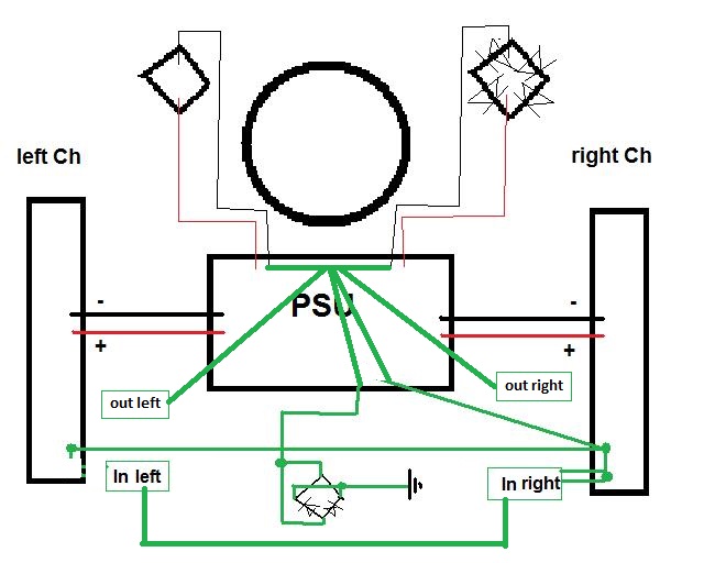

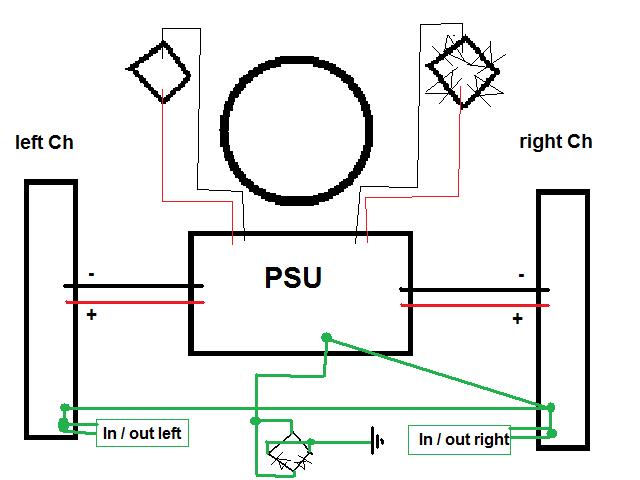

Hello i`v build an second Aleph J and have some hum trouble.
I think its a ground loop but i don`t know what to try first.
I have paint a quick ground schematic not very beautiful but unique
If you have some ideas where to start or what to change?
board are done by myself, maybe i`ve made a fatal layout error used ground plane on each pcb for Signal GND

Danger Mouse
Bring left channel grounds to the same spot on the PSU as the right (the star ground), separating noisy power and quiet signal grounds. Then connect to the bridge isolating the amp circuit from the chassis.
Hopefully your board design made some effort to isolate signal and power grounds. Return them to the star ground separately.
Do you have a resistor or thermistor bypassing the isolation bridge? This is a good idea for safety. A CL60 works well, having a fair amount of resistance until current flows.
ok i will give this a try.
the CL60 are not in at the moment will use them when test phase is over
and all is at its place.
its funny i have a perfectly running AlephJ at home.
Try in my second some board where i have changed the ground routing a little bit thought it would be better this way and nothing works as it should
many thanks for your help

i hope this will help eliminates your hum (at lest reduce )
i am doing this wiring to all my monster...
Thanks for your help
Problem is solved i moving back to the layouts from the aleph wiki.
And going with all groundwires to starground between the last PSU caps.
Now all is hum free.
But was a lot of work.
Changed to much at the same time, maybe the PCBs was the error or the
groundrouting. who knows
