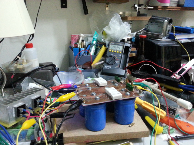

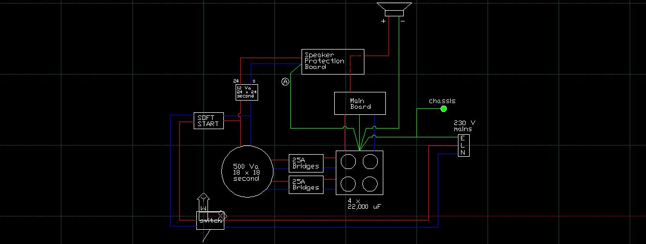

I also have a soft start and a speaker protection. But these were all by-passed when I test the amp.
same problem with both channels ?
I can't see anything wrong , except fact that mosfets are way too high mounted on htsnk ...... but that's not problem seeing that you're having enormous heatsinking
using SE or balanced for listening test ?
if SE , don't forget to gnd neg input leg

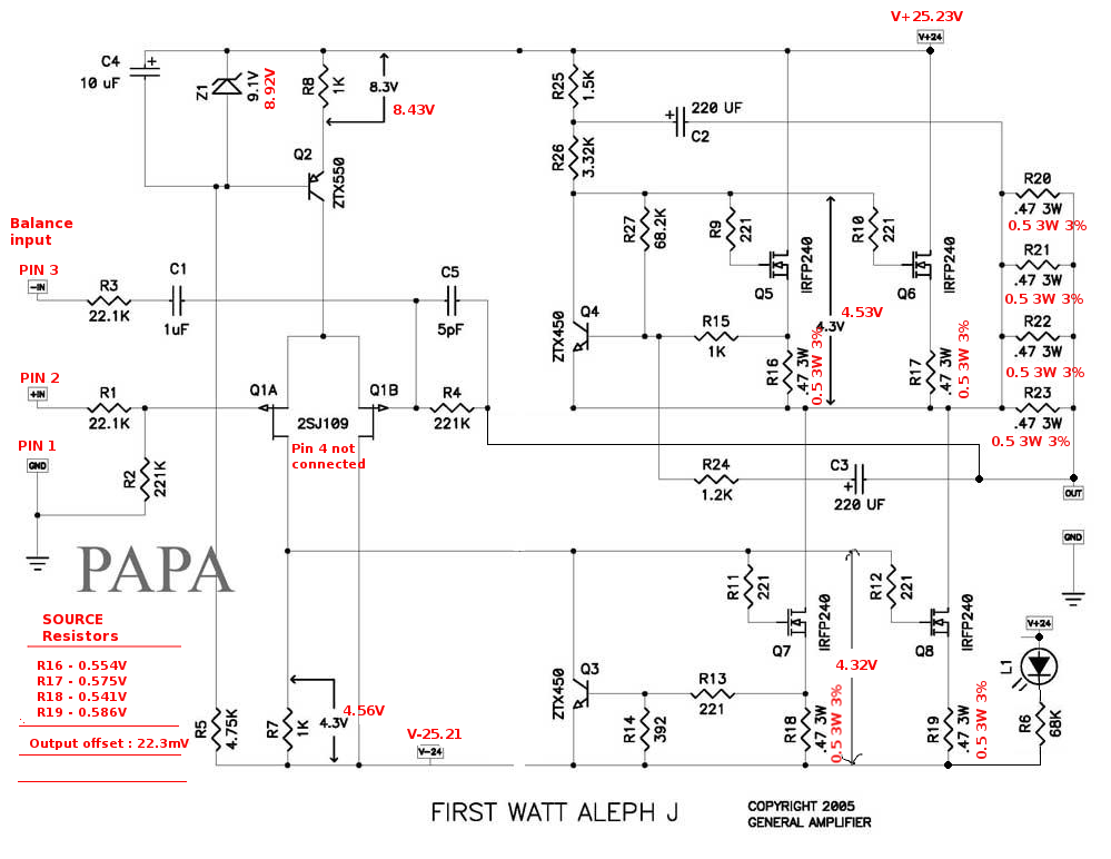

Goodness! Those are 47 ohm resistors! I spend hours and hours checking for loose joints, bad solder points...cleaning up the board, changing wires,etc. Now, I can't get any 0.47 3w resistors.....only 5w and these are too big for Peter's board. I'll use 0.5 ohm 3w resistors instead and the amp plays. The image shows the measurement after about 5 minutes of the amp playing. Is it okay to use these 0.5 ohm resistors? I see from the BOM list which list 5% tolerance. If it is, I'll do up the other channel. Thanks a lot. Appreciate everyone's help. Now the heatsink is really heating up fast and also the heatsink for the 2 bridge rectifiers....at 38 degrees.
.......i think it should work.

(btw- 0R5 are fine )

Thanks for confirming the 0R5. I will use these 0.5 resistors. Now that one channel is up, I am tempt to include the 3rd pair of Mosfet. It's already there mounted on the heatsink including the gate resistors, unused at the moment. I just need to include the 0.5 resistors. Will there be sonic difference if I keep everything as it is and add the 3rd pair of Mosfets?
Right now the Mosfets are at 52 degrees and the heatsink of the mosfets at 48. The small heatsink of the 2 bridges at 46 degrees. Thanks.
you can simply include third pair , increasing Iq for 50% - if your heatsinks are capable to dissipate that

I think my heatsink can cope with the heat. I just wonder if including the 3rd pair will make an improvement to the sound quality. If it does, then I will include the 3rd pair but if the sound improvement is little, then it is just not worth the effort. Thanks.
yup , it will improve
diminishing returns , however

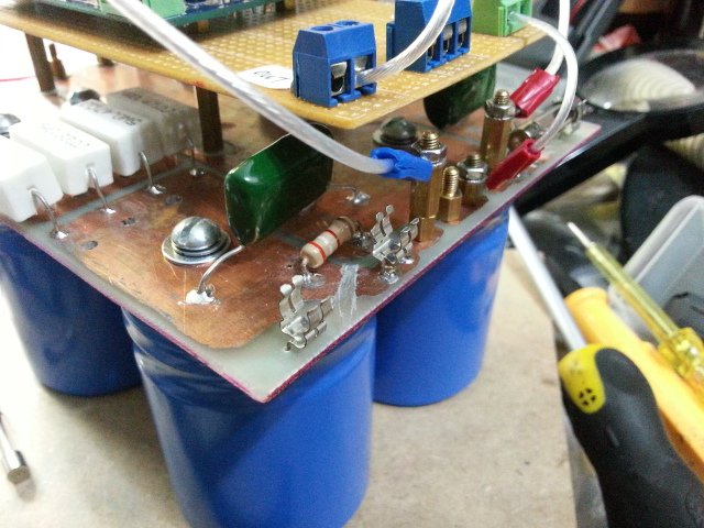

The Fets are mounted on the heatsink with the along with the gate resistor.
is there any impact on routing each transistor by cable instead of direct solder?
I don't think there is but the gate resistors have to be close to the Fets.
