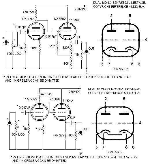

I want to change ac signal coupling caps of my dac and line pre, and I was thinking if I can replace input pot of my line pre from 100k with one of 200-250k so in this way I will need a cap of a lower value on the stage before him right?
correct me if I am wrong
what else will change along with pot value?
I use second schematic
using anything more than 50K for volume pot will introduce cable talk
that will be much more important than any cap issue
whatever cap you have as output on preceding stage , bypass it with MKC , or make another config , which will be DC coupled
however - I'm resorting to DC just because I can , not because cap in chain is most critical link ...... looking at that toob stage , I'm finding it more critical than any cap
