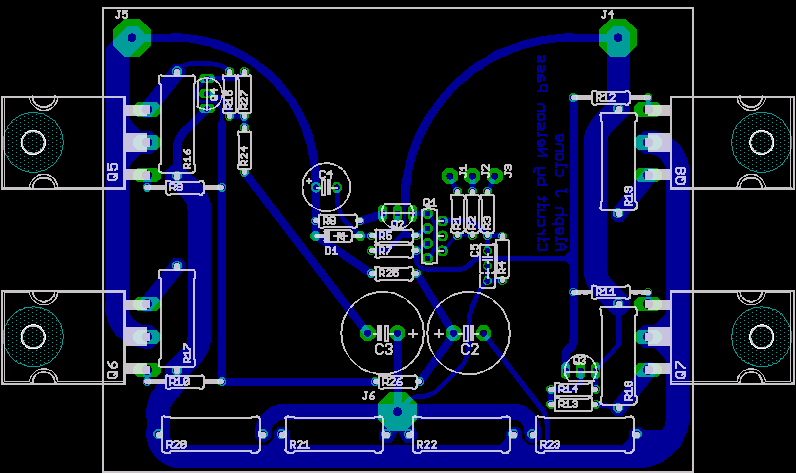

HBarske said:Aleph J PCB? Here ya go.
Board measures 80x100 mm, single sided, no wires. It's exactly Papa's schematic, I only left out the input coupling cap (1µ) for greater flexibility.
Comments welcome.
I like it 😉
if you wanna use small MF resistors , make R5 from two in series ;
dissipation issue
Good hint, thx Choky. U're right, dissipates >300 mW.make R5 from two in series; dissipation issue
if you ask me - I'll stick with two bjt CCS , even if Papa choose simpler one ;
besides better temp. behavior of two bjt version , comparing it with one bjt version, one issue is certainly important - thurn on thump must be greater - look at 10uF across zenner .
maybe I'm wrong , maybe I'm not ;
in any case - I'm sure that Papa's schematic is good enough , as always 😀
