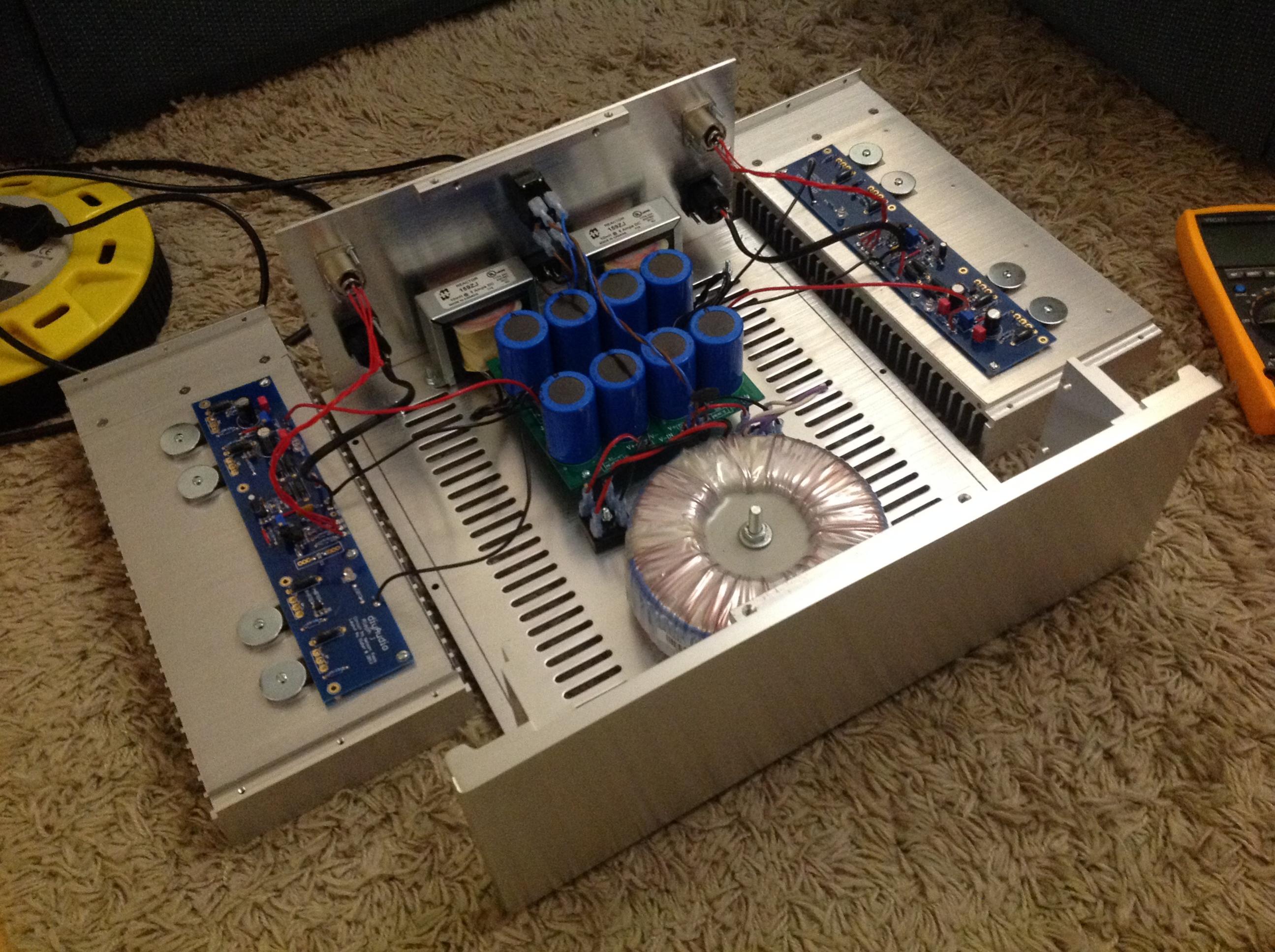

To Quertyl: This was discussed elsewhere. In an Aleph J you need to have a separate full bridge rectifier for the positive rail coming from one pair of 18 VAC outputs and a separate full bridge for the negative rail from the second pair of 18 VAC outputs. The positive rail does have more load than the negative in an Aleph J. If you have a center tap, then you need to change something.
Yes, I have separate bridges for positive and negative rails, basically standard FirstWatt power supply, the same for F4 and Aleph J.

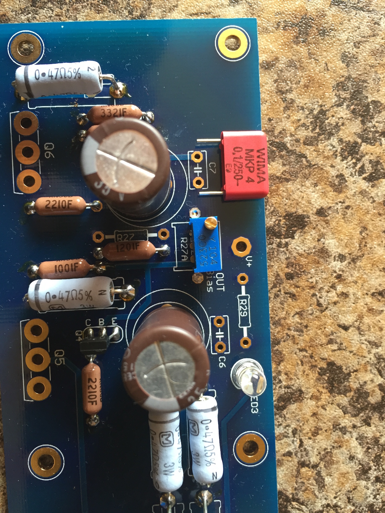

The following picture shows the cap for positions C6 & C7, as you see the cap is physically too big. I followed the BOM and this is what I ordered, obviously the wrong part for this application. (505-MKP4.1/250/5P10, Mouser p/n)
will you please let me know the proper component I need to order?
Thanks in advance!
