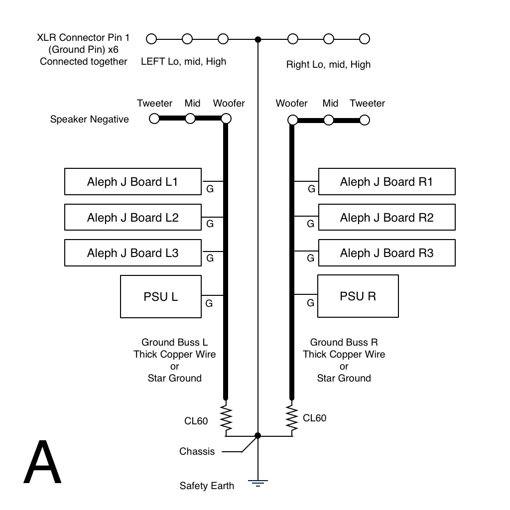

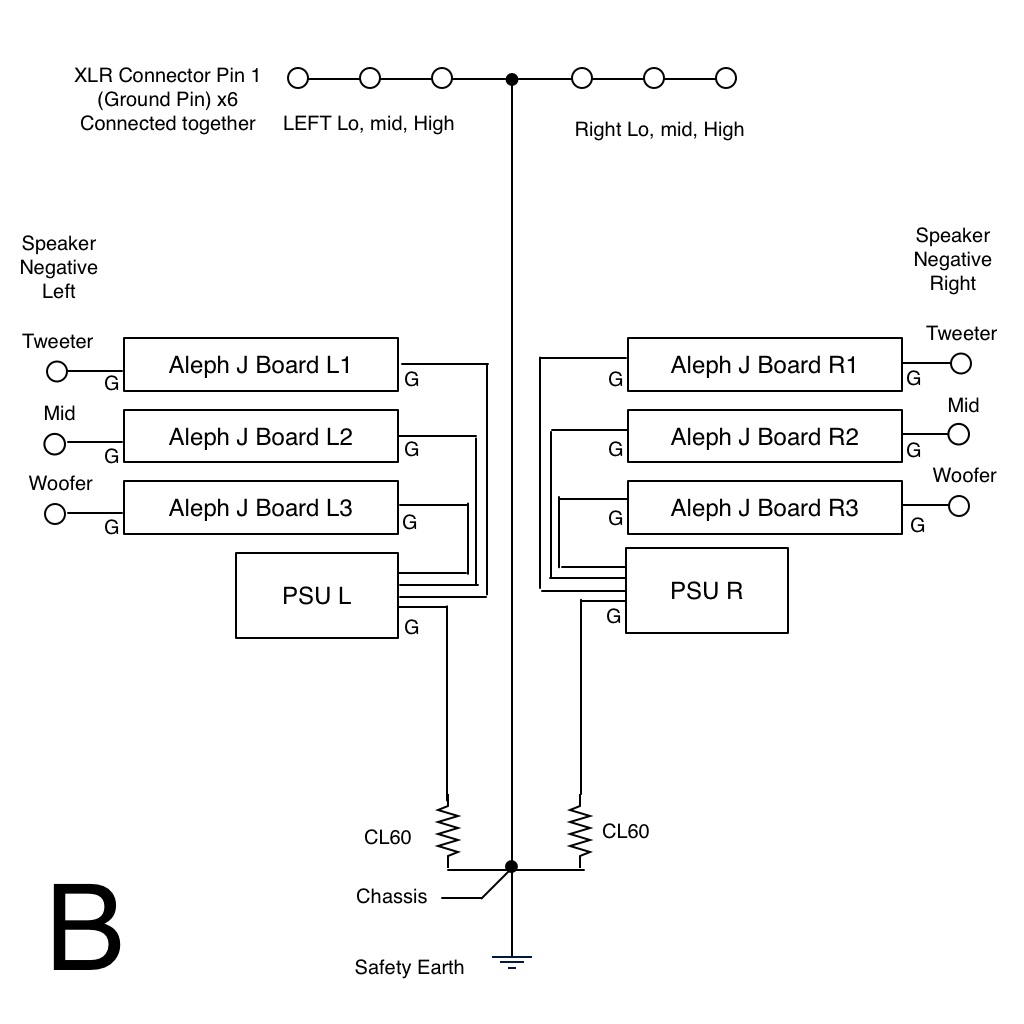

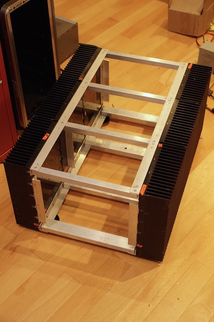

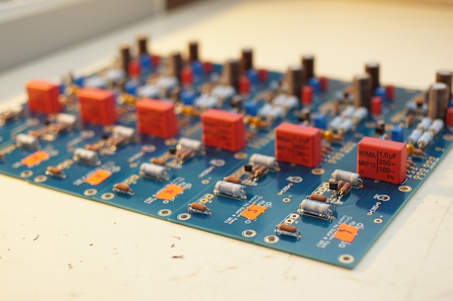

I just finished (6) Aleph-J boards and a custom enclosure for the active crossover (6 ch) system.
Now I have a few questions about the grounding. I have been learning it for a few night, but I can't still find what is the least problematic method.
Please find attached files and let me know what do you think, I made A and B, for example. A few pictures of my project are also attached. The amp has 2 transformers and 2 PSU in one big chassis.
