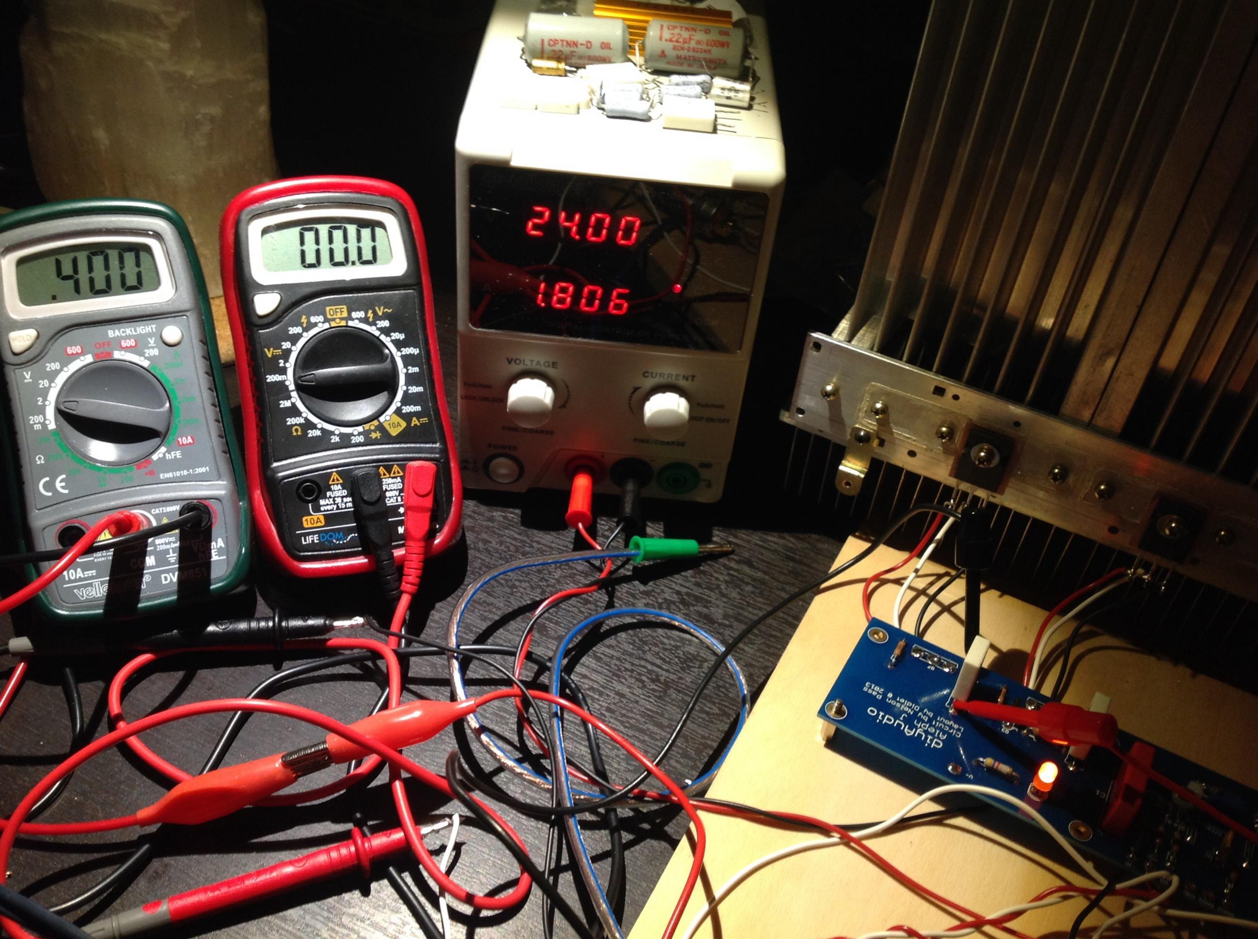

all mosfets are having same dissipation....be sure that they're all torqued the same
@ Zen Mod
Yeah ! Thx Mighty
Was not torqued with the same preassure now is equlibrium.
@ WalterW
Thanks for kind words it´s encourage me to make great amplifier.
Humbe test so i made with i have on table without drill heat sink.
Yes mosfets be claped at final step of construction
and little thermal paste drop bettwen jfets too with heatsrink ring
to keep them togheter.
Last two days check of bias @ offset with long music sessions
Power on and after 5~ 10 minutes all is perfect.

Yes for optimal max bias adjustement low distortion without temperature excess
industrial probe are must have but not critical for first day do you
