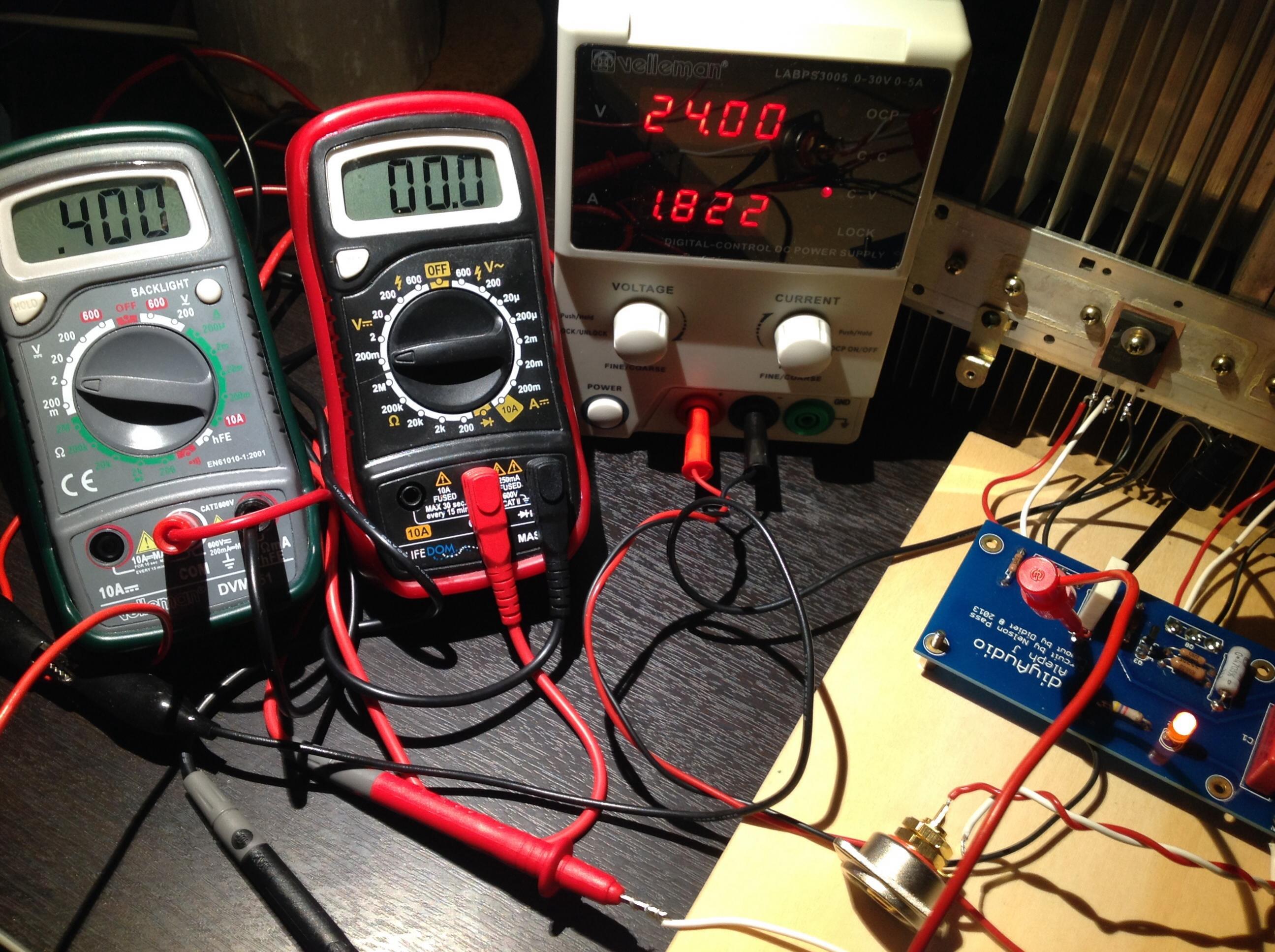

My Aleph J pcb's is ready stuffed so i attached mosfets to heat sinks and
try how they work with bench power supply for the first time.
I need short my green earth to (-) of bench psu ?
Psu output max voltage is +|- 24 V without load
but what output maximal current lock regulation 1,5 ~ 5 A of lab psu ?
Trimmer R27 is 68 kR value adjusted for start like in famous 6L6 guide.
Do i need use dummy 8 R 100 watts resistor ( my speakers are 8 R)
on speaker outputs for this bias & offset adjustement ?
RCA inputs are open or i connect them to my audio source ?
Have two voltmetres 1 for source resistor and 2 for offset.
Thanks for your kind response :bulb::wrench::note:
Green chassis saftey earth does not need to be connected if using bench PSU.
If you have R27 set to 68K, leave it alone for now.
Power up and adjust offset to Zero. Measure bias. Change R27 if you want more or less bias.
You do not need load resistor on speaker output. Short circuit on input is helpful, but not strictly necessary.
Good luck!!

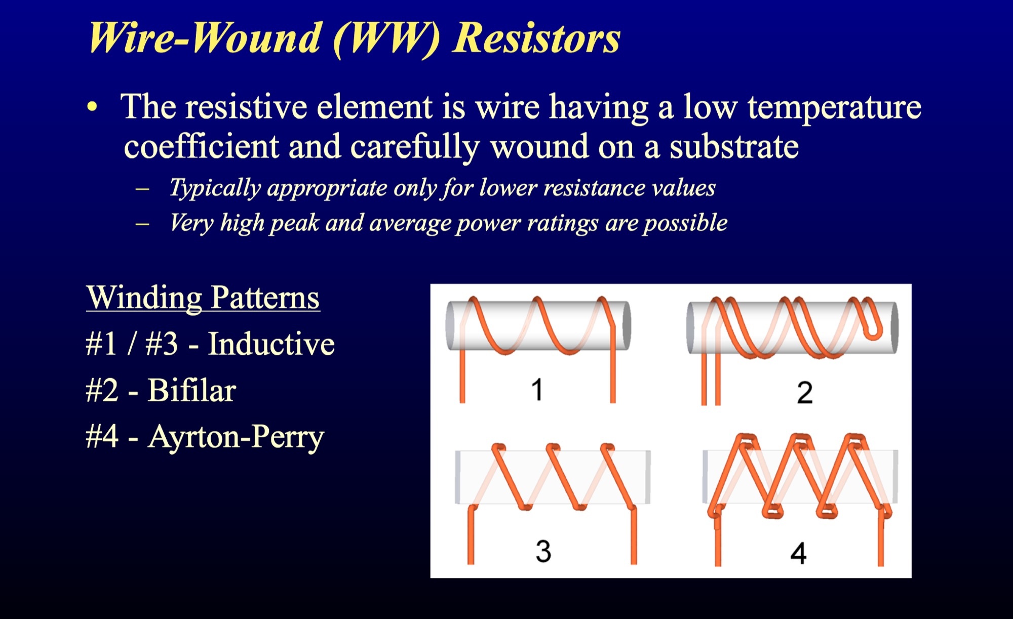

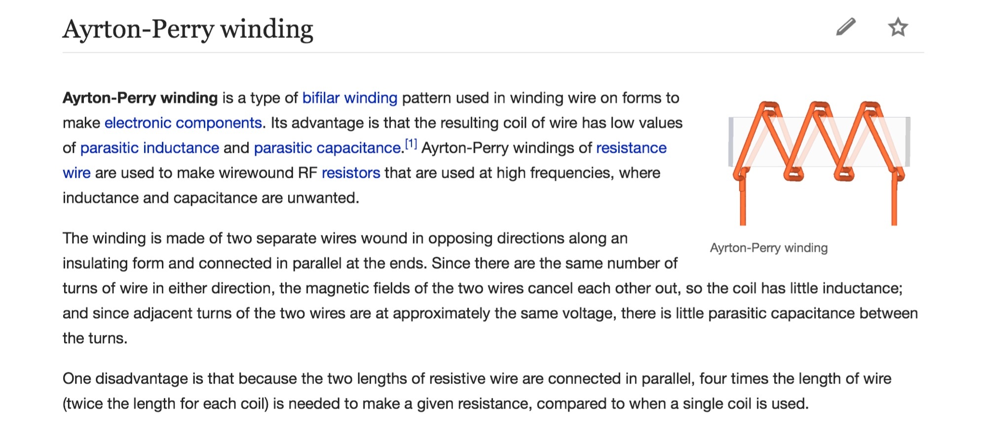

All is good and music are charming 😀
Work in progress next step PSU and i wait for Mills MRAO5F
wirewound source resistors after experiments with generic ones last evening
this no magnetic & no inductive Ayrton-Perry winding can be delicious
let's try them this is electronic cooking for sublime sound.

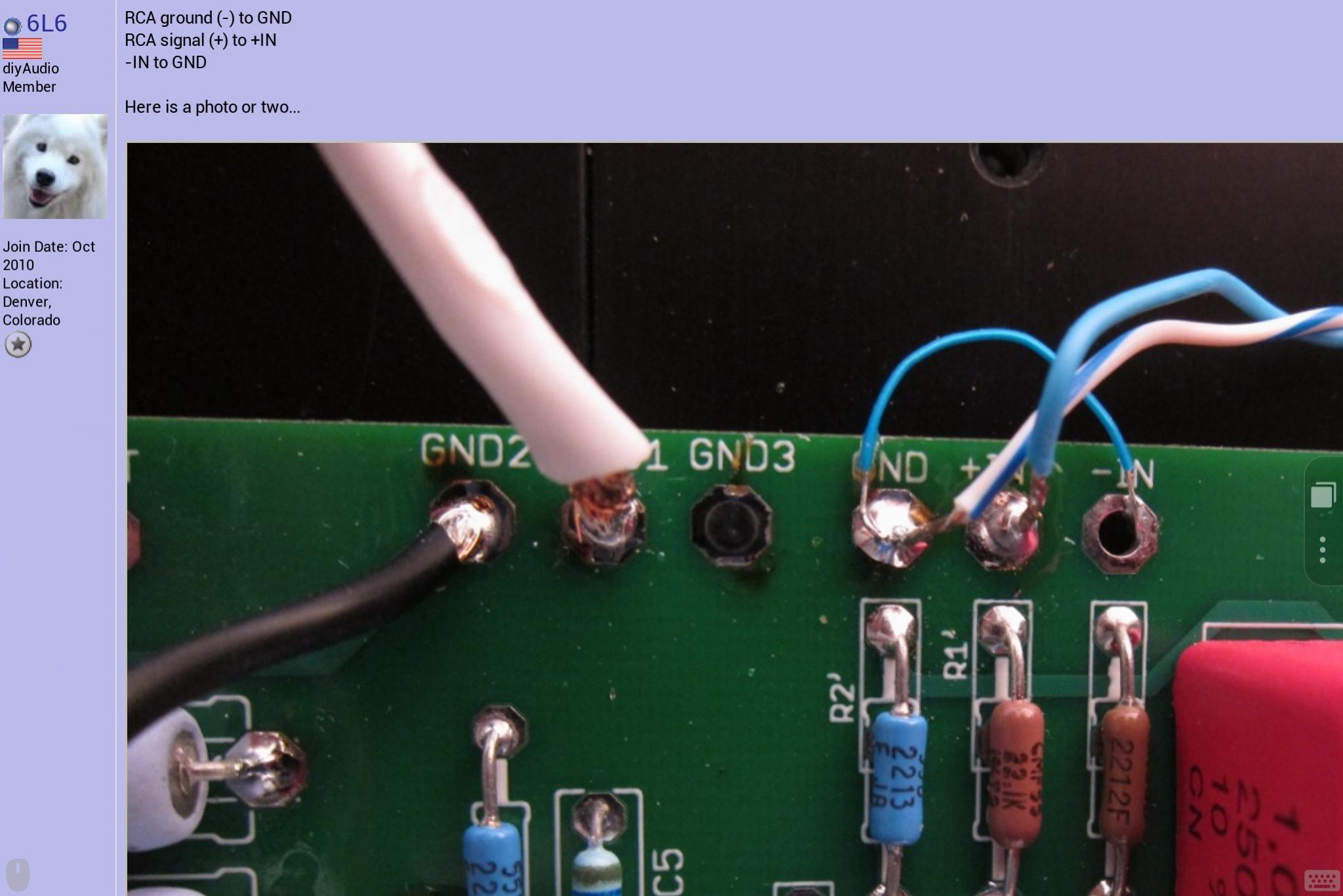

@ Folkdeath95
This photo from 6L6 are useful 🙂

Well, first test made 10 minutes ago, no smoke, no flames, everything seems to be OK. Bias is at 0.35V, offset à 0V and the amp is warming up.
The LED are brighter than expected, but it shouldn't be a problem. I'll see when the chassis is closed...
