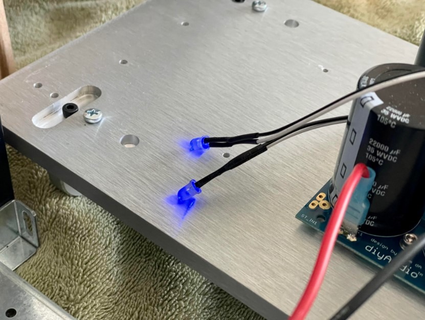

It's alive! Or at least my DC power supply is alive. 25.2 volts on both sides, within .01 volts of each other. The future front panel LEDs are the brightness I wanted (I mocked up with another power supply with the resistor/LED pairing), so now I will install those, now to get those power supply boards stuffed and assembled.
Been dragging my butt on this, but excited to have this milestone passed!

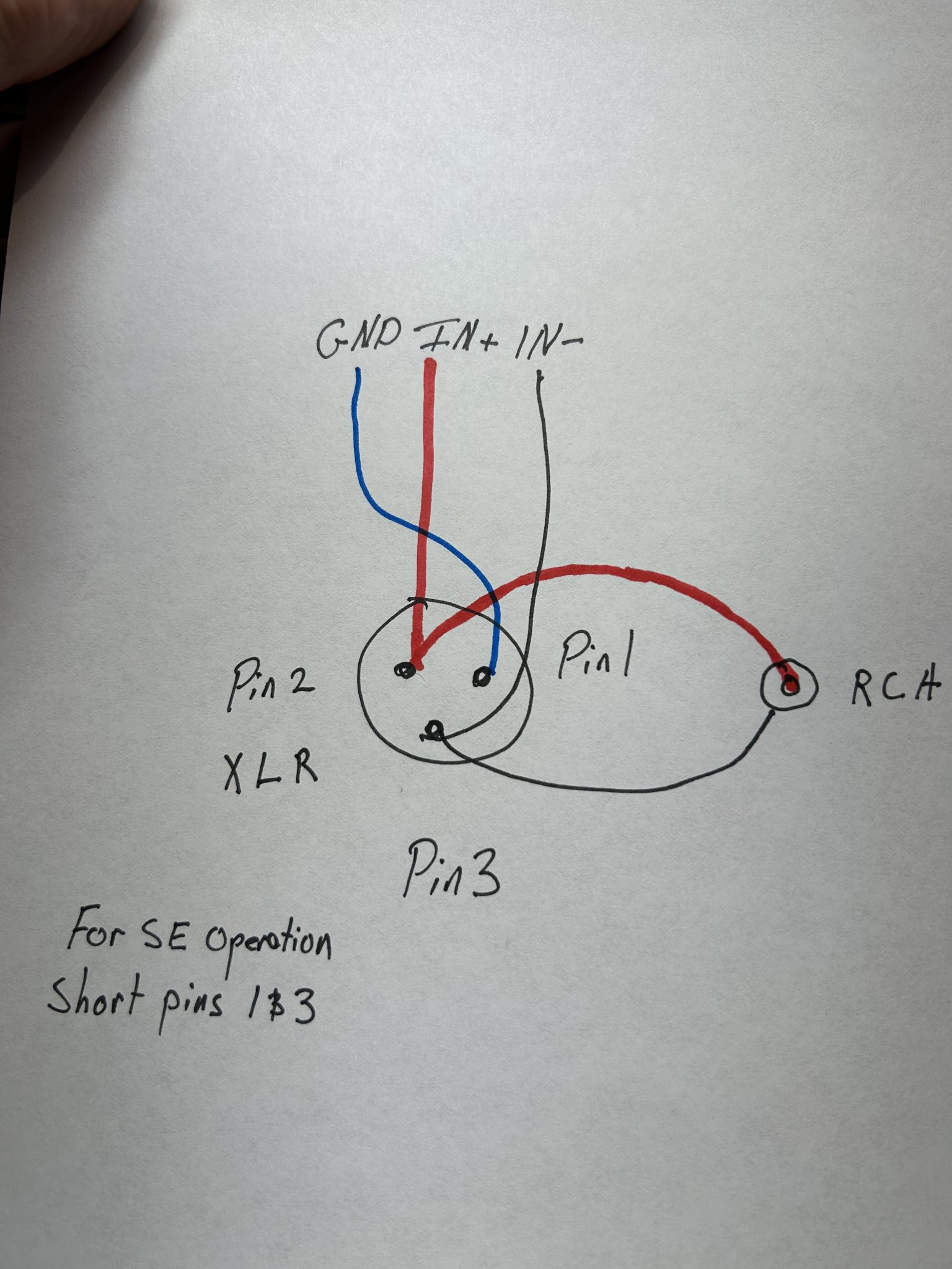

Hello all,
I built an Aleph J with single-ended inputs using the BrianGT boards. In order to simplify the build I omitted R3 and C1 and there was no connection to IN-.
I recently decided that I wanted to try balanced connections end-to-end in my system, so I ordered a pair of Neutrik XLR jacks, 1uF caps (C1) and 22.1K resistors (R3) and installed them in the J. I disconnected the twisted pairs from the RCA jacks, wired them to pins 2 & 3 on the XLR jacks, and wired pin 1 to one of the jack's mounting screws. On the board end, I left the + wire in IN+, and moved the - wire from signal ground to IN-. It follows that there is now no wire connected to the signal ground. I have confirmed 0 ohms from pin 1 to chassis ground, and from signal ground to common ground, on both channels.
Despite being unable to convince myself, I suspect that I am missing a connection, because there is hardly any output to the speakers (faint sound at max volume) and back on the bench I can't get a stable bias or DC offset with a shorting plug in the input. Temporarily reinstalling the RCA jacks (now with a jumper from signal ground to IN-) allows me to once again set the bias and DC offset accurately.
What am I overlooking?

it works (in fact, in both ways) in amps where signal ground is connected, in some (proper) way, to chassis
so, if that detail is still missing in your amp, it isn't proper
is there at least 10-15R NTC between audio GND and chassis (which must be connected to safety GND)?
except in case of being made of wood or plastic or any other non-conducting material :clown:
