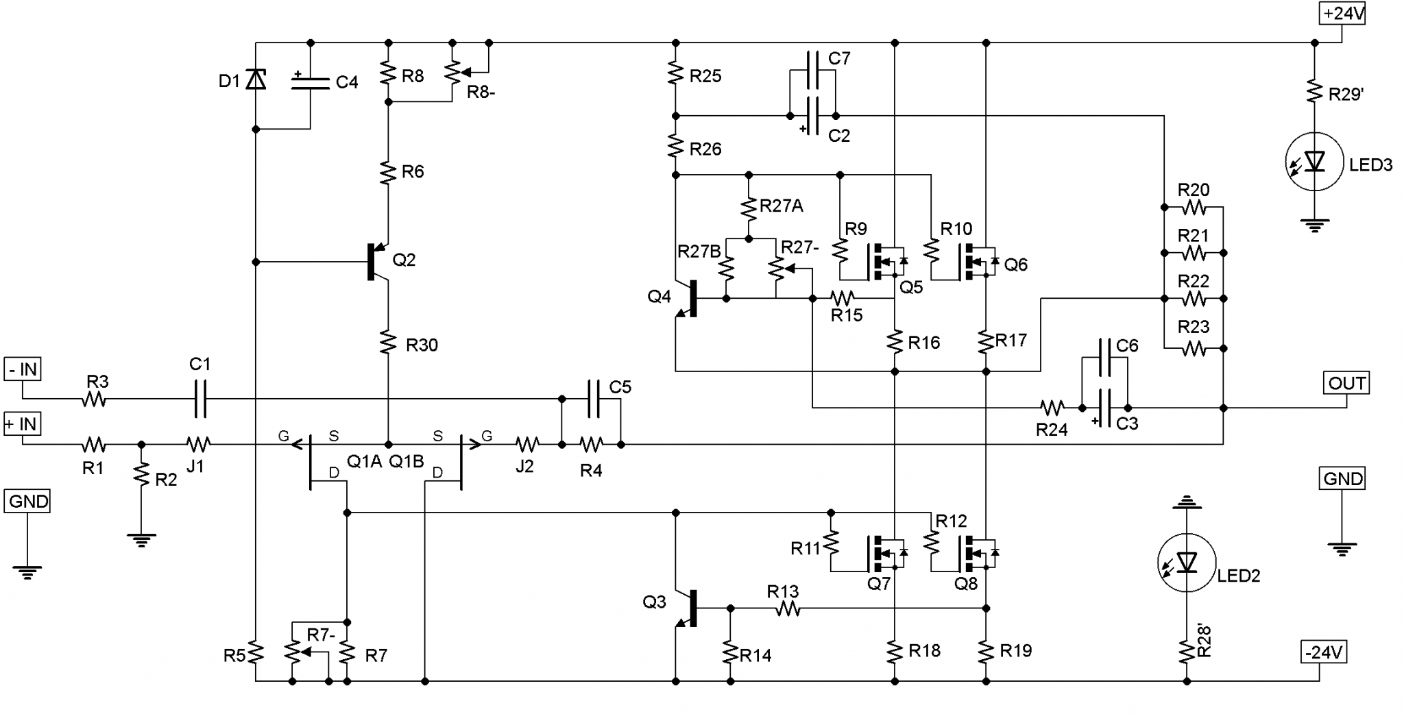

You are saying PP which was my thoughts at first when seeing the circuit but on the Firstwatt page it is described as a SE.Aleph CCS is upper part, modulated Current Source, so acting both as biasing mechanismus and also as upper part of PP OS, where you can set desired amount of its contribution in output
look here:
It is acting like a part of a PP OS. Not making it a PP circuit. Still only a CCS, but increasing efficiency and stability into low impedances, etc. many advantages. It could be replaced with a resistor, making it hopelessly inefficient, less powerful, but perhaps even more true to the single ended topology.You are saying PP which was my thoughts at first when seeing the circuit but on the Firstwatt page it is described as a SE.
Addition: If you reduce the CCS controbution as mighty sez, you get more 2hd and even more SE romance and sugar, but also less power and perhaps a little less stability into difficult loads, etc. the wonder of the Aleph CCS is it enables people to keep the qualities of SE topology even with more demanding speaker loads, and with more power than most SE circuits, using a CCS applying minimal damage to the SE spirit
study the patent and whatever schematic you can find of it
you'll see that behavior is different to regular PP stage, even when Aleph CCS is set to 50% contribution
(one of the) catch(es) is that Aleph CCS behavior/modulation is strongly dependent of load (speaker) itself
I was in the same place as you are. The main trigger for asking questions, in my case, was the inclusion of the R20 thru R23 in the design... which is a downside (but unavoidable) of this active current source implementation that brings lower distortions and better efficiency.
Check the patent paper attached.

put 1KHz sine, 1W at output, through dummy load (8R)
measure voltage AC across source resistor in lower rail, write down
measure voltage across AC resistor in upper rail, write down
inform here
goal is to find what Aleph CCS AC gain you have actually
meaning - when said is approx 50%, that means that upper half of amp OS ( exactly Aleph CCS) is having same voltage/current contribution as lower part of amp, practically amp acting as regular PP amp
if said gain is lesser than 50%, amp is leaning more to pure SE mode of operation, thus being more dependable of load value and behavior
now, having 604, efficient as bigbadaboom, you can try trick with load shunt - if you put 10-20W 16R resistor in parallel to spk, silly amp should think that 8R speaker is connected
some power to speaks, some heat to resistors, but who cares, with their efficiency

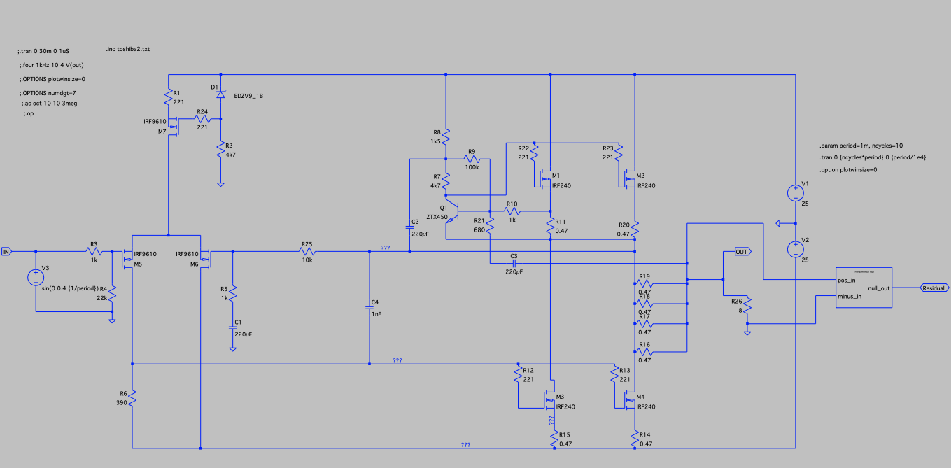

Just finished my first Aleph J. What a wonderful amp, best of both worlds, clarity and softness at the same time.
M2 must go to the basement!
Some remarks, to get the 0.4V at the 0R47 I had to go down with the R27 68k to 15k, why ever.
Next days I will look for the H2 neg phase with Diana. In Spice I have to go to 2k for the R24/1k2 to see neg phase.
And by the way, I finally succeeded in getting neg phase H2 in Spice for A3 and A30. I was looking for this a long time. The solution was not to take the IRFP models in Spice, but the models for IRF240 for the A3 and the model for the IRF244 for the A30. Et voila!
Many people told me that the IRFP are a good replacement for the 240/244. I have no doubt it will work, but the H2 neg phase is a shy animal.
So for IRFP you have to play a longer time with the Aleph resistor to get neg Phase too.

here my try with A3.
If you have more questions.... :--))
https://www.diyaudio.com/community/threads/spice-simulation.101810/page-19#post-1333137
