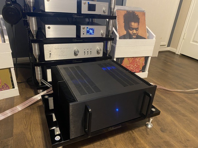

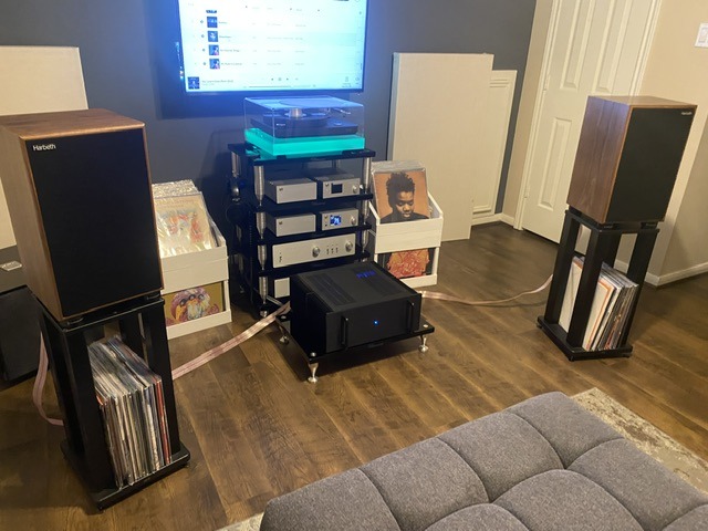

The Aleph J on Harbeth may be my new favorite amp combination. I was using a Pass xa25 over my M2x and Amp camp Dual monoblocks before.

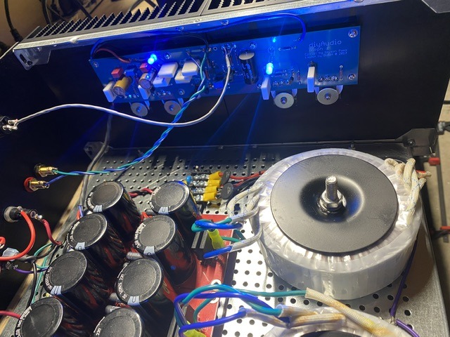

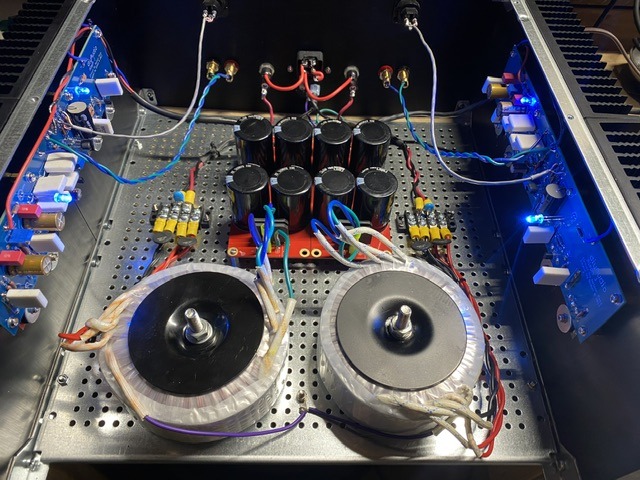

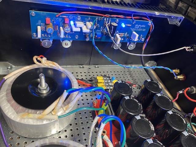

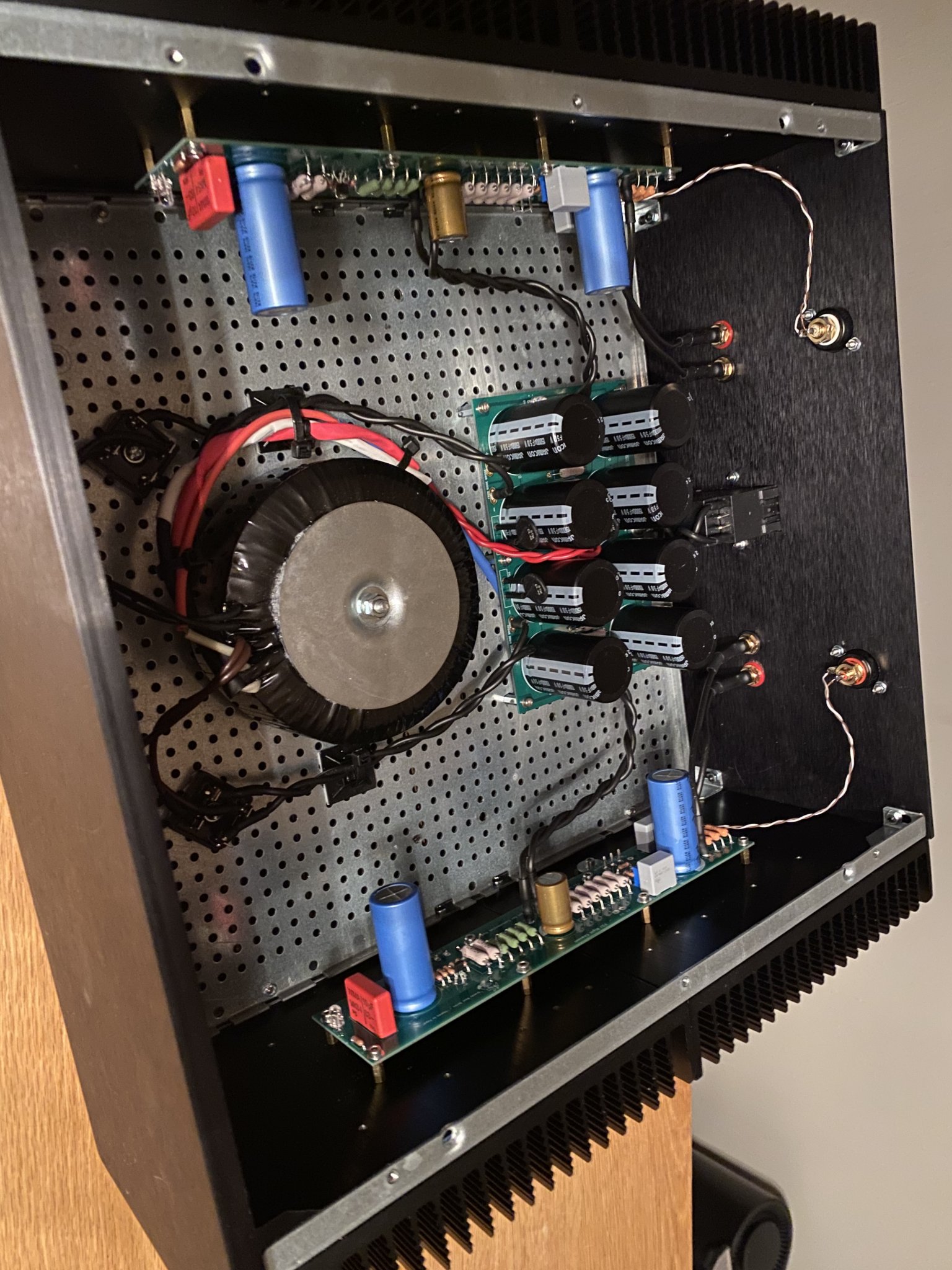

I have a 4U 400mm chassis with dual mono AS-2220s, 54000uf per rail, and 28V rails.
Not shown in the pictures as I did it later, I added rca inputs with an On On switch for each side to tie pins 1 and 3 together. Kind of the same concept as the new amp camp wiring for parallel. Not sure why I waited so long to build this amp.
The imaging and Mid range are very nice and the top end is just enough.

You’d love the F2 🙂Does the the Aleph J invert phase? I know I enjoy it more with the + and - swapped at the speaker. How about other FW amps?

The F2J is with unobtanium. Smooth clean positive phase 2hd.

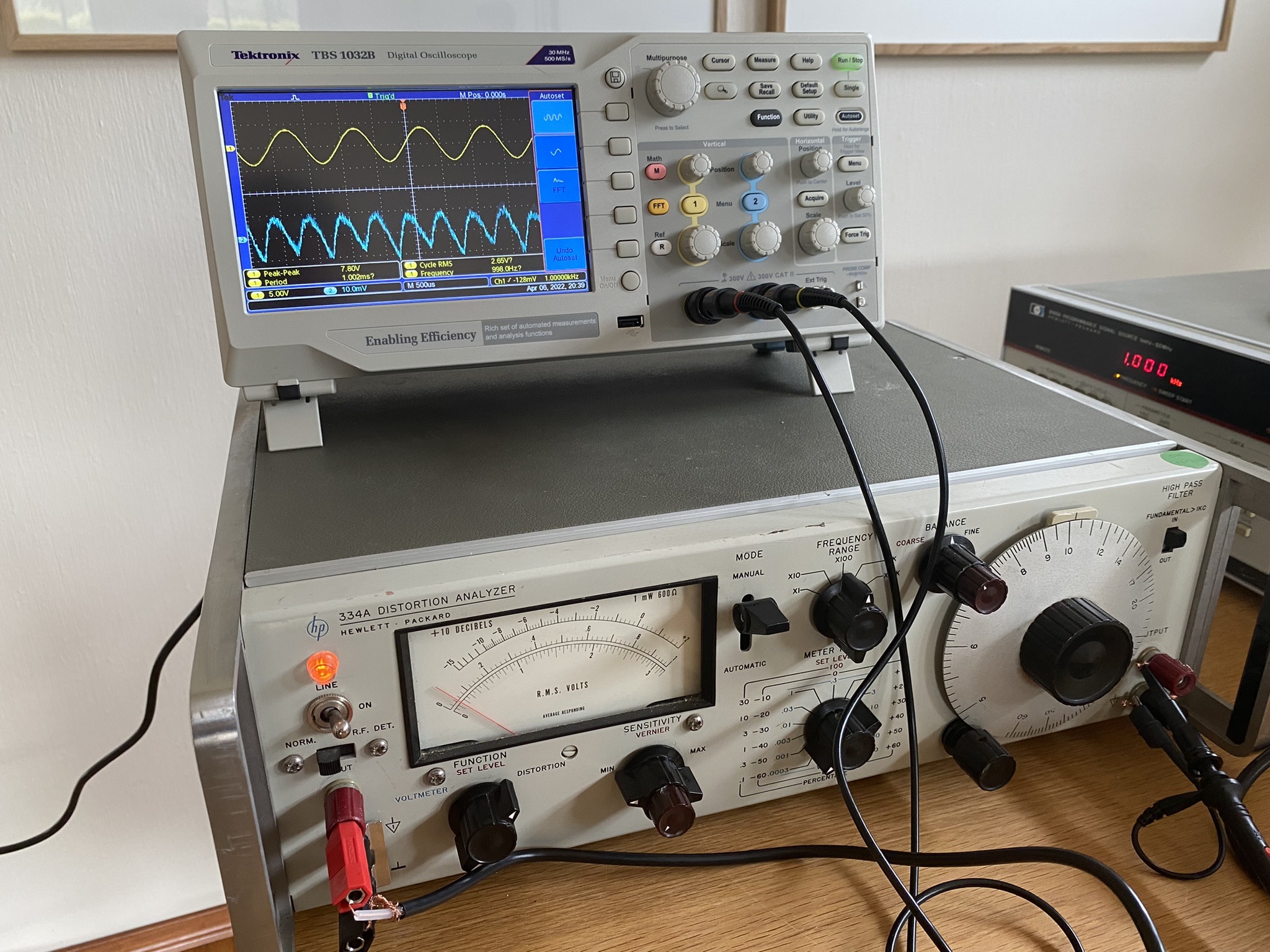

I don't have that scope, but unless the time scale / axis of the blue and yellow traces are different (I don't see that on-screen anywhere), then that's not showing a 2nd harmonic. It's showing a lower-level signal at very close to the same frequency as the fundamental and slightly phase shifted (if the traces are time-aligned). I can see the period / frequency of Trace 1, but not 2.
Not second guessing anything, but from what I can see in the picture by itself, I'm not seeing a clean visual of a 2nd harmonic distortion.

Maybe my 334 is broken. Will do some digging. But I did manage to adjust the amp for minimum thd using it, but what it is showing - I agree, looks off.I don't have that scope, but unless the time scale / axis of the blue and yellow traces are different (I don't see that on-screen anywhere), then that's not showing a 2nd harmonic. It's showing a lower-level signal at very close to the same frequency as the fundamental and slightly phase shifted (if the traces are time-aligned). I can see the period / frequency of Trace 1, but not 2.

Forgot to say I did do some zooming and adjustments of the residual, but with this 334 I have always experienced this phase shifting, and what is shown always looks like a lower level version of the fundamental. But I have been able to read the seemingly correct thd off the meter, and affect the visual residual by adjustments. Hmmmm. Will check it out, maybe I’ll have some time this Christmas. The unit was tested in 2010. But of course, in these sorts of measurements, there is always a huge room for F40 errors (error being 40 cm from the unit)
Phew. I would think so, from the outputs on the right side of the front panel.If the blue trace is the residual from the 334 monitor jack, then it’s working just fine.

It is, I think, the best I could squeeze out of the WLS last summer^ If all the stars were aligned, that (to me) looks like a lovely illustration of a negative phase 2nd harmonic.
