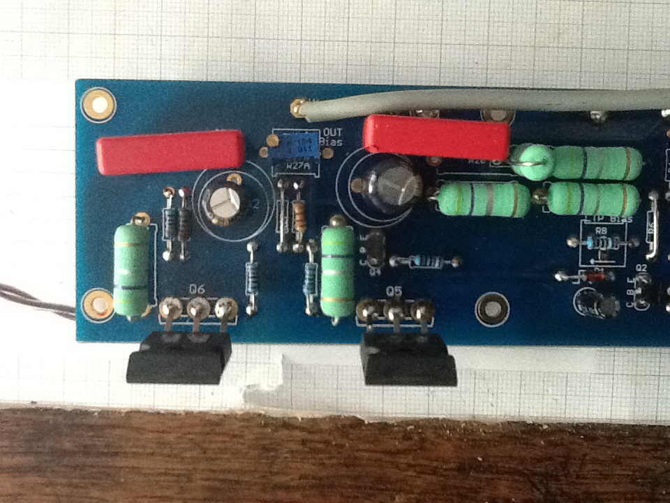

Hello all,
Hope someone can help...

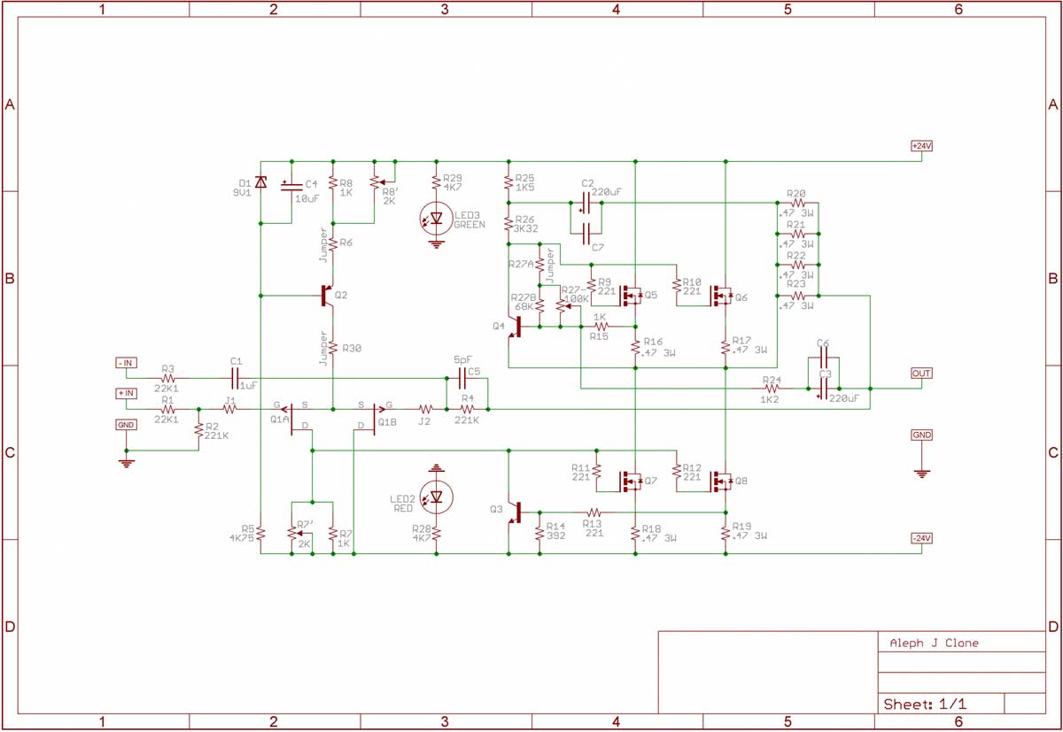

I am building two mono J's. The circuits are stuffed and I fired them up.
Channel-1: I have set off-set and bias. The off-set seems to wander between +10 mV and -10mV. I goes up and down.
Observation 1:
Bending Q4 away from R16 seems to change the off-set and seems to lessen the difference in off-set to +/- 5 mV.
Question: is this normal?
Observation 2:
R5 gets quite hot.
Channel 2:
The MOSFETs do not warm up. The PSU is working and the LEDs for the + and - rails are on.
I have compared all resistors with the ones on the working channel and have re-soldered the components. When measuring the voltage on different points on the board against GND, I get some 25V on R16/17/R18/R19. Also, R5 gets rather hot.
Anyone who can help?
Tx in advance, Vranc

obs. 1 - normal
obs.2 - if R5 is according to this schm , do not worry
ref. to gnd ?
however - give us pictures
ref. to gnd ?
