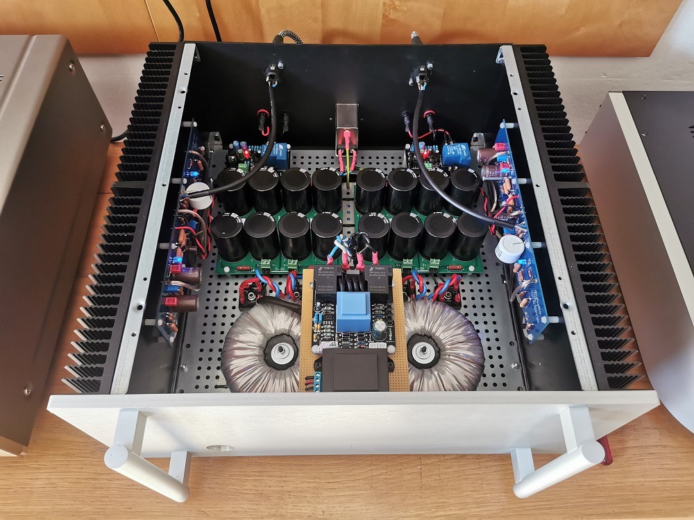

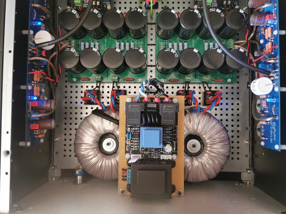

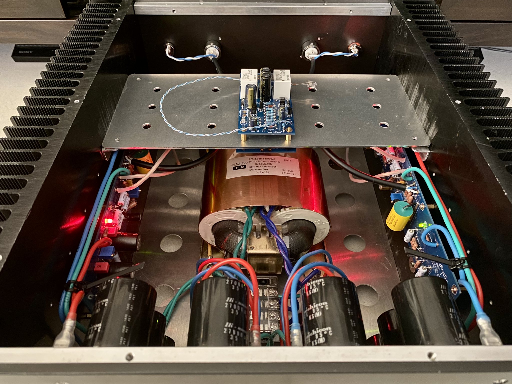

Just finished putting together an Aleph J. Not quite finished, with a few remaining things to sort out including wiring up the speaker turn on delay circuit and making a face plate for the front of the chassis.
Started out planning a dual mono configuration but ended up using this 650VA R-Core feeding dual PSU boards.
Listening to a DSD of Cannonball Adderly - Somethin’ Else playing through a tube output DAC into some Fostex Sigma full range drivers in large horns.
It sounds absolutely stunning! Thank you Papa, 6L6, Didiet78, Laverda and all the great knowledge offered throughout this thread!

Nice!
Cool looking transformer🤘🙂🔥
Seems that you opted for fancy C1 caps👍
Aleph J number two, coming up! 😇

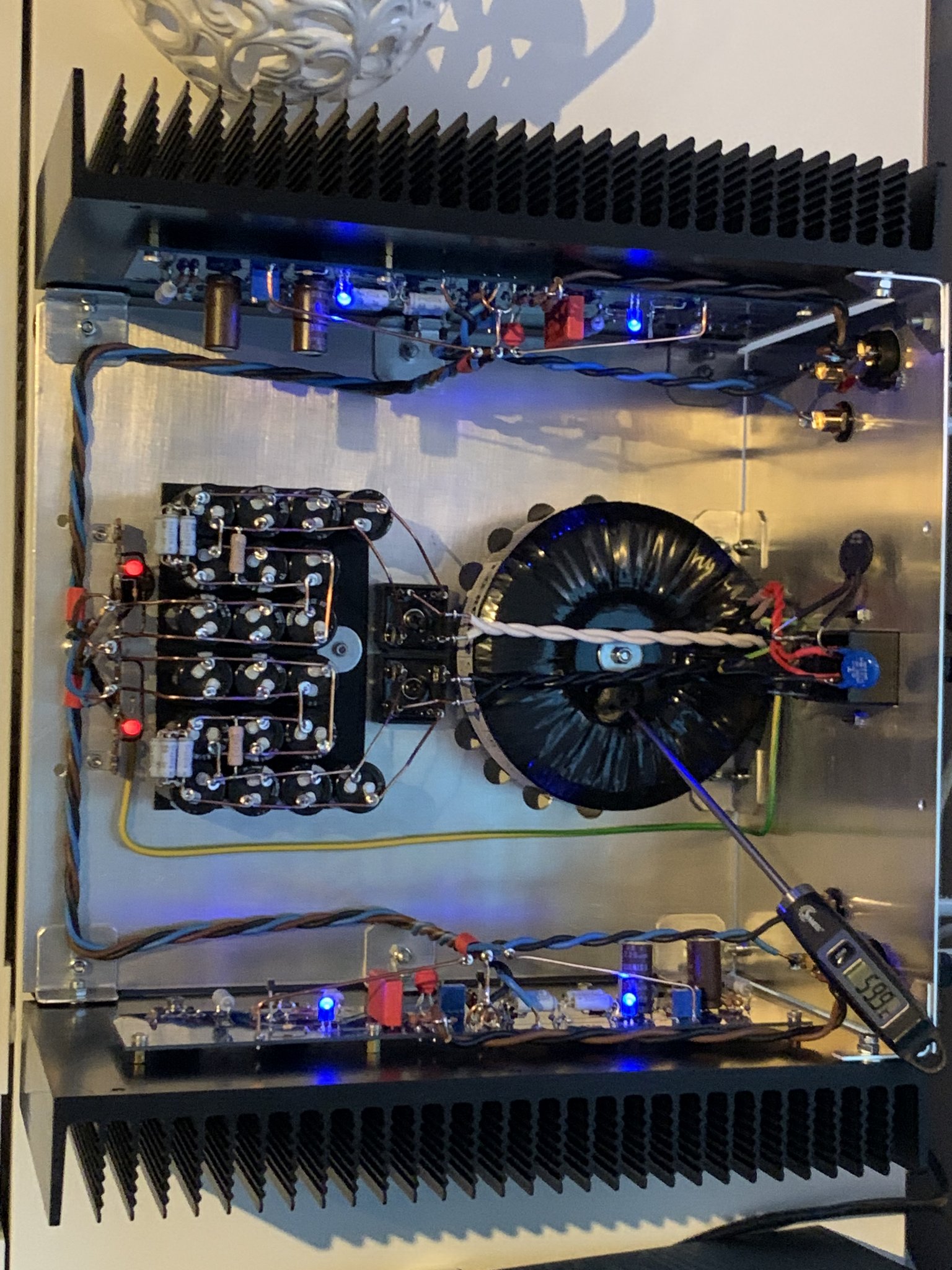

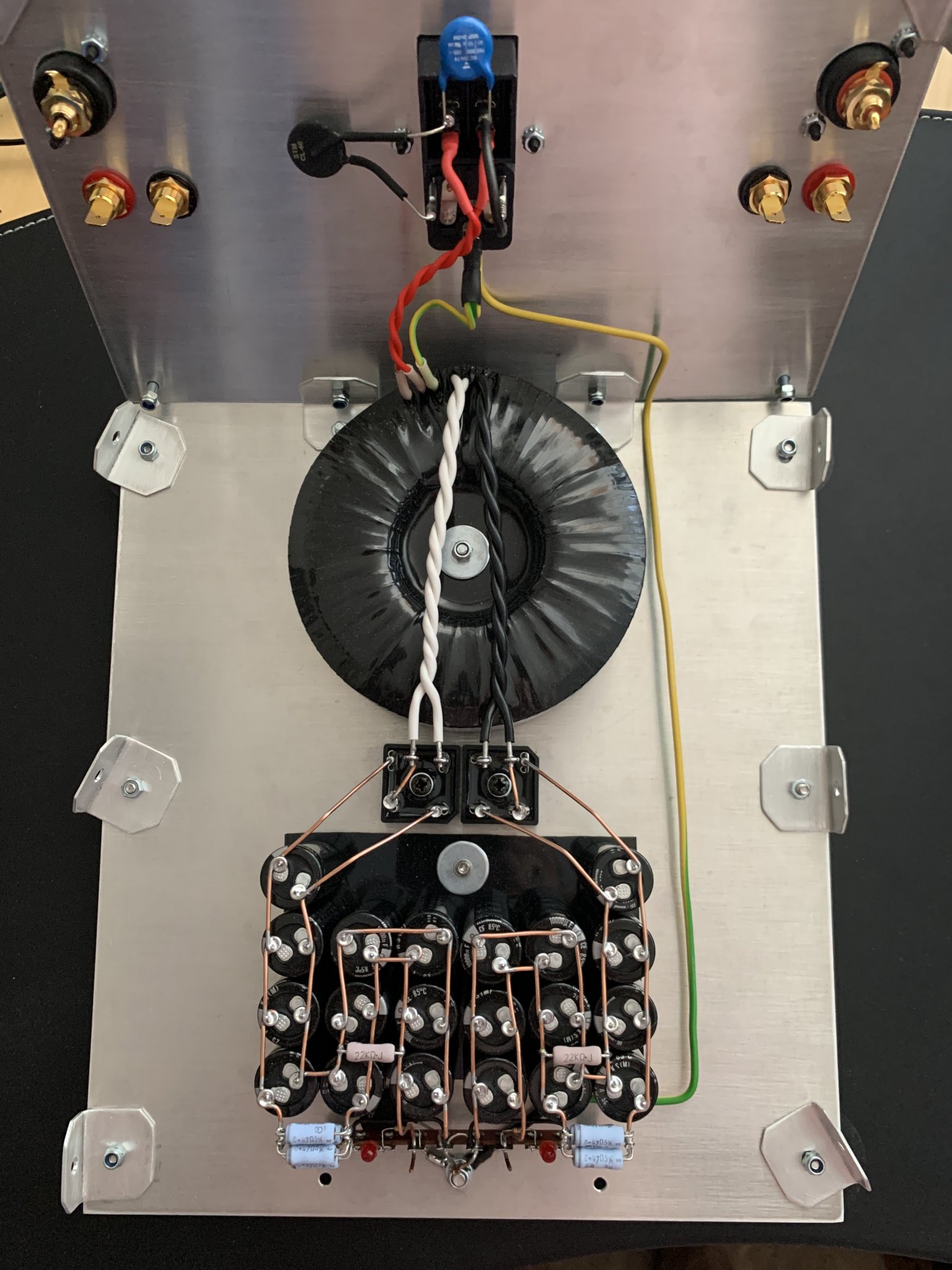

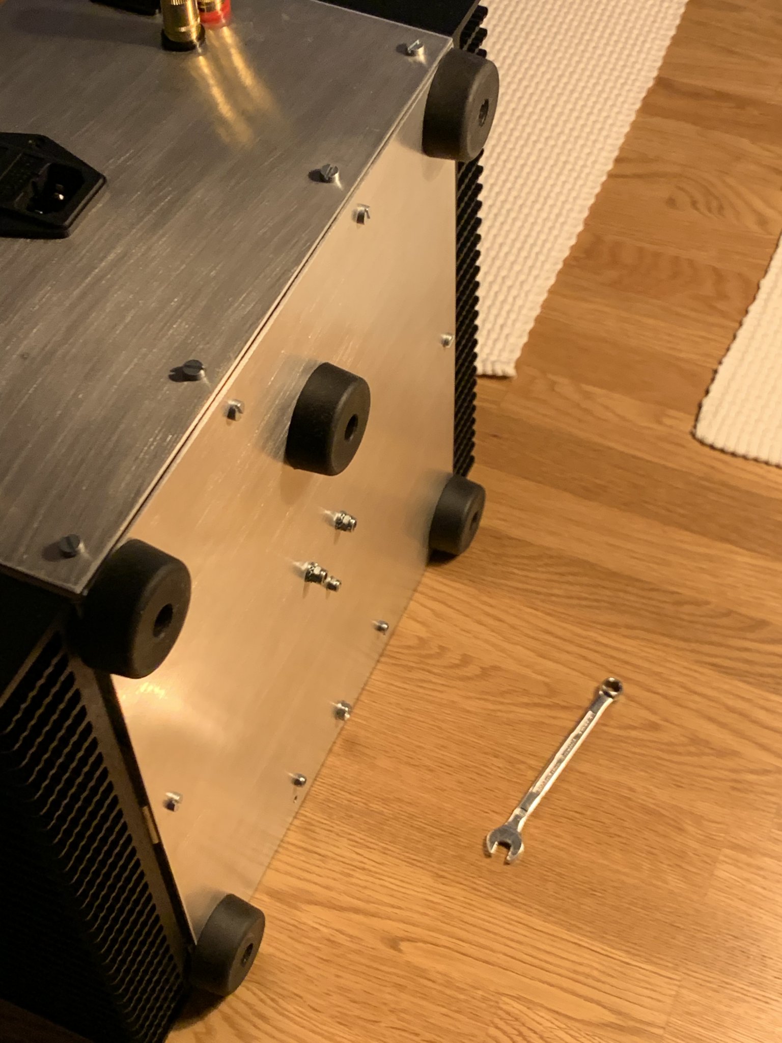

I have made ventilation mods in the bottom plate for enhanced transformer cooling, as a safety margin on those really warm summer days ☀️🙂🔥
Will post the new temperature readings in 24+ hours.
Picture shows, before ventilation mod, that even the transformer got himself a rubber foot🙃

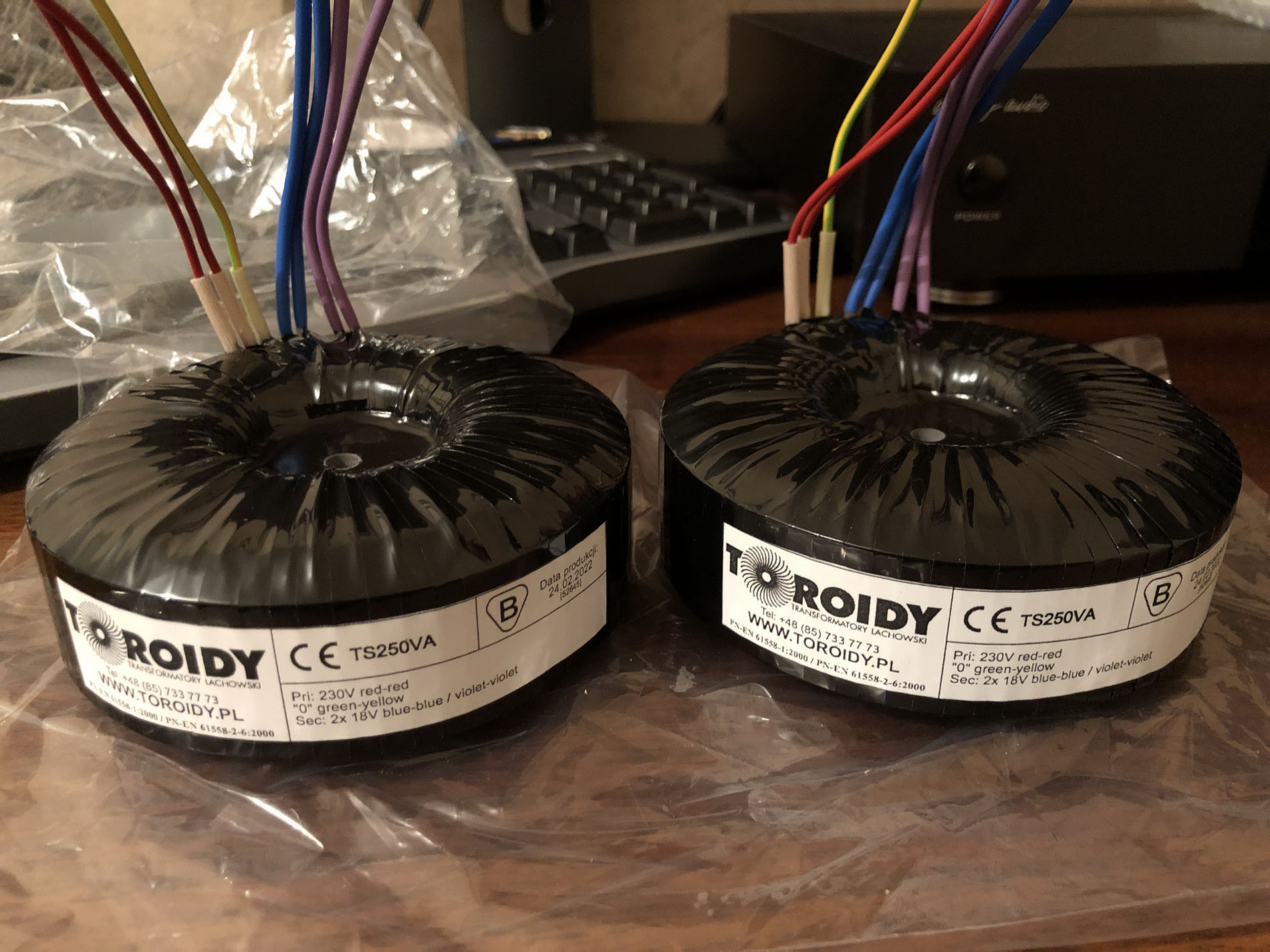

I mailed Toroidy about transformer temperatures:
” Hello, how high temperature is highest recomended/safe to run the Toroidy transformer? What temperature leads to faliure?
In my class A amplifier the transformer reaches 65C after 48 hours on time. Is that way to high, should i add more cooling vents? It is a 300VA transformer and i am pulling 190W continous power from the 230V grid. ”
They answered:
” Dear Jonas.
Normal operating temperature is up to 70*C.
Temperature above 90*C may lead to failure.
Best Regards / Serdecznie pozdrawiam,
Tomasz Lachowski ”

10 Hour warmup🙂
Both channels driven.
27C ambient besides the Aleph J on the stereo/Dolby Atmos bench. Since 7 other channels, besides the Aleph is warming the room 🤗
And More channels on the build!
53,4C at the warmest part of the heatsinks.
59,9C at the transformer. I am at this point not even the slightest worried about the temps. 🤘🙂🔥

Note the added ❄️ventilation❄️ holes around the transformer:

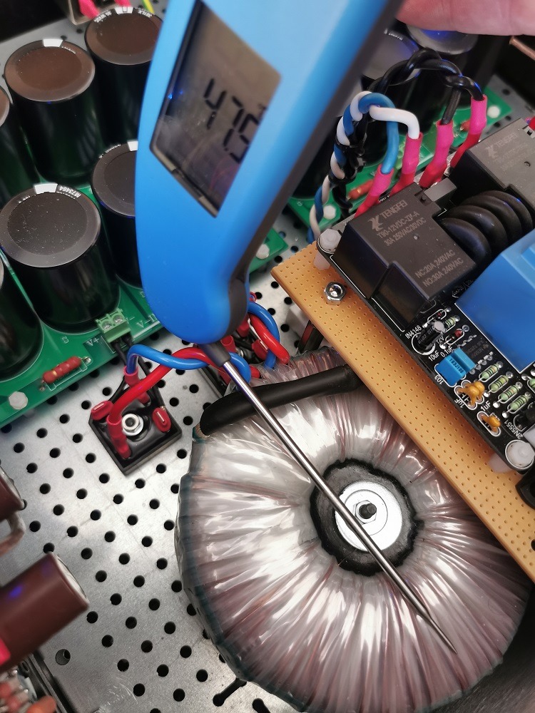

Another one singing.
I add a picture of transformer temperature for compare (4 hours in closed 4U/400mm) . Those are 300VA donuts from local manufacturer. They are wind on the bigger core as " audio" feature.
Amp is dead quiet.

Looking great! Only 47,5C - thats chilled tranformers. So. Time to Let the good times roll, and play some music! 🙂
