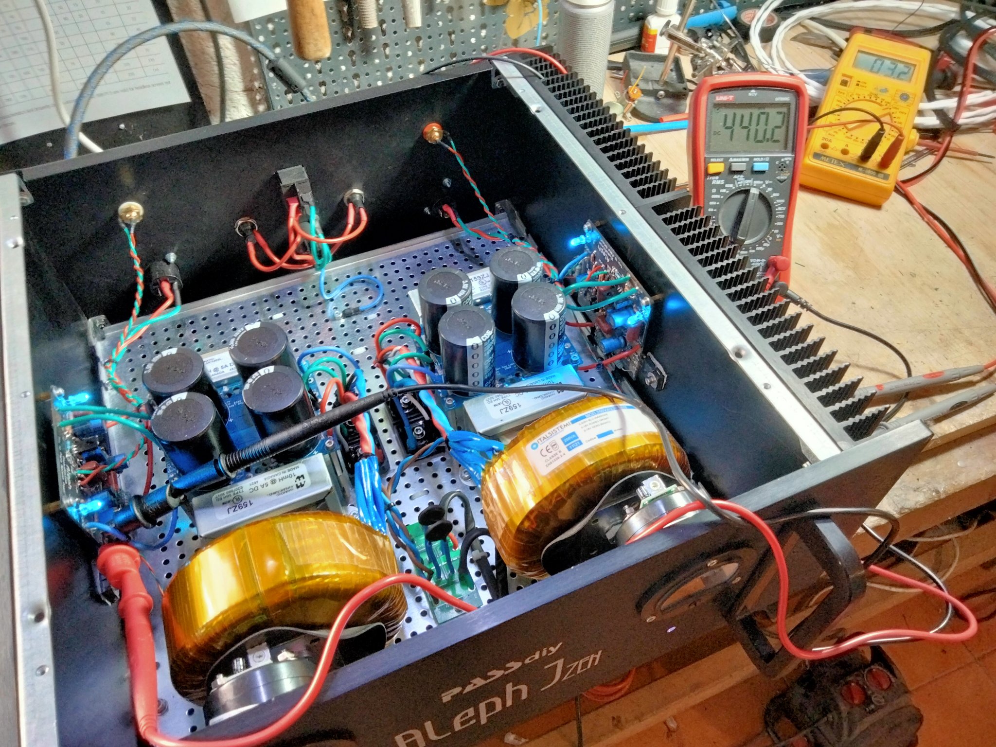

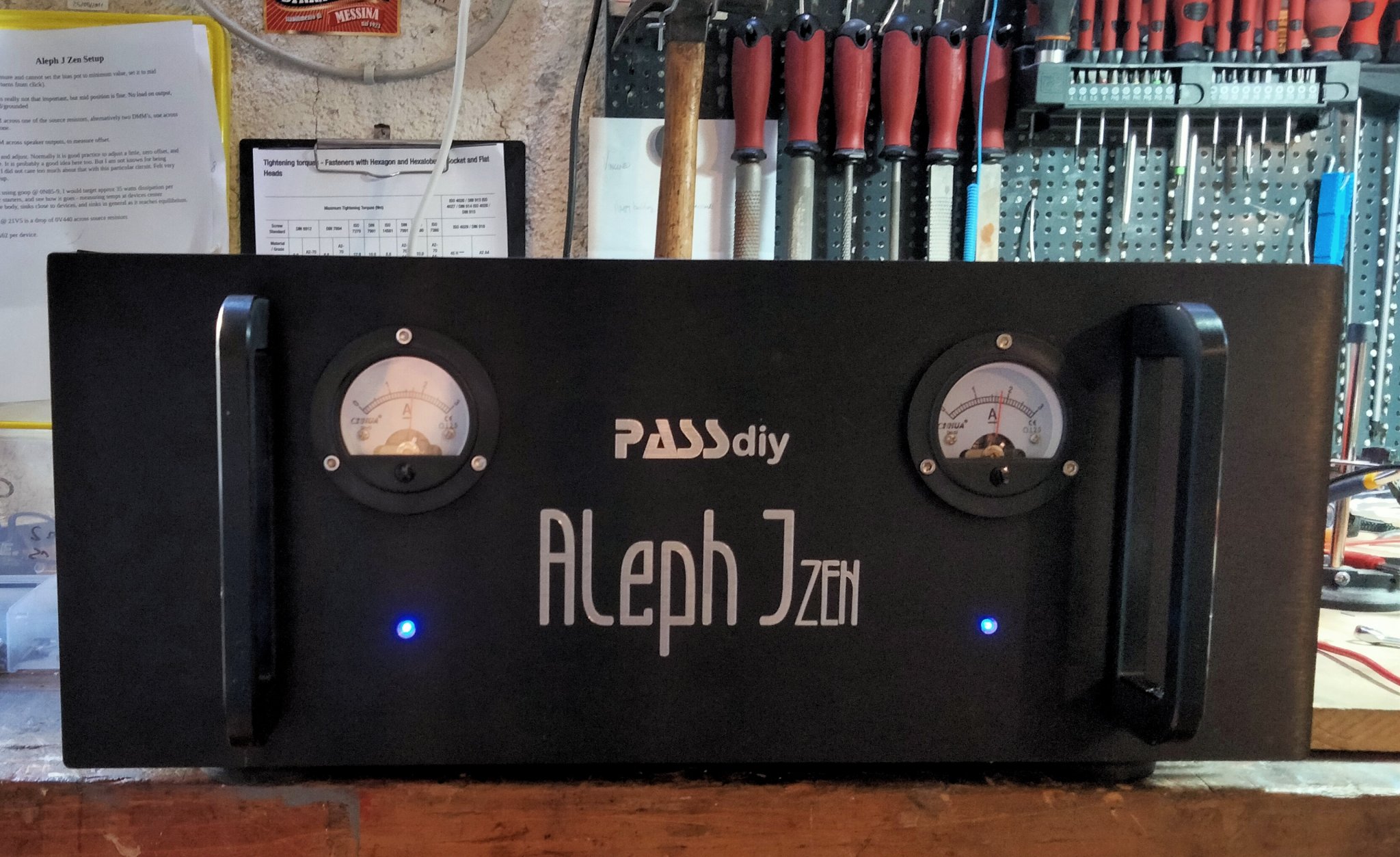

What is sink temp right by the MOSFETs? Sink temp on top of sinks?View attachment 1029094
Instruments work perfectly 🙂
Time to fine-tune...
As heatsinks are in the lower part of right temp scale, should I try to go higher with Iq?
most important: what is the temp of the MOSFET cases, and and middle pin of the fets?
These readings will enable an assessment of heat transfer. Also, what is the current Iq? Drop 0v44? If so @ 23v5 rails an 1A6 Iq, each fet is dissipating 38 watts, not using Keratherm. Enough, most would say. And also: you sure you need more current? If speakers are happy, keeping amp in happyland before summers 50 degrees on sicily might be the best choice.

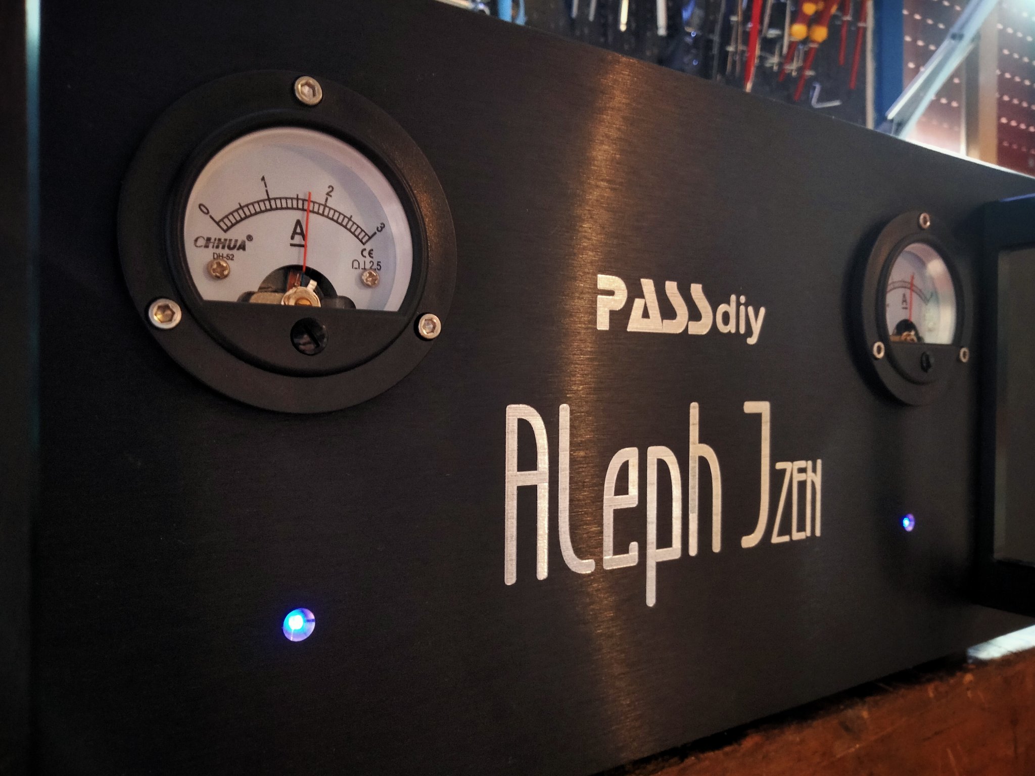

Beautifully done! I love the amp gauges and front engraving, gels very nicely together.View attachment 1029094

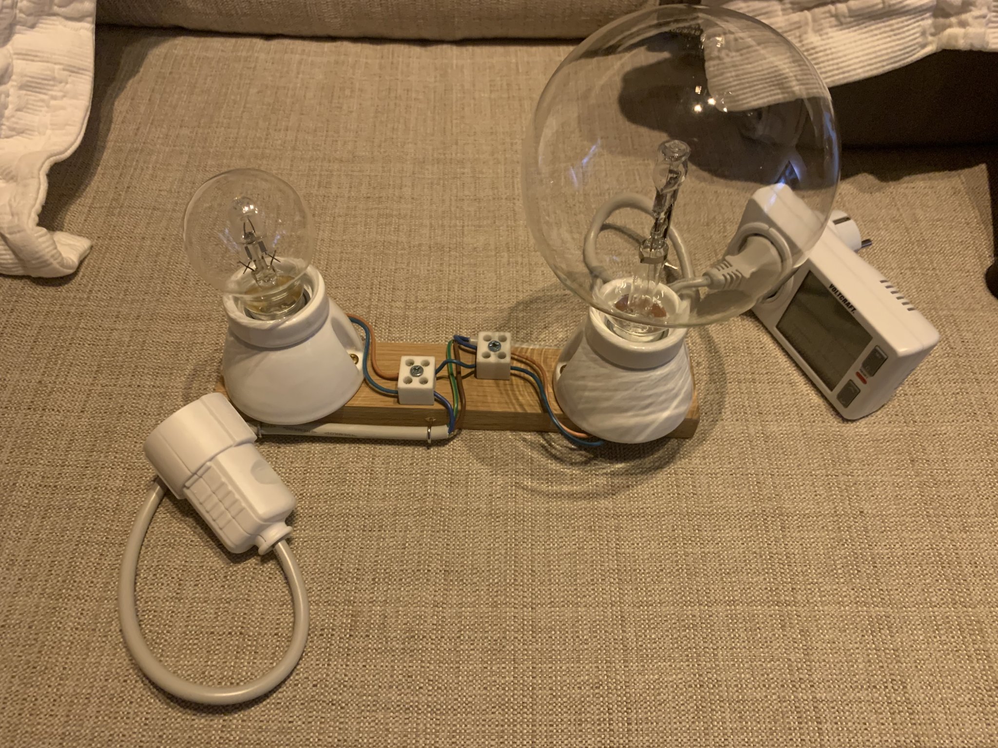

The newly built light bulb tester. 70W + 30W halogen lamps. Classic 100W oldschool lamps is verboten unobtanium in my parts of the ”enviromental” friendly universe.
Well, im thinking watts is watts, and i really like the smell of halogen in the morning 😁👍
So. Well. If im thinking wrong. Just tell me 🙂

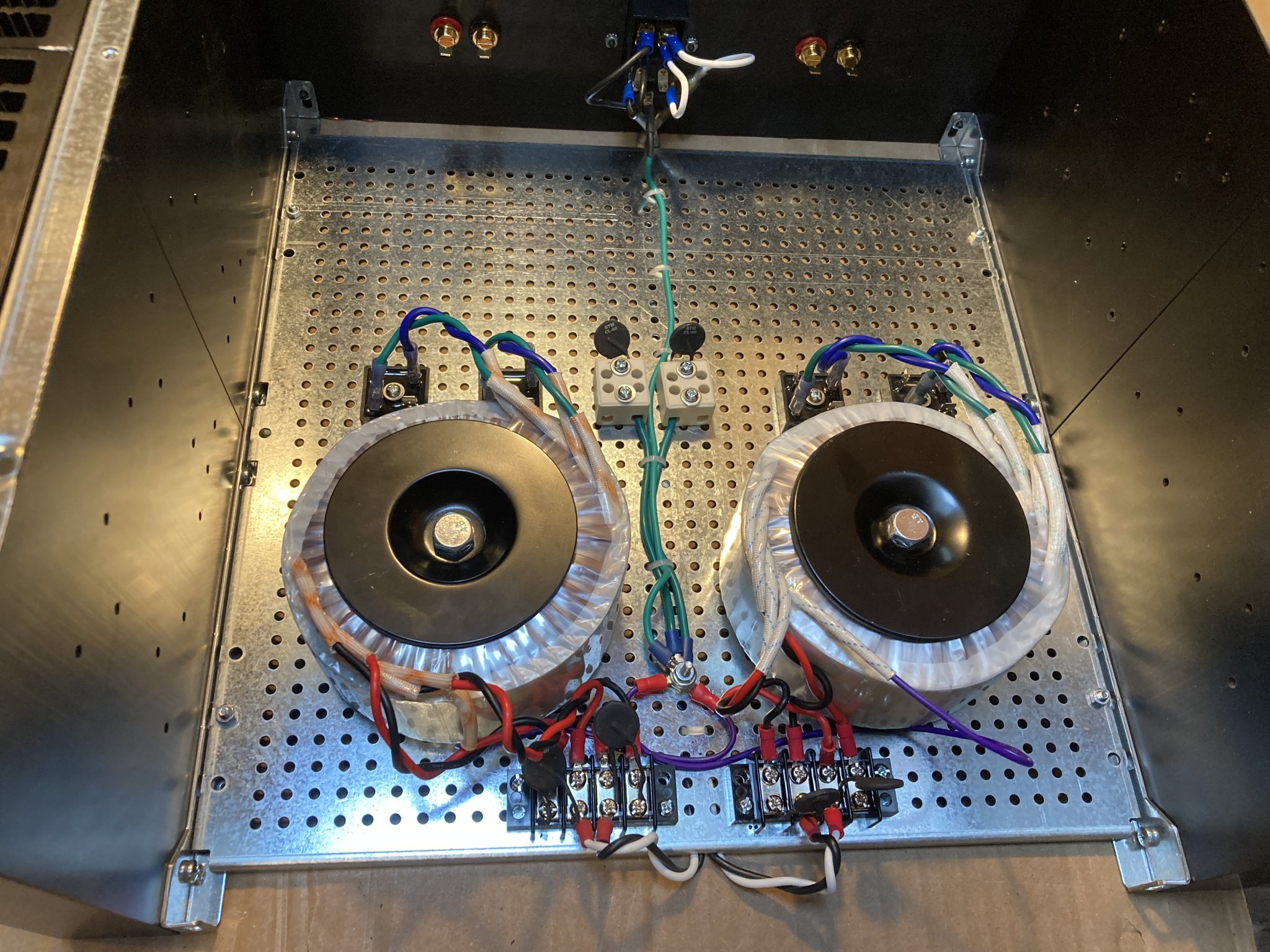

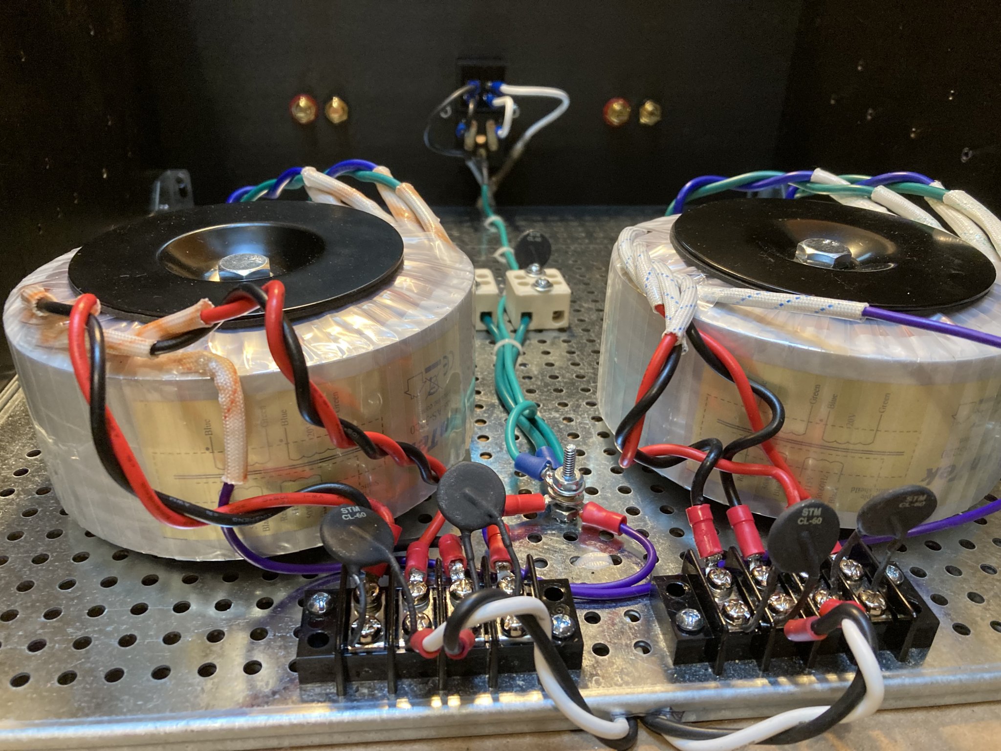

New Builder here. Here are a couple of pictures of progress. This is as far as I can get without PCBs. Take a look and let me know if there are obvious errors or poor technique. The IEC is missing an inrush capacitor and a 3.3nf safety capacitor. I'm following Octopus technicus' chassis schematic (post 7711 from October 3, 2021.
Looking good. A few comments. I’d move the bridges as close to center as possible. Remember goop under them, and tighten to 2nM-ish. No need for inrush NTC @ IEC, allready in place at connection blocks. Trannies could be closer to center. Remember to file off the anodization @ your chassis gnd points.New Builder here. Here are a couple of pictures of progress. This is as far as I can get without PCBs. Take a look and let me know if there are obvious errors or poor technique. The IEC is missing an inrush capacitor and a 3.3nf safety capacitor. I'm following Octopus technicus' chassis schematic (post 7711 from October 3, 2021.
also, the right trannies secondaries pass right by the future location of your PCB. Put them on the center side of the tranny 🙂
Thanks Andynor. I'll probably get after these changes today. I don't know the nomenclature for "2nM-ish". Is that kind rule of a rule of thumb torque value? And what kind of goop is goop? Heat transfer paste? Also, I think I have just one more part to source and that is the the c2, c3 caps (220uf 35v 20% audio SILMIC II). For some reason I only bought 1 instead of 4 and now they seem to be out at Mouser and Digikey. I wasn't sure what subs to use since they either didn't specify "audio" and/or SILMIC II. I'm guessing that I'd want to get 4 of the exact same caps rather than mix with the one I already have?
2 Newton meters (should have bern Nm and not nM) of torque. Or just wing it, and tighten it lightly till it stops, and then a bit more. Remember split washer. Goop, yes, thermal paste. They get hot and can break over time. But details, it’ll probably survive anyways. But if you are a bit OCD, these details help sleep.Thanks Andynor. I'll probably get after these changes today. I don't know the nomenclature for "2nM-ish". Is that kind rule of a rule of thumb torque value? And what kind of goop is goop? Heat transfer paste? Also, I think I have just one more part to source and that is the the c2, c3 caps (220uf 35v 20% audio SILMIC II). For some reason I only bought 1 instead of 4 and now they seem to be out at Mouser and Digikey. I wasn't sure what subs to use since they either didn't specify "audio" and/or SILMIC II. I'm guessing that I'd want to get 4 of the exact same caps rather than mix with the one I already have?
Nichicon Muse or Gold audio grade are fine replacements. But check octoparts.com. It’s like the Google of audio parts.
no worry in running higher voltage rated caps either. 35v is recommended minimum. You can also use 50 or 60v caps. I would personally not worry about using 25v either, my PSU caps are 25v and I sleep well, despite notoriuos OCD (no pun, biggie).
and yes, sure 4 alike caps. They are el cheapo anywz.
