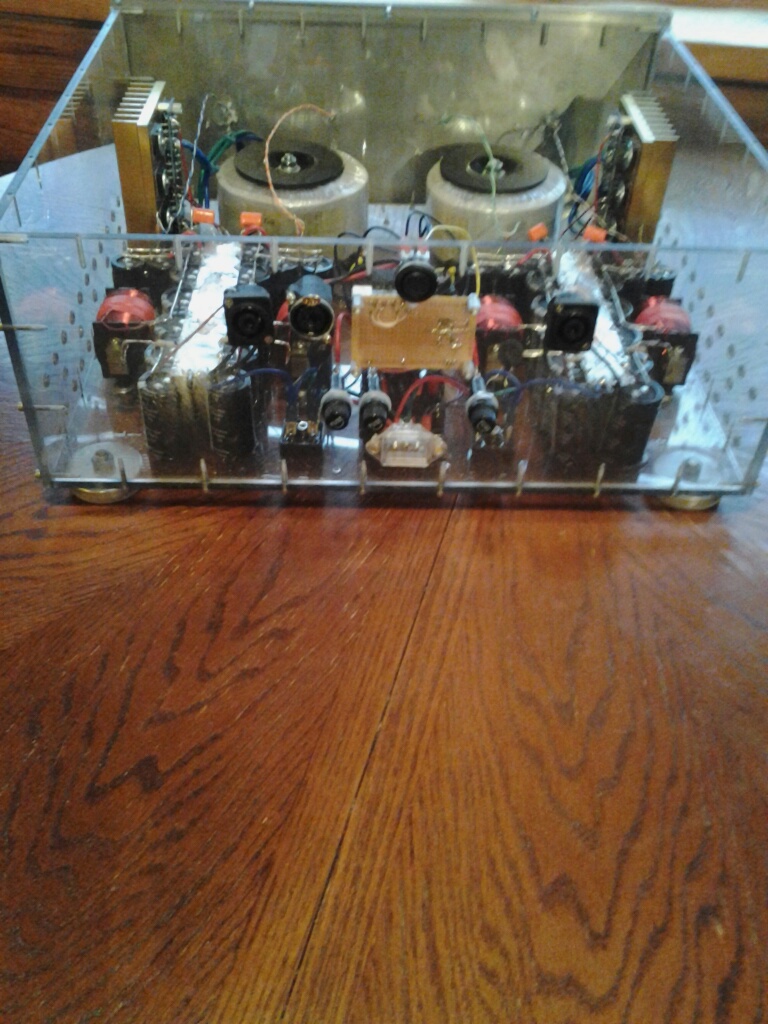

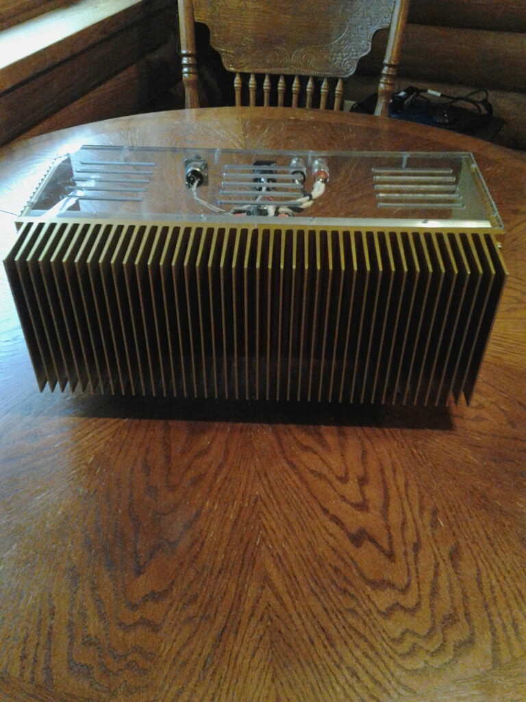

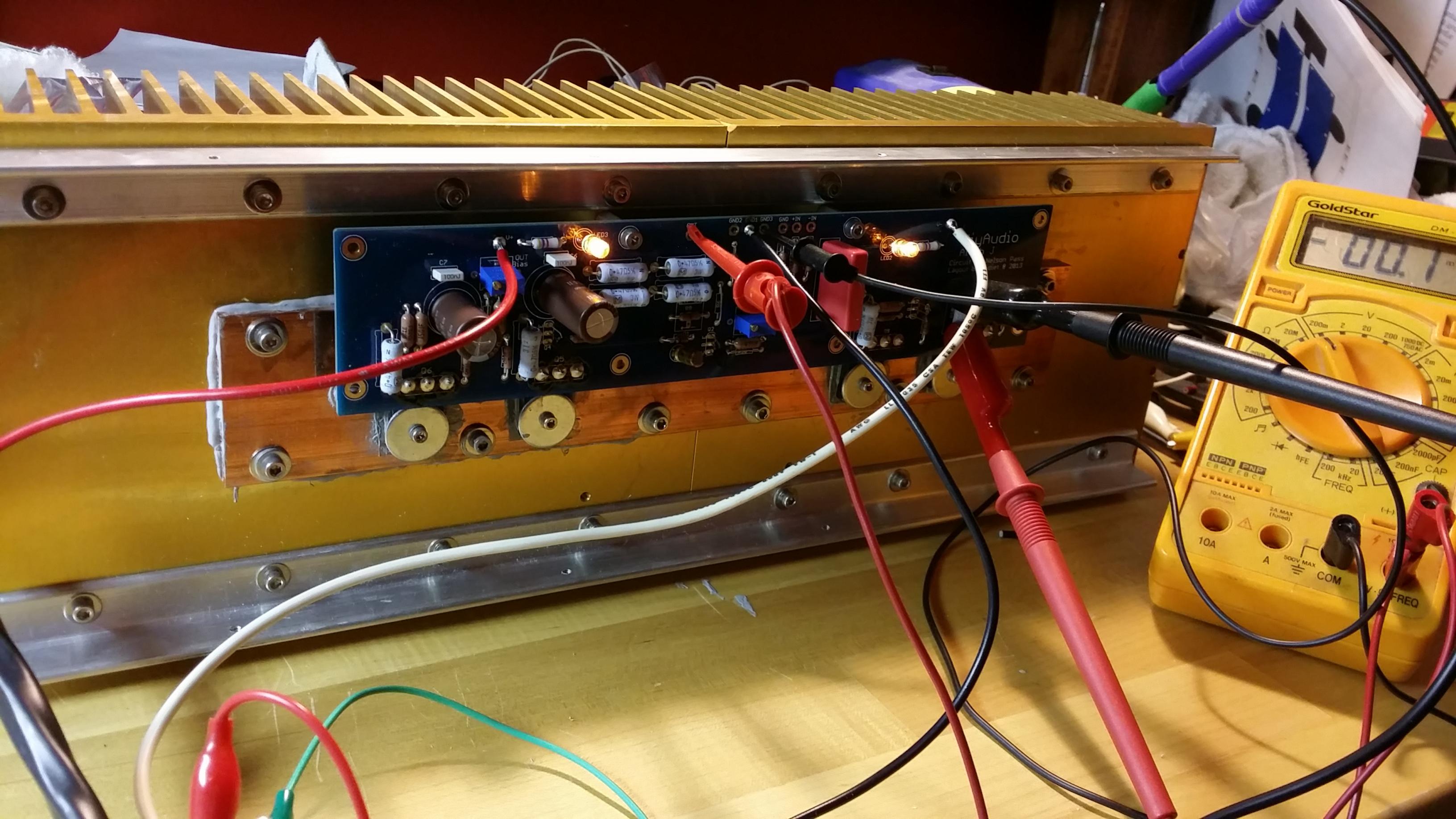

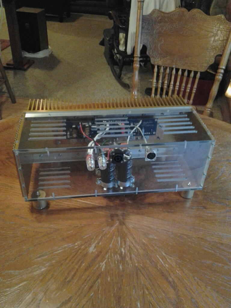

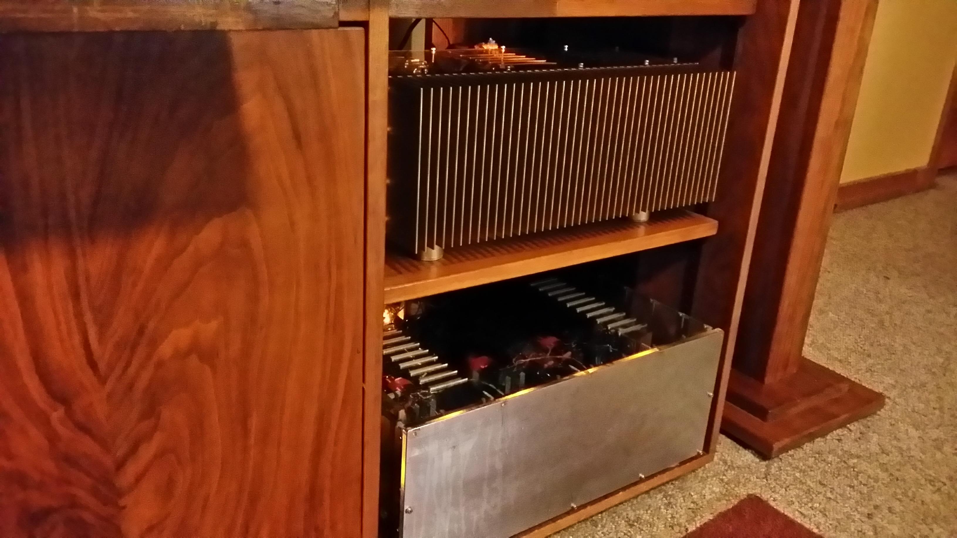

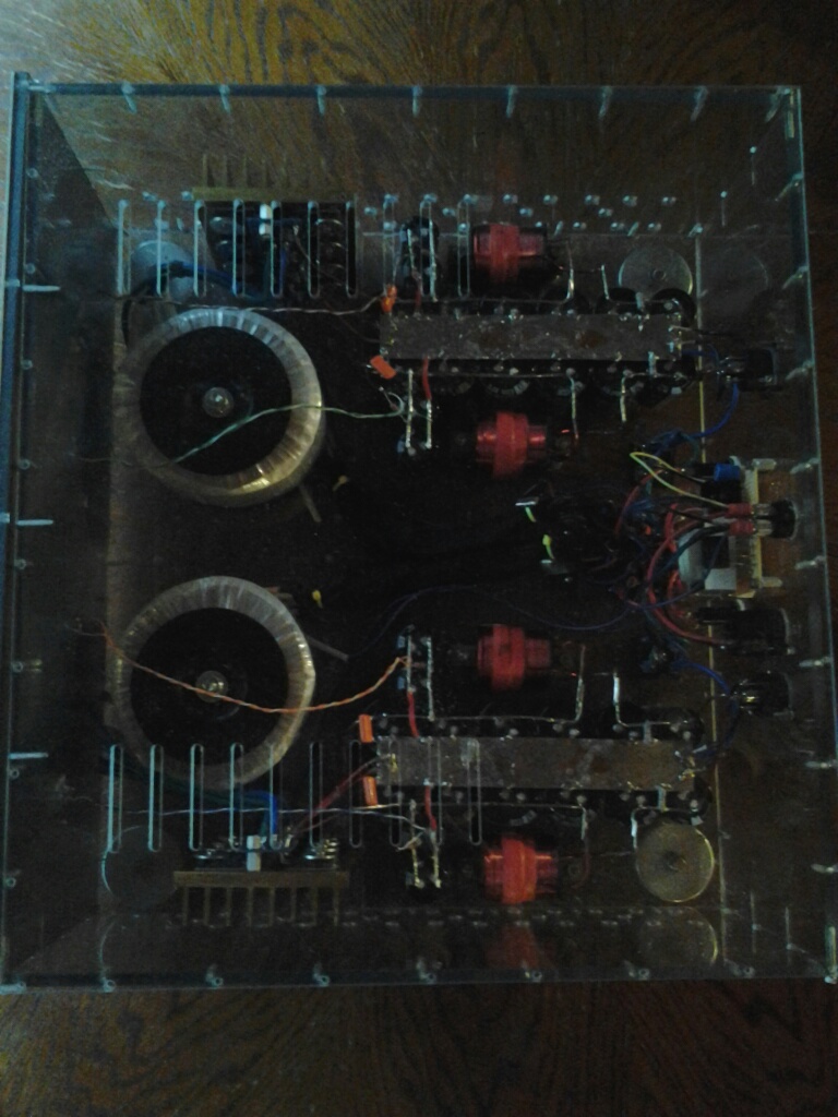

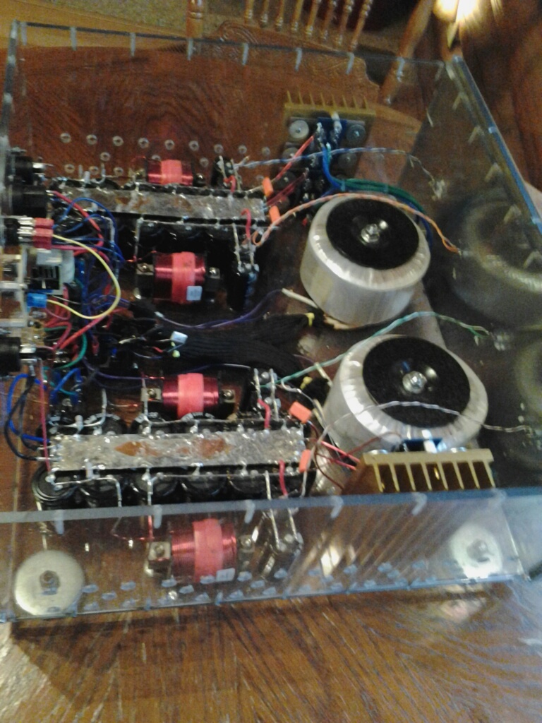

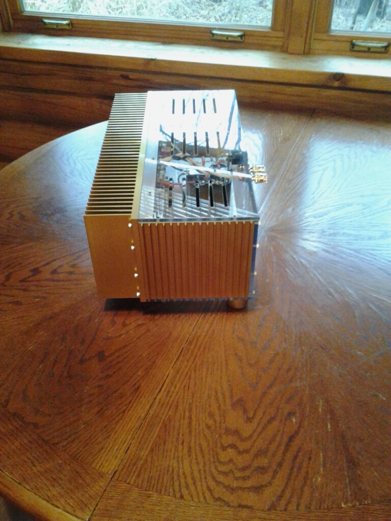

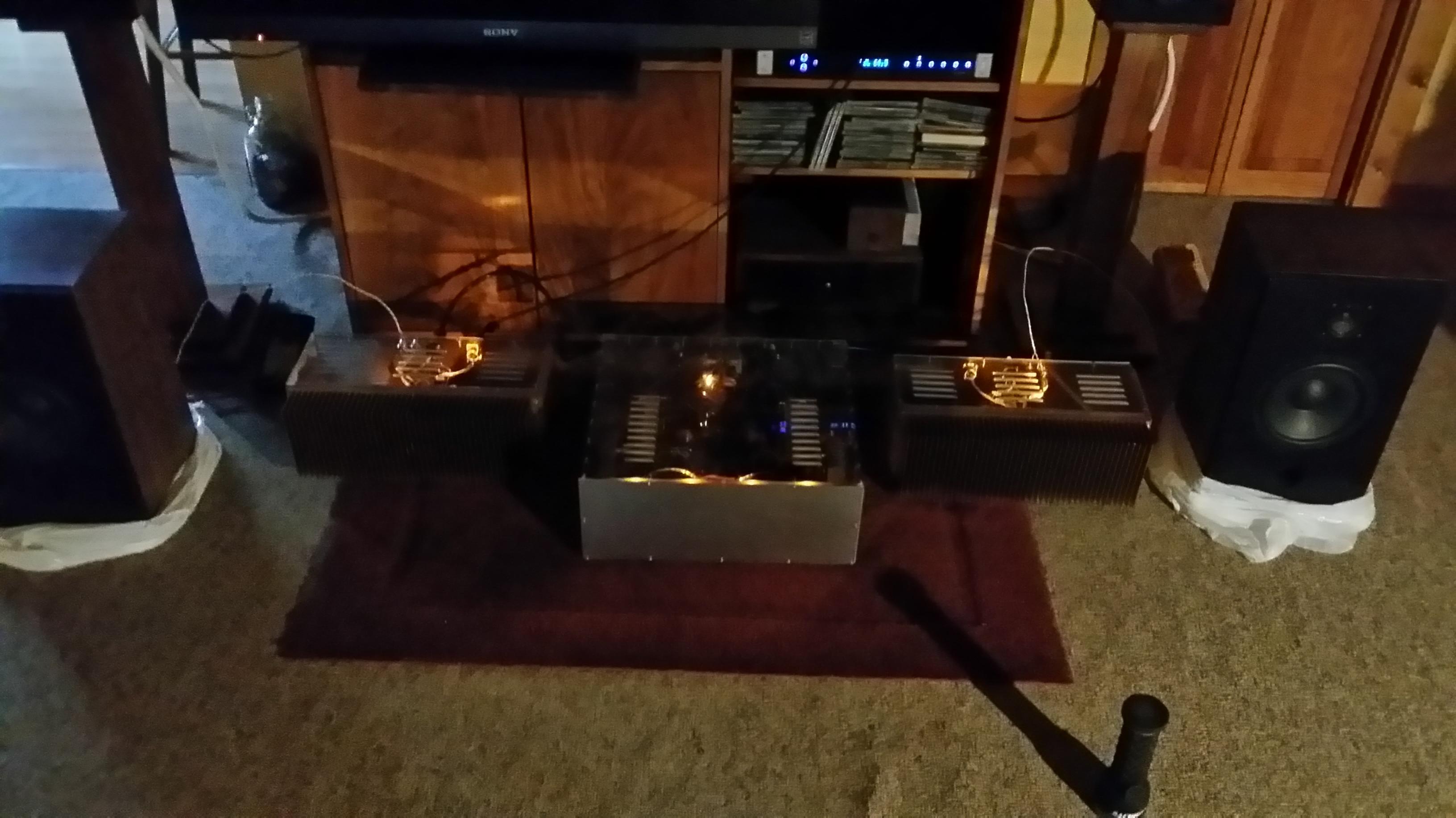

I finally finished my Aleph J. After I heard that Buzzforb did a PS in one enclosure to 2 separate mono amps, I knew that was the way I wanted to go. Mainly the enclosures are made from 0.25" polycarbonate. The PS is dual mono with 2 Antek 300VA transformers. The AC in for each channel goes through a Omron relay with a 12V coil. I can turn it on with the DPDT switch either using the onboard homemade 12VDC supply or wth the 12v out of another piece of equipment. The heatsinks for the rectifiers are HeatsinkUSA 3.5". Each rail of each channel has CLC with 84,000uF before the 3.7mH choke and 86,000uF after the choke, with 56,000uF of that being in the amp enclosure to get it close to the amp board. I do not think 170,000uF is too much. The DC goes through a Neutrik connector to each amp.
The heatsinks on the amp are 2 HeatsinkUSA 10.08 cut to 18" wide. The machine work was done by their local shop. I can give the pdf files of the drawings to anyone who asks me. The sides are their 6" low profile. I got them gold anodized in Indianapolis. I really like that gold color. With a copper heat spreader, I adjusted the bias to 0.55V and they were about 46deg C in the open. They are about 49 deg C closed up. I tried them out on the floor first to make sure they worked before mounting them. They are dead quiet with no turn on thump and no turn off thump. I really like the looks in the evening with the amber LED's glowing. Oh, in case any one wants to know, they sound wonderful. I am still getting used to the great sound. Many thanks to Nelson, 6L6, and the others who drew up the boards and gave advice.

For those worried about needing a soft-start on the AJ...I basically used Nelson's PS circuit for the F5 using a CL60. With all the caps that I used, the CL60 works just fine as a soft start.
After my AJ has broken in, the sound is superb (yes, transparent) and I think it has good bass to a 8ohm speaker, especially for a SE amp. The bass is not quite up to a huge powerhouse push-pull with lower output impedance that can drive 4 ohms at full power, but I like the AJ better everywhere else. Besides, my plan all along is to allow the AJ do what it does best and put a 2nd order high pass filter at 80 Hz to it (probably make it from j-fets, is there a post with a circuit already?) which will make it a 4th order at my sealed speakers. I will mate it all with a subwoofer with a 4th order low pass input.
