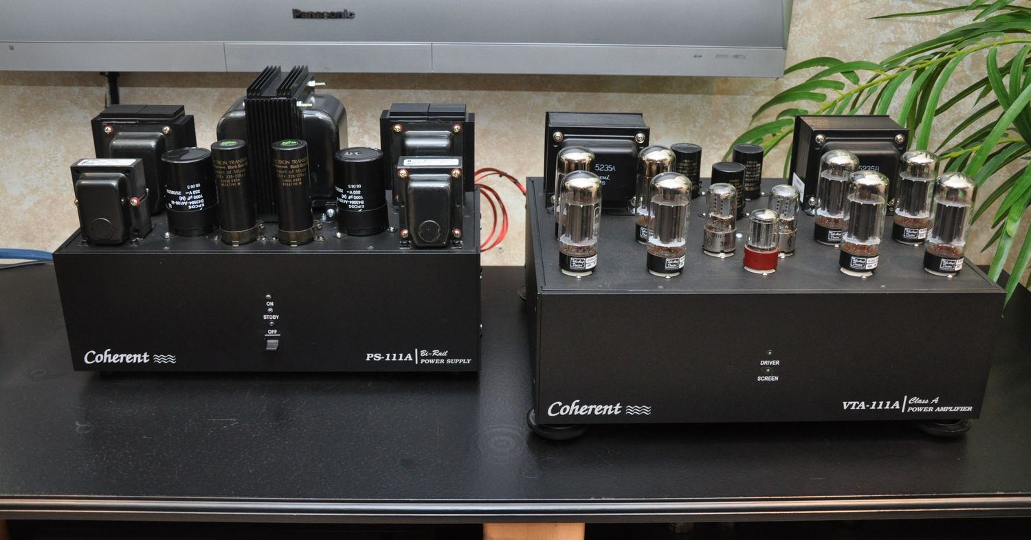

Find attached a picture of one of the amplifier pairs (each has separate power supply) At some point I'll get a full build description, schematics, etc and more pictures on my website...when I get that up and running, hopefully in the next few weeks.
