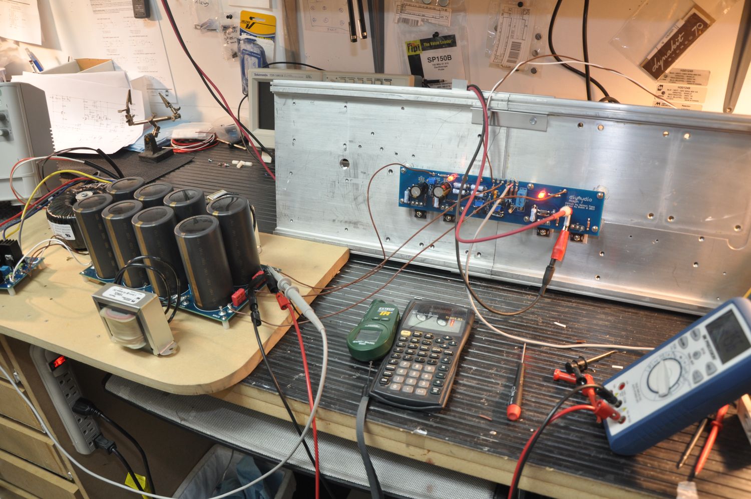

Hoping one of the resident AlephJ experts can help me on this one.
Attached is a picture of my test setup. Not seen is my HP8903B analyzer. It self tests at 0.004% or lower from 20Hz to 100KHz, so it's working fine.
Voltage on rails = +/-27.2V loaded
Load = 8ohms (250W Arcol non-inductive resistor)
Voffset at 0V
Vbias at 400mV (initial)
Voltage across R6(560 ohms) is 4.5V
All IRFP240's matched from same lot. Vgs across all devices operating 4.37V
The "test" heatsink's temperature is about 45C.
Applying a 1KHz signal of 1V RMS results in an output just under 10V (9.62VRMS) about 12W, seems about right -19.6dB gain.
However, distortion is 0.15% at this low level. At 10KHz, it goes to 0.2%. At 20KHz, it's at 0.42%
When I bring the input to 1.4V output just under 14V, about 23W. Distortion at this point is 0.22%. I didn't bother checking the higher frequencies.
Looking at the FFT of the output, the 3rd harmonic is responsible for most of the distortion at higher power, and especially at anything over 3KHz.
I remove and short the input, and readjust bias for 500mV across source resistor. Reapplying signals as above, the distortion at 1V input is still too high, at 0.08%.
The power supply is clean. At no signal input, the ripple is just 40mV. The input 2SJ74BL pair is matched at Idss = 8.2mA.
As I'm using single ended input, I've shorted the input "-" to ground. Using a shielded cable.
Any suggestions...ideas...would be helpful and appreciated.

Still not sure what you are asking, your distortions measurements seem really quite good...
Thanks for asking.
As I mentioned to Dennis in a previous post, my screw-up, I didn't read the manual on the Aleph J, so it's come as a bit of a "cold water in the face" reality check.
In your build guide, I missed the little snippet regarding the power level you used in your 0.045% result at 1KHz (1 watt)
I was hoping to get something at least 20W or more with this build at reasonable distortion. "Reasonable" distortion is ideally all second order (as my tube amps have) But right now, I'm concerned about the third order harmonic overpowering the second at any power level over about 15W output.
Will this be a concern? Maybe not as I was planning on building a pair to bi-amp my 803D's. They are only 90dB efficient. With bi-amping, and at reasonable power levels, perhaps I'll never hear that 3rd harmonic wiping out the 2nd...
All amps have rising third with rising power levels...
Build the amp. Listen to it. You will love it. 🙂
