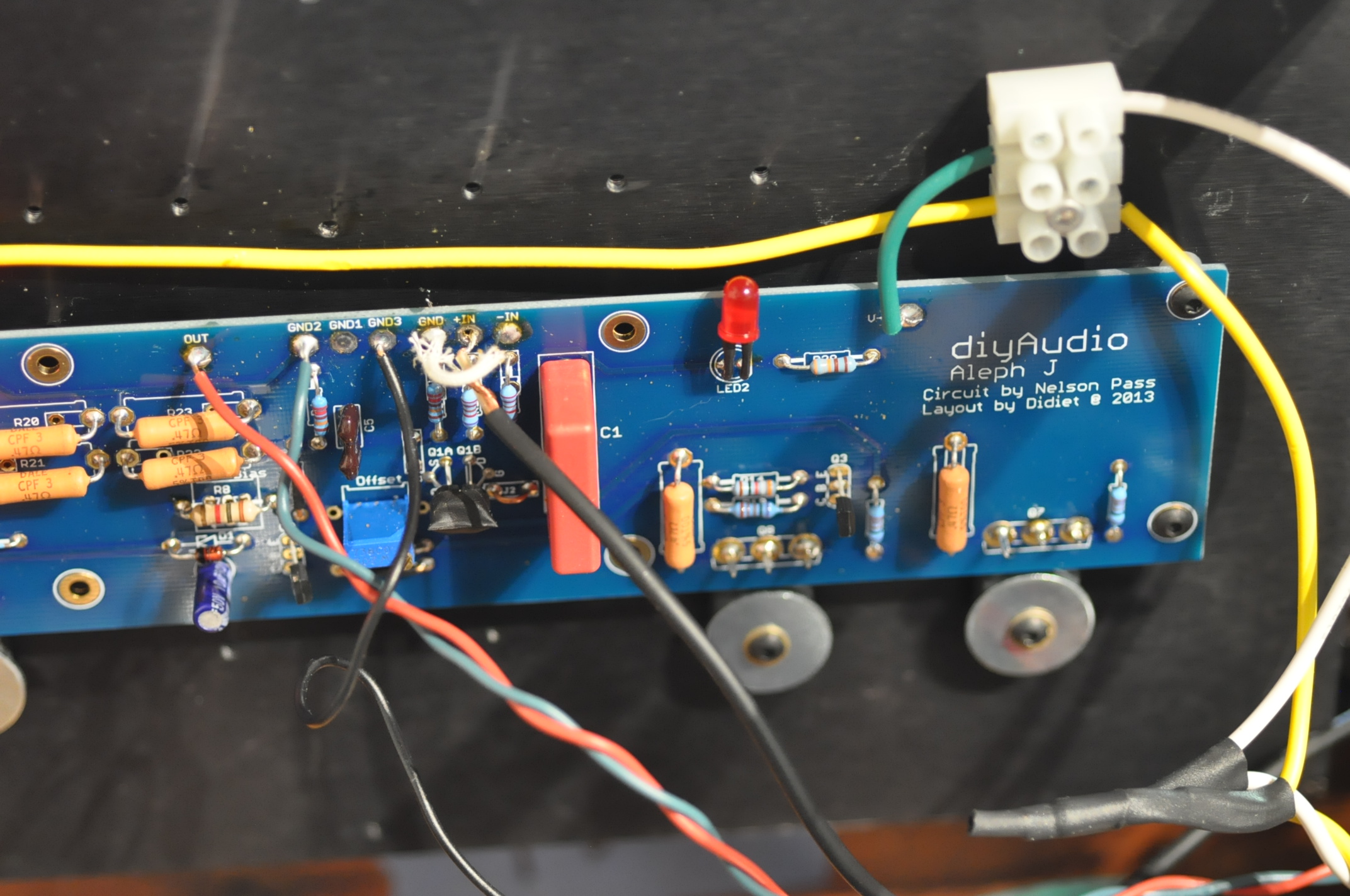

I'm pleased to report that Extreme_Boky's suggestion led to resolution of the gain issue. I had in fact placed the wrong resistors in R1, R3 and R4. I guess I didn't pay sufficient attention to the designations "221K" vs "22K1". In any event, all is sorted now and the Aleph J is performing beautifully.
I'd like to express my gratitude to Extreme_Boky, Dennis Hui and Zen Mod for taking the time to respond to my post, and sharing your understanding of electronics and the Aleph J circuitry. While I'm at it, thanks also to 6L6 and flohmann for the excellent build guides. And of course to Nelson Pass for making these designs available to the DIY community.

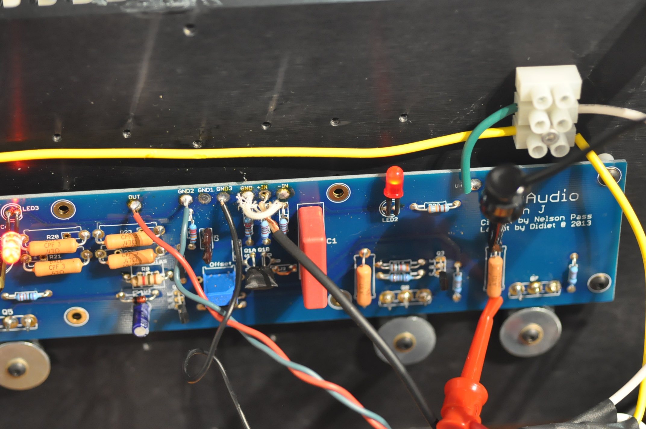

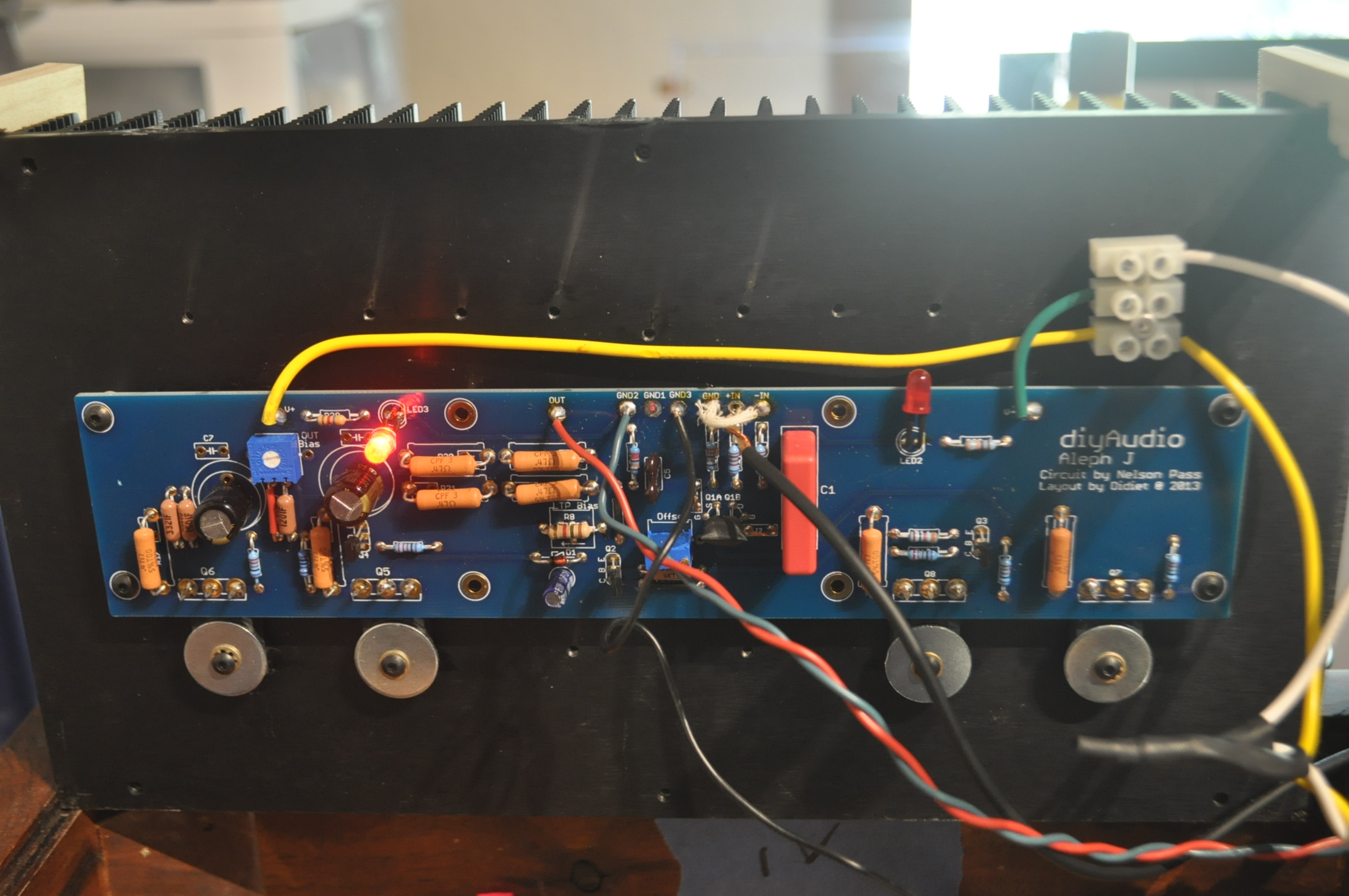

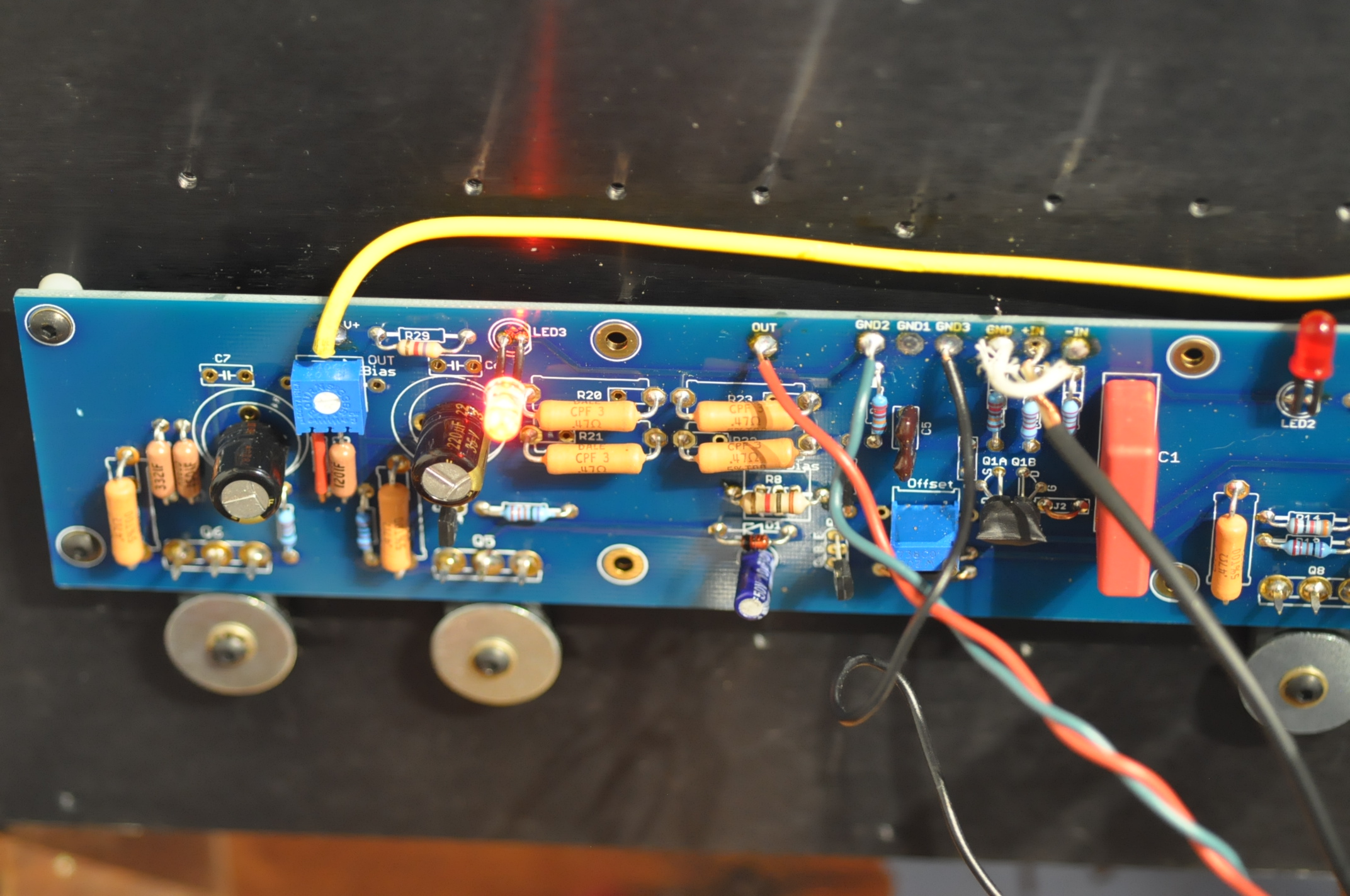

Non working LED's in backwards. I'll get the tripod out.
... I discovered that instead of 4k7 resistor for led voltage drop, I used 4M7 crazy thing is I took all those 4k7 resistors from the same bag, must have been some mixed up bag
On more than one occasion, I have received 220K resistors in a bag labelled 220R. Since I made this discovery, NOTHING goes into a PCB without being measured first.
