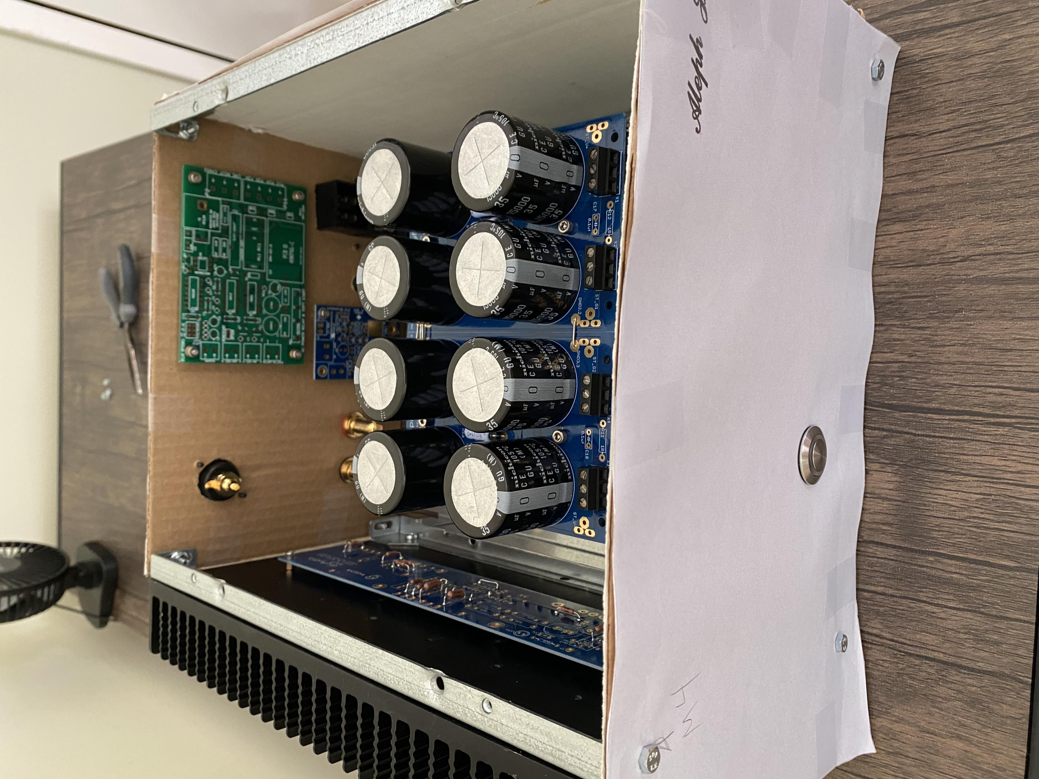

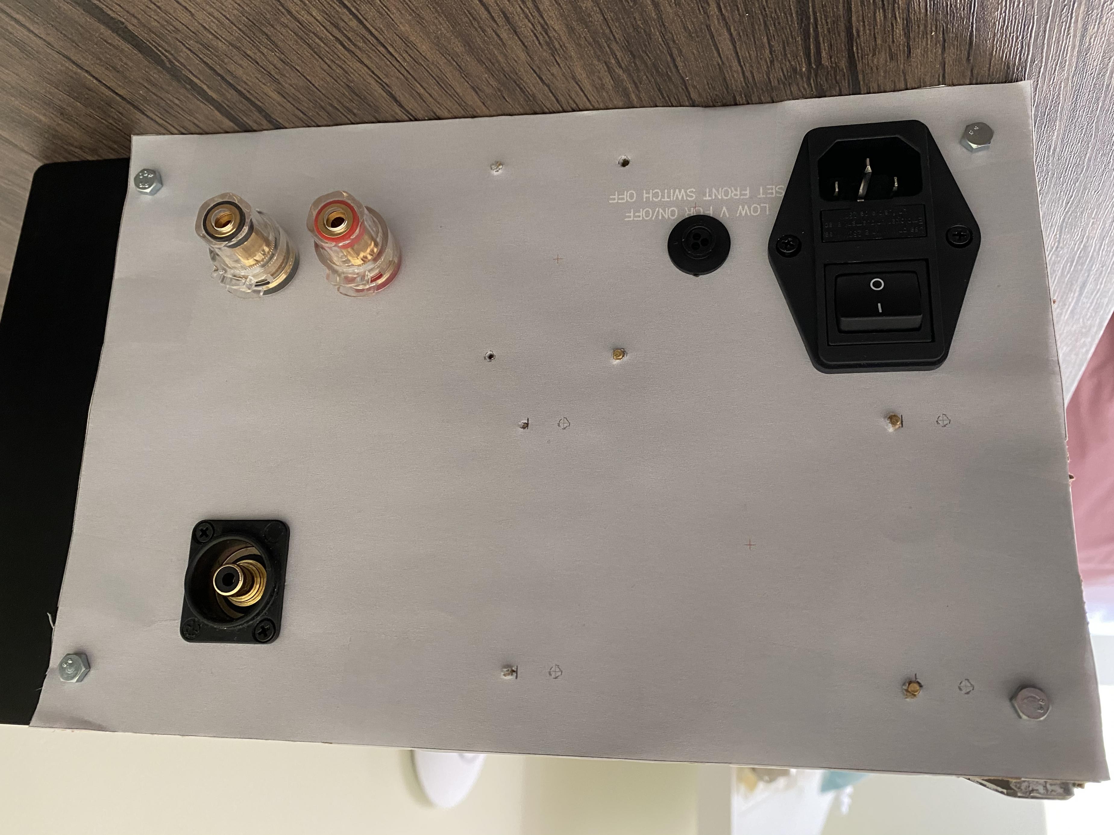

Revised layout
Putting both the Guardian 86 and the low voltage ac switch pcb on the back panel freed up some space. As you can see, I am trying to keep the pcb’s as far from the input jack as I can. Does this look okay? Would I be better off putting the Guardian pcb (that is the smaller one) between the input jack and the speaker posts?
Any thoughts would be appreciated. I am anxious to order the panels!
Thank you.
The pictures came out a little funny. The IEC jack is on the lower right hand side as seen from the front panel looking towards the back. The speaker posts are towards the bottom, the input jack towards the top.
Thank you.
