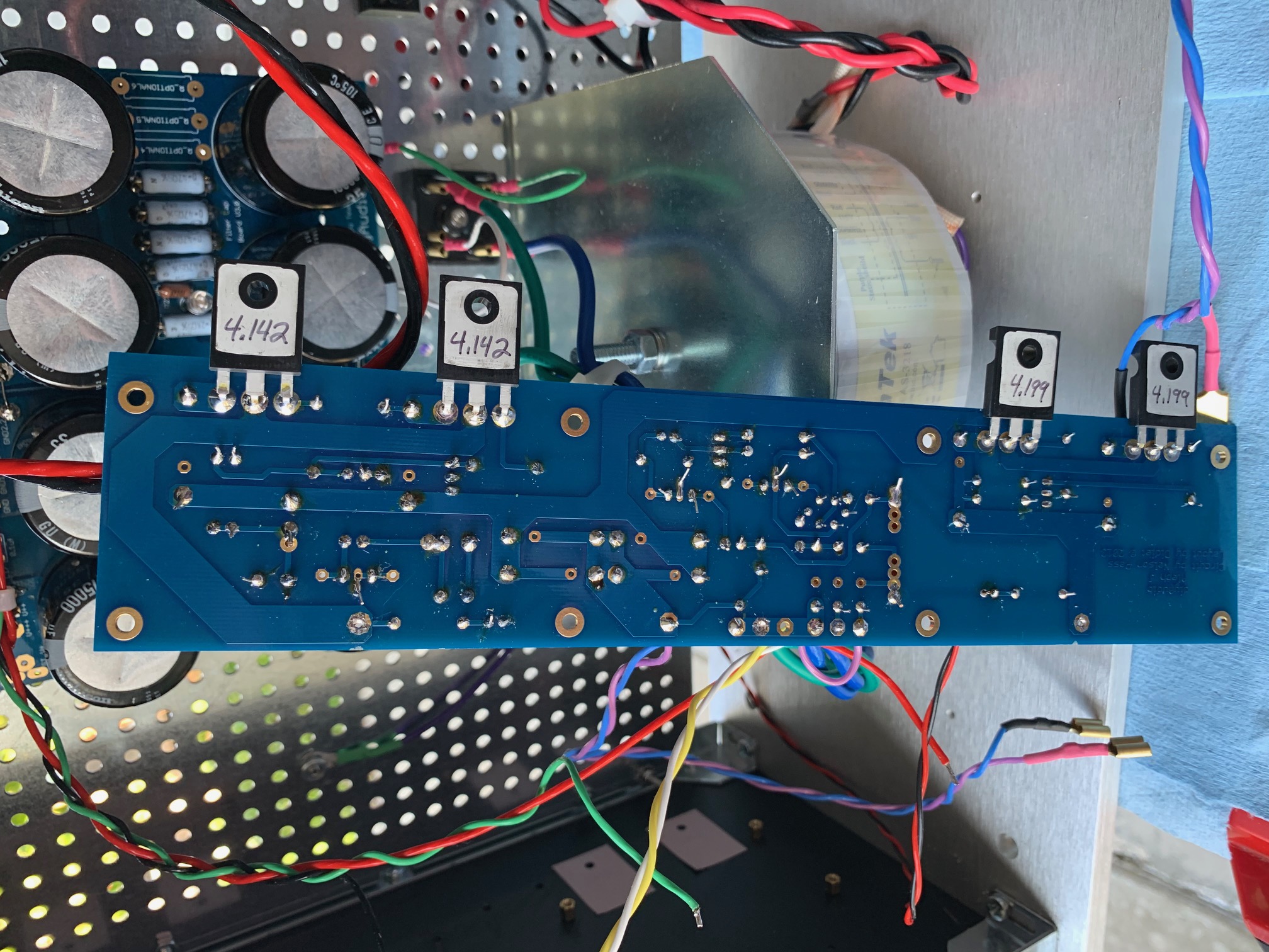

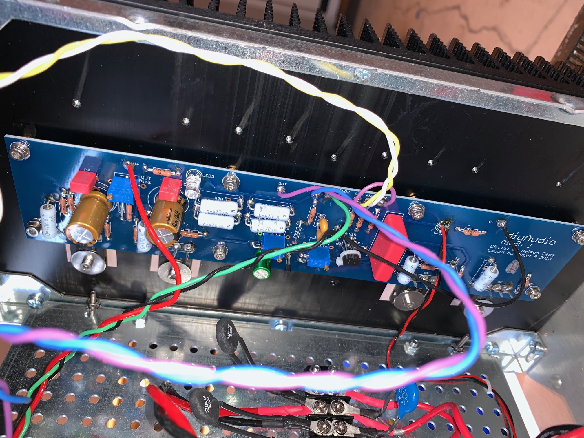

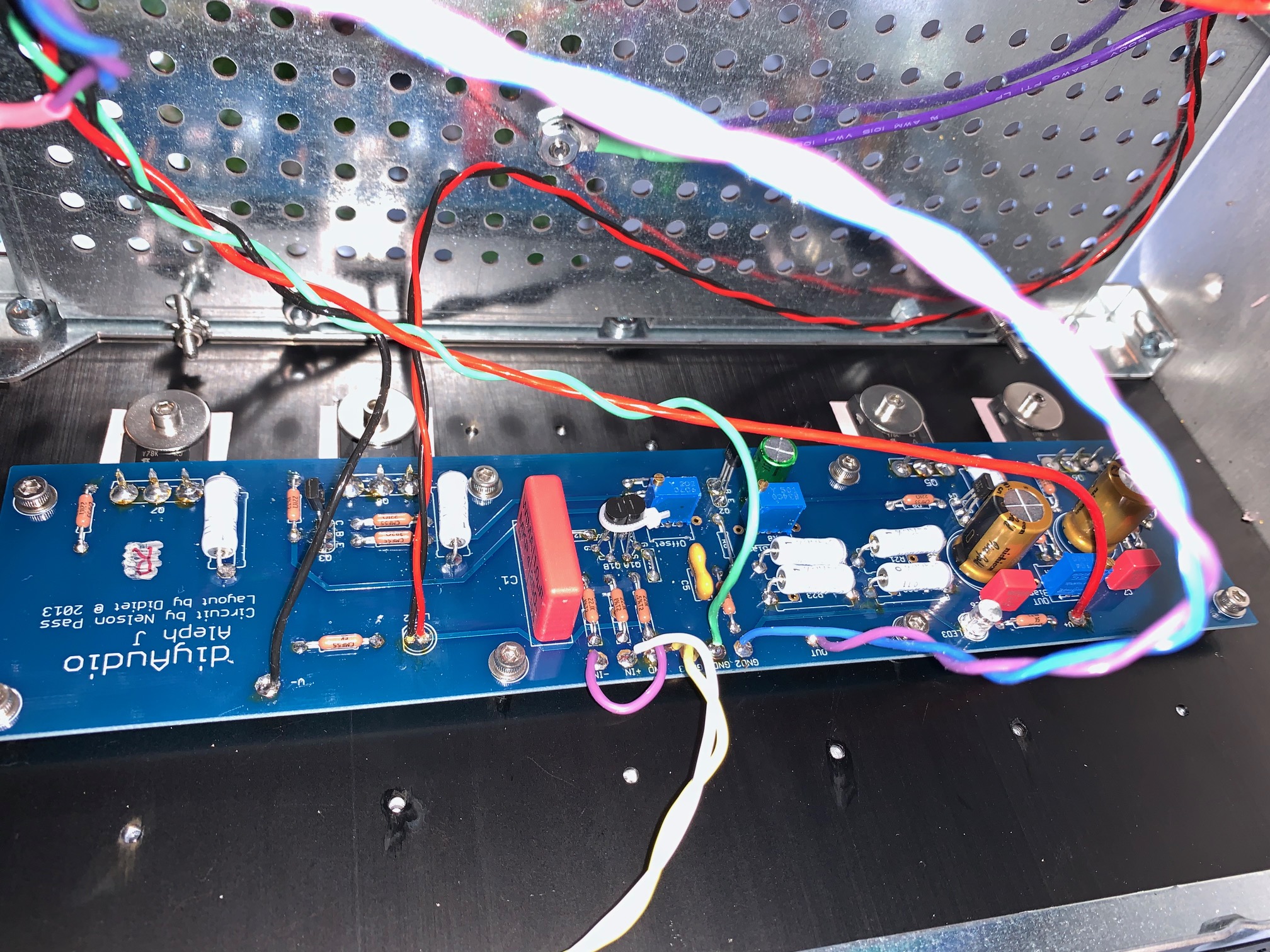

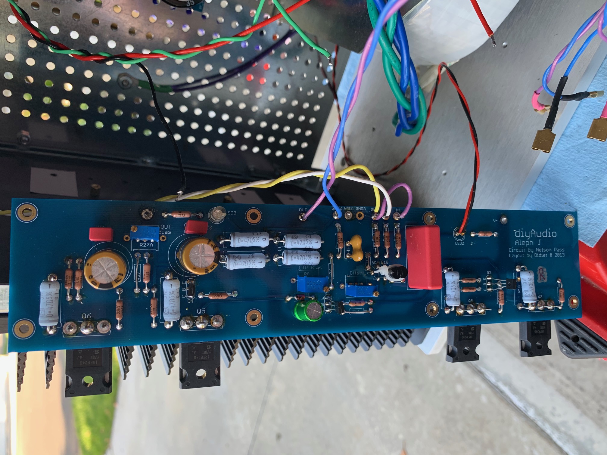

I was running this by Jim and he hinted (Jim, I hope that was a hint) that I post my problem here, so...
I'm having a similar problem to kpsthakur. I can adjust the offset on the good (left) side to 0. When I try to adjust the bad (right) side nothing happens and I have a static voltage of approximately -21.45 v. On the good board I can adjust the bias to 350 mv. On the bad side I can adjust the bias to 350 mv. So the problem appears to be related to the offset is some way.
I've checked the values of the parts and everything appears to have the correct orientation and location. Photos are attached. Any suggestions?

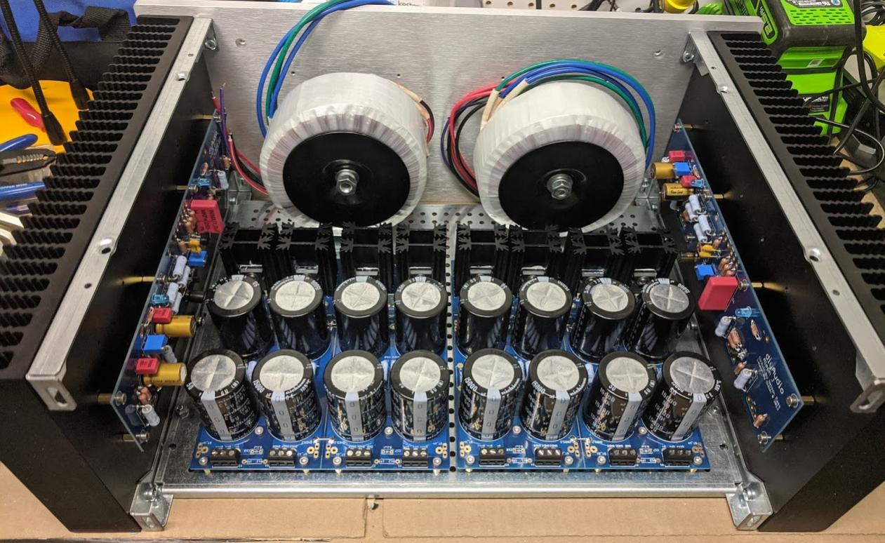

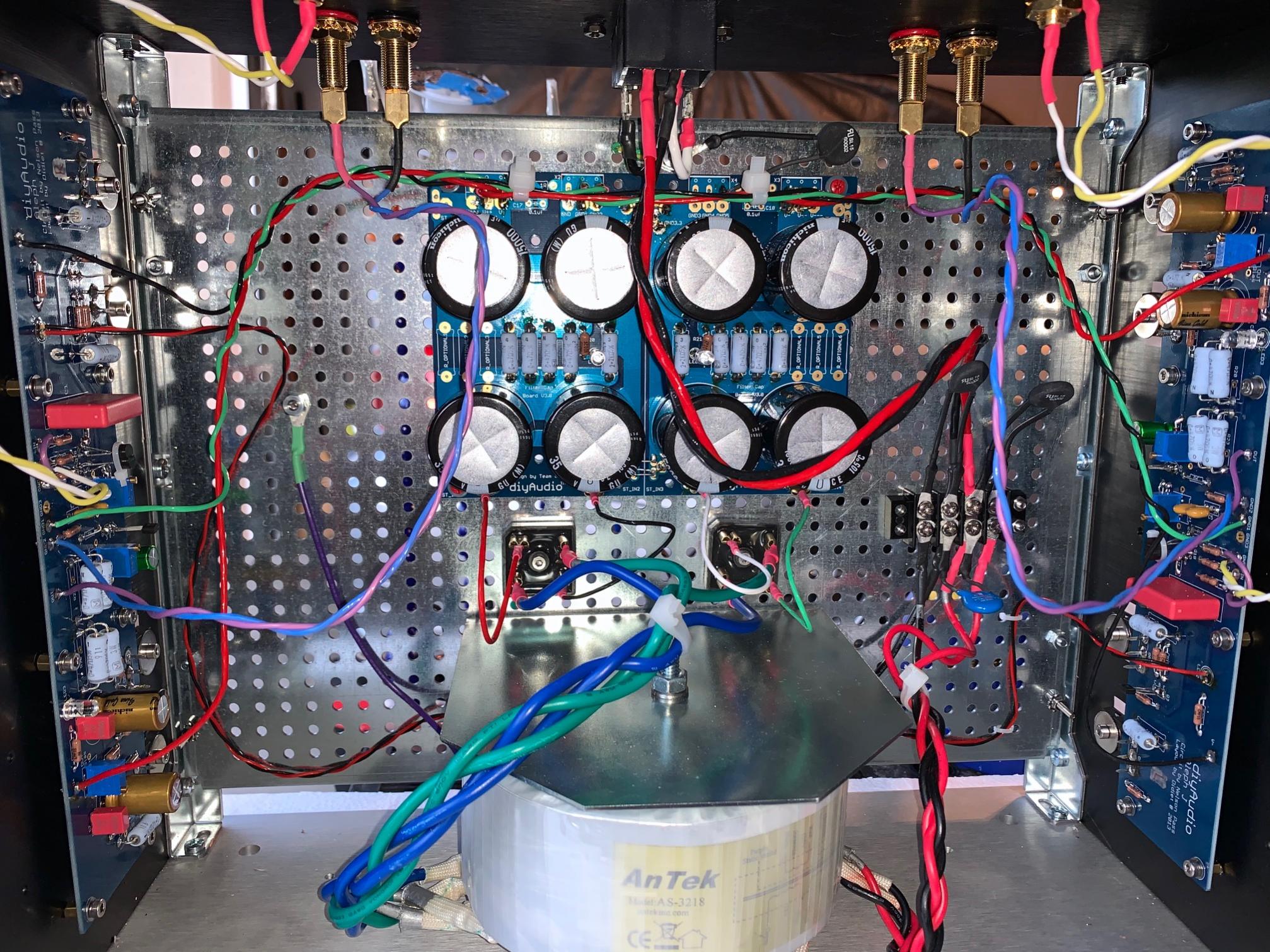

dual mono grounding
have seen different ways that people execute grounding on single chassis dual psu builds. Generally into two camps;
1. IEC earth, both PSU Grounds (w\ CL-60), and both transformer shields on one star
2. IEC earth, one PSU Ground (w\CL-60), and transformer shield from same PSU channel on one star and the other PSU & transformer shield on another star
Is either of these likely to be better than the other from a hum or otherwise perspective?
Would it make any sense to do the following instead?
IEC earth to it's own point, as short as possible.
One PSU Ground (w\CL-60) and that same channel transformer shield to one star and another star of the same for the other channel.
Whatever i do i'm going to have to be a little creative with doing this all inside a 4U with the full diode rectifier boards attached. Things are pretty cozy! Getting close though, maybe next weekend will have everything done. Waiting on a couple of things to show up and hoping to post the full build sometime afterwards.
