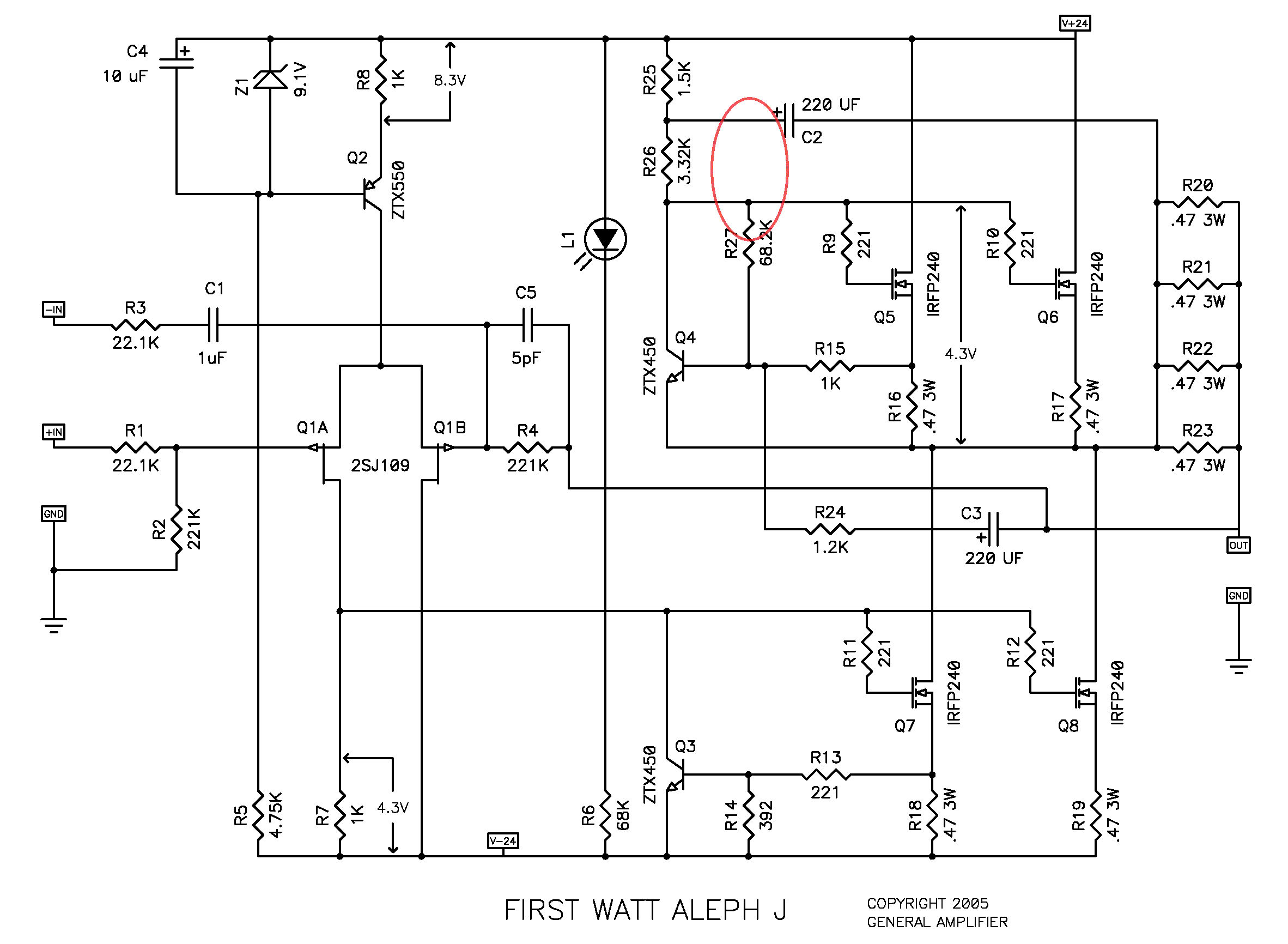

I've been having some fun with this circuit in LTSpice in preparation for an upcoming build. I thought that it would be fun to up the bias to boost performance into difficult loads.
However, upping the bias from just under 0.9 A to a little over 1A results in a 4 dB increase in H2 and a 2 dB decrease in H3. I've fiddled with the AC gain feedback resistors, and if I drop the AC gain to about 30%, I can match H2 and H3 at a higher bias level, but that's unhelpful - more heat for the same performance. I've experimented with methods of changing bias (e.g., lower value source resistors and adjusting R27), but the trend is consistent.
There is a sweet spot, it seems. Low bias - around 0.6 A - performs much worse than the specified value of about 0.85 A or so. It obviously makes sense that NP would select an appropriate bias point for the design as published, but I'm wondering why the performance suffers as you try to scale it up.
Any thoughts on why this may be so? It would seem as if the distortion should decrease across the board with increasing bias: http://www.firstwatt.com/pdf/art_mos_test.pdf
Am I missing some adjustment that should be made to compensate?

I just ran the sims using Cordell's IRFP240 model instead of the model bundled with LTSpice, and the distortion difference between low and high bias vanished. You're right - it appears to be an artifact of simulation/modelling.
I remember that I adjusted the trim-pots as per Nelson's Alph J schematics: R8 was a 1K resistor, R7 a 2K trim-pot adjusted for 1K; R27 a 100K trim-pot adjusted for 68.2K. The quiescent current was around 0.56V / 0.47 ohms = 1.2A per each "branch". I am not sure what the quiescent current was in an FW production Aleph J...

The Factory Manual says peak current output is 2.5 A. With 42% AC gain, which is approximately the AC gain of the posted schematic, 42% of the output current comes from the variation of the current source, or about 1 A. That leaves 1.5 A to be provided by the gain devices, requiring at least 0.75 A bias on each.
In simulation, if I hook up R27 as in the original schematic, I get around 1.2 A, like you describe. This would pump out much more than 2.5 A current at peak, though. Dissipation would be about 220 W, which squares with the manual’s statement of “about 200 watts.” Maybe the current output of the factory model is substantially derated?
In this build guide, 0.85 A is suggested, and this comports with a peak 2.5 A plus a little buffer. I get about .9 A if R27 is connected at the junction of R25 and R26, as it is in the Aleph X and Babelfish J. There was some question about if the Aleph J schematic was correct and where R27 should be connected but I didn’t find an answer.
This post suggests that the latter connection is more typical of Aleph amps. Stated in reference to the Aleph 5:

post schematic showing different positions of "disputable" resistor , so we can comment
I remember some debate about , but also remember there was no issue per se , difference being of academic , not practical relevance

The numbers are per device, except for the peak output of 2.5 A, which is total, and the 220 W dissipation, which is for all 8 devices in the stereo amp. The actual draw would likely be a bit higher.
The difference in practice may be academic, as the bias can be controlled with either arrangement, but it's just a question of what was the originally intended bias. Moving the connection but keeping the value - 68.2k - results in the different bias values I mentioned.
Here's the first question I saw about how it should be arranged:
Hello Papa
Refering to your Aleph J schematic, R27 is connected directly to the gate of Q5 and Q6.
Is it possible that R27 is intended to be connected between the junction of R25, R26 and C2? If connected this way it results in 2A bias and seems to operate somewhat better into low impedance loads (from memory).
The way you have it connected results in approximately 2.6A of static bias (a little high).
I know the issue of high bias was addressed by members with trimpots, but it was applied somewhat differently.
It seems to me R27 should have been connected between R25, R26, and C2
Top junction of R27.

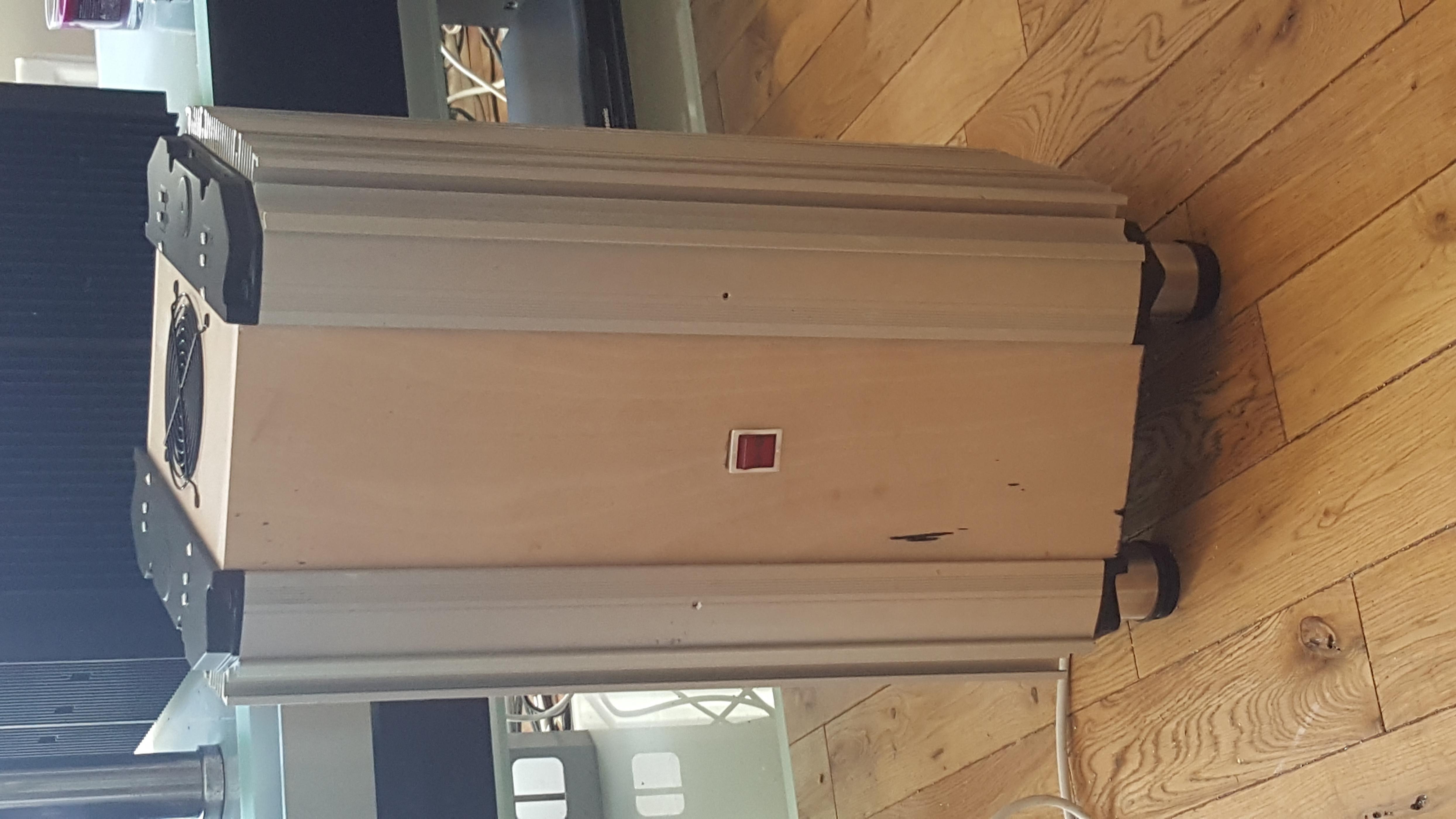

I have 5U chassis; 1A quiescent current at the moment, per each branch. I remember I noticed an improvement when I went up, from 0.8A to 1A. The sound was more relaxing and enjoyable. The winter is approaching our hemisphere, so I will go up to 1.2A and see what happens.

Remember that “bias” in the Aleph is actually AC current gain, although increasing it does increase the total current and therefore bias. Generally speaking you are hearing the change in the current gain instead of the actual bias, as it has a more direct effect on distortion spectra.
Also speaking in generalities, Nelson’s suggested settings are almost always in the “sweet spot” for subjective sound quality. However, it’s absolutely up to you to experiment and find out what you like best. 🙂 🙂 🙂
