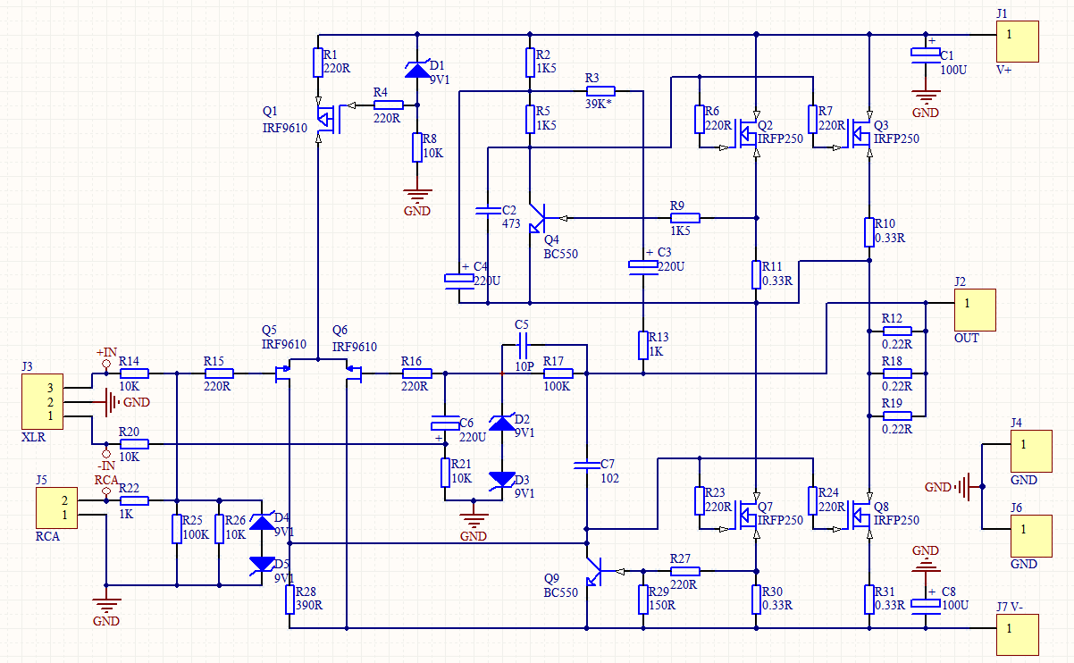

My friend Bruce is not an EE but he does have an uncanny, almost superhuman ability to notice weirdness in EE designs. Often these turn out to be design errors (!). Bruce modestly refers to his skills as "simple pattern matching".
Just now I did some simple pattern matching between the schematic of post #3486 and the schematic of post #1. One thing that positively JUMPS OUT at me is: Capacitor "C4" (220uF) in #3486, is not present in #1.
I will leave it to the EEs of diyAudio to decide whether this is a fatal error in the circuit design of post #1, a fatal error in the circuit design of #3486, an insignificant difference that has no impact whatsoever, or perhaps some other conclusion.

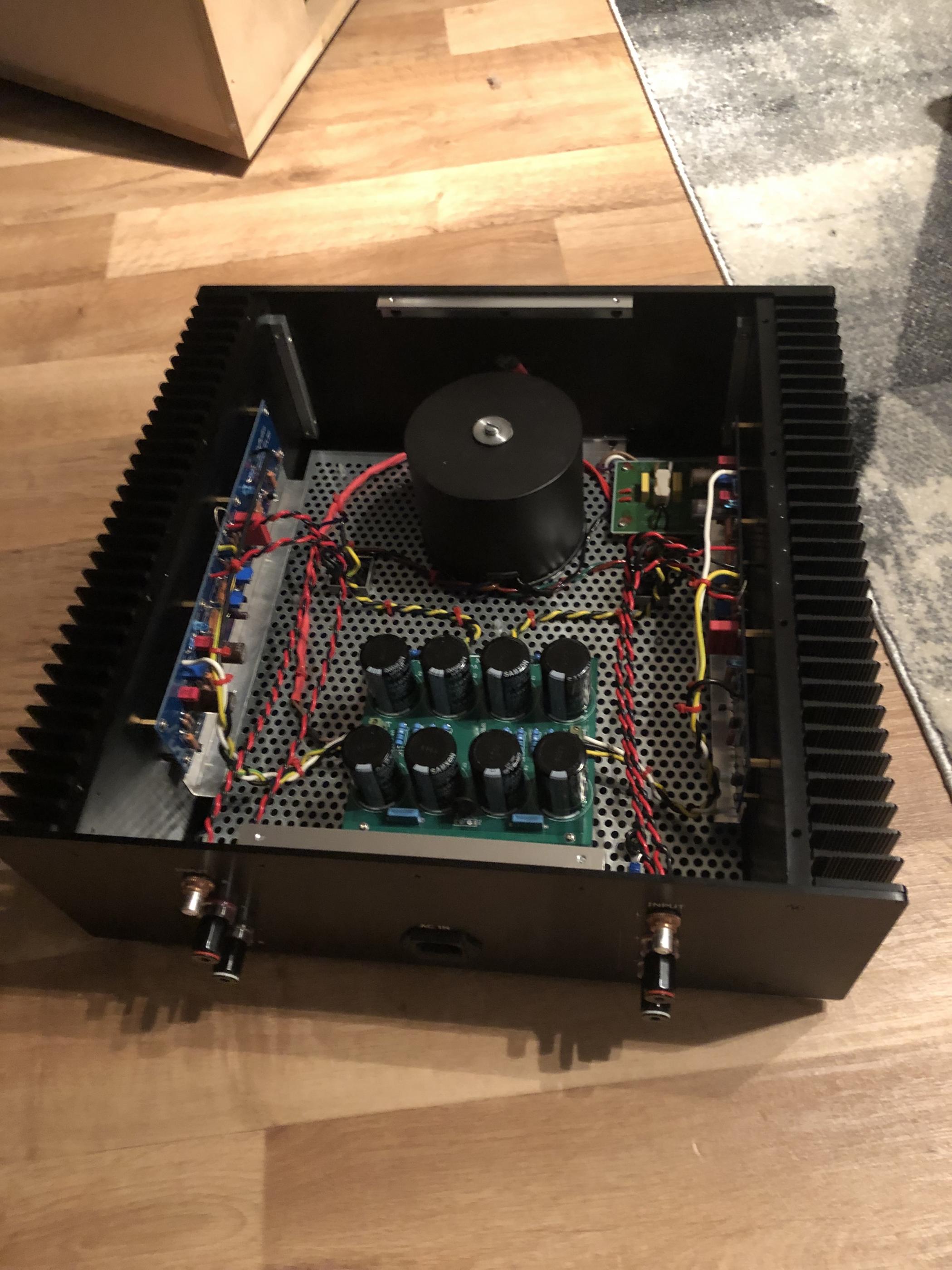

Based on my experience with the ACA amps that I have been building recently, it would be better to use a simple CRC power supply filter. If you wish to enhance your power supply, you could use transformer(s) with 20 Volt secondaries and a diyAudio style PSU board with 18000 uF, 50V capacitors for a total of 72000 uF per rail. Or go full dual mono with a separate transformer and PSU board for each channel. You will also want to invest in a good chassis such as the Modushop 4U, 400mm deep one. Take a look at the pictures posted above by nikko03 for an excellent example of an Aleph J build using this chassis.
