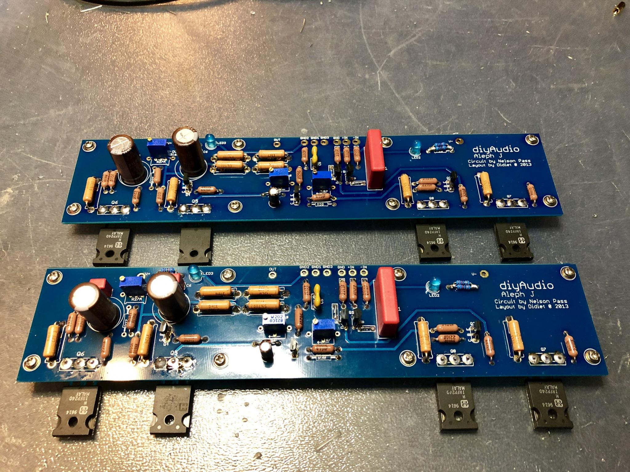

finished amplifier cards and psu. waiting for my chassis to come. so the assembly can begin 🙂

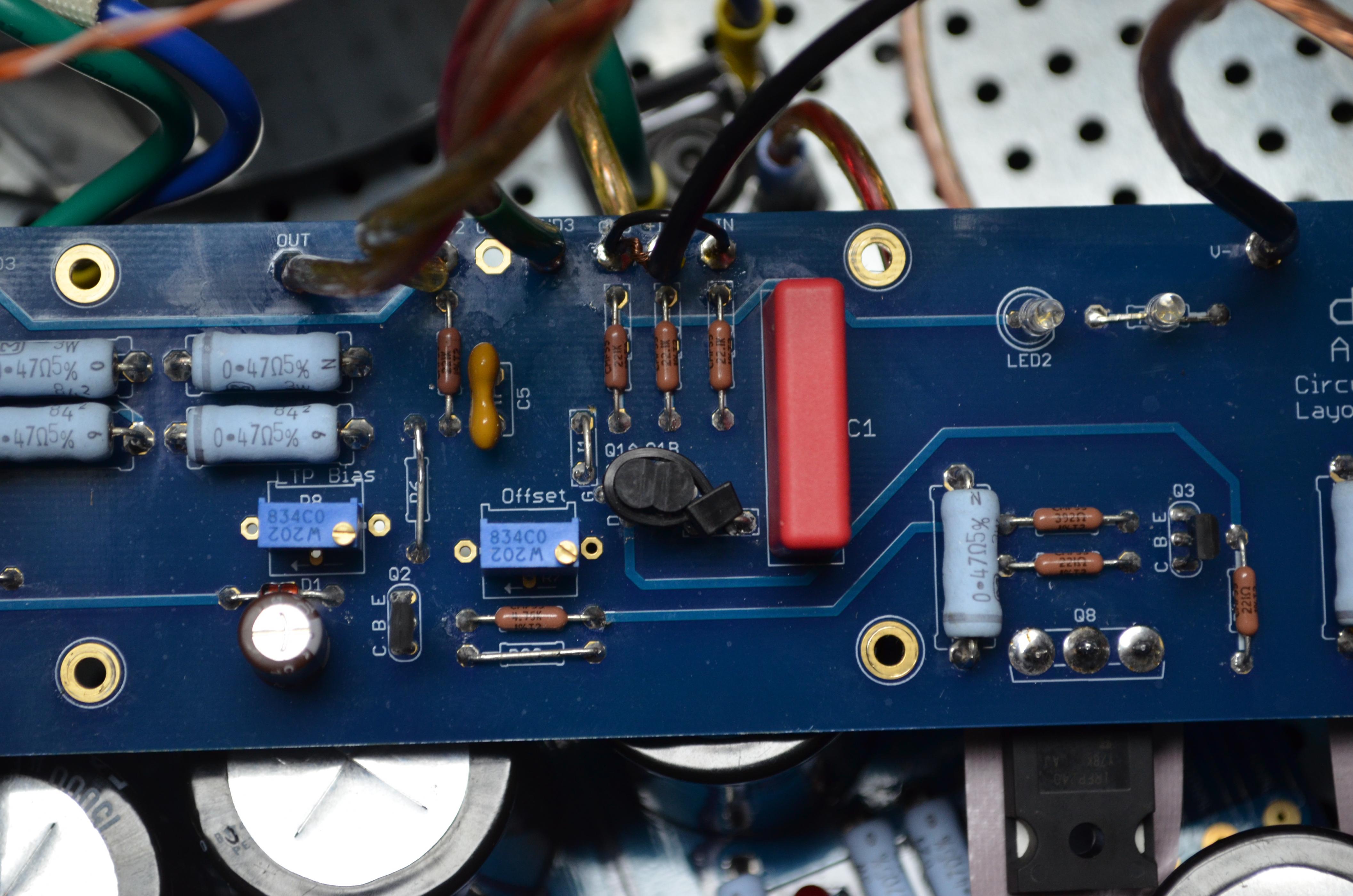

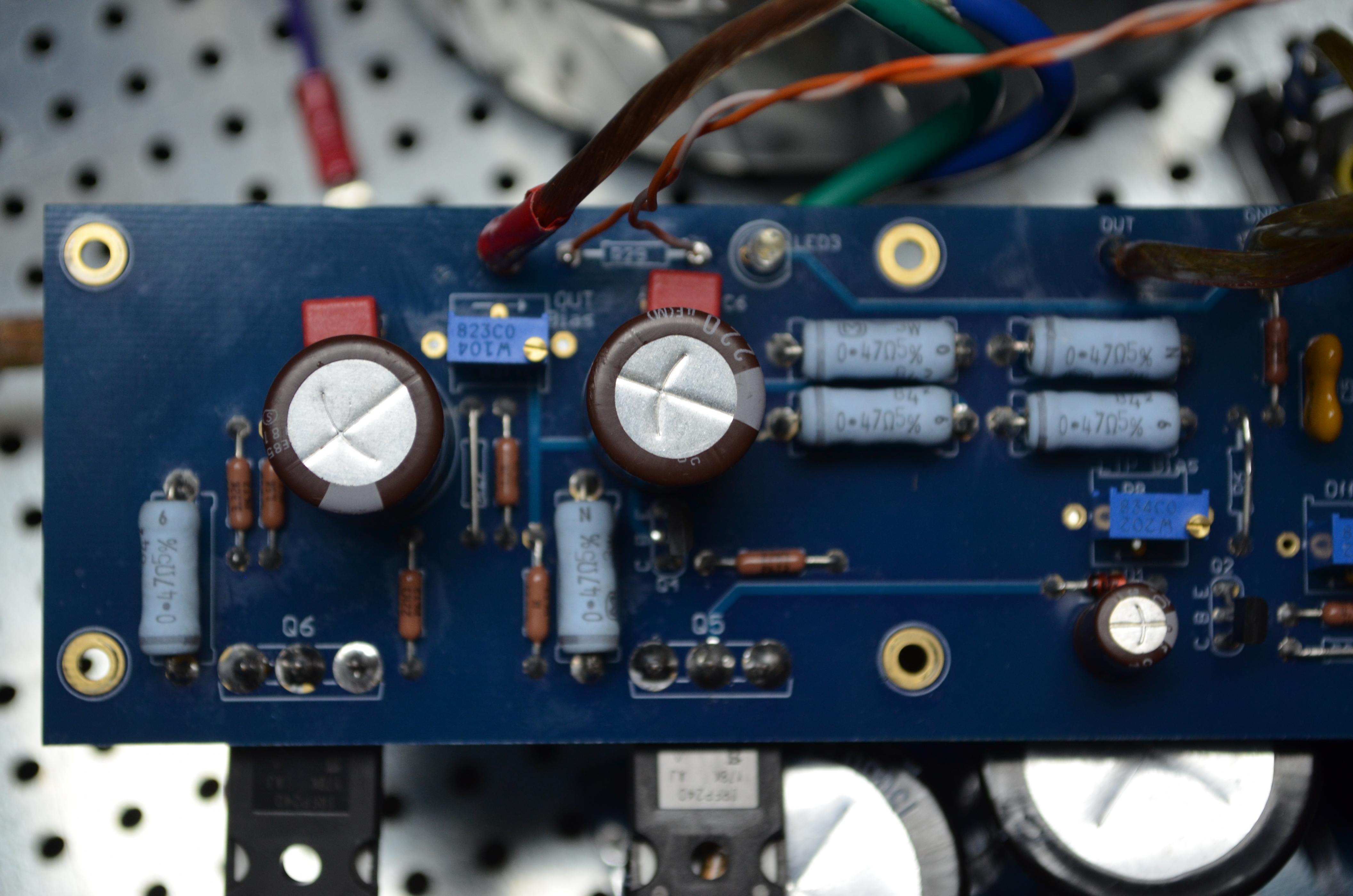

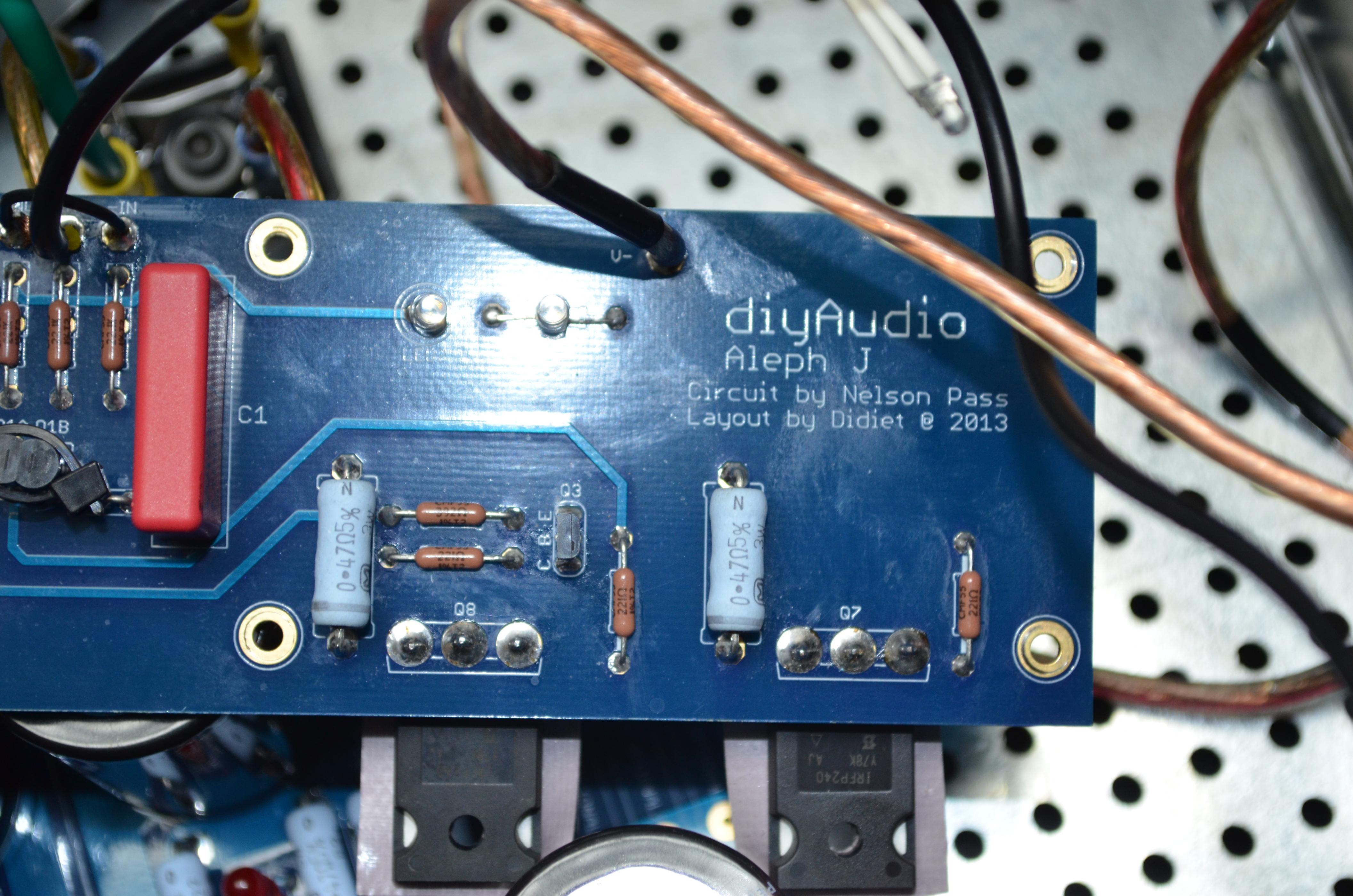

Send some clear, well lit pictures of the amp boards.
Have not started the 2nd board.
Hope these photos are good enough for analysis.
EDIT: Would someone please identify which are source resistors by schematic number, please?
