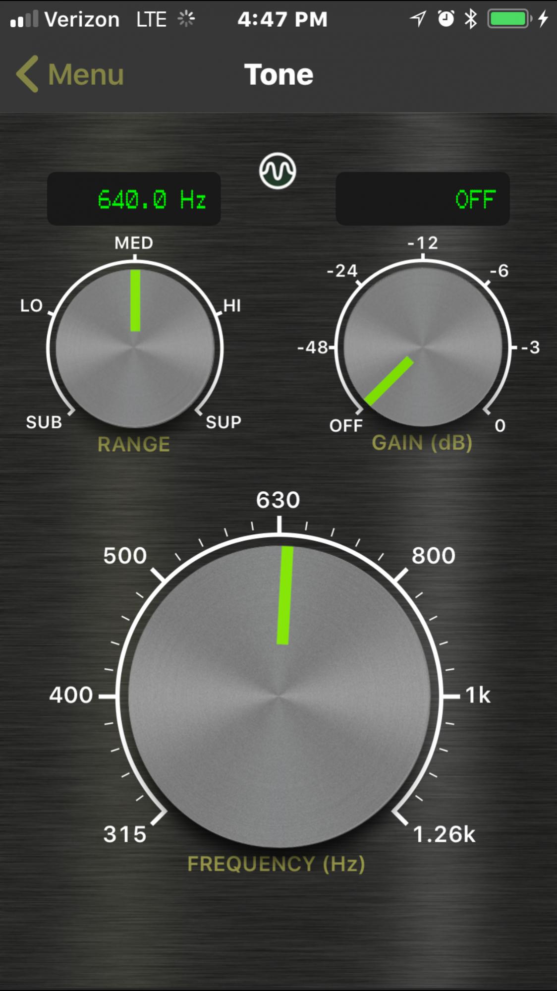

The variac in combination with a signal generator and AP System is very effective. Of course, not many DIY-ers can afford this gear; me neither - I am just recalling time I spent with electronics manufacturing company a few decades ago.... 🙂
The bulb tester seems like a very sensible solution for DIY audio builds, especially if combined with a variac (and maybe a cheap-ish oscilloscope?? 🙂)... but... the signal generator would be so handy as well... oh wait a minute, I am re-writing the first paragraph again.
Variac and free signal generator on iPhone or android
I sent a link earlier for You Tube for Mr. Carlson’s lab about a bulb tester .
Here is a link how to use a variac and you might as well learn something about a isolation transformer while you’re at it .
Signal generators are available for your android or your iPhone for free . If you want to clean it up and boost to gain of the signal a little more you can run your cell phone through a DAC.
Tech Tips Tuesday, Isolation Transformer and Variac Safety - YouTube

Ramp the voltage up until your PSU measures about 10v, test again: does it produce music? Let it sit for a few minutes. All resistors still reasonable temperature?
Working in a quiet environment helps - you'll hear a resistor or transistor crackle if you cook it. Keep your nose close - you can sometimes smell a problem before you can see it.
If it makes some sort of music (always use a cheap speaker that you don't mind blowing), ramp up to 120v and do first rough set of bias and offset.
