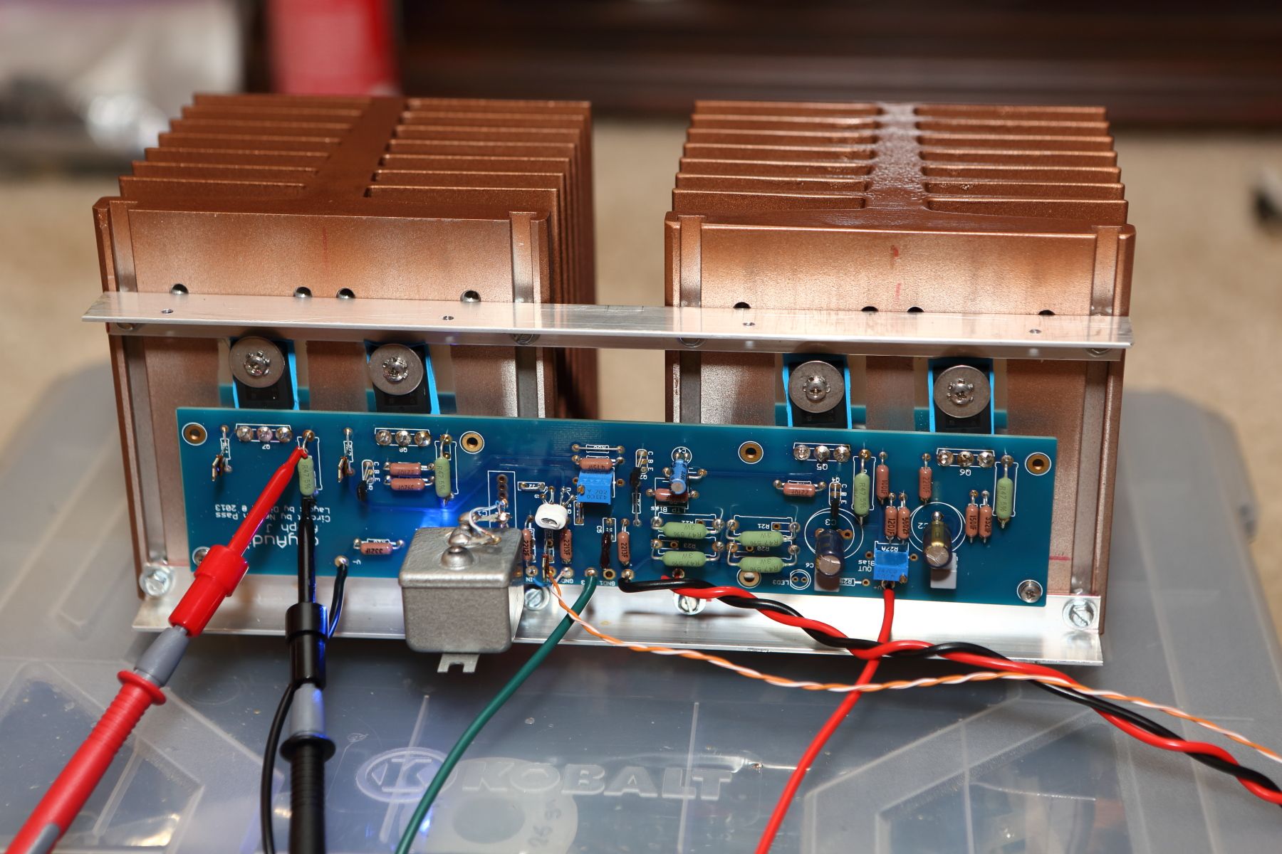

Got one channel of my Aleph-J up and running, but I am having trouble adjusting R27 with any significance. For R27, I installed a 56k resistor with a 20k pot in series as someone suggested a few pages ago instead of the 100k pot.
With the 20k pot maxed out, Vdrop across R18 = 0.542v. With pot turned fully in opposite direction, Vdrop across R18 = 0.523v. There isn't much movement here...
Big green power resistors R6, R7, R18, R19 measure 0.531v, .523v, 0.525v, 0.530v voltage drop.
0R47 / 0.527v drop = ~0.98A per device at 22.3v rails = 19.8w dissipation per device, so each sink is dissipating ~40w of heat.
With thermocouple on my DMM, the hottest spot I can find is the mosfet mounting screw at 56c, hottest spot on the sink is directly adjacent to mosfet at 50c, ambient = 23c. I can live with this temperature for the amp. Thermal interface is Bergquist 1500ST.
Is there any problem with not getting Vdrop across R27 down to 0.400 for bias/AC gain as indicated in post #3 of this thread?
The temp seems OK, but if AC gain is set less than optimally, I'd rather adjust it...
