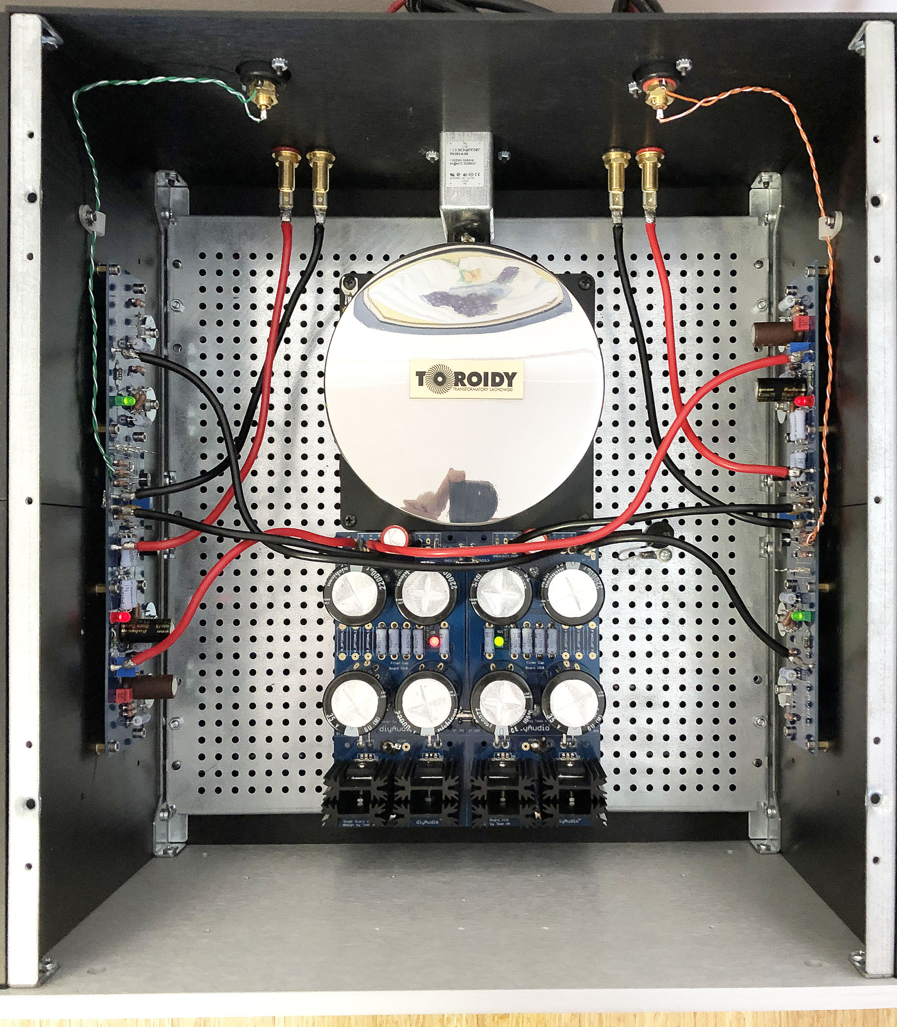

I tried everything I could think of before posting this, but my Aleph J hums with anything connected to the inputs. I have tried different preamps and interconnects with no change. I reconfigured the amp to vertically mount the tranny and have rerouted the incoming AC, and it's still there. I am using shielded wire for the inputs with shield only connected to ground at the RCA input. I tried cutting one of the shields with no change. Moving the input wiring around does nothing to the hum that I can tell. The hum is not super loud but audible from a few feet away from speakers. Too loud to be acceptable.
Hum goes away entirely if I stick a shorting plug in either RCA input. This points to the input wiring, but I can't figure out what's wrong. Thanks for any assistance, and see photos.

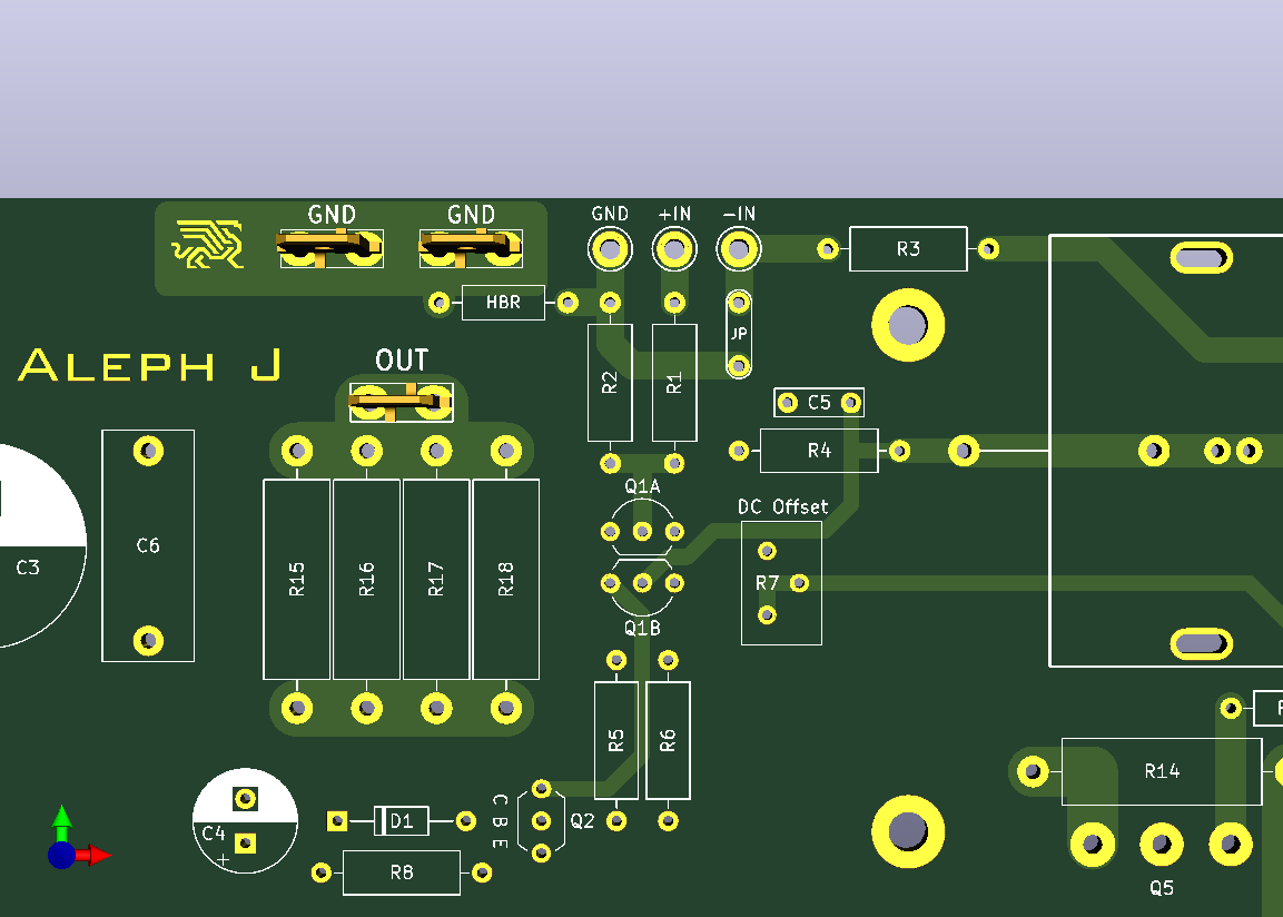

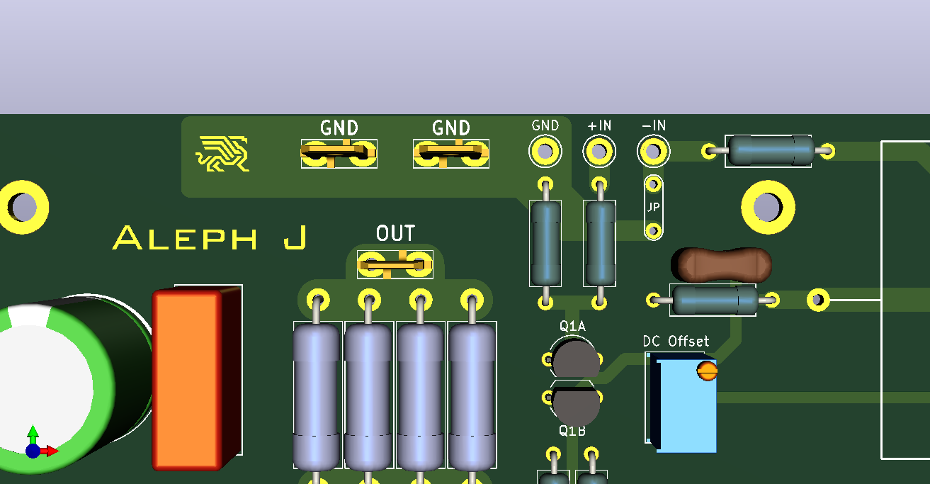

I kind of did Aleph J board layout with 2 output stage transistors for SS from Cody and Nelson giveaways.
For reference I took ground from DIY Audio store boards.
Now I think should I really separate grounds and add a place for resistor to connect them.

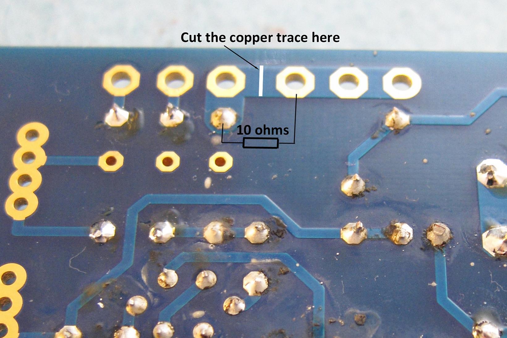

How did you insert the 10ohms resistor? Where exactly?
NOTE that the resistor should separate the low current signal ground return, from the high current ground return areas on the AMP PCB.
I inserted the 10R resistors on the amp pcb at the input- and connected the - lead from the RCA to the resistor. I did this on both channels and it did not make any difference in my 120Hz hum. I measured 120Hz with my android phone running the app - Spectroid.
This is NOT the correct way to do a ground lift.
Edit
exactly as per the photo in post #25
I made attempt to separate grounds in my layout.
HBR is a Hum Breaking Resistor. (15-20 Ohm)
JP is a jumper place holder in case unbalanced only input.
What do you think guys? Is that correct way to separate grounds?

Sorry, I have been busy and waiting on my heavier wire to come in. I had some time to work on it this weekend, and I have been able to reduce the hum significantly. I rewired the PS wiring several different ways, and there was absolutely no change that I could detect. Again, the amp is DEAD quiet with shorting plugs, so I never really thought the PS or filtering was the issue.
I reduced the hum by adding a Y shaped ground that connects each RCA ground directly to the PS PCB. This is even with the ground from the input wiring still connected to each board. It's at a level I'm satisfied with.
However, I now better understand the ground lift resistors and their function, so I'm eventually going to place those on the boards instead of the RCA jacks as was suggested before. I'll have to remove the boards from the heatsinks to get at the ground trace to cut it, but this makes the most sense now given all I've tried so far.
