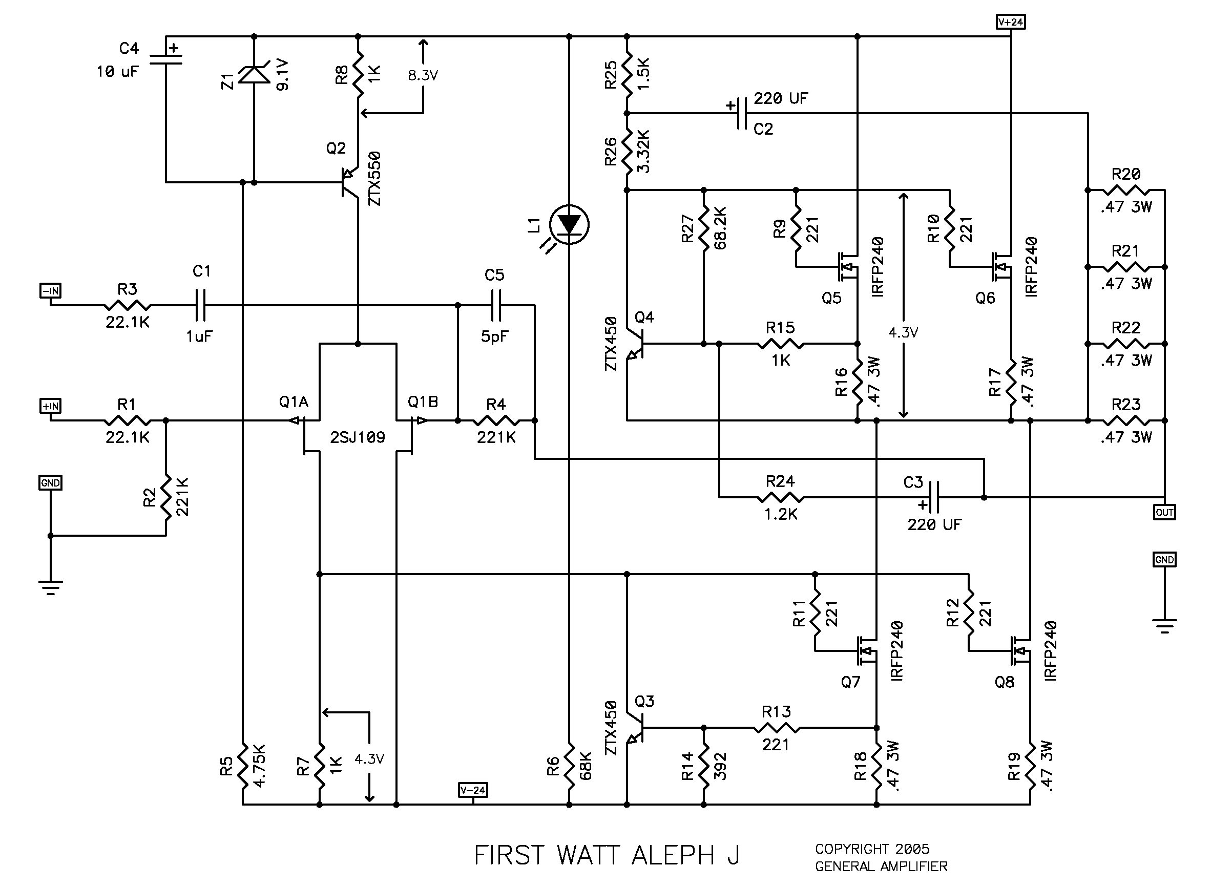

I'm not sure that the quote addresses the question. I
interpret it as wanting to know how to set the current
gain of the Aleph current source, not the DC bias.
For the former, you generally want to set the gain so that
the AC variation of the current source is about 1/2 the output
current. It can be more or less, but 50% gives the optimal
energy efficiency figure.
You will note in the Aleph schematics that the Base of the NPN
transistor which controls the current source attaches to the
output of the amplifier through an RC network. The value for
C is set arbitrarily high so that it does not interfere with audio
frequencies, and it is the value of R which is the most convenient
spot to adjust the gain of the current source. For the purpose
of this discussion, I'll call it R0.
If you set the amplifier driving a sine wave into a load (let's say
16 Vrms into 8 ohms at 100 Hz), you can measure the current
variation of the gain N channel Mosfets (whose Sources attach
through power resistors to the - supply rail) with a cheap AC
voltmeter placed across one of these Source resistors. With
R0 taken out of the circuit, you will get one AC value across the
Source resistor (say 470 mV, for example). As you put a value
for R0 in the circuit, this will decline, and when it measures 1/2
the value without R0, you have reached 50%. If it measures
1/4 the value, the current gain of the Aleph source is 75%, and
this figure is too high for a standard Aleph. Most listeners like
the Alephs at 50% or lower, so I recommend between 50% and
100% of the AC voltage value compared with no R0.

R0 is R24 here :
(you need to measure voltage across R18 or R19)
edit : my Paesano Logic is telling me that you're at 50% AC gain when AC voltages are same across ,say, R19 and R17 ......... but I'm never sure how's my brain working ...... biz as usual - Mighty ZM in constant state of Public Disgrace

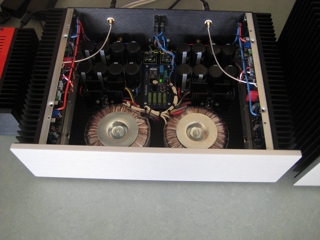

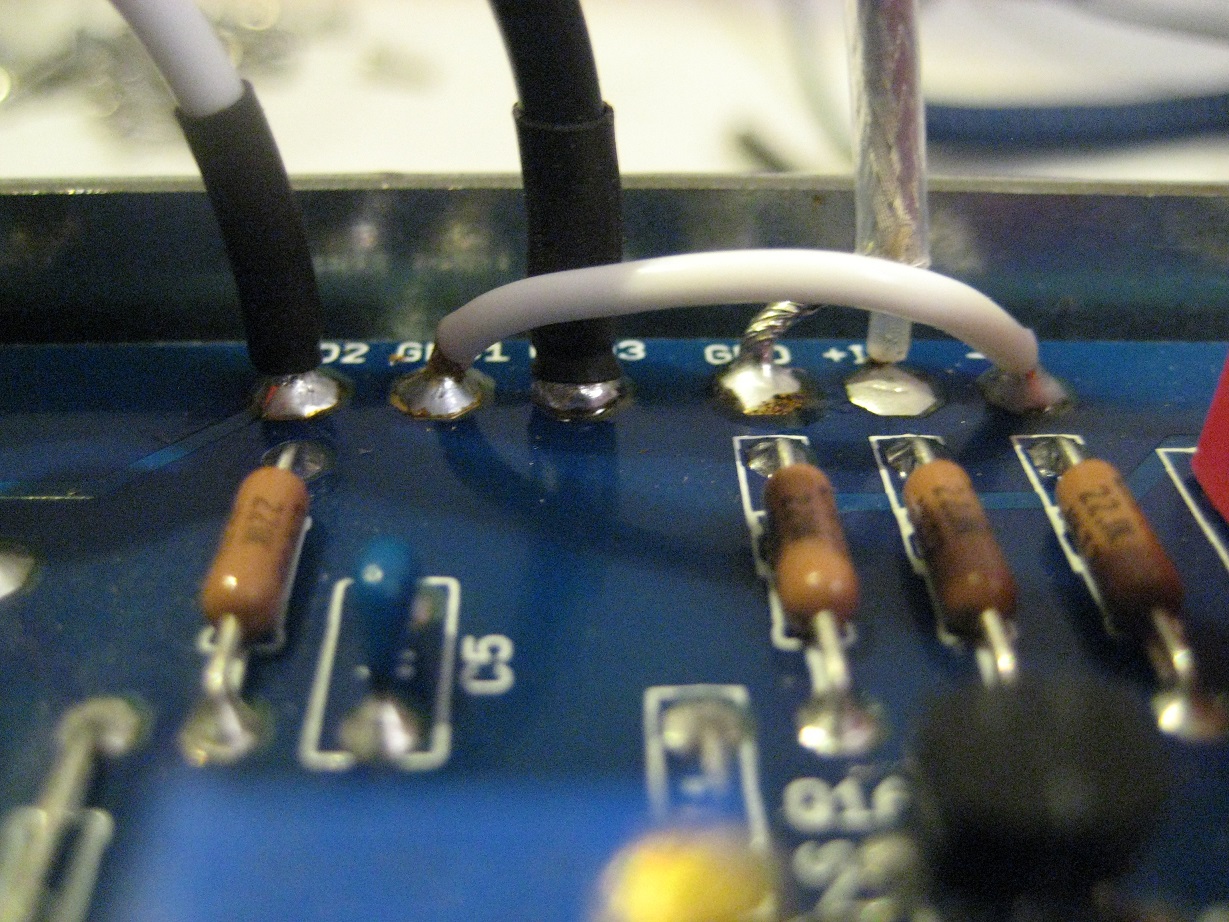

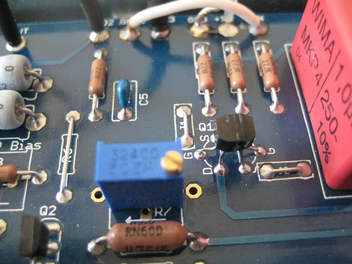

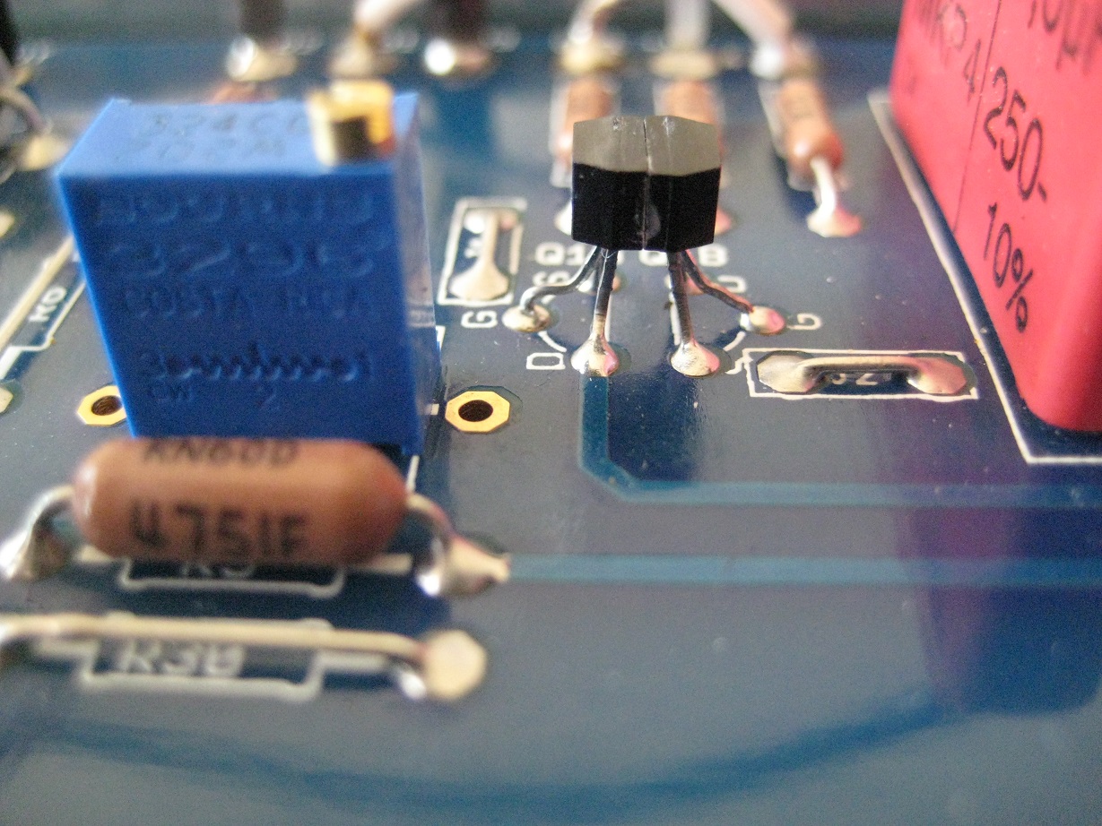

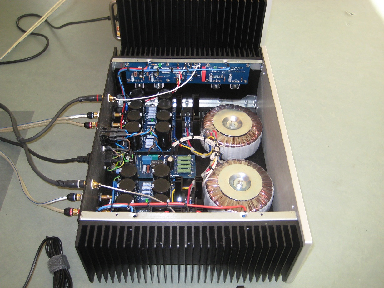

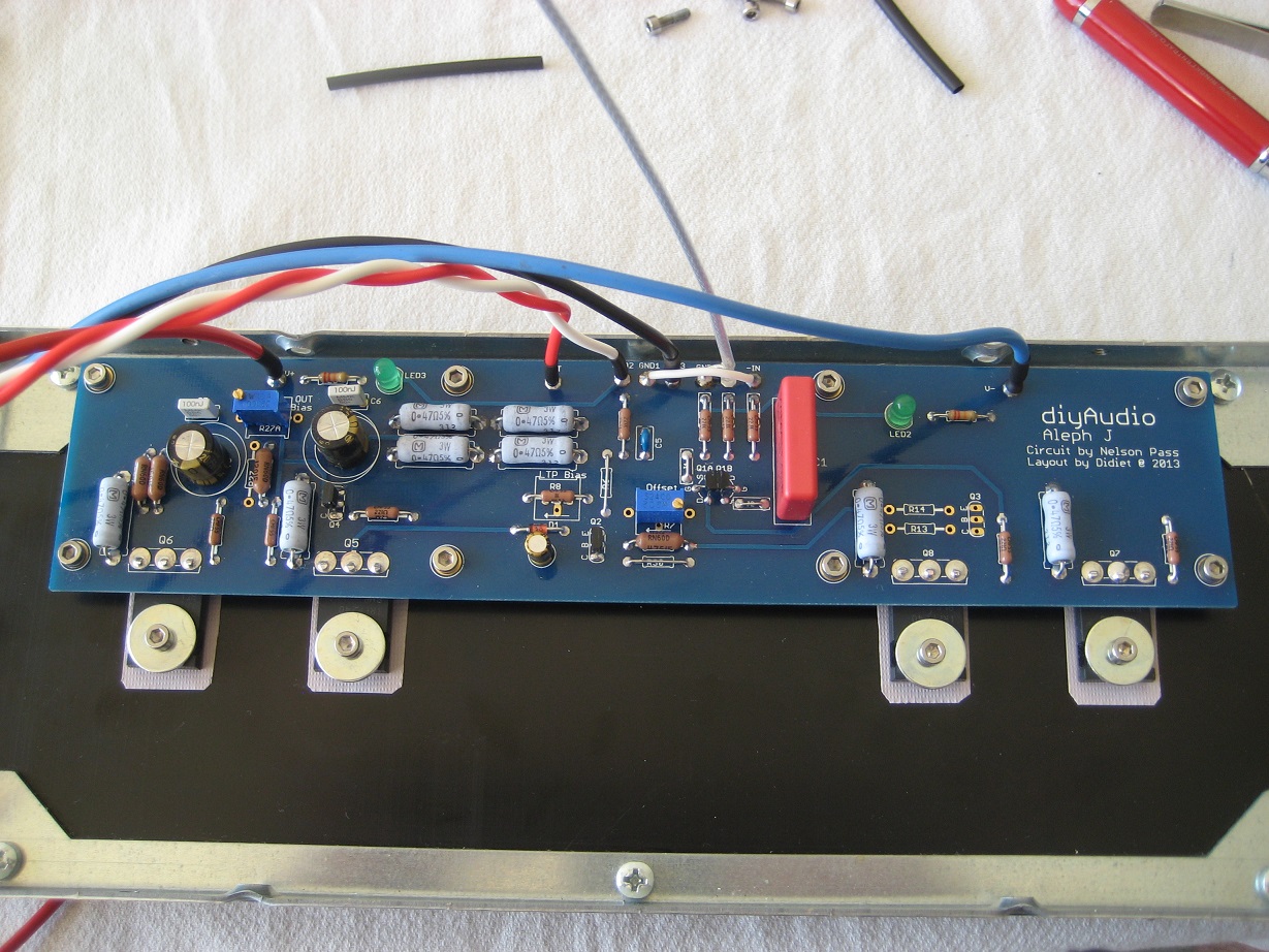

Finished my Aleph J...

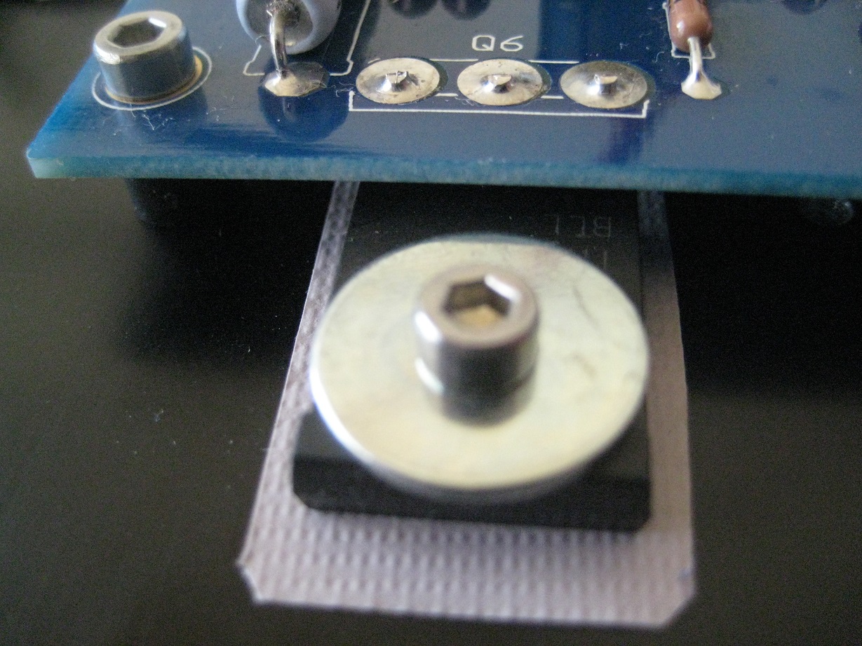

I built it in my F5 chassis which wasn't a big trouble because of the UMS specification, and the 24 volt needed for almost all Firstwatt amps.
For the F5, I used a 3 U hifi2000 chassis which isn't big enough for the Aleph J.
I can bias the Aleph cold at 400 mV over the 0.47 Ohm source resistors which results in 55C heatsinks with the lid off !
The amp seems very robust, bias lowers from 400 mV to 380 mV when warming up. So it bias itself lower when heating up!! That's not the way a F5T reacts 😛
Offset is very stable within a few millivolts. A nice stable and complete Amp. I left out the current limiting.

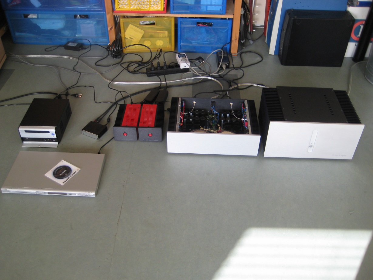

I have been listening and comparing the Aleph J against the F5Tv3 for a week.
Aleph J wins in the highs and mid highs... what a detail, best I ever heard. Hi hats, cymbals, electronic music..WOW
But the F5Tv3 wins with bigger soundstage...the Aleph J seems more compact.
There is no real winner, both amps sound different, even my wife noticed 😀 but they are both great !
Next is to build the Aleph in his own chassis, I'm thinking of a easy, compact, nice computer case with ( very silent) forced air cooling 😱
Like the cases of Streacom, Fractal Design and Lian Li ...
