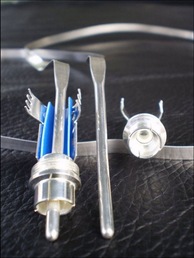

I have wondered where Nick gets his silver ribbons....it looks like he DIYs them!!![]()
That one is the pinnacle of interconnects...a silver bullet, as I call it.... single peace, pure annealed silver, no soldering. Very fast, faster than a speed of light 🙂

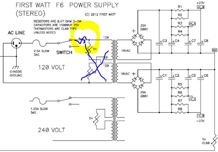

Hi, I don't have any soft start in my Aleph J.
I tried one cheap from ebay but it reduced dynamic. My transformer have two wires on primary so it's not possible to put thermistors between the primary. is it possible to put in series before the transformer?

In addition to your question, I'd suggest posting the make and model of transformer you're using along with your mains voltage for verification.

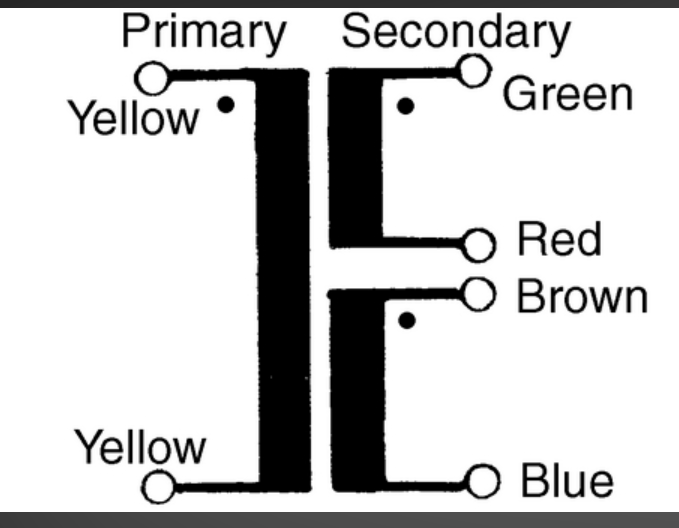

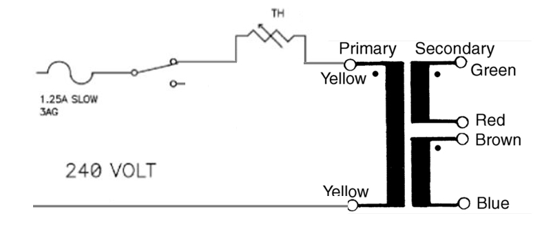

My transformator is 230V, not 2*115V
Check the photo.
Thanks! Is this a good solution? I have already tried but removed the thermistor because it got very hot.
It is supposed to get very hot.
When you turn the amplifier on, it is cold (room temperature) with a resistance of around 10 ohms. It acts as a resistor, and it limits the in-rush current.
As the current starts running through, it gets quite hot very quickly, and its resistance drops to around 1 ohm (or lower). It will continue to run hot (and keep its resistance low) - this is a normal operation, don't worry about it. Just give it a bit of space to "breathe".
