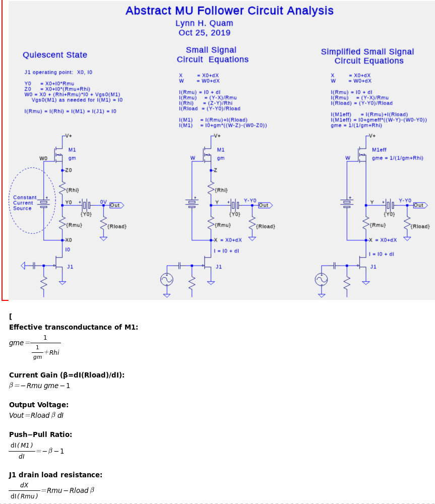

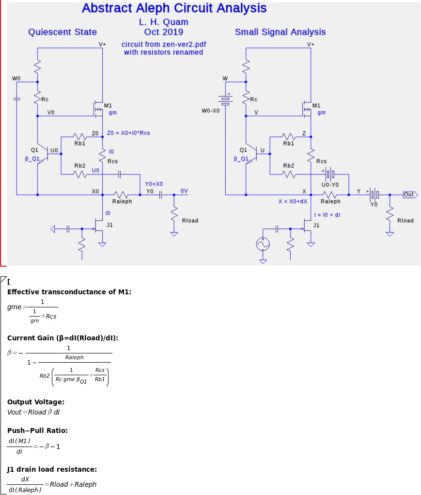

Aleph vs. mu-follower circuit equations
Shown below are abstractions of the mu-follower circuit of the FirstWatt SIT-2 and the Aleph Current Source as described in http://www.firstwatt.com/pdf/art_zv2.pdf. The mu-follower and aleph circuits have some commonalities and significant differences.
Commonalities:
Both circuits produce push-pull output from a single driver FET J1 and are characterized by their current gain and the load resistance seen by the drain J1.
Differences:
The aleph circuit equations are significantly more complicated than those of the mu-follower, the aleph having 7 parameters vs. 3 parameters of the mu-follower. The aleph circuit has the additional non-linear transistor Q1 inverter in the signal path to the modulated current source FET M1 vs. the direct (capacitor) coupled signal path from the J1 drain to the current-source FET gate.
The circuit equations of the abstract circuits were solved to obtain the current gain from the drain of the driver FET J1 to the output load Rload and to obtain the load resistance load line) seen by the J1. The complete systems of equations are available to those interested.
I forgot to mention about the sign of beta (the current-gain). It is negative because dI(Rload) (the current into Rload) decreases with increased dI (the current through the J1 drain). The equations would probably look better by defining beta as -dI(Rload)/dI.
