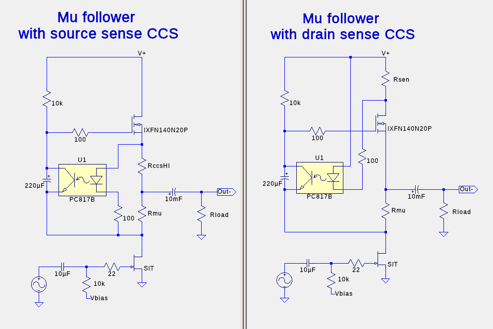

Since this topic remains interesting, I will point out that the Aleph follower has
one single advantage, which is the simple adjustment of its gain without alteration of
the bias figure. You can easily put a little pot on the resistor going from the
output to the Base of the bias control transistor and play with the waveform
there. Not as easily done with conventional mu follower.
Thank you Nelson, for filling in the elephant left out about the Mu. We can get around bias changes by doing an array of Rs but its adjustment is only as 'fine' as the array itself, which might not be very fine at all. It would adjust the relationship between driver and source, But, what ability does it have to shape H2/H3? Slightly or significantly?

The circuit on the left is the "ordinary" mu follower circuit using an opto coupler. The mu follower circuit shown on the right allows for independent adjustment of the CCS current and the mu follower gain.
