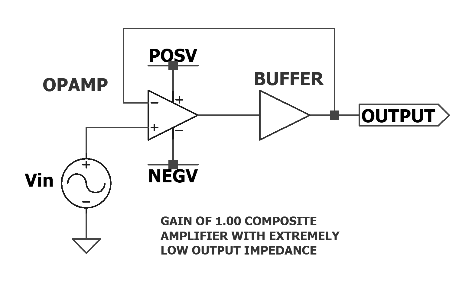

To get another factor of 1000X reduction in output impedance: use (your favorite buffer) as the second stage of a composite amplifier. In this composite amplifier, the first stage is an opamp with enormous open loop gain. As has been successfully demonstrated in M2x-Norwood, M2x-Milpitas, WHAMMY, etc. Thanks to the global negative feedback loop, the output impedance of the buffer is reduced by the gain of the opamp:
Zout_composite(s) = Zout_buffer(s) / Opamp_open_loop_gain(s)​
Obviously you still need to ensure the global loop is stable, since both the opamp and the buffer contribute added phase (reducing phase margin). But it can be done; it has been done; and working examples abound.

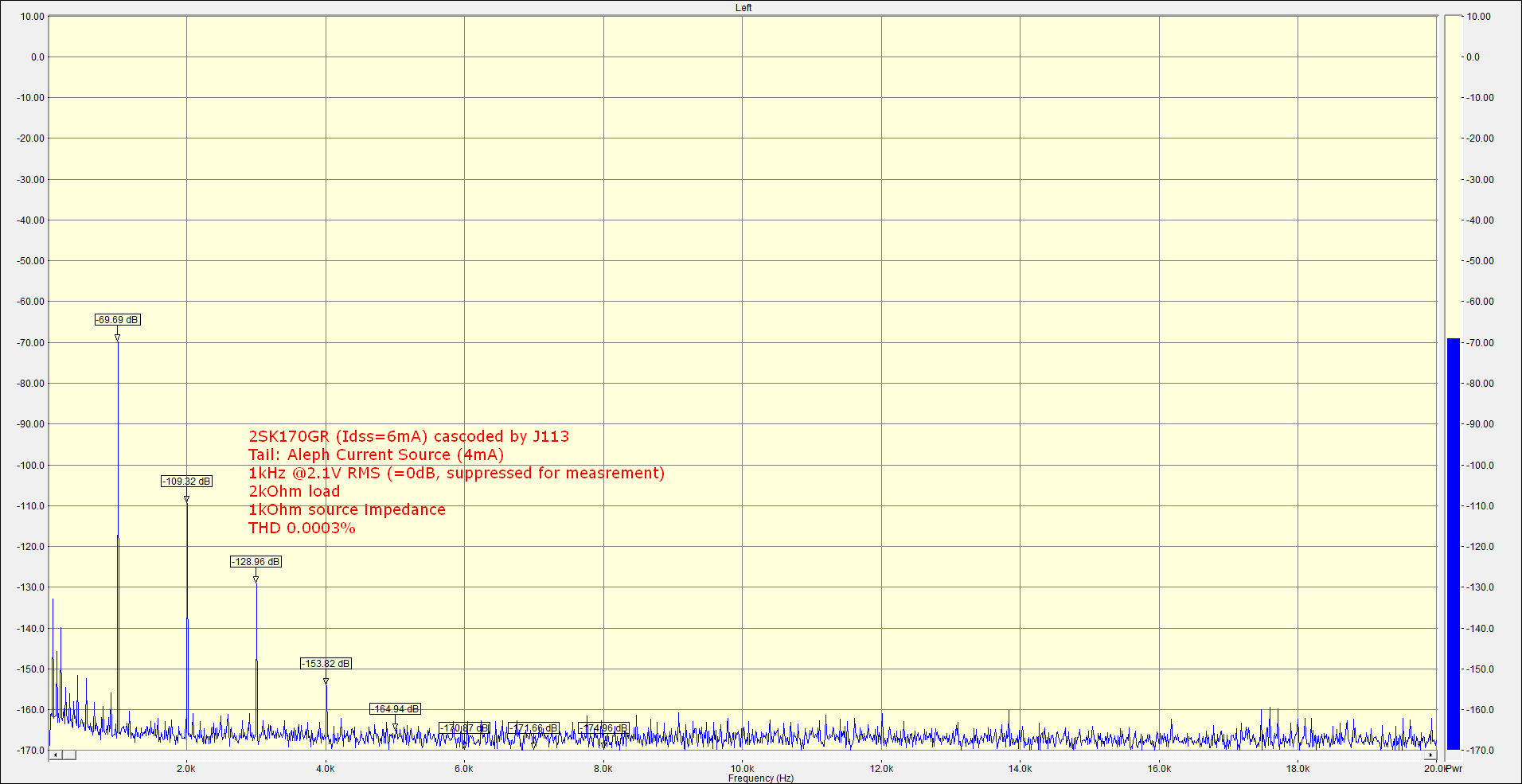

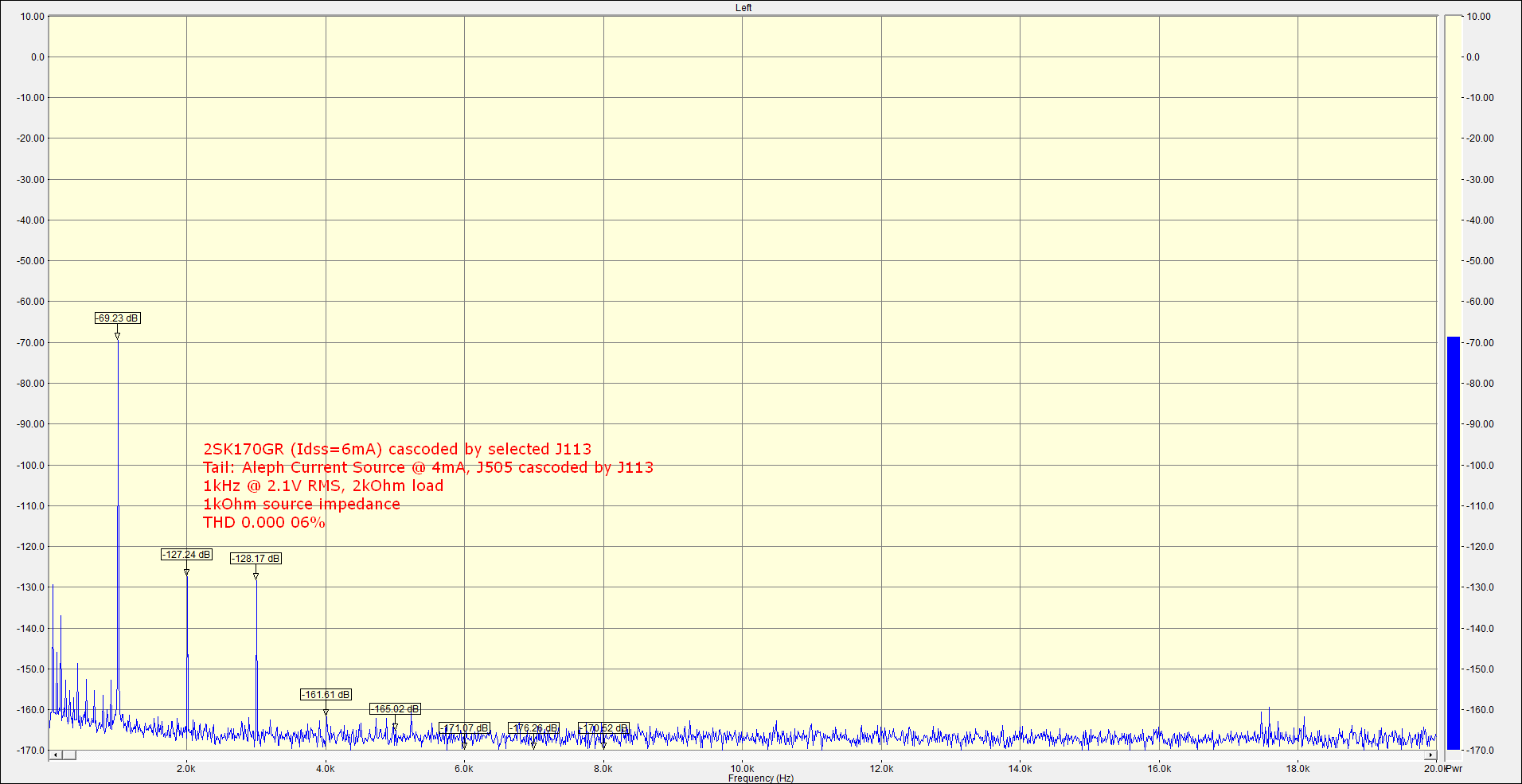

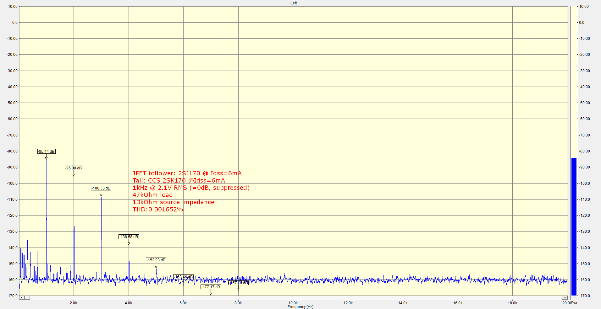

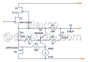

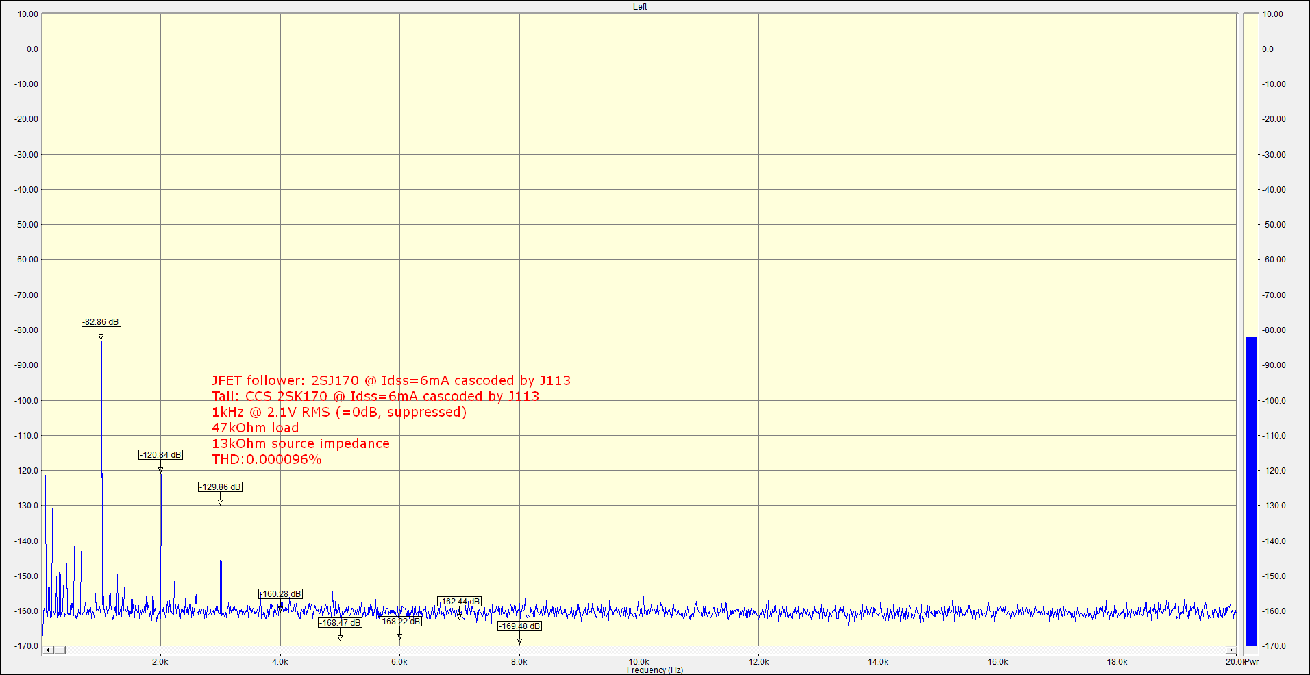

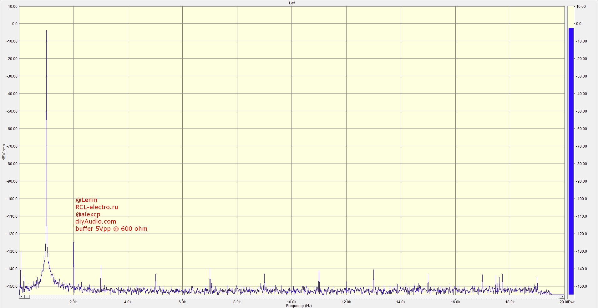

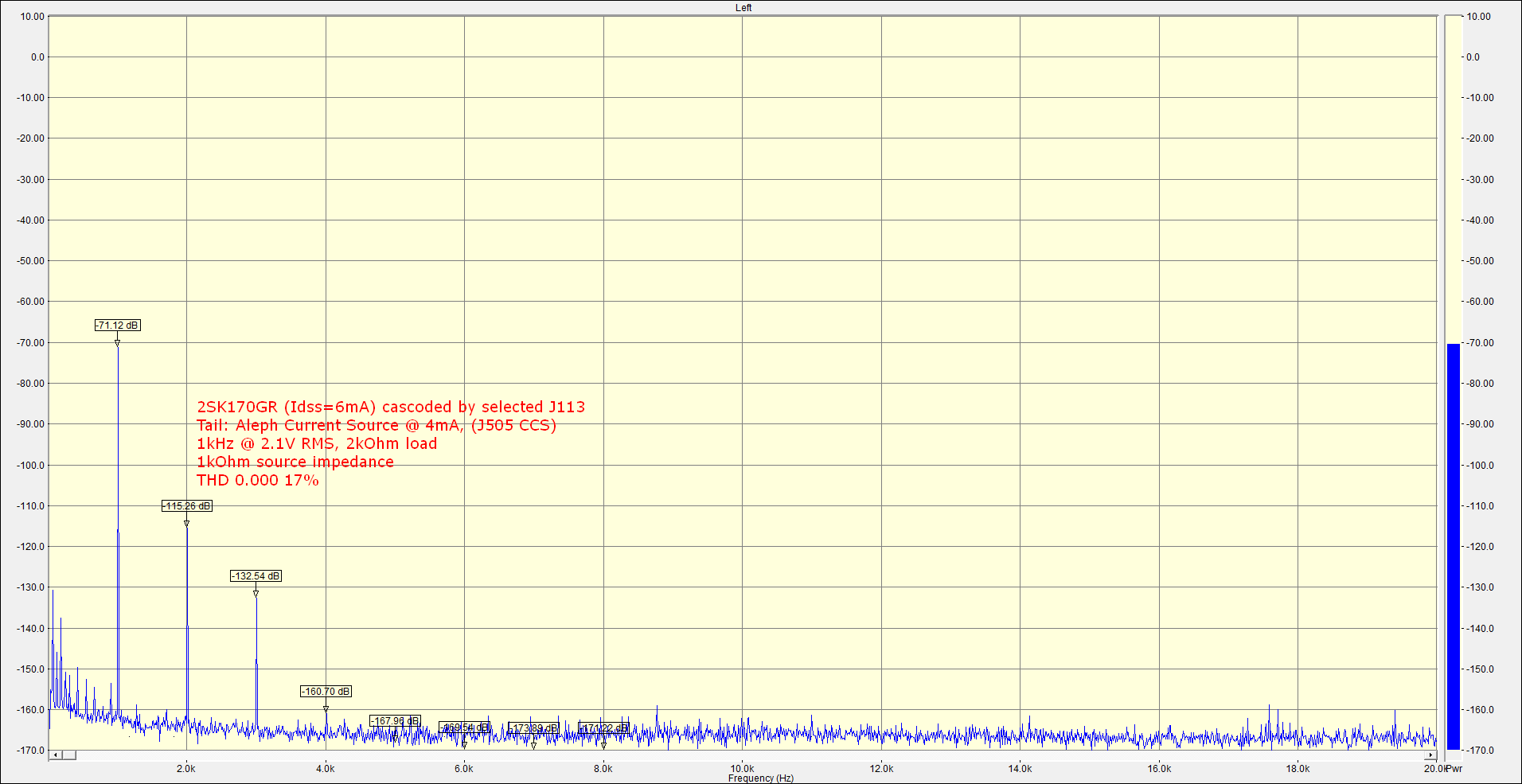

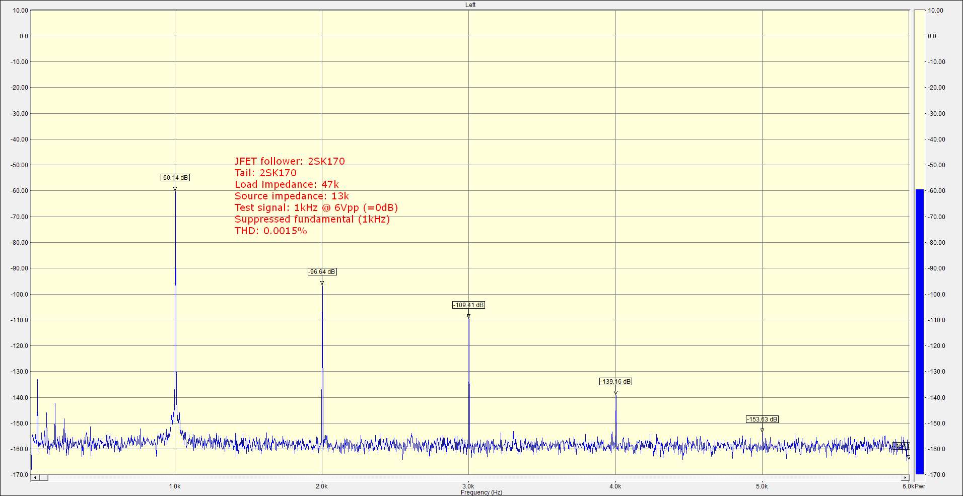

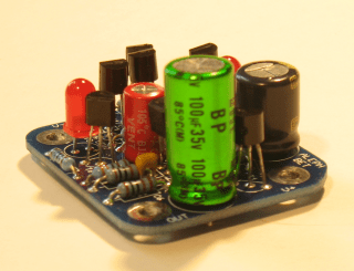

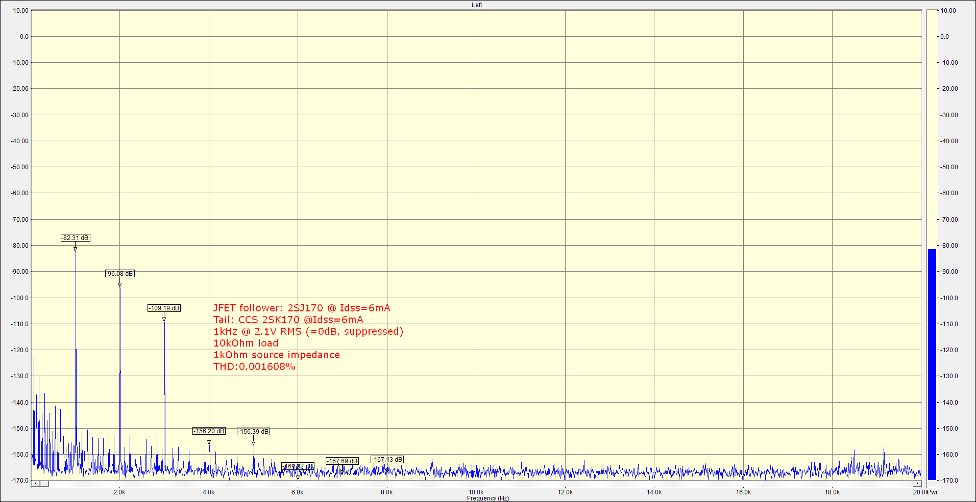

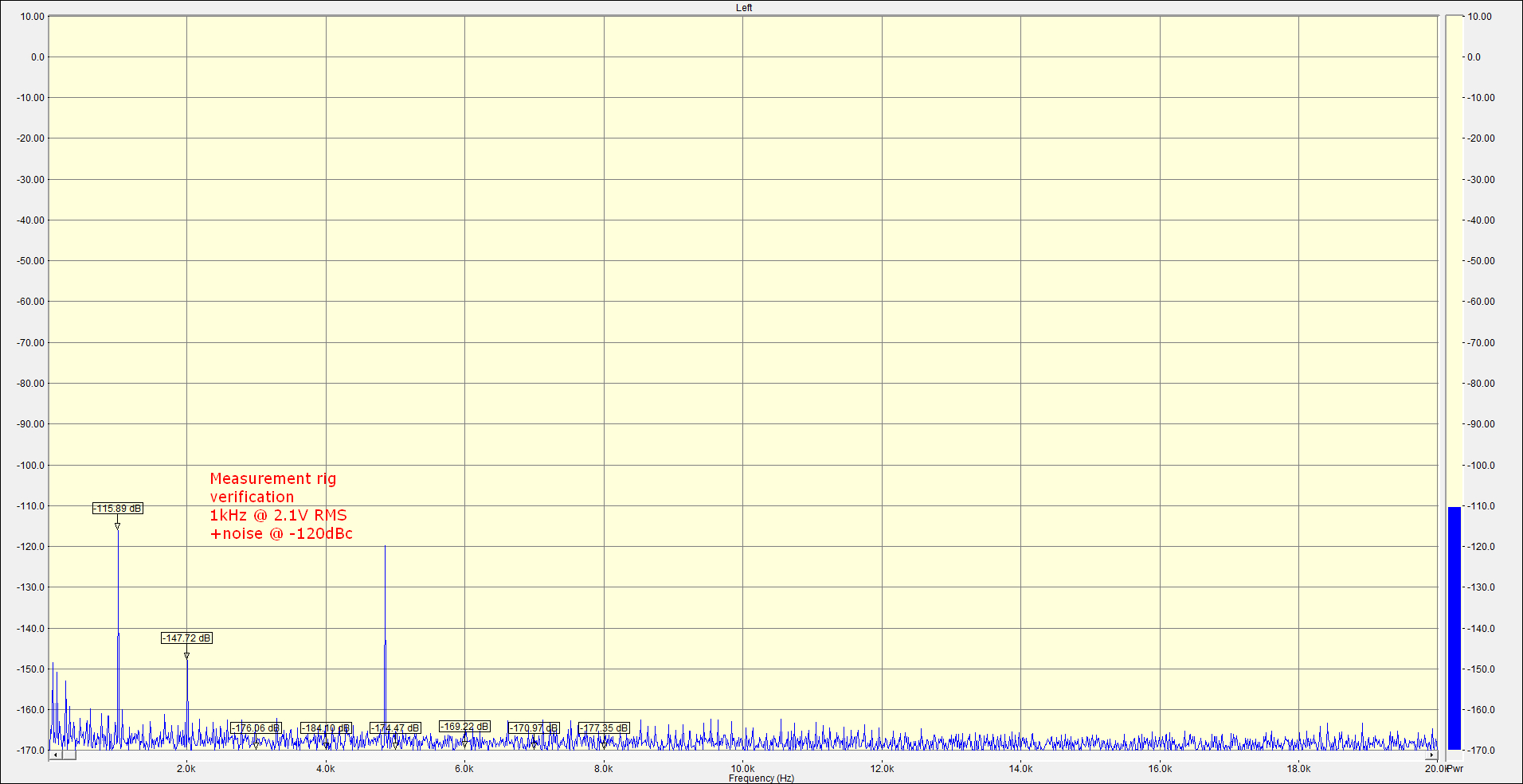

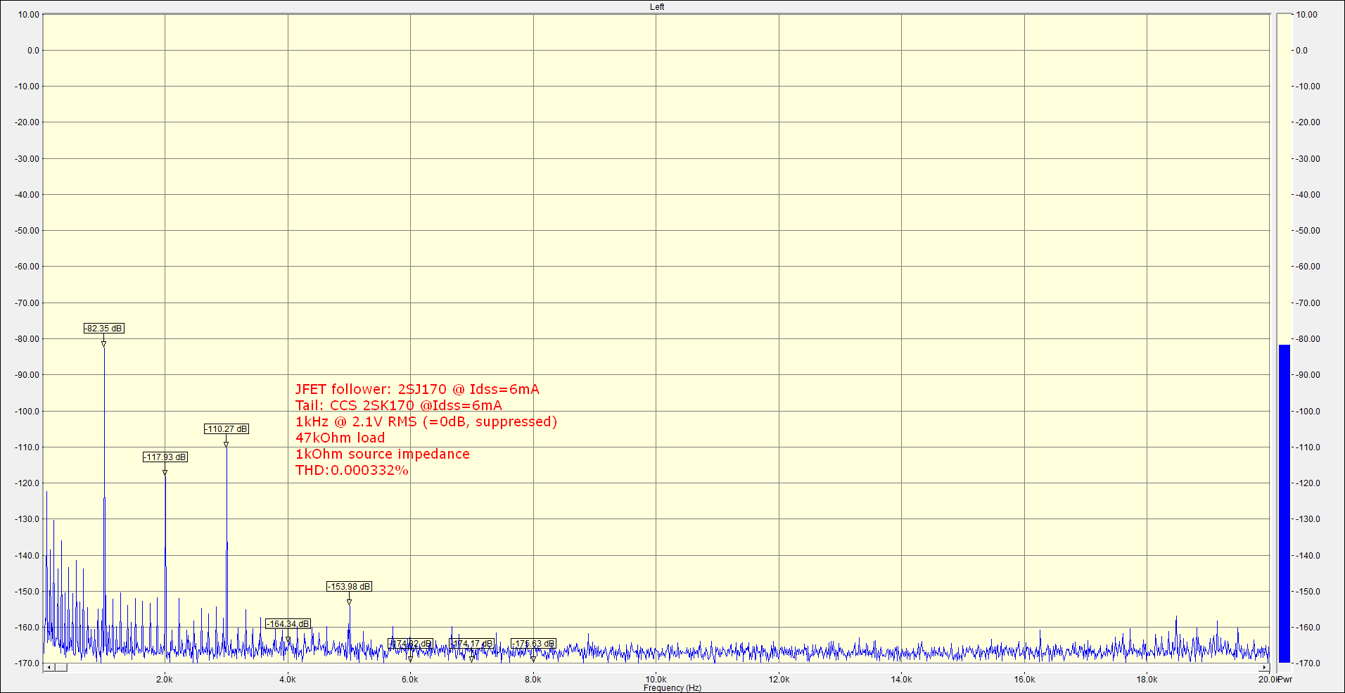

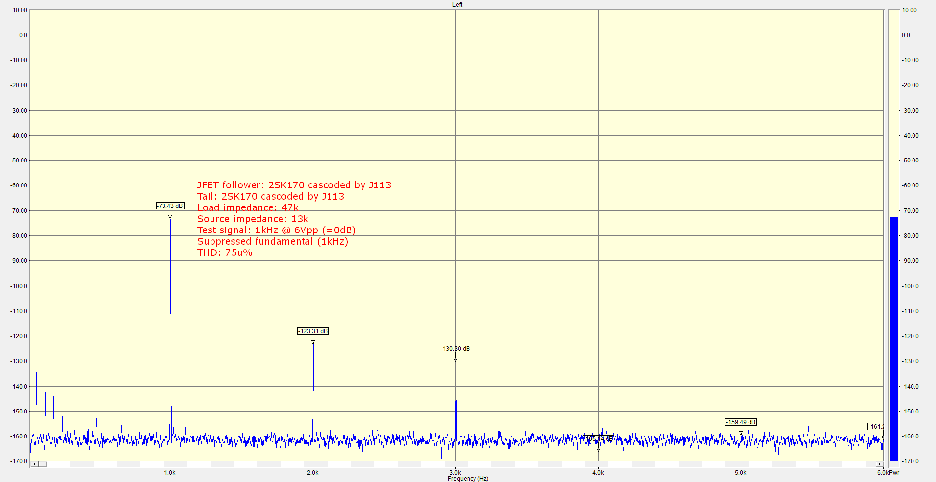

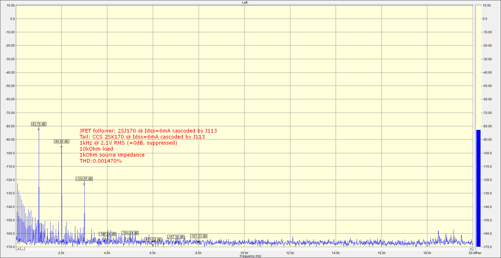

Indeed, feedback helps. In Aleph Bet, however, we explored a different approach, where the buffer is a simple follower, and feedback is used only to servo its operating point.
Speaking of M2x, here is one prototype of Aleph Bet in the form factor of M2x daughter card:

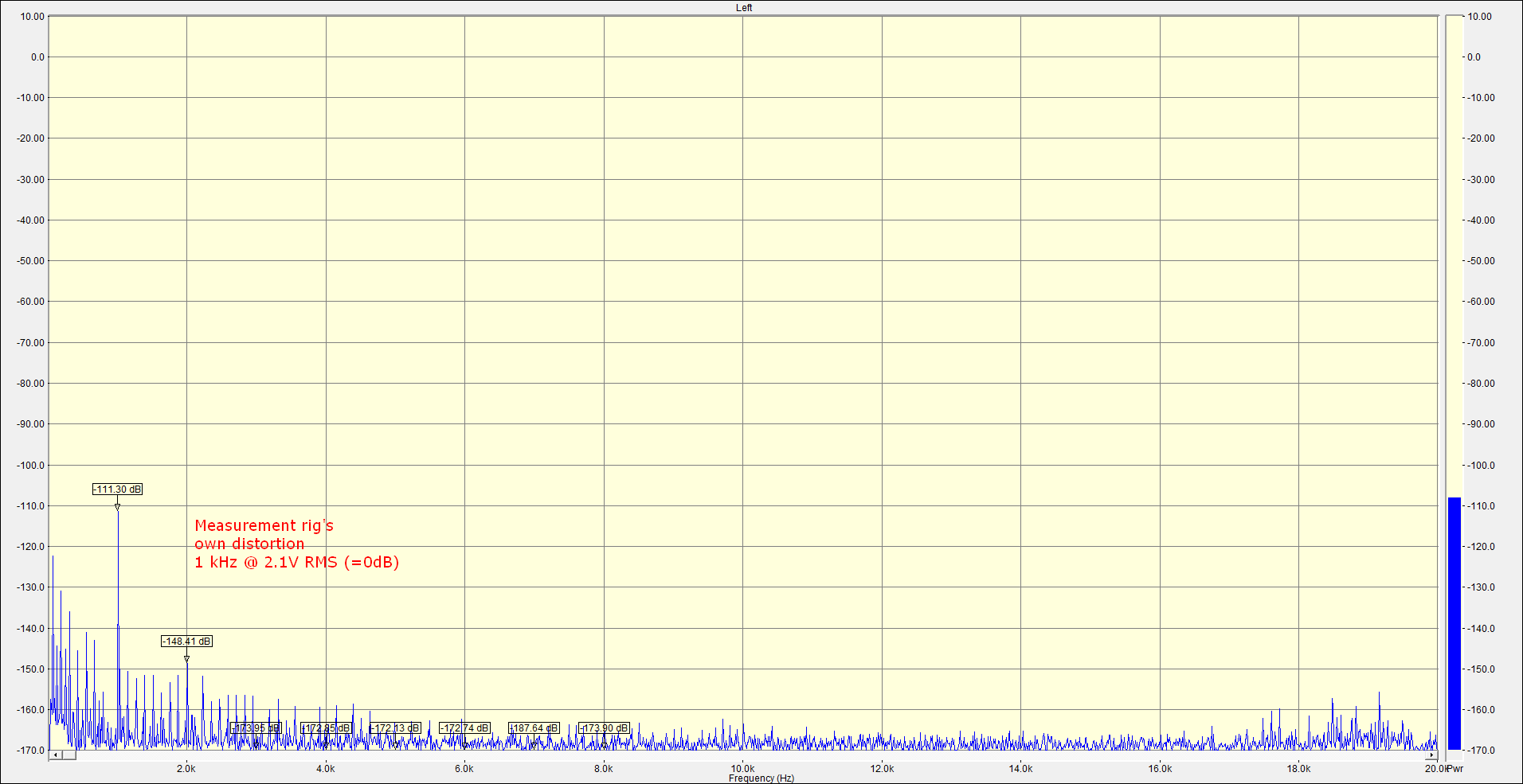

I don't have an M2x, yet, but the buffer already performs flawlessly.

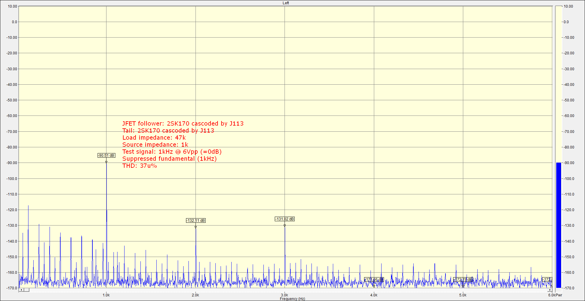

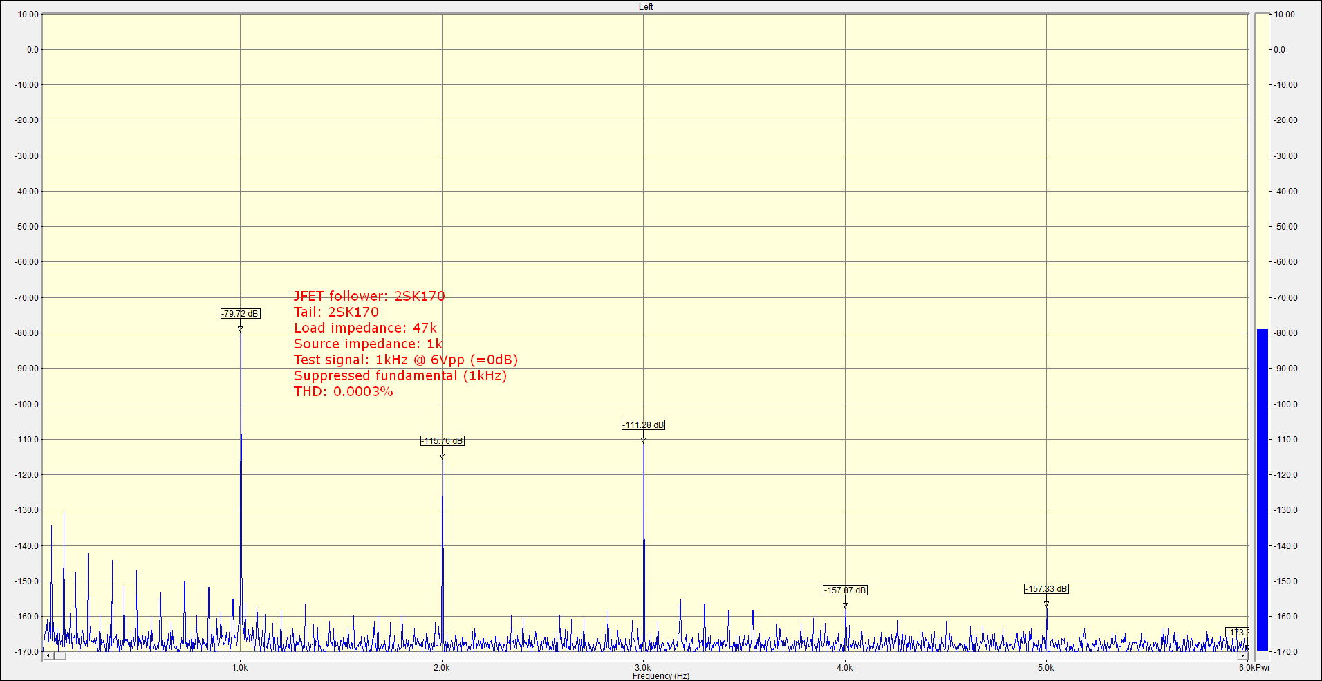

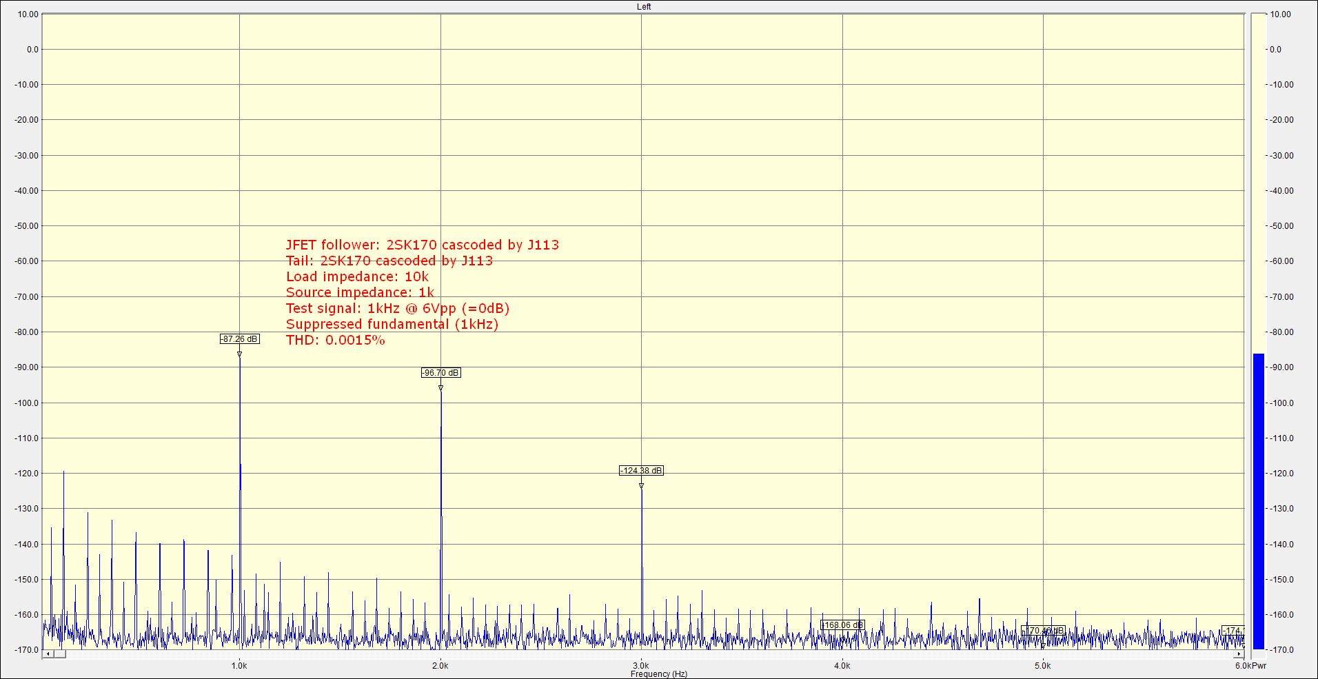

Sorry but a LM317 is light years away from what I’m looking 😉 This topic attracted my attention because the design has a FET input (therefore very high input impedance et minuscule bias current), a very low distorsion and a low noise. That’s not something that is achieved by integrated circuit, as far as I know.

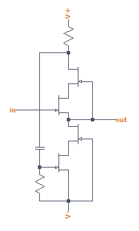

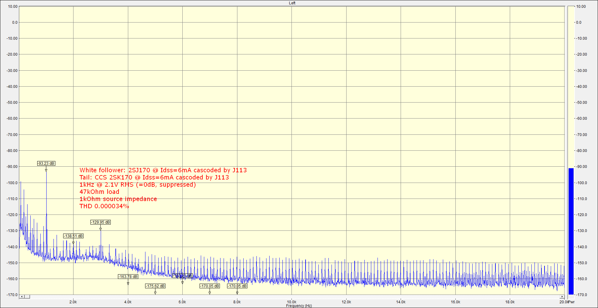

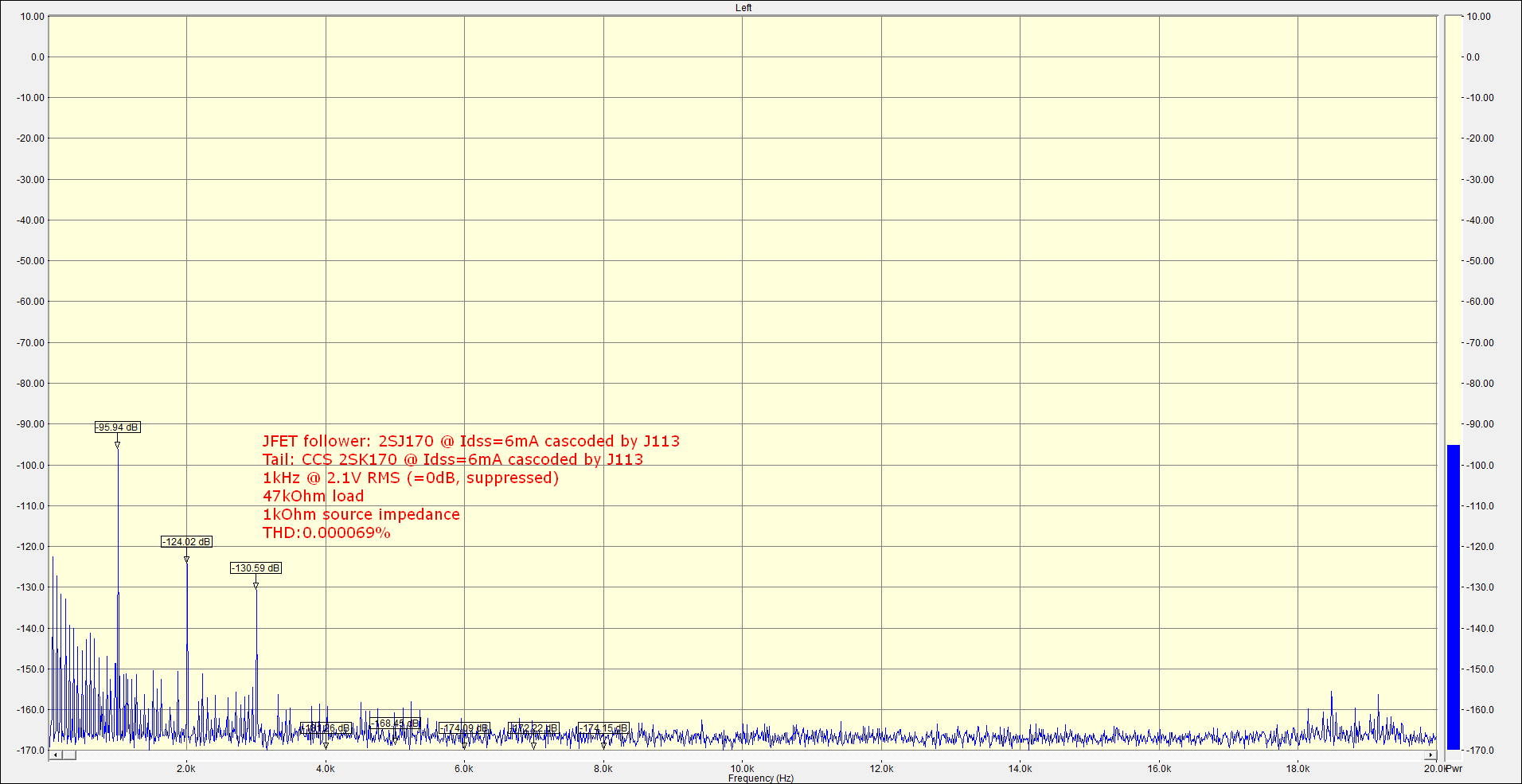

So far, playing with my simulation version, which should be pretty accurate, I understood the great benefit of the output current compensation. I’m much less convinced by the benefit of cascoding the FET. In fact, I’m more or less convinced that it’s a bad idea for a buffer that has already a low input capacitance, except maybe to increase the input voltage range. A "degenerate cascode" could maybe offer the benefit of a large input voltage without the drawback of a weird input impedance. Well, this design makes me think 🤔
  • Thank You
Reactions: ginetto61

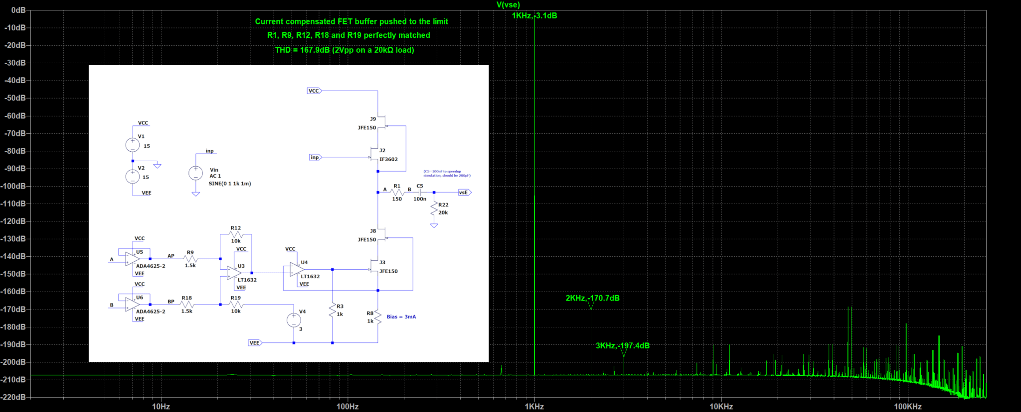

I made a big error in the previous post when I said that I was not convinced of the benefits of cascoding: it’s in fact mandatory because there is no way to have a decent distortion without cascoding.

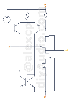

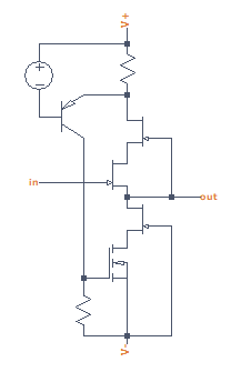

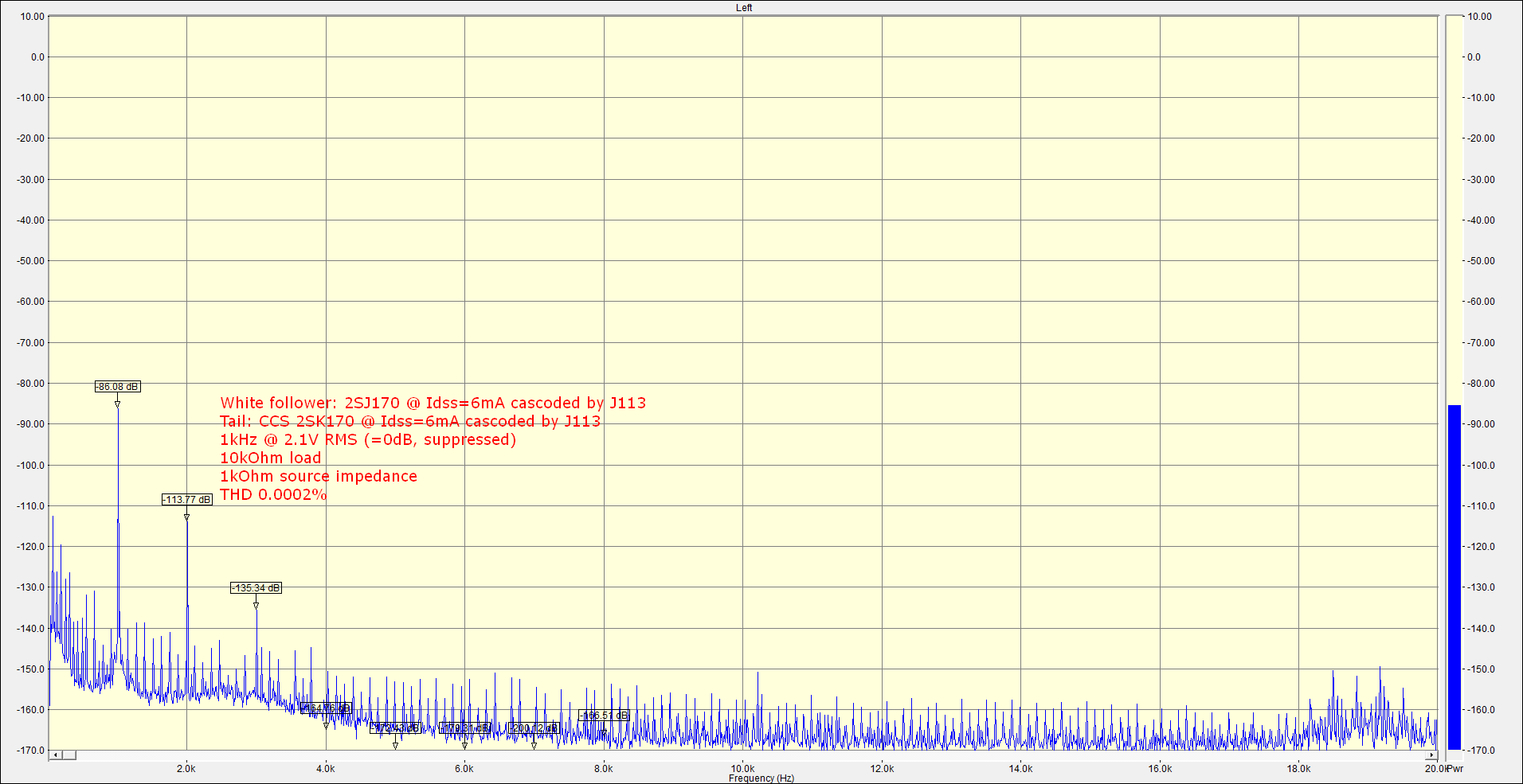

Anyway, I continued to play with idea of a designing a very low distortion FET buffer. My current result is in the picture that follows. I don’t know if it’s covered by Nelson Pass patent or not, but the idea is the same.
Anyway, this design is not usable for at least 2 reasons: it’s too noisy and the input impedance is too weird. But, the THD is quite good thanks to resistors that are matched to 0.05% (which I admit is crazy). However, there is no need to match anything else. Well I thinks it’s a kind of an upper bound of what is possible with currently available JFET.
