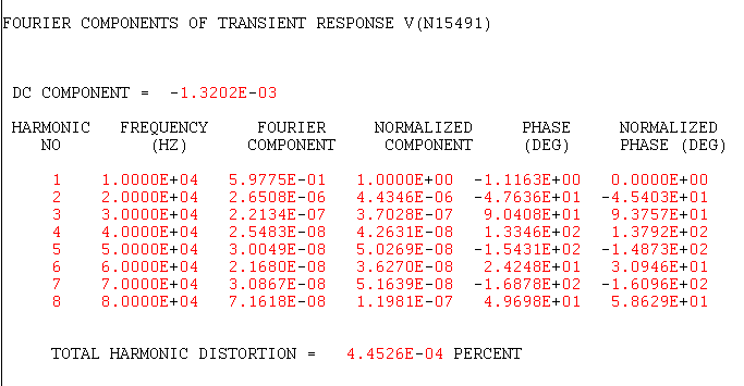

Anyway, here's the implementation using a mosfet/bipolar current source, and the sim distortion results - respectable. The driven current source is also providing properly mirrored output drive. I ginned up a board using a simpler approach to this concept over the weekend, and I'll be putting the circuit through its paces when I get the time.

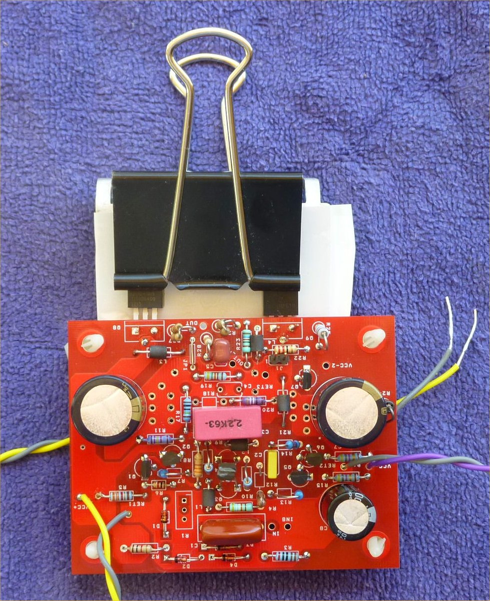

Here's the latest version of the Aleph HP amp using a depletion mode mosfet for the topside modulated current source. I'll be spinning this amp in two versions, one biased for headphone use, and one with a larger depletion mode fet for use as a ~5W class A amp to power some computer speakers I'm designing using huge PVC pipe elbows for the enclosures.

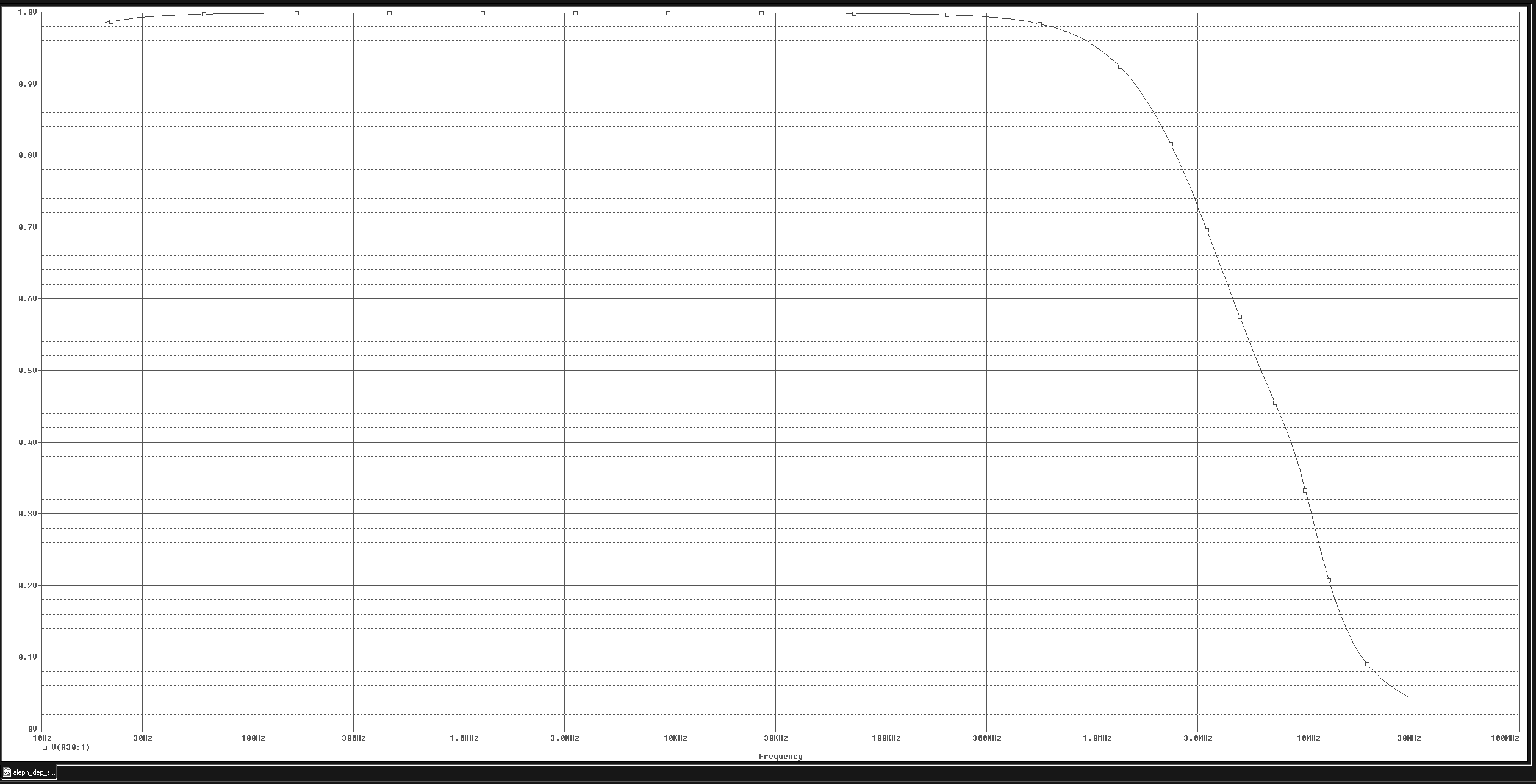

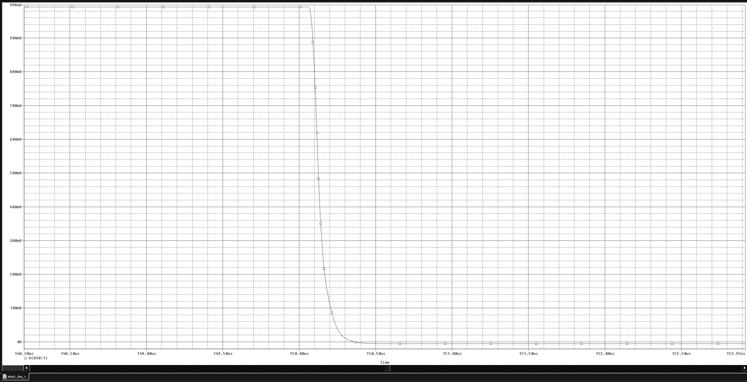

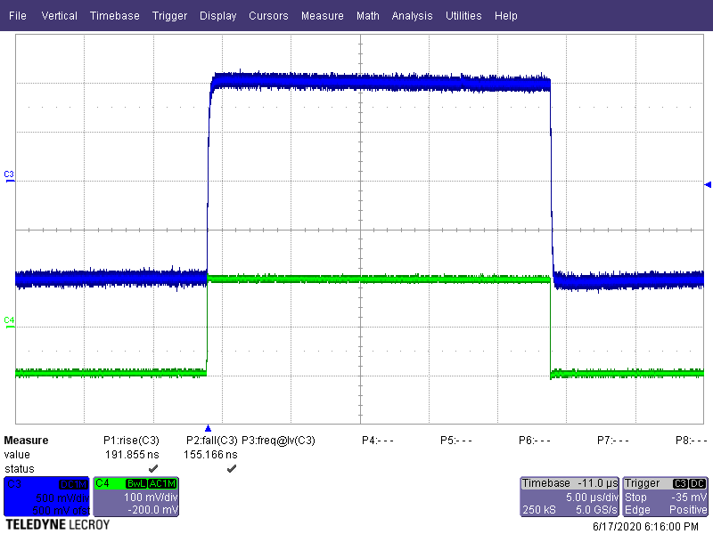

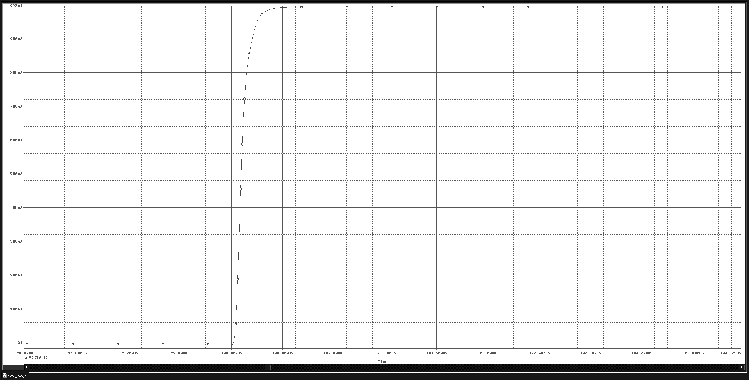

Here's the simulated time domain response to a 10 kHz square wave with 50 ns edges. The plots are expanded to show detail of the rise and fall times. I''ll be seeing soon whether the amp is actually as fast as the sim indicates. If I remember correctly, my signal generator square wave has only 100 ns edges, so the output may look very much like the input. I'm hoping for no funky ringing or overshoot.

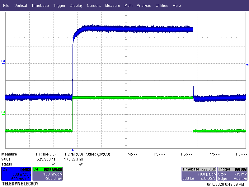

I finally managed to sit down and feed the amplifier with a square wave to get the response - things look agreeable... I will proceed with boxing up a couple of boards for listening rests, as well as spinning a version with 5-10W/channel, depending on how much dissipation I can handle with the TO-220 devices currently in place.

Here's improved transient response resulting from tweaking the rail voltages a bit. I'm going to have to poke around and study the schematic until I understand the sensitivity to rail voltage, though I have a notion... At any rate, I'm happy to see the improved response - zippy little critter. I'm reluctant to reveal the schematic, as I have had promising IP re headphone amp designs stolen & bowdlerized without original design credit in this forum before.

I've been working my way through various issues re the sensitivity of the square wave response to rail voltage, and I think I now understand what is going on. I'll be doing some tweaking, and will post more pics when I have them.
What I've found will also be relevant to scaling up this amp for speaker duty.

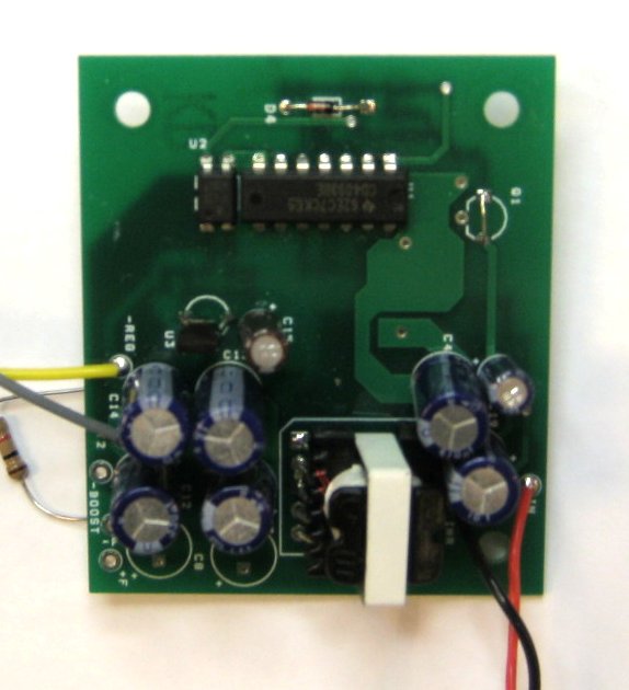

Here's the DC-DC converter I'll be using to generate the negative supplies from a 12V SMPS wall wart. The DC-DC converter uses a bog-standard CMOS logic chip as controller - no fancy stuff. All home-grown...

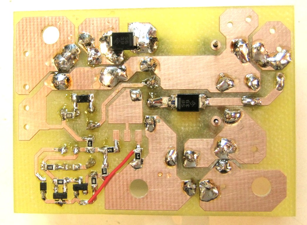

Here's an alternate flyback supply based on a classic "ringing choke" topology, used for generating the two negative supplies used on this amp from a 12V switching wall-wart that will power the positive supply. There is no IC controller, just a couple of bipolar transistors and a p-channel mosfet. As an experiment, I'm using a powdered iron E core instead of ferrite as the core of the transformer. I may switch back to ferrite if the losses are excessive, but if it works, the powdered iron removes the necessity of grinding a gap for the core, which is needed for ferrite.

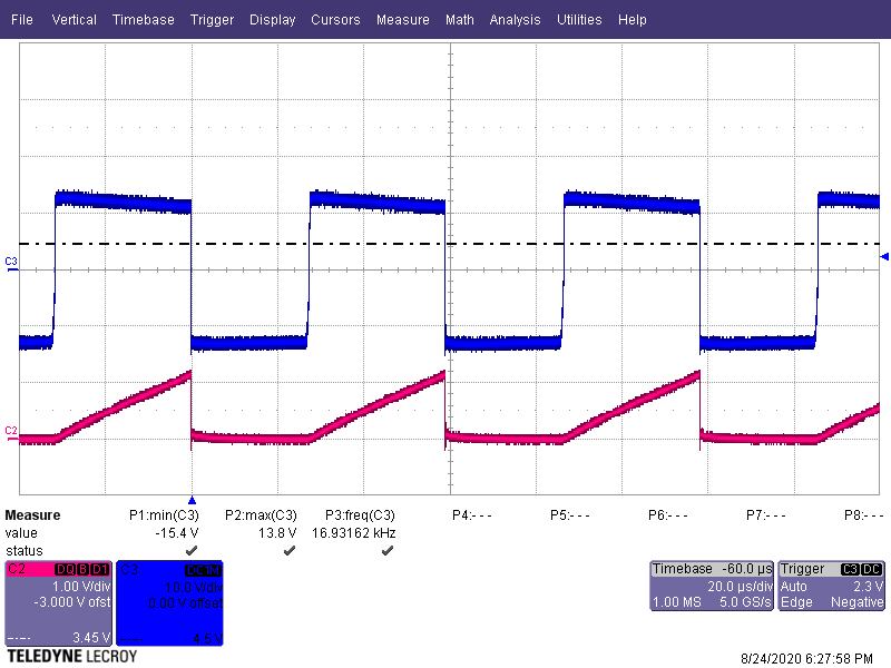

This morning I got the ringing choke converter up and running. Operating frequency is markedly lower that expected - I suspect it's due to the increase in permeability in a powdered iron core with AC excitation. I'm using Micrometals mix 52, which can double in permeability as a function of AC excitation. The low level inductance measurement shows a value close to the target of 200 uH. The current waveform shows an inductance value of almost twice the low level value. I'm going to try cutting the turns on the inductor and see what happens...

Here's the drain voltage and current for the ringing choke converter, so you can see my concern. The blue is the drain voltage (10 V/div), and the red is the drain current (1A/div). On the negative half of the drain voltage wavefrom, the trailing edge shows a characteristic rounding that shows that the converter is operating in borderline discontinuous mode, as it should. The slope of the drain current shows a large signal inductance of almost twice that of the small signal inductance value of 200uH. I will also be subbing a switch FET with lower RDSon, to counter the voltage droop happening during the device on-time.
