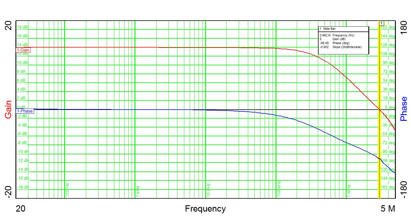

I've been wrestling with compensation issues with the Darlington - based incarnation of this amp, probably mostly due to the much higher transconductance of the Darlington devices compared to the mosfets previously used. I'm encountering a nasty resonance at around 2MHz which causes the amp to be conditionally stable, even though the time domain transient response looks relatively benign. I think the path to success will be to tone down the bias current on all stages except for the output - we'll see. I've also experimented with several placements for compensation, though none appears to be the silver bullet needed.

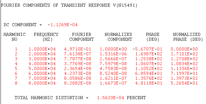

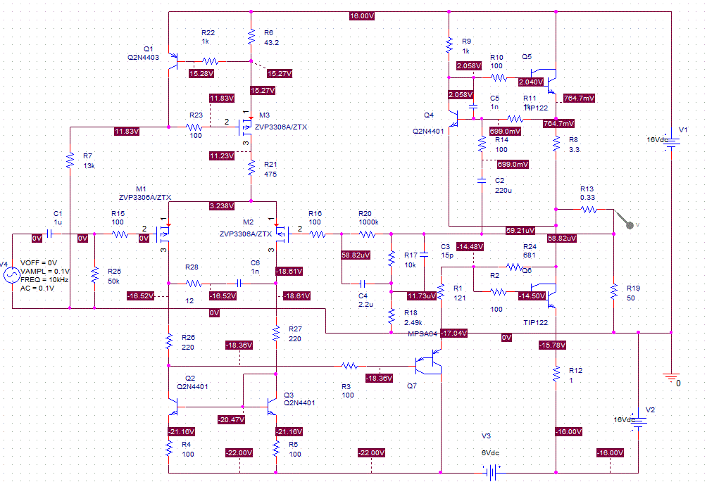

As a tide - me- over, I did a sim using Patrick's modulated current source scheme. As an aside, it looks like I used a similar circuit in one of my explorations for a "J2MeToo" sort of amplifier. See post #47 of this thread - IXYS 200V Depletion Mode Mosfet Now Available

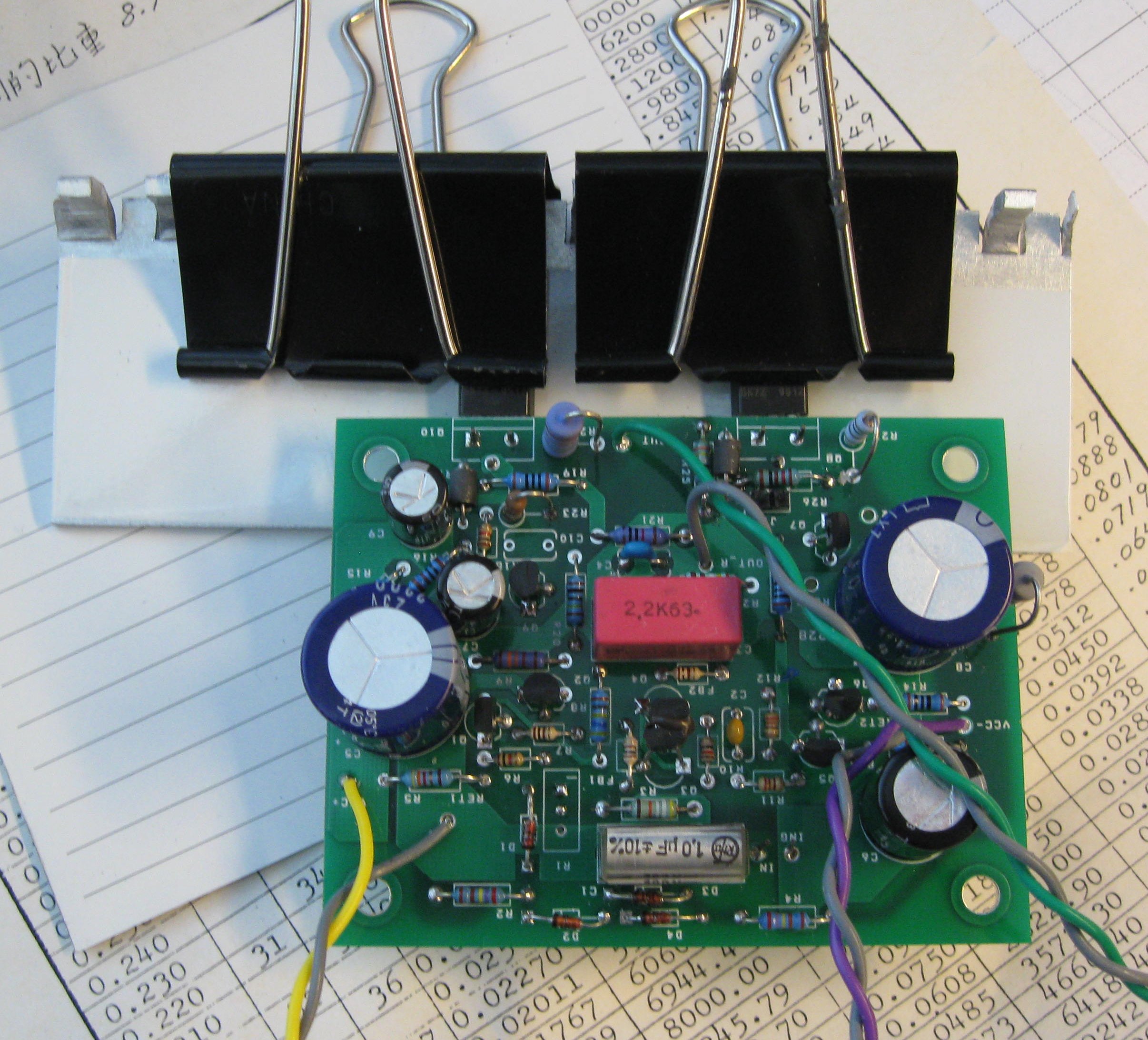

Anyway, here's the implementation using a mosfet/bipolar current source, and the sim distortion results - respectable. The driven current source is also providing properly mirrored output drive. I ginned up a board using a simpler approach to this concept over the weekend, and I'll be putting the circuit through its paces when I get the time.

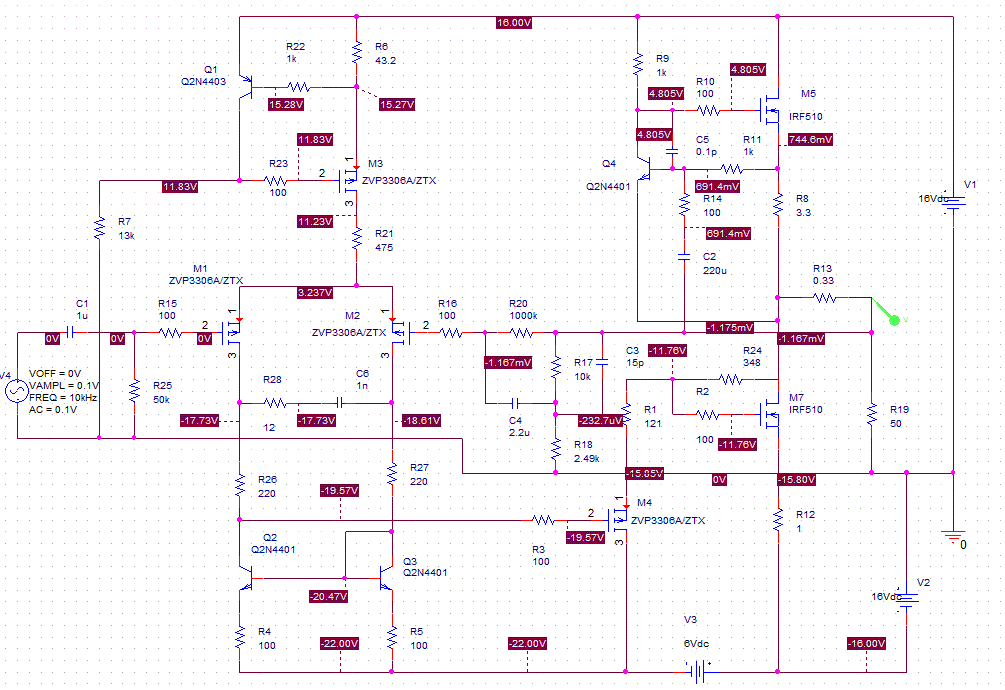

Here's the latest version of the Aleph HP amp using a depletion mode mosfet for the topside modulated current source. I'll be spinning this amp in two versions, one biased for headphone use, and one with a larger depletion mode fet for use as a ~5W class A amp to power some computer speakers I'm designing using huge PVC pipe elbows for the enclosures.

Here's the simulated time domain response to a 10 kHz square wave with 50 ns edges. The plots are expanded to show detail of the rise and fall times. I''ll be seeing soon whether the amp is actually as fast as the sim indicates. If I remember correctly, my signal generator square wave has only 100 ns edges, so the output may look very much like the input. I'm hoping for no funky ringing or overshoot.

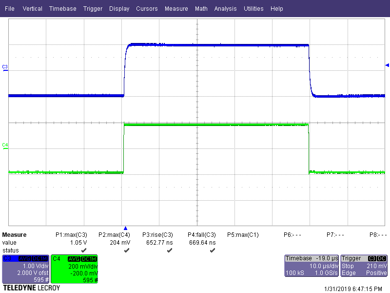

I finally managed to sit down and feed the amplifier with a square wave to get the response - things look agreeable... I will proceed with boxing up a couple of boards for listening rests, as well as spinning a version with 5-10W/channel, depending on how much dissipation I can handle with the TO-220 devices currently in place.

Here's improved transient response resulting from tweaking the rail voltages a bit. I'm going to have to poke around and study the schematic until I understand the sensitivity to rail voltage, though I have a notion... At any rate, I'm happy to see the improved response - zippy little critter. I'm reluctant to reveal the schematic, as I have had promising IP re headphone amp designs stolen & bowdlerized without original design credit in this forum before.

I've been working my way through various issues re the sensitivity of the square wave response to rail voltage, and I think I now understand what is going on. I'll be doing some tweaking, and will post more pics when I have them.
What I've found will also be relevant to scaling up this amp for speaker duty.
