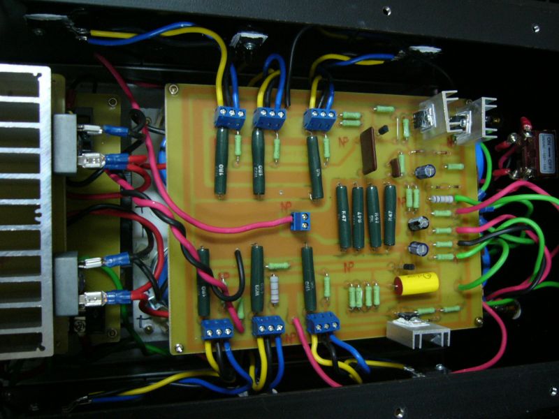

I would shut everything off and pull the board. Check all the solder joints and replace Q4 and 5. Not being there it's tough for me to suggest anything else at this point.
No, just the bad one, assuming the other one sounds fine. It wouldn't hurt to check all the resister values too.
Thanks for the email. I just replied you. Ok, I will pull out the board. You suspected bad solder joints and bad Q 4 and 5?
The other good channel sounds fine with the xlr but not any more with the RCA. There's a slight buzz hissing sound when hook up the speaker.

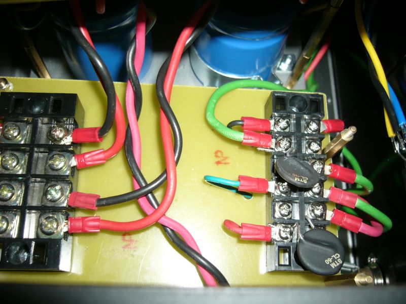

Power connection
Please look at image 'earth connection'. On the right is how i hook up the connection from top down :
1) cold (black)
2) gnd wire (green) is connected to star gnd
3) gnd wire from chassis (connected from IEC)
4) transformer gnd (on left) and gnd wire connected to star gnd
5) Live wire (on right) from IEC
6) Live wire from transformer
Item 2 and 3 is connected by the CL40 thermister
Item 5 and 6 is connected by the CL60 thermister
