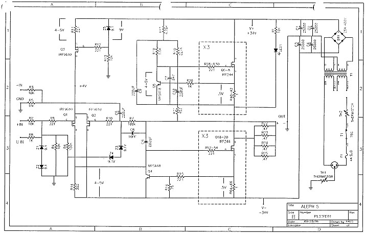

I can't post the whole service manual as it is too large. But you can download here http://vidar.hallais.no/media/download_gallery/Aleph%205%20(60w).pdf
It looks close, everything is biasing up OK. The only thing I question is the voltage across R28-30 and 52-54.The cone movement is normal unless it's staying in. Check out your grounding to the power supply and your input wiring and connections. 24mv isn't terrible for output offset.

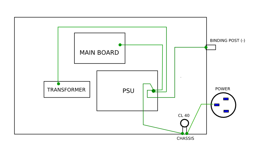

For the R28-30 and R18-20, is it ok to have more than 0.5v as recommended? I used a starground to connect all gnd wires, including the transformer.
R28-30 on the schematic are grid stoppers, 221 ohm. The output fets are biased around 20W each, no problem unless the heatsinks cant handle it.
You have .9xx V for R29 on one channel, check which resistor you actually mean. If that's a source resistor that fet is way off spec.

But for the R29 - 220 ohm which feeds the Fet of the R41, I am using a metal film 220 ohm resistor. The rest are ceramic as the supplier is out of stock for the ceramic ones. Should I change all to metal films? Could this explain why I got a higher reading on R41?

The grid stoppers shouldn't affect your bias, there is only two explainations for the differing voltages across your source resistors. Either the resistors values are off or the fets arent matched, or both. The amp should still work though.

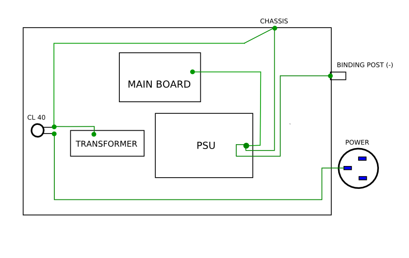

Your grounding scheme isn't exactly right, the AC power ground should go directly to the chassis. The transformer and all circuit grounds should go directly to the PSU, then connect the thermister between the chassis ground and the PSU ground.

If R41 is indeed a 1 ohm resistor then that fet is passing 40% more current than the rest of them. Something ain't right!
You're grounding scheme is correct if the thermister is installed between the PSU and the chassis, it's hard to tell on your drawing.

Thanks Bill, i will change the Gnd connection and see what happens. It is kind of scary to see the cone moved so much, kinda of half an inch. I have a 180mm woofer.

The Fet connected to R41 with 0,901mV seems to be badly matched. Just try another one from the lot you used for matching.
