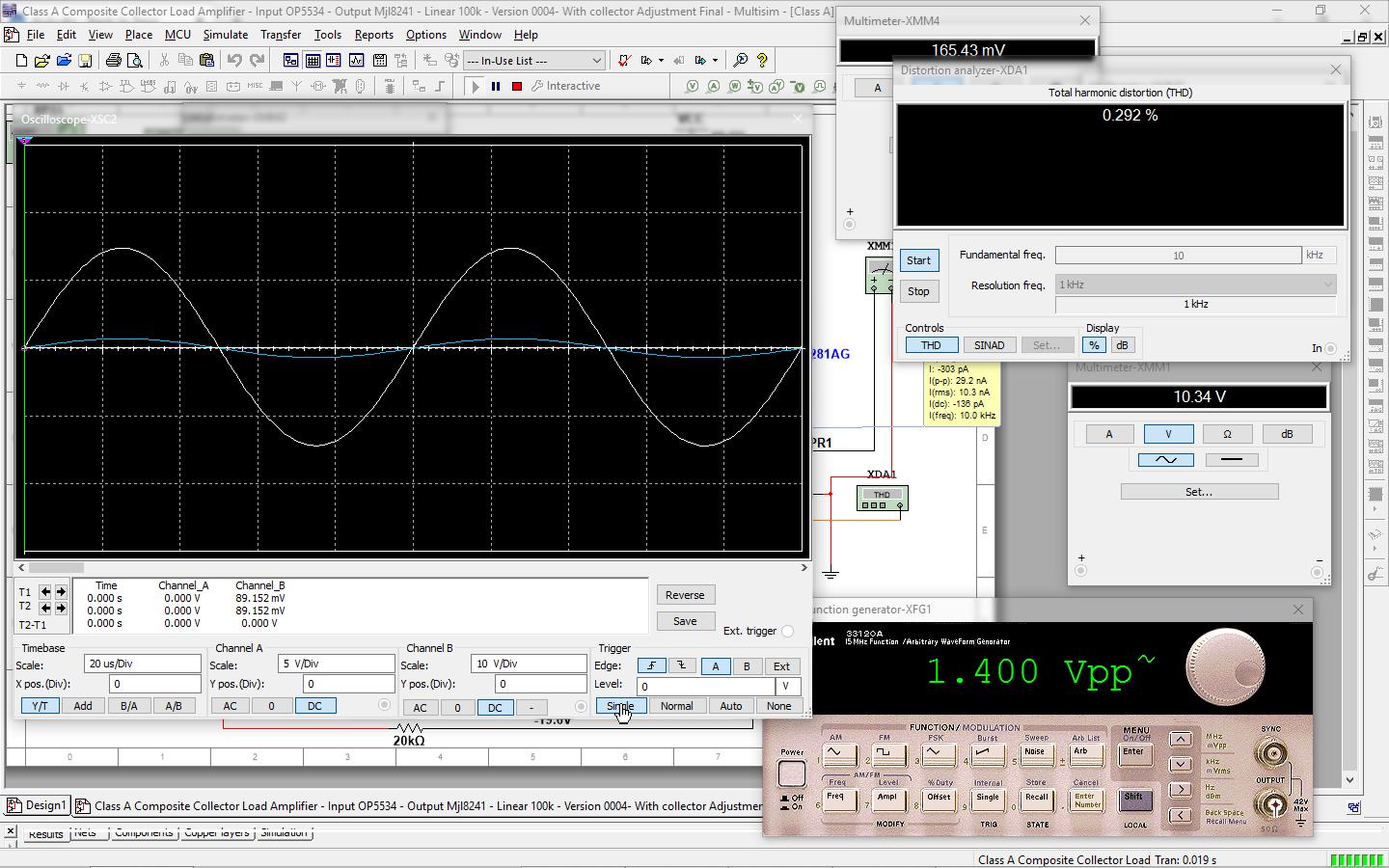

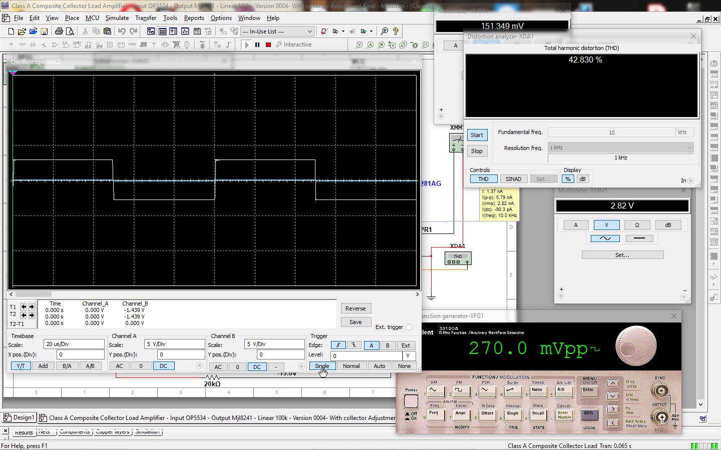

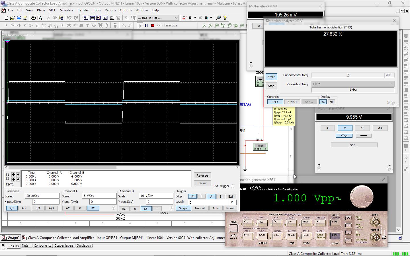

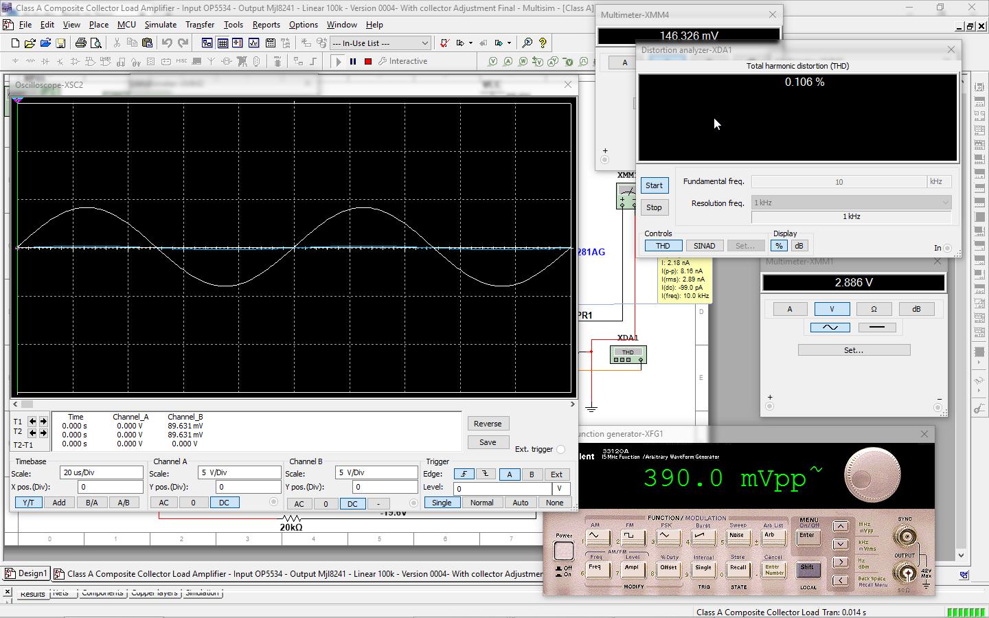

@vacuphile, I do not agree with you
Sorry I think you are mistaken.! You can hear the difference very well and latest you will know when the Tweeter is sending out SMOKE SIGNALS.
In the picture it shows a simulation.
1. Sinus 10 Khz@10 volts output and 0.292% Distortion.!
2. Square 10Khz @10 Output and 27.832% Distortion.!
You will hear this as clear as the Amen in the Church after Sundays Church session has finished.,
Just take out your function Gen, a Oscilloscope, Distortion analizer, and Old tweeter which is no need anymore, because it will be distroyed.
No need to Amplify the signal up to 10Voltsp-p just 1 Watt is enough..
Then Open your Ears and listen to it.. And there the Tweeter blows..
Pic 3 & 4 showing the same Example @ 1 Watt RMS
If you need a Video REAL TIME I can make one for you..
Never input Square wave above 100mili Watts into your speakers, it will definatley kill them and before it does this, you will hear that nasty sound of the SQUARE Wave.
