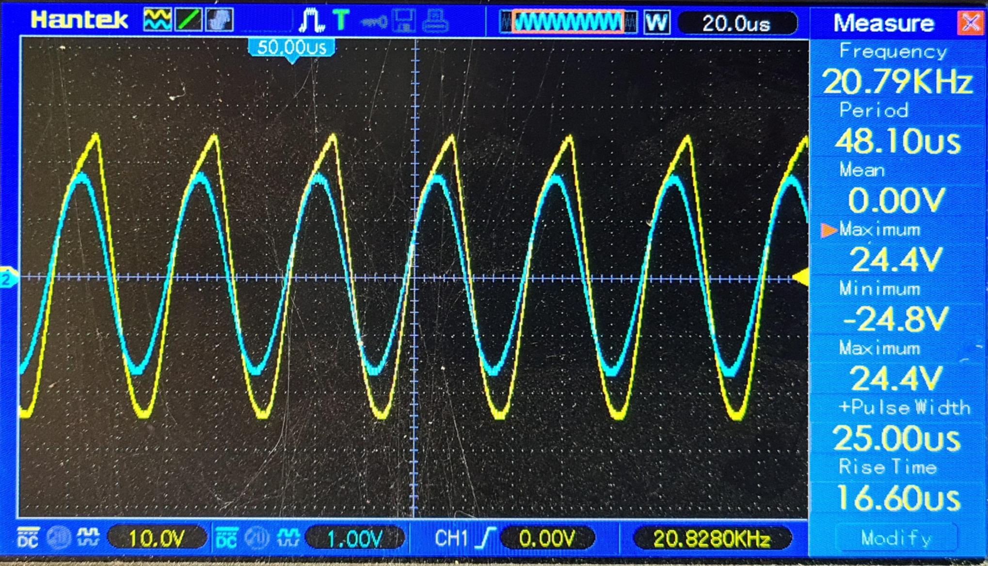

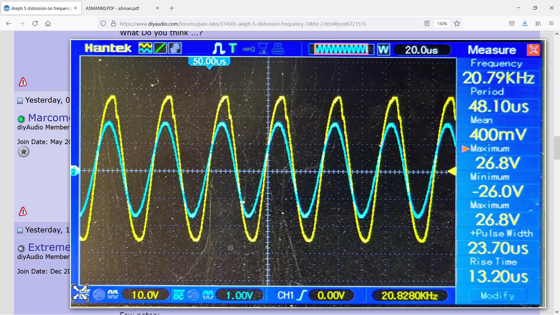

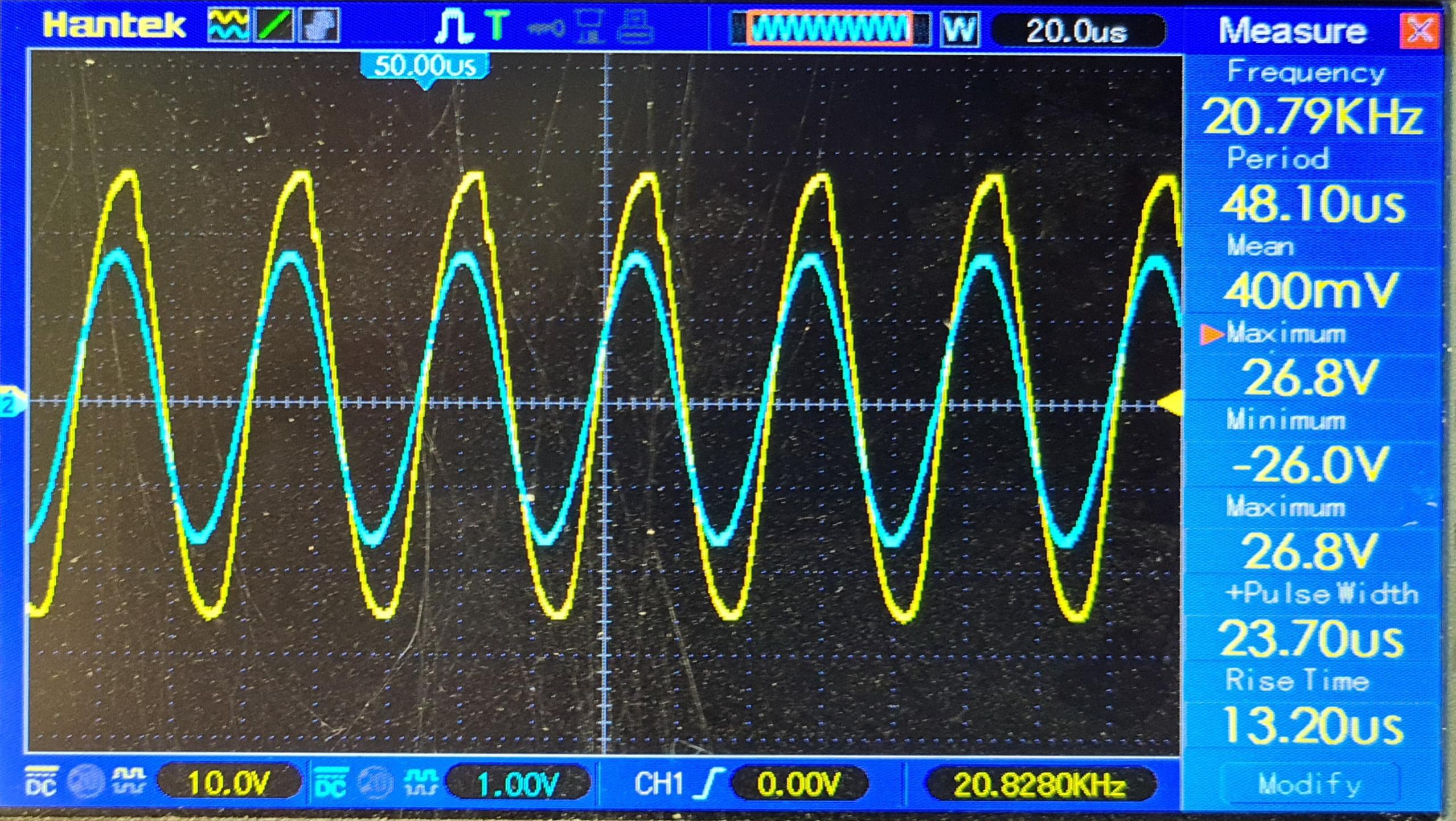

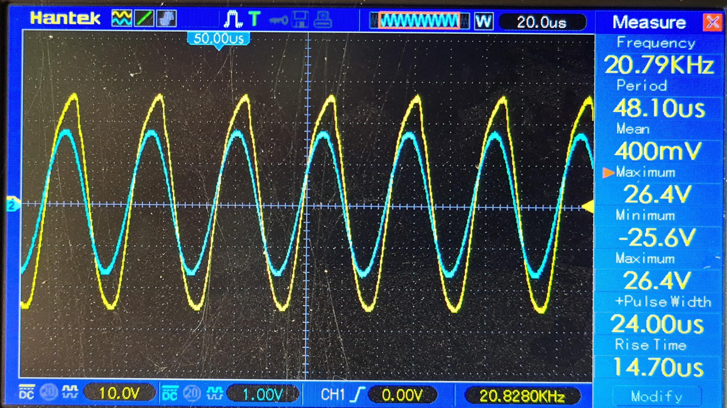

one thing:
only well experienced Greedy Boy should try feeding an amp with 20KHz and shoot for clipping
your 20KHz power graph shows 53Vpp ......means 18V7rms, which is 43W@8R ......... jolly good
Aleph isn't Laboratory Amplifier - not made for that and no need to be used as that
in short - first ask, measure later
Have you looked at the specs?
In the oscilloscope image the fdo have 26.8 volt peak, the rms volts are less .....
Marco

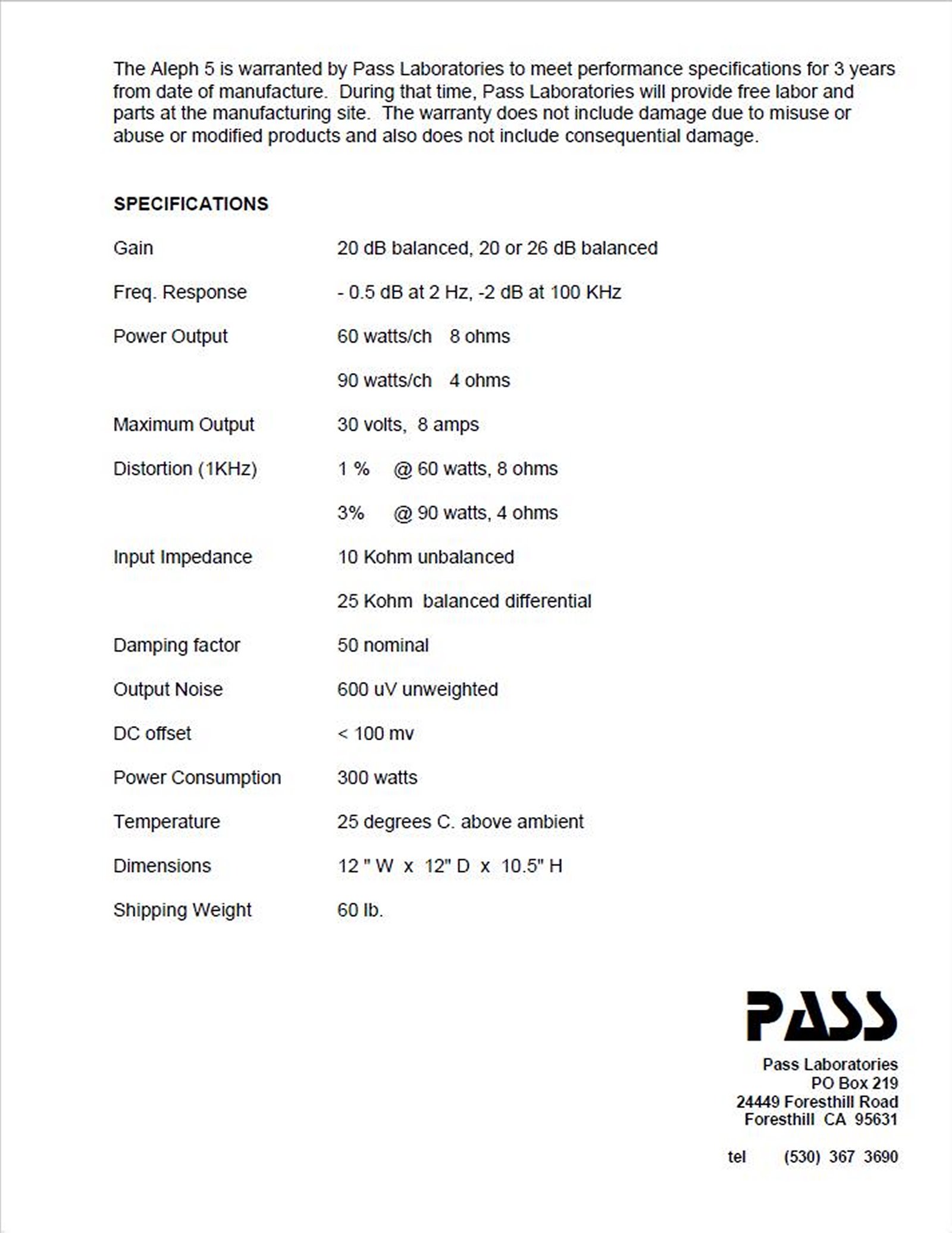

Nelson Pass explicit set 100KHz to - 2 db if you now calculate it to 20Khz then you will see that this is within the spec. and 20K / 100Khz is closer than 1 Khz to 20Khz..
More: Also Nelson Pass wrote, that the Amplifier would deliver 60Watt@8Ohms and !!!!! 1% Distortion, but it is not stated where this distortion occurs. Find out where the point is with less than .5% Distortion @1khz and then make the same test @ 20Khz or even @ 100KHz again, and you will see the outcome is the real thing, which actually should blow your worries away.
Now you overdrive it into 78Watts Peak and find only about .2% distortion. My Question to you, is it really necessary to improve anything..
On last thing: Class A Amps are more than high fidelity, these are HIGH END FIDELITY amp and with good speakers connected you will not need more than 1.5 Watts in your room, to have it real loud with high quality sound.
This should count more that everything else.
Cheers my friend.. I just hope you will not improve it to the negative side of Quality..
