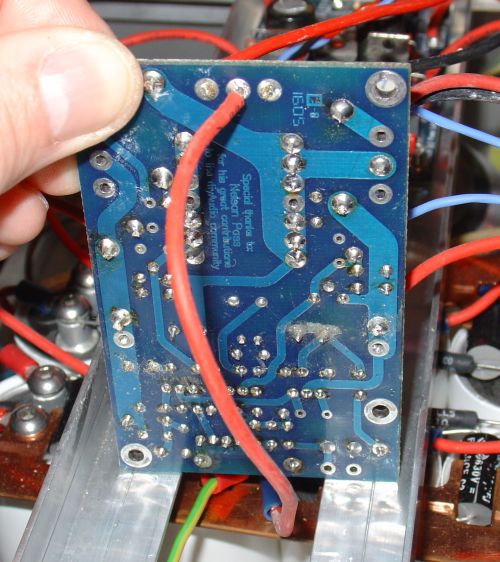

and I have notice something strange at least visualy...bacause I don't think that I solder this bad ;-) but the PCB under Capacitor ( I think it's C11 ) looks burned ?
not shure is C1 on this pcb the C11 on original shematic ?

Here it is again with red cloud ;-)

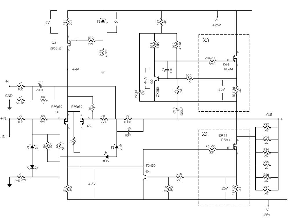

yoke , it's useless ( at least to me ) to post without known nomenclature ;
use this schematic , and just disregard part names on pcb ;
I know ( and have in my PC ) too much Aleph schematics , to even remotely be sure what you're talking about , without exact schematic ...
I hope it will help

you are rigth
there are several schematic of Aleph30 with diferent markings...
and it's been a while since I build this ;-)
lets resume
power is +/-22V
I have around 13V on the output
R11 - 5V
R14 - 2,5V
Z5 - 9V
Q5 - from c to e 4.6V from b to e 0.6V
Q4 - from c to e 5V from b to e 0.6V
Q 6-8 source resistors 0.5V
Q 9-11 source resistors 1V
