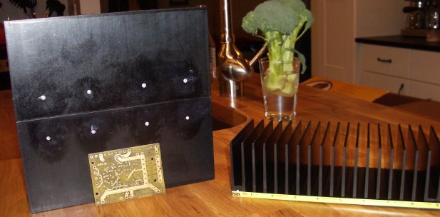

I picked up a six of these heatsinks from BGMicro. Their shipping is kinda high, but the price for the sinks makes it an ok deal.
I can't decide if I need to use two or three of them per channel.
Use all of them! You probably allready heard that an Aleph 30 needs heatsinking? Think again, it needs a lot of heatsinking!! Just connect those fets, though leads and spread the heat as good as you possibly can!

Pathmark, looks like you will have good heatsinking, I have not yet bought any parts!
I think the thickness of the heatsink base plate is important, a thicker plate will spread the heat better and avoid local hot spots.Still looking at ebay. 🙂

I received heatsinks yesterday and they look great, thick base but as everyone keeps mentioning I am still worried about the heat.
Pathmark
JFTR,
the heatsinks Bugg got for his Aleph/30 are not only great, but so cheap that i'm too damn jealous to be nice.
Even by the 6 in a cheap USPS Mondiale box, they'd cost me an additional $15/pc in mailing and dot-dot-dot taxes to buy them myself.
Bugg can expect 0.35 C/W at the least from a single one of his heatsinks, possible even a lot less if it's an efficient design. I hate you, Bugg.
According to Rod Elliott's heatsink calculator spreadsheet they should do .39C/W. With only 2 fets on each one I would think this thing might almost be kid safe. I couldn't imagine finding anything this size for so cheap. They are used but the ones I got don't have any obvious scratches.

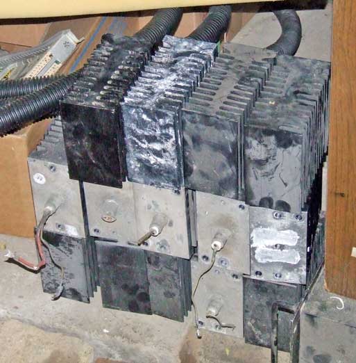

jacco vermeulen said:
JFTR,
hehe
look at these.......each capable of coolin' ~50W with 25 Celsius rise above room temp.......
on pic-middle row,most right-you see two white marks ....of 50W Golden Dales ,used for measuring;
I have 4 more ,not on pic,slightly taller........
these 14 + 4 cost me 90 bloody Euros at junkyard.........they even lowered Al prices later........I hate them!
