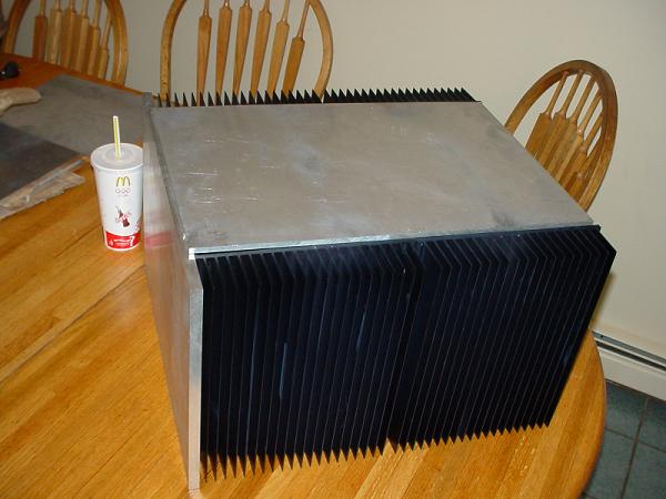

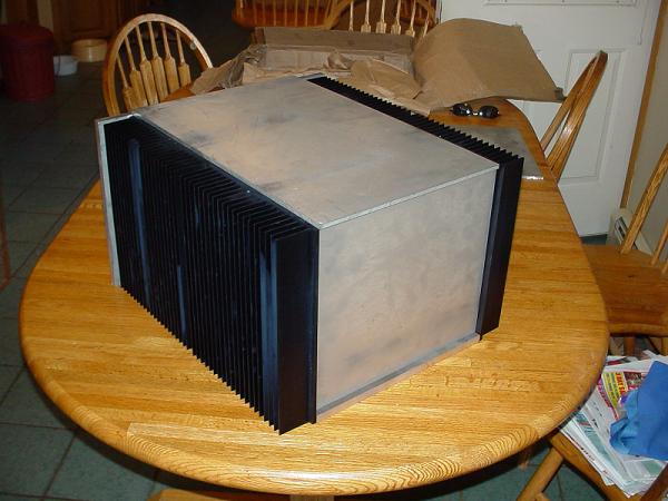

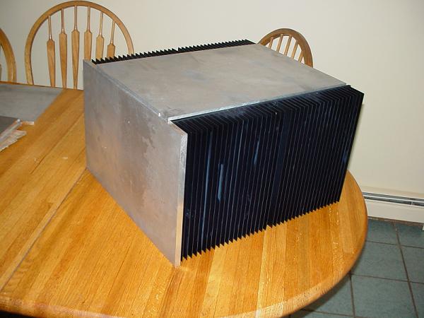

Being very busy these days with work and being broke I've been piecing this together slowly, but its well worth it, so I thought I'd slap something together, throw a few pics out and get some comments.

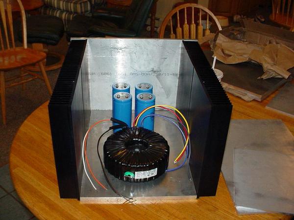

thats a 1500VA trafo 38V sec
49000uF caps
1/2" baseplate
1/2"frontplate
1/4" backplate
1/4" top plate
With the higher voltage on the secondaries, I plan on mounting 3 transistors on each heatsink, there are a total of four sinks per monoblock @ 12" x 9 7/8" x 2.3" high fin. These babies are gonna be hot and heavy weighing in at 95 to 100 lbs each.![devil_r :devilr: :devilr:](https://files.diyaudio.com/forums/images/smilies/devil.gif)
