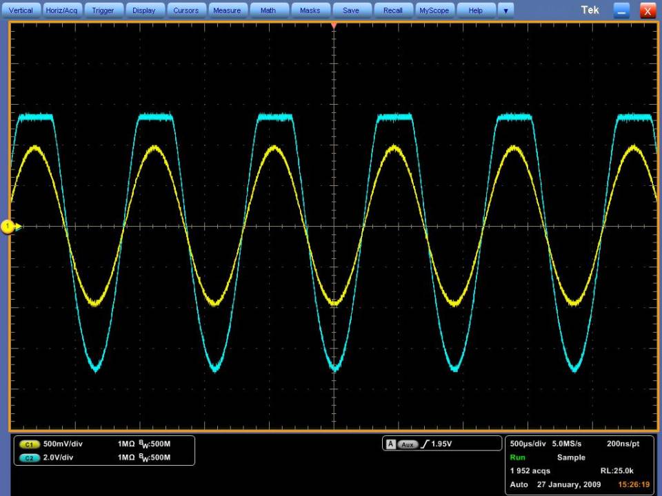

Well, I've been pounding on this failure for some time now, and I'm still not able to find the culprit. Here in the lab, I have hooked up the Front End PCB to a 1/6th scaled down output stage, and a 10 ohm resistor load. The supply is now +/- 20V
I have replaced all semiconductors except Q3 and the zener diodes, but the problem simply remains. I have attached a scope screenshot.
The yellow trace is the input signal, about 1v peak-peak.
The blue trace is the output, connected to a 10 ohms resistor.
As you can see, the output clips on the positive side, about where the input signal exceeds 600mV. If I reduce the input to below 600mV p-p, the amp stops clipping. If I remove the input, a small DC (about 200mV) remains on the output, but it is very noisy.
It appears something as if there something wrong in the differential stage. from the 15mA sourced by Q3, about 12mA passes through Q1-R14, leaving just 3mA for Q2. A clear unbalance. Also, Q1 Vgs is about 4.02V, and Q2 Vgs is 3.85. Apparantly just against saturation. Voltage across R14 is 4.21V, and it measures 392 Ohms as it should do.
Voltage across R16 is only 200mV, but 500mV across R15-R16.
Any suggestions?

are you using matched devices for input LTP ?
remove temporary Z1,Z2,Z3,Z4
replace both Q3 and Z5 ....... 15mA isn't enough through CCS ;
I have found lately several specimens of zenners to not have proper voltage
LTP = Q1 - Q2 Differential pair? Yes. They are matched to <50mV. Not as good as the ones I had in first. They were <2mV
I've removed Z1 - Z4 --> no effect
I've replaced Z5 with a 10V type (didn't have another 9.1 at hand) --> no effect
I've replaced Q3 --> no effect.
I have unsoldered R7 / C8, values are OK, as far as I can check without unsoldering everything, all R's seem OK
I'm going mad here...

first thing first ;
isolate just input stage ( LTP , diff. whatever you call it ) ;
try it and be sure that you have needed ...... and equal current through both mosfets .
only then you can try further ........ again soldering only important components ......

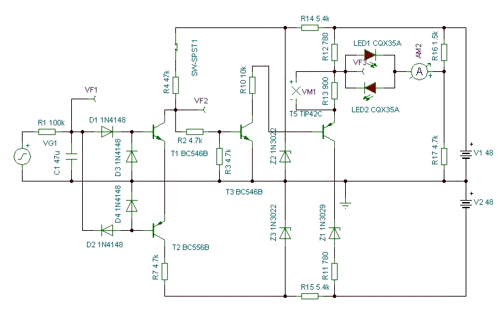

DC protection circuit
Congratulations...your Aleph 2 is beautiful. I made Aleph 4...and I'm also very satisfied. If you are interested I used some DC protection circuit in my design (I like my speakers and don't want blow them on first amplifier failure).
R1 is relay coil resistance (I used FINDER 40.61 24V/900R, one pole)
Here are all schemas: http://www.facebook.com/album.php?aid=158500&l=a5f40&id=1386409150

Debug - step 1
Thanks Zen Mod and Majerovic for both you help and advice... I can use some expertise here...
So following Zen Mods thinking I'm now trying the systematic approach. This is step 1:
I have isolated the Current Source Q3 / Z5 and surrounding R's. Q3 - Drain is linked to GND. Supply is now 50V across the positive rail (V+) and Ground
- With a 10V zener and new IRFP9610 it sources approx. 25mA. Voltage across R11 = 5.4V, Voltage across Z5 = 9.5V.
- With the original selected zener, Isource = 23mA, V_R11 = 5.1, V_Z5 = 9.17V.
- With the original selected mosfet and zener, Isource = 22.7mA, V_R11 = 5.05, V_Z5 = 9.14V.
I checked C5 yesterday. It is fine, and polarity is ok.
Next, the diff pair.
