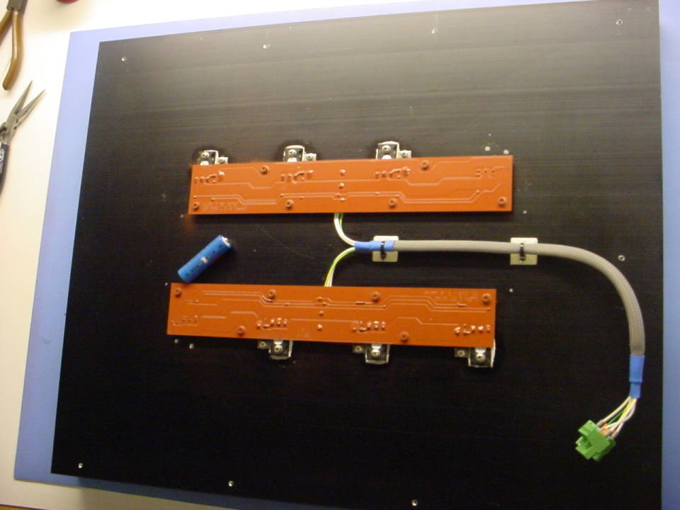

Below is the Heatsink Assembly. I have 4 of these, 40cm x 50cm x 4cm, with a thermal resistance well below 0.2 K/W each...😎
As you can see, the mosfets are already pre-assembled, and again the PCB's have conformal coating. There is room for an additional set of fets here, should I find the amp could use an update (however unlikely) It can be done without an entire re-design... Even the holes are already there... 🙂
Note the penlight battery, I put it there for scale...

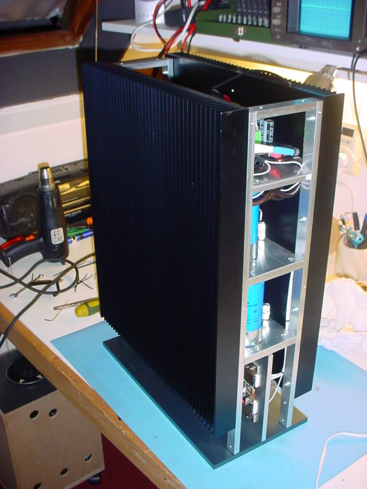

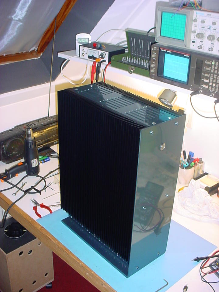

So, after about an hour of struggle to get all the holes properly lined up, and then to secure everything properly, here's a good milestone... Both heatsinks are attached and connected and now I can perform a first test to verify operation.
We should play this Aleph on your speakers man, I'm sure that will sound sweeeet... 🙂
This is me again performing the first functional tests... everything is working great... the switch on is still quite a "thump" for the mains, and you can see the lights flicker sometimes heheh...
In the front you can see the high-power dummy load I use for testing.. it saves me a lot of speakers this way...
I should here also acknowledge my sweet girlfriend... I'm the most lucky DIY audiophile in the world with a girlfriend actually helping me building these monsters... The dummy load is her work.

This is my girlfriend wiring up the front button. You can see the front panel is already mounted.

As I will be testing amp number 1 today, I will assemble the second one.

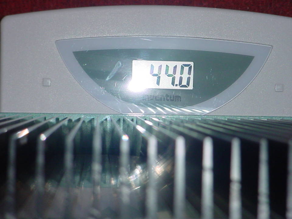

I knew it was gonna be heavy metal, but what is the weight of that thing?
To answer that question, I put it on the scale for you... Here's the result. I'm not afraid someone will try and steal my audio 😀

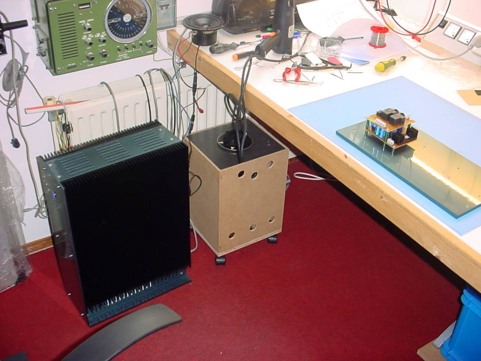

All righ all right! Hold your horses 😉
I've started on No. 2. Number 1 is running on a small speaker, connected to the radio. Gives me some music to listen while building AND i'm testing...
The wooden box is my 2.2kVA isolation transformer with variable output. Safety first gentlemen, when fooling around with mains connected equipment, use an isolation transformer!
All righ all right! Hold your horses I've started on No. 2. Number 1 is running on a small speaker, connected to the radio. Gives me some music to listen while building AND i'm testing... The wooden box is my 2.2kVA isolation transformer with variable output. Safety first gentlemen, when fooling around with mains connected equipment, use an isolation transformer!
