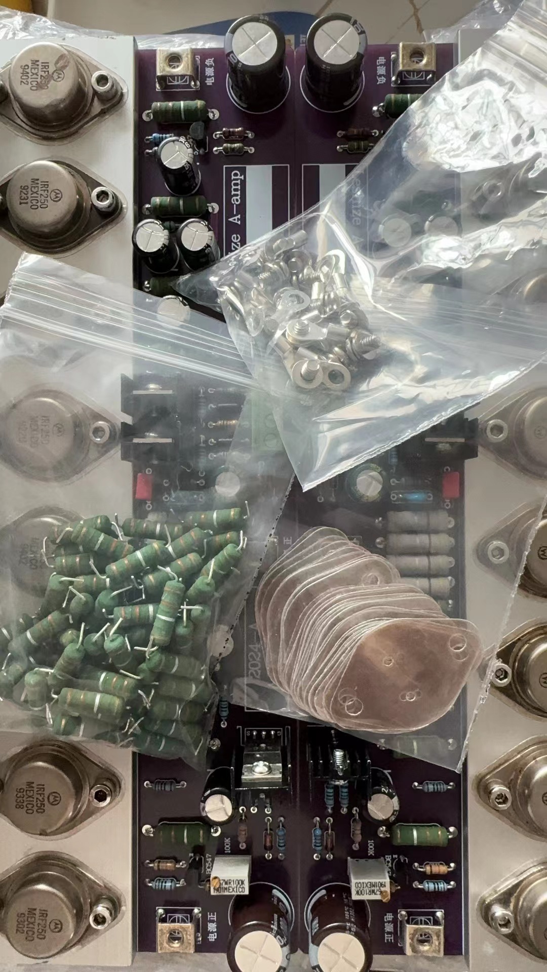

I am building two pairs of A5 clones to use with active crossover. well, sort of A5 for I do not know how to call it since I intend to run it with approx. +-38V (28V transformer output), 4 volts higher than A5 but 7 volts lower than A2, probably get around 70W with it. Intend to drive my speakers with low impedance of 6 ohm norm. and 1.5 ohm min.
Bought the kits from China, but also bought extra MOSFETs with it, so there are a total of 72 matched IRF250 between them, and another 16 matched IRF250 (4 sets of 4, but not matched to the 72) for the original set of A5.
Thought I will use 36 MOSFET in each pair, I.E. (9+9) MOSFET in each channel. The 16 MOSFET that are not matched to the 72 will be left out for now.
The vendor is still trying to look for another 24 matched MOSFET, if I am lucky then the amps will have 24 MOSFET per channel, same as Aleph 1.2 but with only 1/3 of the power of 1.2.

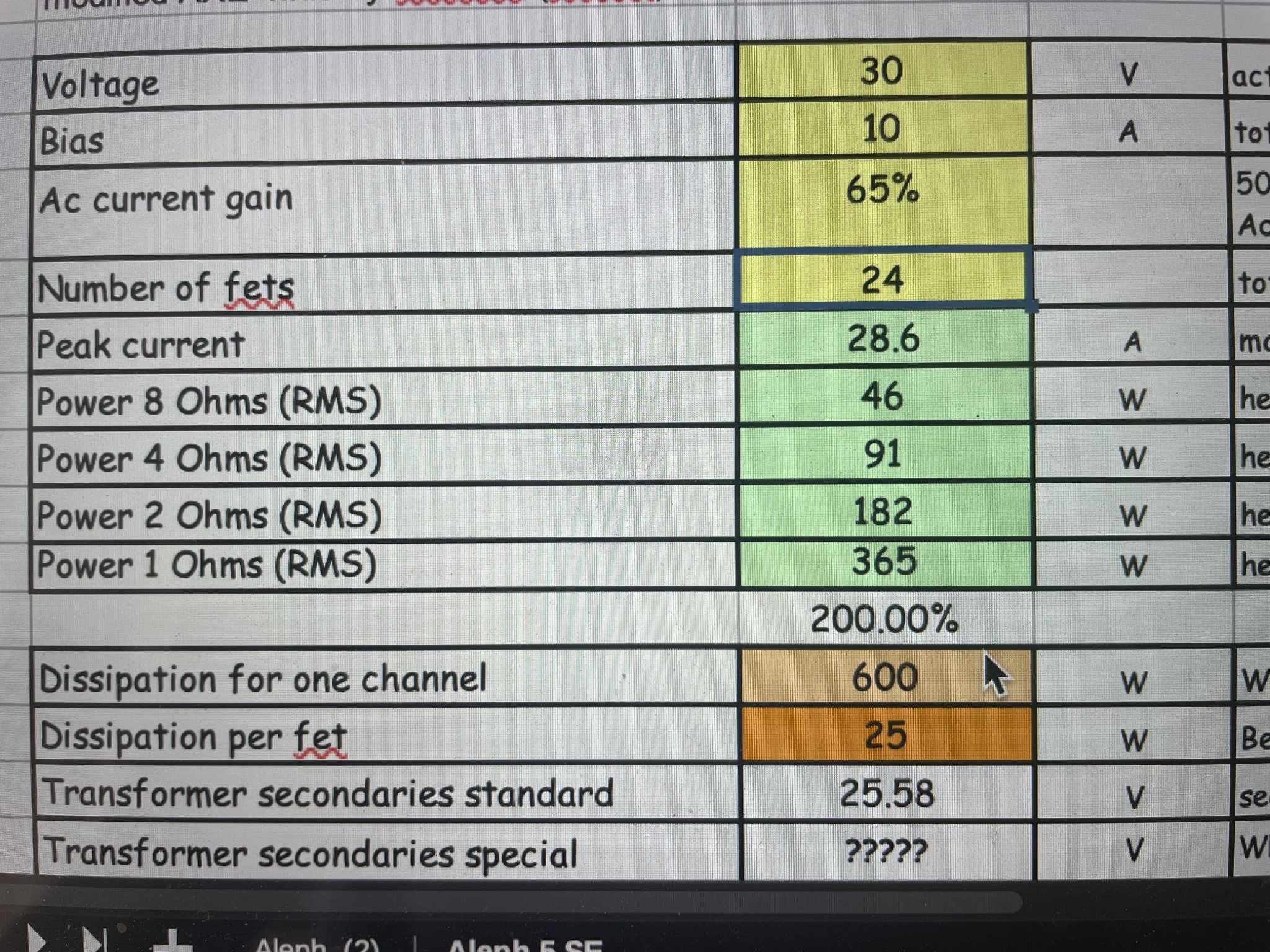

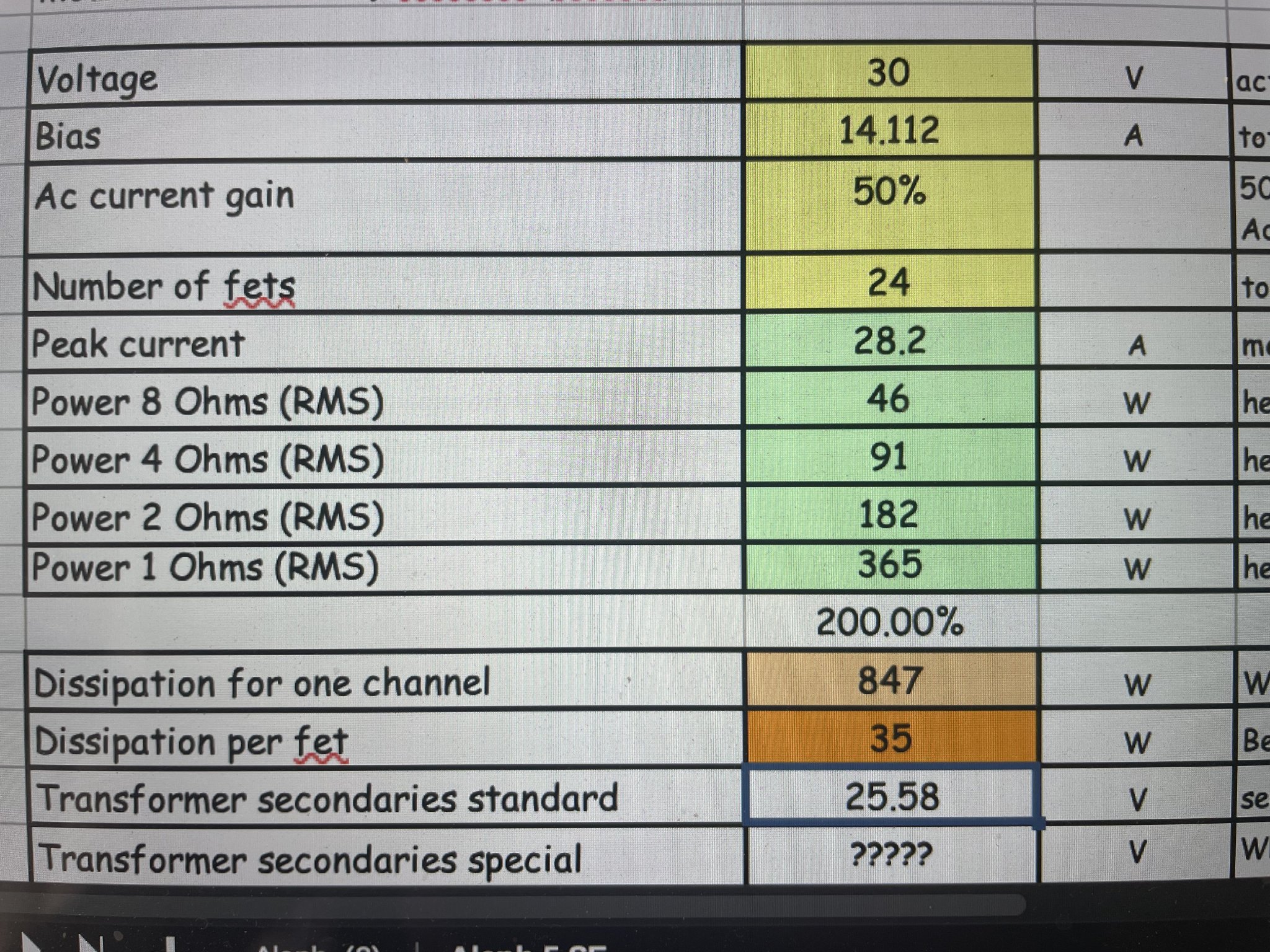

Questions:
1) what is the effect of bias current on sound quality (10A vs. 14A as in picture 1)? and/or others, I noticed that the dissipation per fet shot up when I have a higher bias current, trying to recall my school days 35 years ago, does it move the quiescent point, which should be adjusted so that the signal output wouldn’t clip.
2) what is the effect of AC current gain on sound quality (50% vs. 65% as in picture 2)? and/or others. If higher percentage of current is by the current source, does it make the current source MOSFET hotter? should it be 50/50?

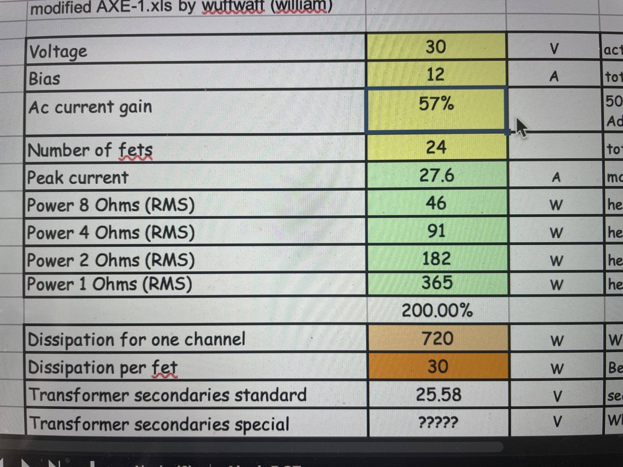

And if I have allowed (by varying bias current and AC current gain) for full output at 1 ohm, and sufficient no. FETS to ensure that it doesn’t overheat, do I still need to allow for extra VA capacity in the transformer wattage? The rows that read for factor 2, 3, 4…
🤣 well, I didn’t know where to start and 10A was there on the spreadsheet…, but I was going to use a 2500VA transformer for each channel, based on the fact that if I wanted to have around 75W@8 ohm and 600W@1 ohm, and allowing for the low efficiency of single ended class A…. And enormous heatsinks were planned for. And this excel table is really useful to help me to optimise the voltage rail (hence power) based on various restrictions.
In any case, in order to be able to drive 1 ohm load, either the bias current or AC current gain will have to be increased to meet that requirements. My previous guesstimate of +-38V voltage and 75W @ 8 ohm will have to be reduced to +-30V and 46W@8 ohm.
QUESTION: would +-30V voltage rail hamper the dynamic performance of the amplifier? Would it still produce the same audio quality as the Aleph 2, despite having as many MOSFET as the Aleph 1.2
I may have to reduce the rail voltage (if it does not affect the audio quality) lower based on my normal listening sound level. Would it?

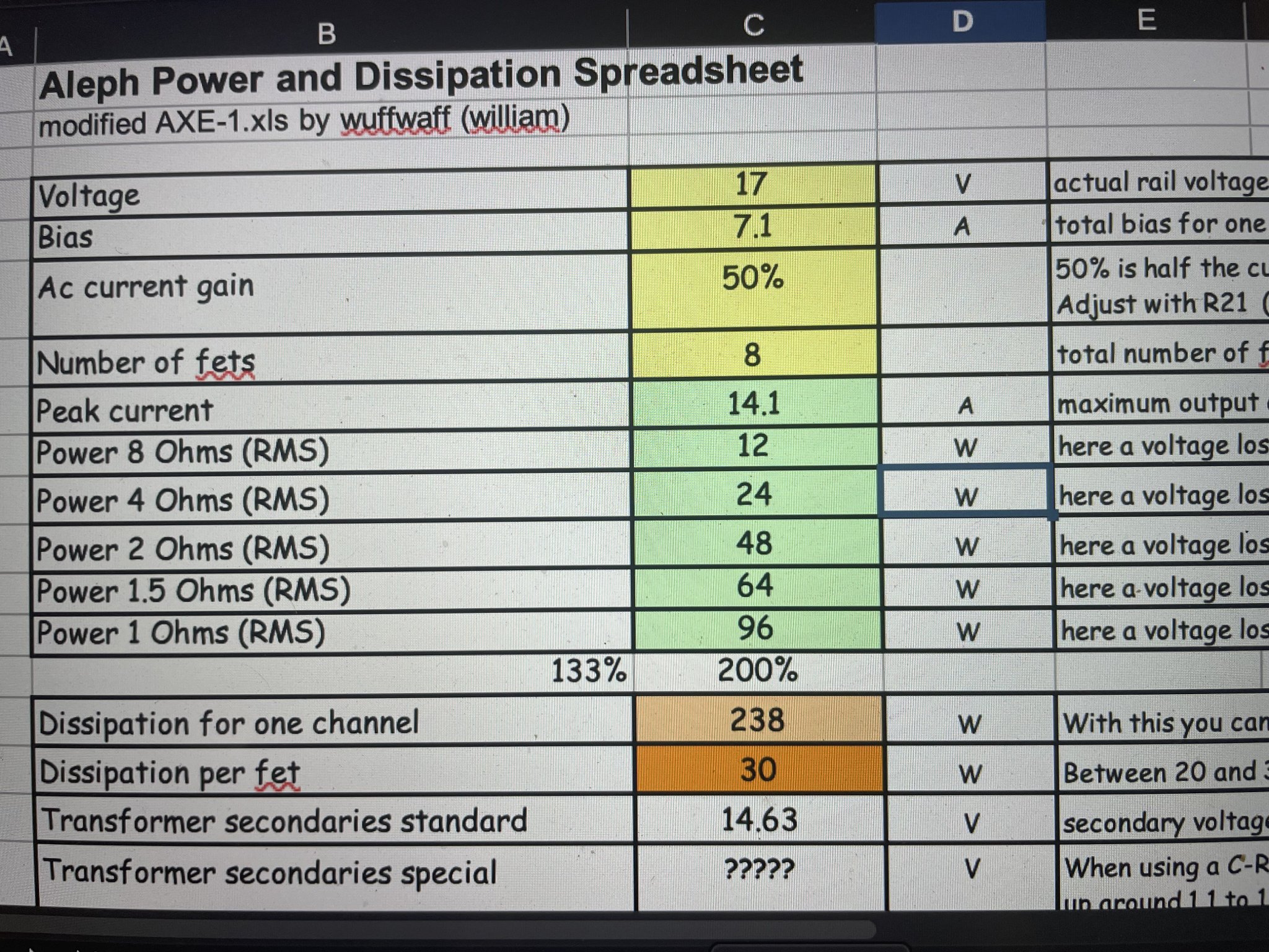

After playing around with it and comparing different voltages with different number of MOSFET and bias current, I got to 2 sets of numbers for the 2 pairs of Aleph 5 clones that I am building:
1) 8 MOSFET per channel (pic.1)
*VCC = 17V
*Bias = 7.1A
12W@8 ohm
24W@4 ohm
48W@2 ohm
96W@1 ohm
It appears that in order to keep the dissipation per FET to 30W and below, and to have output voltage constant regardless of the impedance, I will have to half the Aleph 5 VCC voltage.

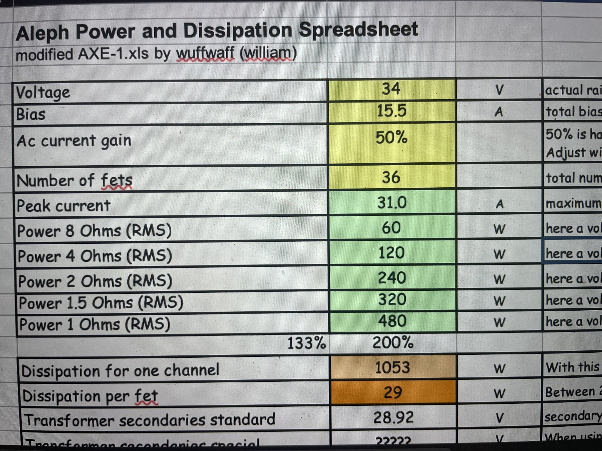

2) 36 MOSFET per channel (pic.2)
*VCC = 34V
*Bias = 15.5A
60W@8 ohm
120W@4 ohm
240W@2 ohm
480W@1 ohm
Some of you may suggest that I could reduce my bias current, but in order to drive speakers effortlessly that may have as low as 1 ohm impedance, I will have to have 36 MOSFET per channel in order to keep dissipation below 30W/MOSFET.
Please feel free to point out mistakes in my calculations, if any.
