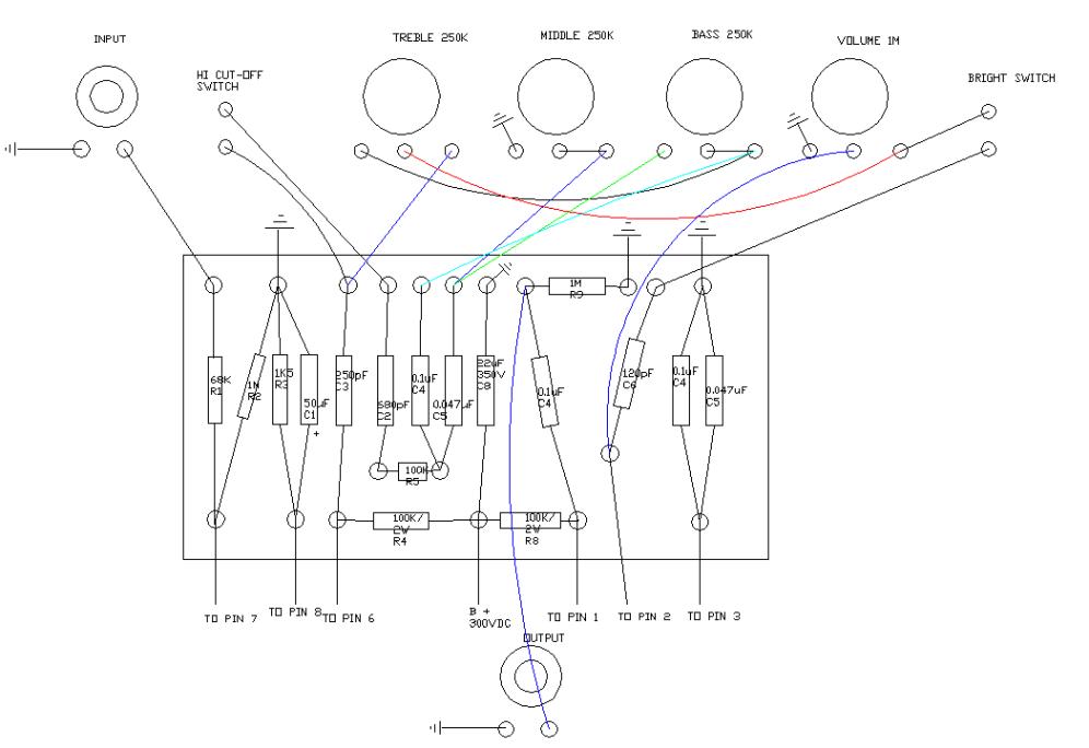

I want to build a clone of the Alembic F2-B starting from the schematic on this site. http://moosapotamus.net/IDEAS/F2B/alembic.htm
The only difference being that I only want one channel. I should mention I'm a newbie in electronics, not totally though, I've done some soldering of PCB kits before and such. A friend of mine who's an engineer will also help.
So here's my questions 🙂
I've drawn up an eyelet board for the placing of the components, can one of you guys be so kind as to check out this next to the schem and telll me if I did it ok? I'm not sure I got all the switches and pots with the right lugs. Look at the drawing of my pots like you would be directly looking at the back of the pot. Also, I had no idea how to draw a switch and for that matter what sort of switch to use.

So does anyone have a second to see if my layout will work or if I screwed up? I'd be eternaly grateful to anyone who does 😀

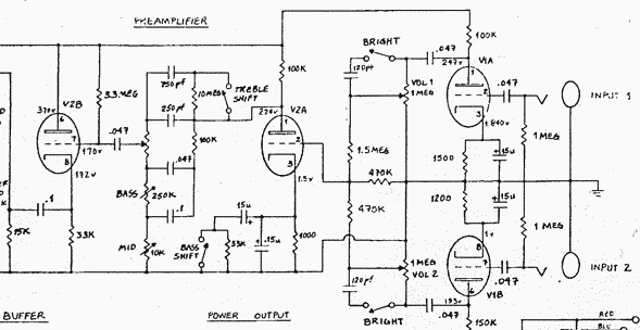

The schematic referenced has an error in the tone stack. There is a node on the 100k and 250pf at top. The 680pf is paralleled with the 250 to shift the treble point. There are several photos of the F-2B on the net showing controls and switches. While your basic eyelet layout (with the above correction) would work, it looks potentially noisey and very messy with too many runs from the controls to the board and the treble boost and shift caps should be close to controls and not on the board. Again find photos of the alembic's internals as well as other guitar heads and emulate the layout and ground paths. There are turrent board versions of Princetons that can easily fit your needs. I have fun building preamps for myself all the time, one or two different each year. It's easy, but tricky and if you're a rookie with tubes, read up on safety or build a fet version 🙂
I have it directly from Mica Wickersham that the F2-B is a straight derivative of the old Fender front end. There's no debate there. The "F" in the name is a hint if you want to think along those lines. Add an effects loop and a simple crossover and you're done.

So scottnixon what you are saying is that where the line from R4 to C3 crosses the line from C2 to R5 there should be a connection between the two?!
I have just finished my layout and are about to order the electronic parts so this is vital information.

I see the similarities of the tonestack of the Bassman 135, the Dual Showman and the Alembic (moosapotamus).
Only two things differs. The hi-cut capacitor and the size of the mid pot.
The hi-cut obviously didn't have the effect I thought it would. I was looking for a deep boost like the one on the Bassman.
The guy at moosapotamus had changed the mid pot value from 10k to 250k.
If it is not a mistake, what difference does it make?
The larger mid pot makes the midreange response more flat when the control is centered (the Fender 400 Hz 'suck-out' is minimized, and the response is nearly flat when all the way up)
You can see this effect with Duncan's Tone Stack Calculator.

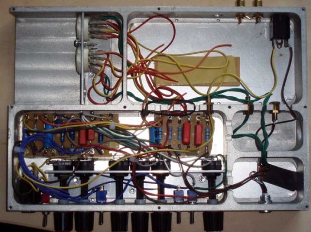

This is just the preamp without power-supply of course. I have taken out the ECC83 because I'm going to clean it up. It's a bit of a rats nest, too small a housing I suppose. The extra two pots on the left were for a switchable tube overdrive, but I couldn''t get it to work so I took it out.
This F2B bit has got a bit of a twist, it's got a switchable "high" capacitor a-la Mesa Bass 400 and also the "Bass-shift" function, as well as the bright switch.
The powersupply is still a bunch of components on a plank, quite scary, considering the fact I had some 330uF/ 450volts capacitors lying around and used three of them...
I used two 12volts transformers back to back, and I think my anode voltage ended up being a bit higher than the specced 300 for the original F2B, I think something like 325volts.
