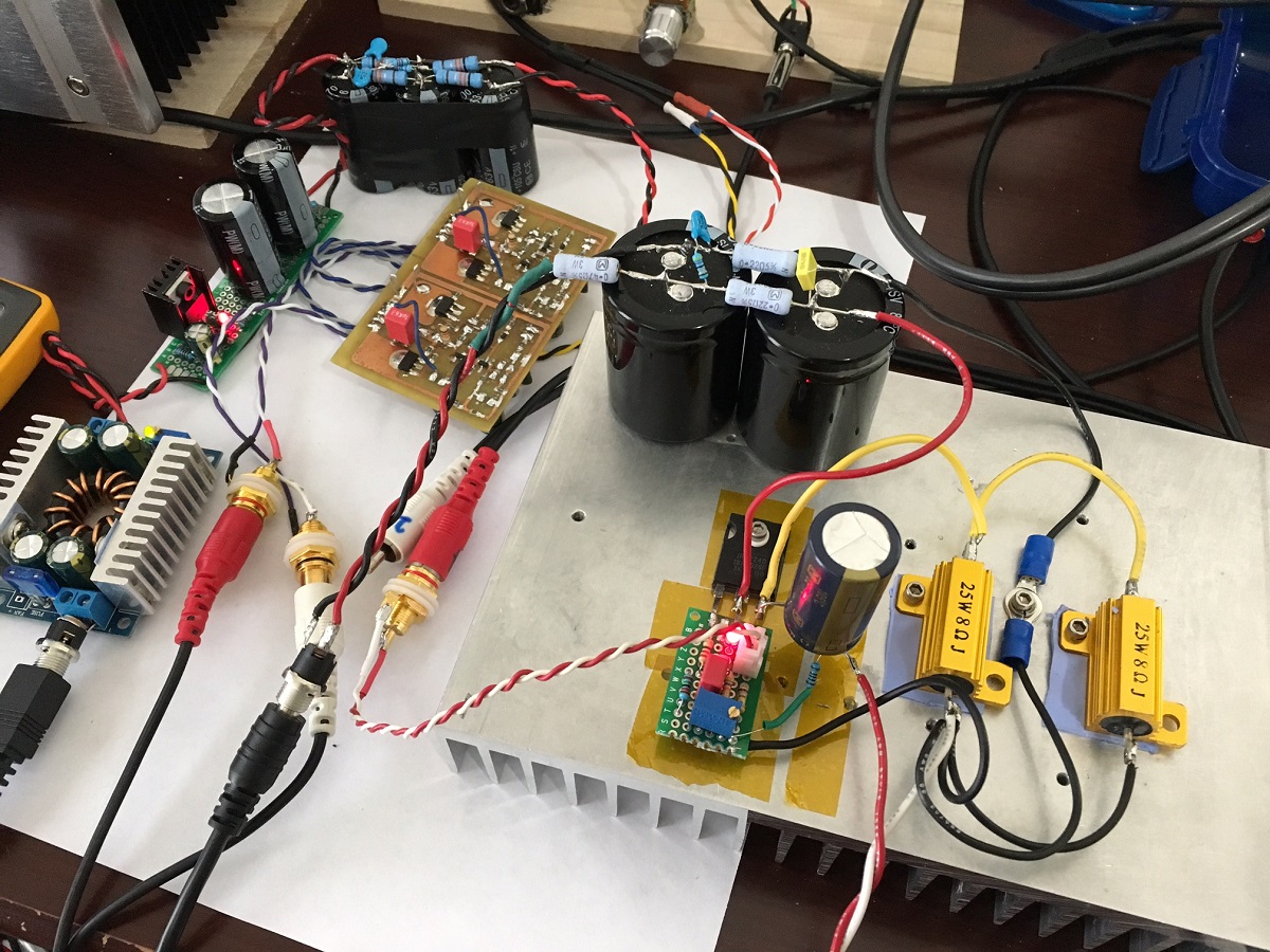

So I had an hour to throw together the MoFo amp (unity gain single transistor MOSFET follower amp). I did not have a 50mH inductor on hand so substituted the inductor with a power resistor for temporary test to get sound. My MoFo is using am IRFP240 and 24v SMPS followed by a CRC made with 22mF and 0.22R resistors. The resistive load is not ideal as it limits peak power due to lack of reactive load from the inductor. However, I am running it at 1.5amps bias so it is solid for playing a few watts into high efficiency speakers. The Aksa Lender preamp can drive it hard and it can get loud. Sounds very nice on test speaker (XKi fitted with Tang Band W5-2143):

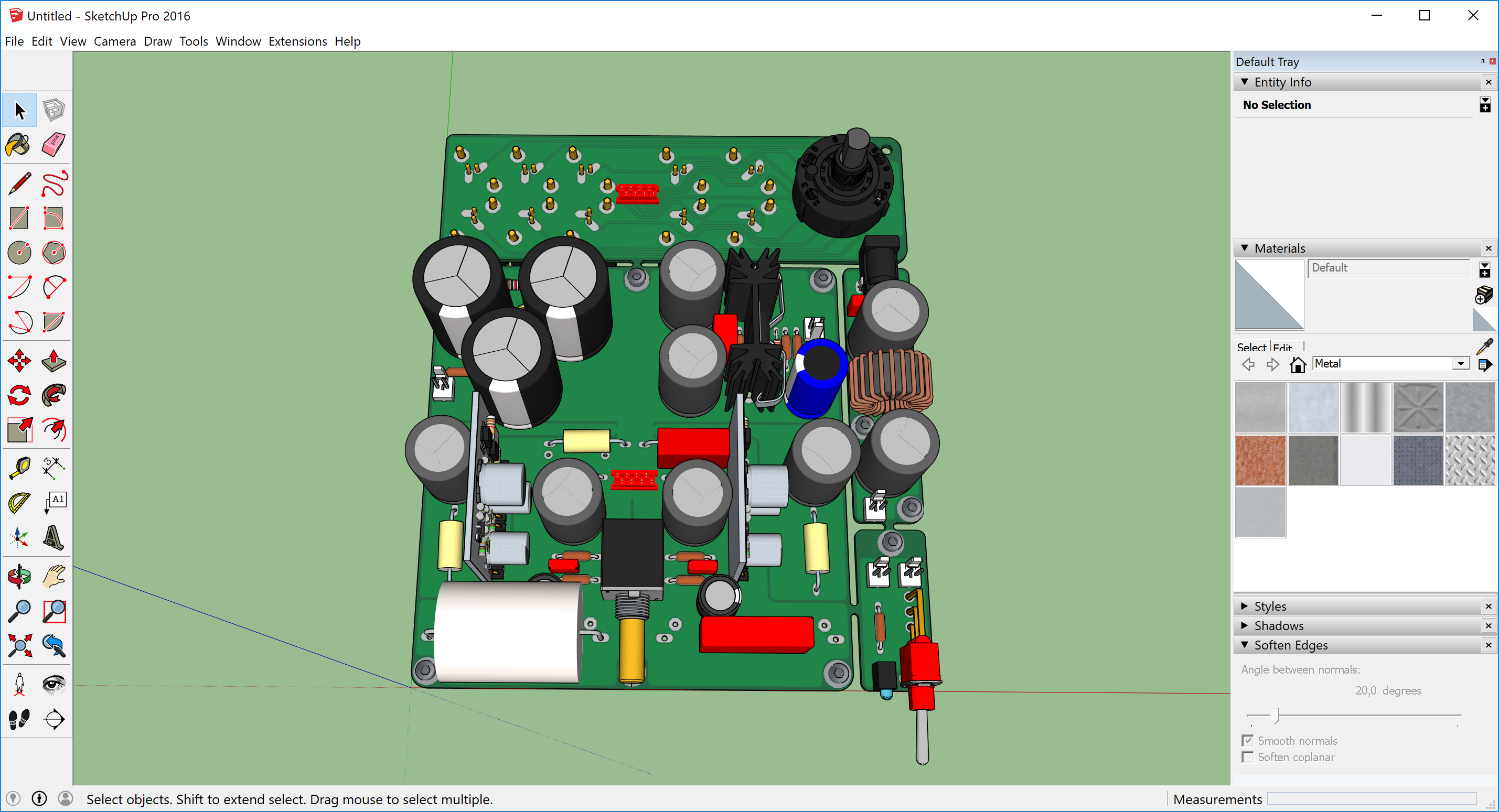

Should look like that as preamplifier powered by SMPS.
Someone to check (also last schematics post) so that I can finish this job.
No intention for GB (only a few boards for me and friends) so I´ll put all the datas online (EAGLE binaries, manufacturing datas).
Have a nice weekend.
JP

Very nice JP! So this is a multi input selector knob and there is a CLC to clean up before the cap Mx? The power should be very clean then. Can you please post the BOM so I can get a sense of the parts needed like pots, switches, etc.
Thanks,
X
Thanks,
X

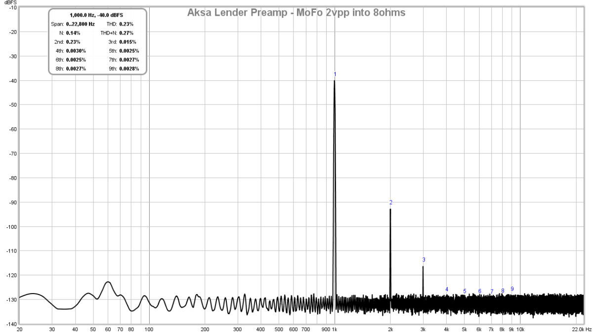

Here are some measurements of the Aksa Lender Preamp driving a MoFo at 2vpp as a headphone amp. It sounds very very nice. Lush, deep depp bass. No sibillance or harshness. Can listen to it all day.

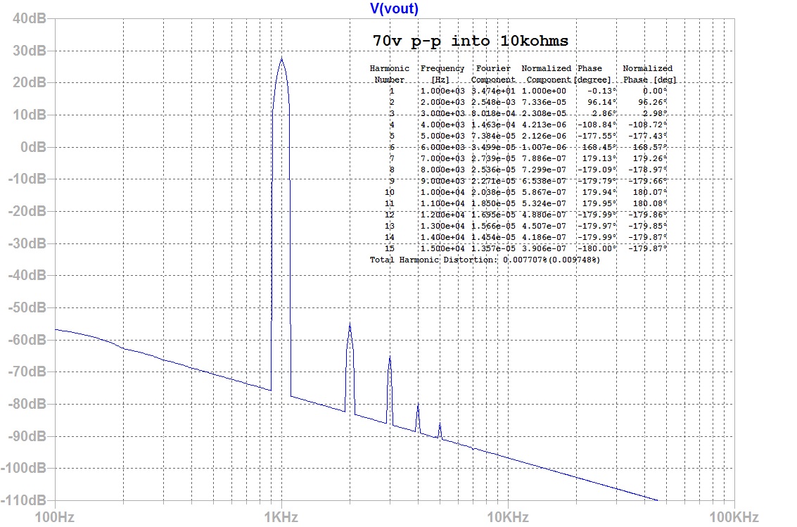

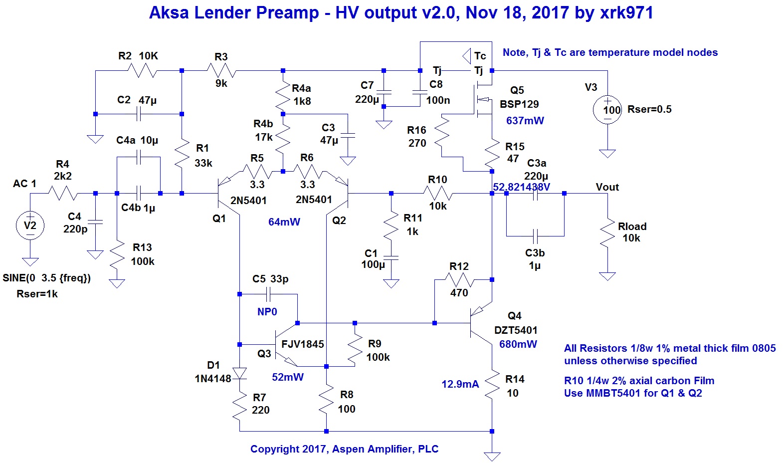

I rejiggered a few components and adjusted several resistors for a HV version of this amp that puts a nice clean 0.0077%THD 70vpp signal into a 10kohm load. LTP current is maintained at 2.5mA but now using MMBT5401 for higher voltage. BSP129 can handle 240v Vds and of course DZT5401 can handle -150v Vce. Gain is about 20dB and with 100v rail we can get a very nice harmonic distortion profile at a swinging 70vpp.
Schematic HV version 2.0:
FFT for 70.0v peak-peak into 10kohm load:
70vpp driving a unity gain output stage is good for 75Wrms into 8ohms.

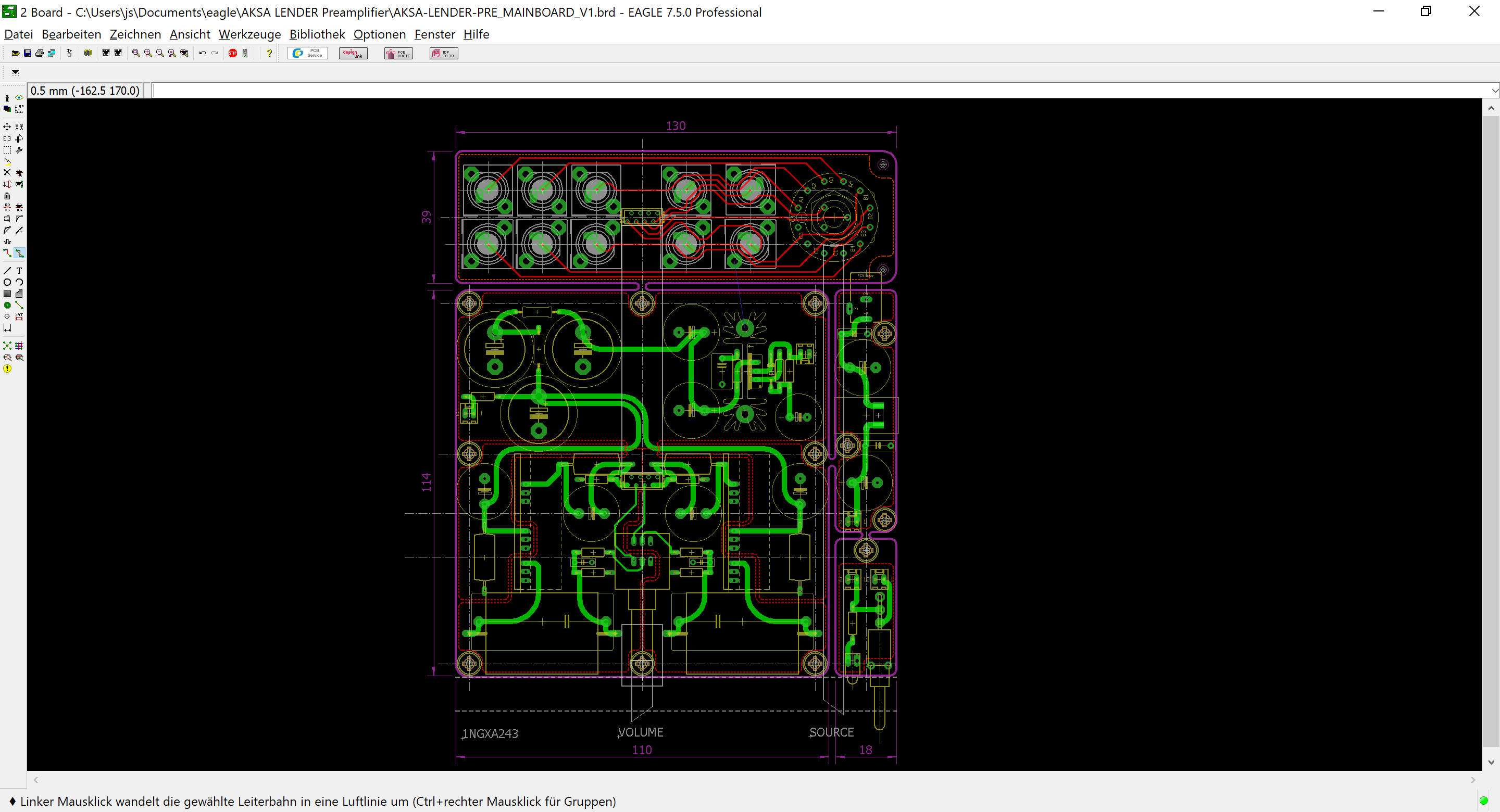

Hi JP,
You are very energetic and prodigious in your layout output. Since this preamp is an open forum design, I hope that you will make either the Gerbers or Eagle files for your layouts available freely in this thread. It sounds like you are planning to do this, but just confirming.
Thanks,
X

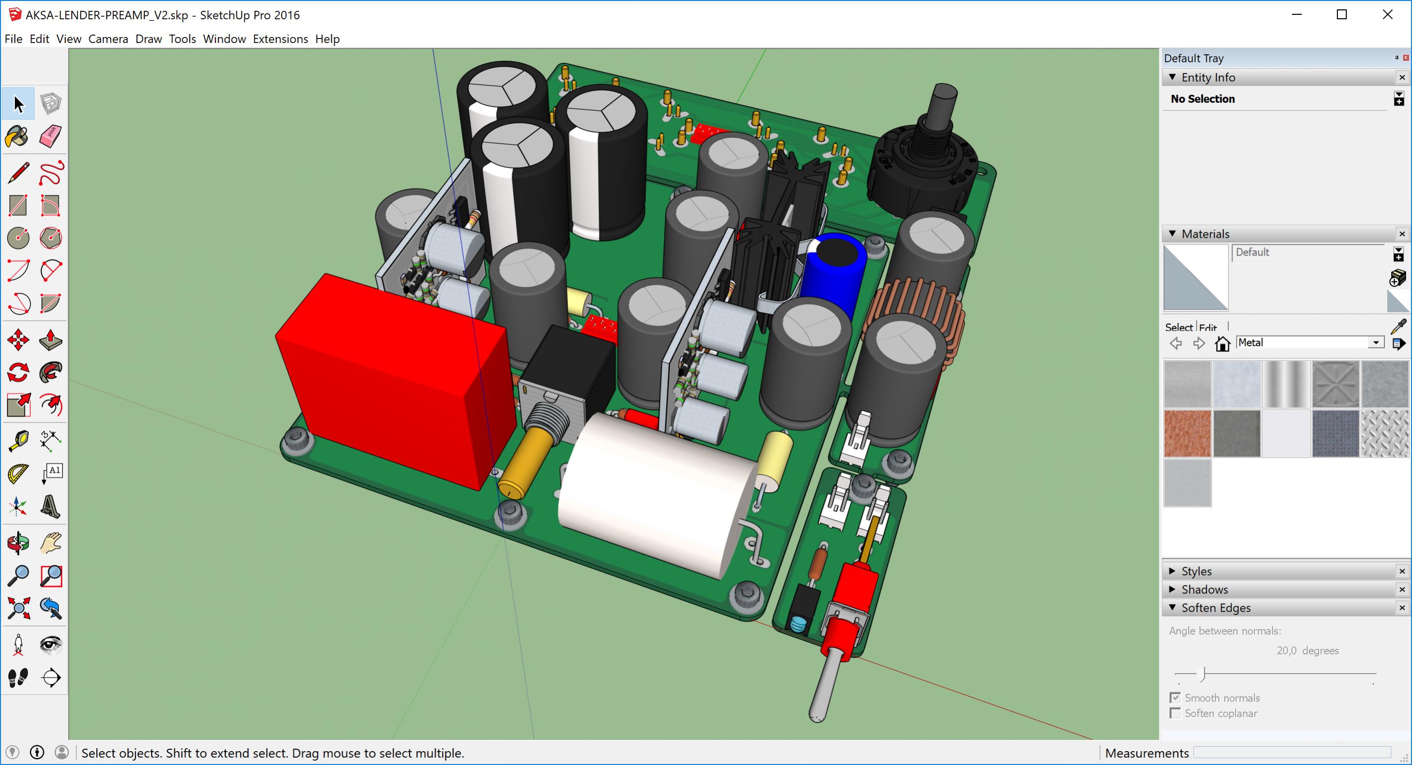

Here IMS version data set to check: schematics, part list, implentation, PCB details.
Silkscreen after check.
Second standard FR4 version after check.
Data set for both version will available for DIY community.
Starting part list for mainboard.
JP

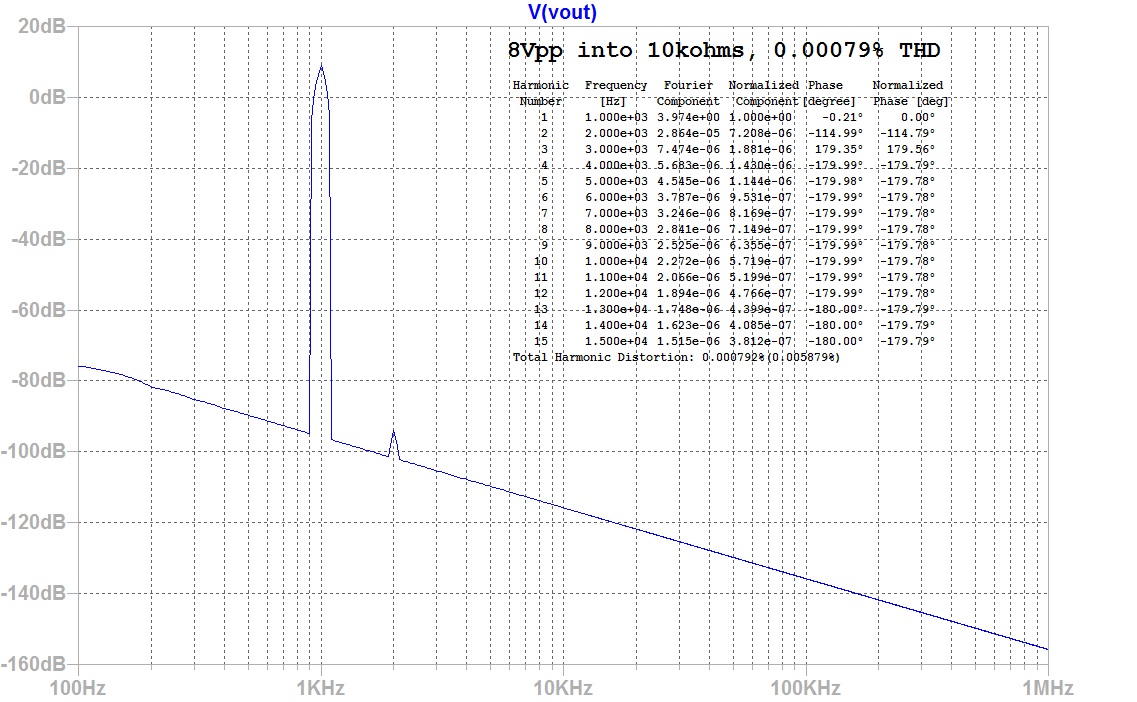

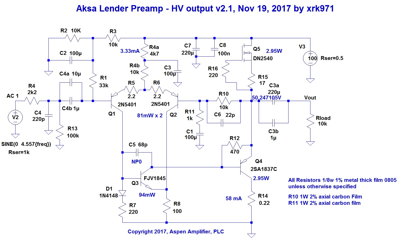

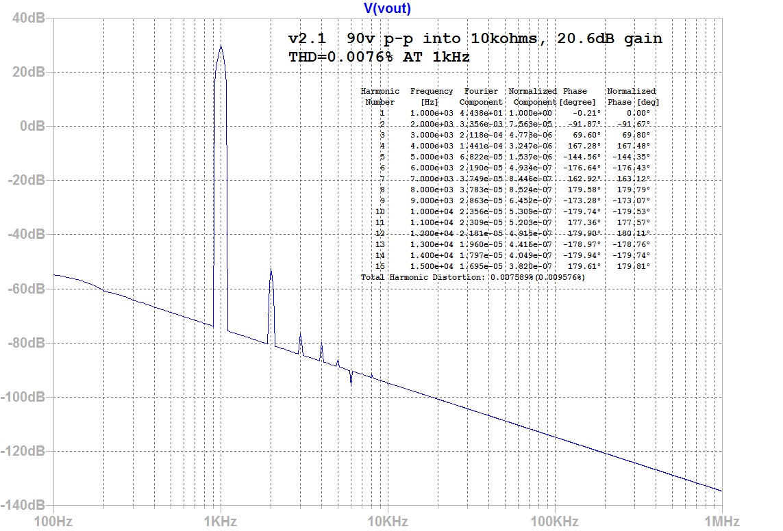

HV v2.1 90vpp into 10kohms 0.0076% THD
With Hugh's guidance, I was able to tweak the circuit for some more bias in the LTP and the VAS stage. Switching to beefier TO220 parts with real heatsinks as we are dissipating 3w ea now. But performance into 10kohms with 90v peak-peak is better than before. More compensation was needed at high voltages.
Schematic:
FFT for 90Vpp into 10kohms:
Here is 8vpp into 10kohms, 0.00079% THD:
