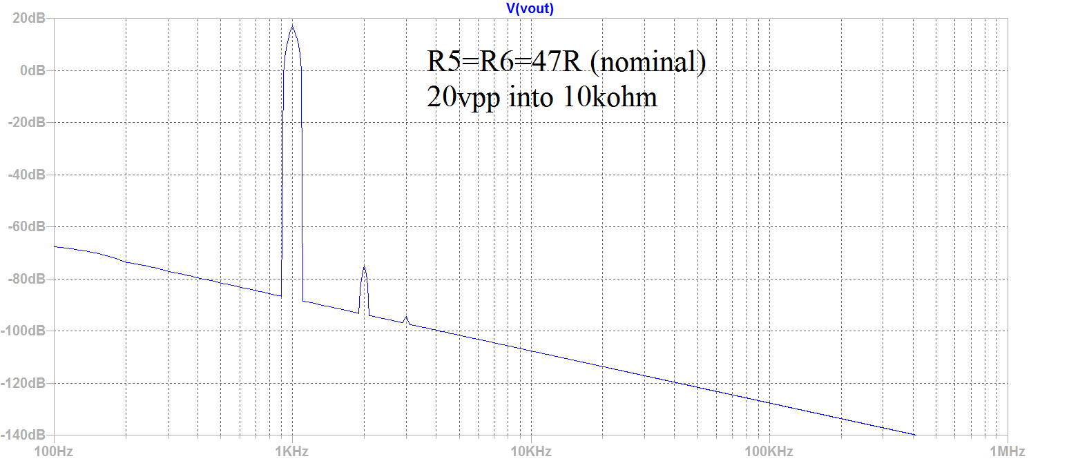

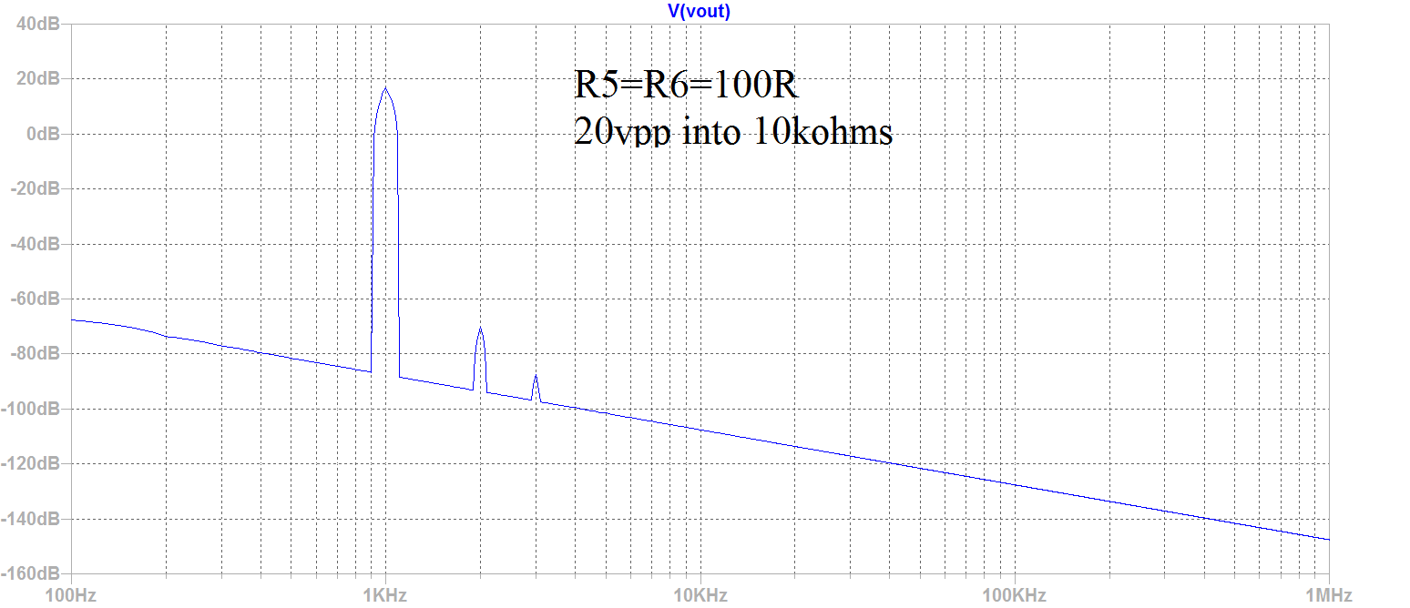

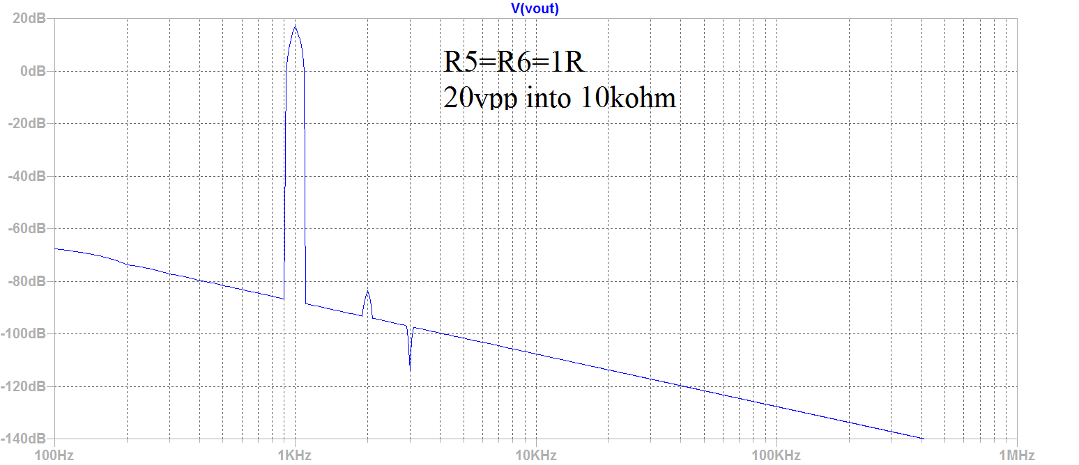

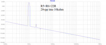

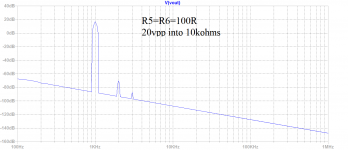

Effect of LTP Degeneration Resistors

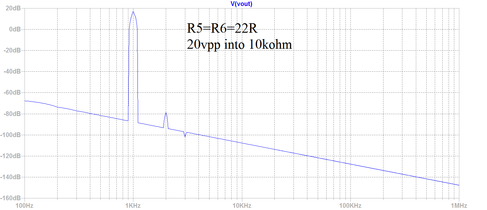

For those who may want to fine-tune the H3/H4 harmonic profile to their taste, here is what happens when the degeneration resistors of the LTP (R5 and R6) are varied from: 1R, 22R, 47R (nominal), 100R, and 150R. This is for 20v p-p into 10kohm load.
1R:
22R:
47R(nominal):

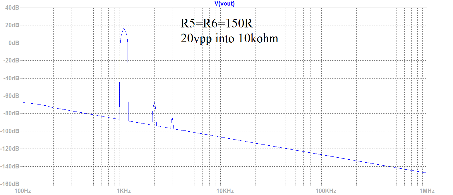

100R:
150R:
Here are the relative distortion components for the 150R case:
Just another knob there for users to fine tune to taste, whatever that may be.

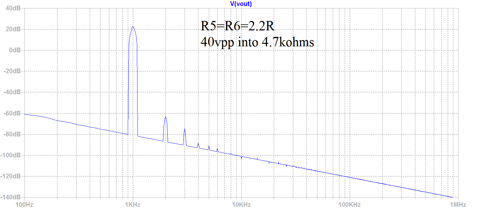

We can also use this knowledge to fine tune the response for a lower impedance load of 4.7k driven to 40vpp and still have a monotonically decreasing harmonic distortion profile by making R5=R6=2.2R:
1R:
22R:
47R(nominal):
100R:
150R:
Harmonic Frequency Fourier Normalized Phase Normalized
Number [Hz] Component Component [degree] Phase [deg]
1 1.000e+03 9.992e+00 1.000e+00 0.07° 0.00°
2 2.000e+03 6.125e-04 6.130e-05 96.23° 96.16°
3 3.000e+03 9.096e-05 9.104e-06 5.15° 5.09°
4 4.000e+03 1.521e-05 1.522e-06 -161.88° -161.95°
5 5.000e+03 1.209e-05 1.210e-06 -178.67° -178.74°
6 6.000e+03 9.770e-06 9.778e-07 179.88° 179.81°
7 7.000e+03 8.345e-06 8.352e-07 179.88° 179.81°
8 8.000e+03 7.299e-06 7.305e-07 -179.99° -180.05°
9 9.000e+03 6.492e-06 6.498e-07 -179.97° -180.04°
10 1.000e+04 5.844e-06 5.848e-07 -179.99° -180.06°
11 1.100e+04 5.312e-06 5.316e-07 -179.99° -180.06°
12 1.200e+04 4.869e-06 4.873e-07 -179.99° -180.06°
13 1.300e+04 4.495e-06 4.498e-07 -179.99° -180.06°
14 1.400e+04 4.174e-06 4.177e-07 -179.99° -180.06°
15 1.500e+04 3.895e-06 3.899e-07 -179.99° -180.06°
Total Harmonic Distortion: 0.006203%(0.008600%)

X I'm looking at your latest simulations, am wondering what does it mean when some of the harmonics goes negative as in the R5=R6=1Ohm and 22Ohm cases where the H3 takes a dive.
They are not negative, it's a log plot so can't go negative - the value is just lower than the descending (due to 1/f) average baseline. If that makes sense.
Ok I think I go it, I guess the simulation is able to visually point out harmonics whereas in real measurements would otherwise drown beneath the grass then.
Is it possible to lower the baseline by increasing the accuracy of the simulation?

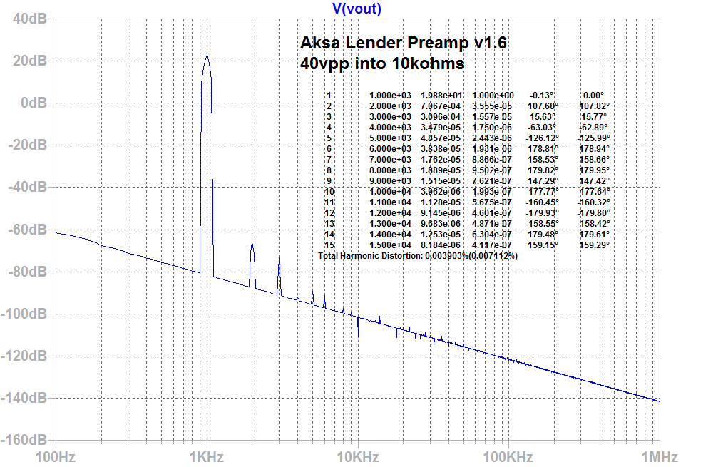

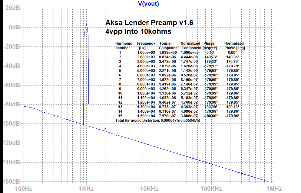

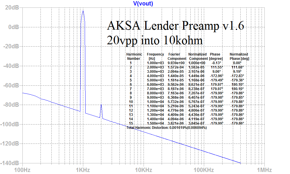

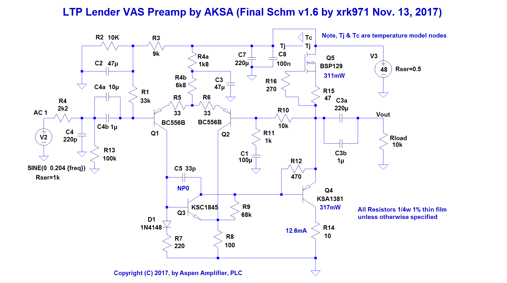

Some final tweaks v1.6
I think the preamp is ready for layout and production. I added an RF filter on the input, adjusted the degeneration resistor to 33R for reduced distortion at 40vpp, although this is totally user adjustable from 0R to 220R depending on how much thickness/body/sweetness one likes the sound to have. I also added a decoupling cap for the LTP as suggested by Juma. The BSP129 and KSA1381 are both dissipating about 300mW ea so can work without any extra heatsinking. If you push the bias current above 12mA, make sure to add a heatsink or extra copper pad for BSP129. All resistors are usual 1/4w axial and preferably 1% metal thin film on R5 and R6 to assure balance. Use 5% carbon composition resistors where you think it makes sense in signal path if value not critical. Match the Hfe of the Q1 and Q2 for lowest distortion. Use a high quality electrolytic such as Elna Silmic II on C4a, and likewise on C3a, use a decent brand name 50v electrolytic.
Here is final schematic v1.6:
Here is predicted FFT for 4vpp into 10kohm (0.00055% THD):
Here is predicted FFT for 20vpp into 10kohm (0.0016% THD):
Here is predicted FFT for 40vpp into 10kohm (0.0039% THD):

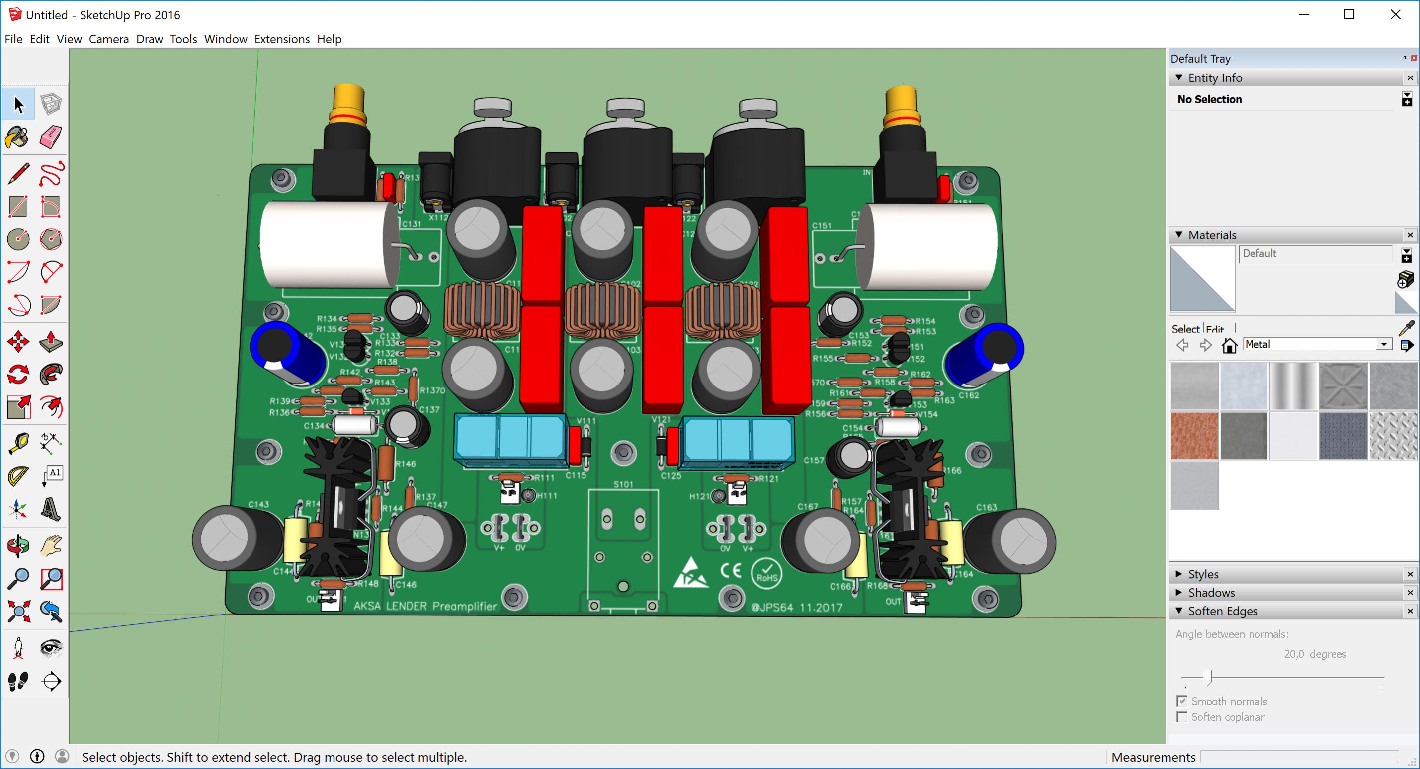

JPS64,
It wasn't until I enlarged the image that I realize you had done the full blown design already. Well done. Will Gerbers be available?
Thanks,
X
Thanks,
X
