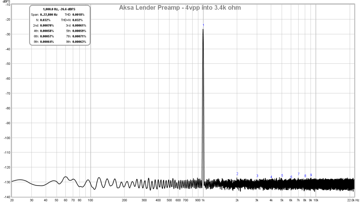

I installed a 4k7 resistor, and that, coupled with a voltage divider for the input resulted in a net 3.4kohm load.
Here is 4vpp into 3.4kohms, I adjusted the gain on the audio interface a bit but distortion is still pretty low, around noise floor of measurement setup:

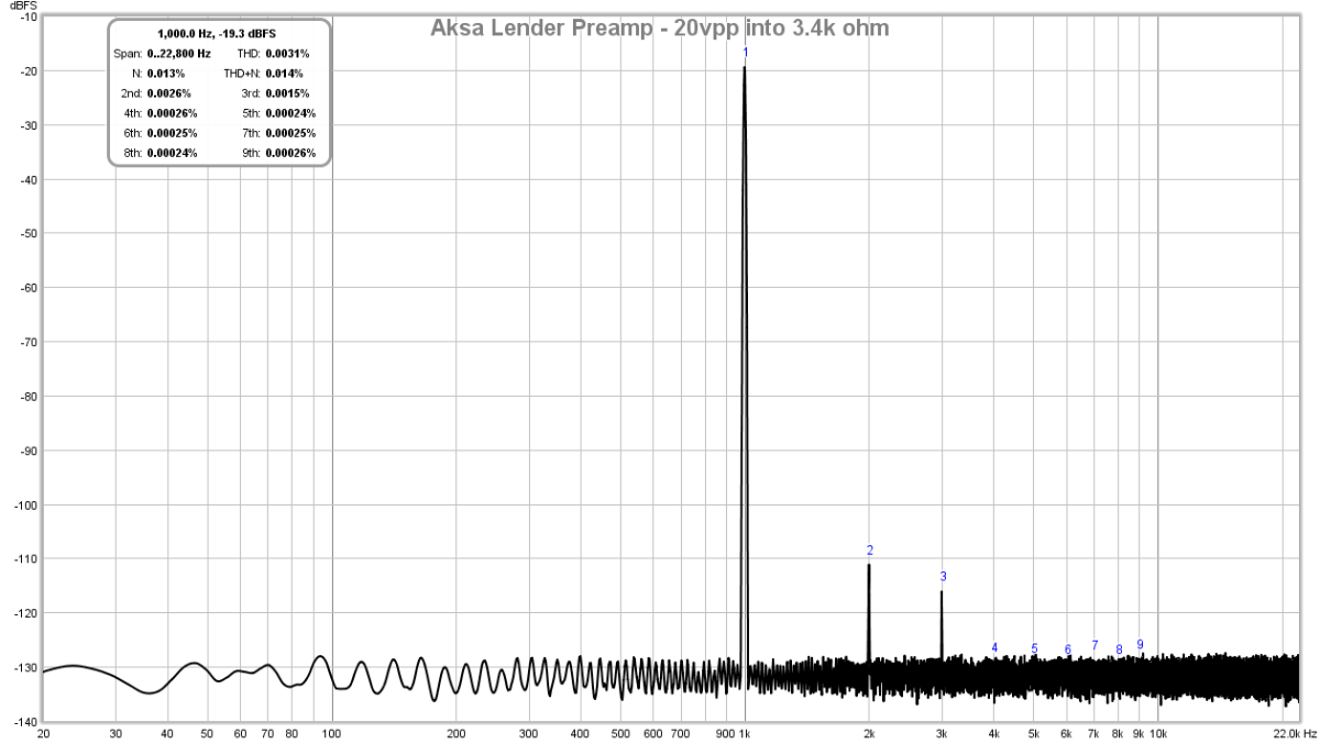

Here is 20vpp into 3.4kohms, it seems 3rd order harmonic distortion increases relative to 2nd order at this loading, but still a decent result that would probably sound quite good still:

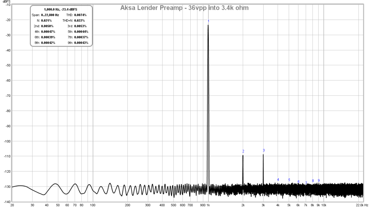

Here is 36vpp into 3.4kohms, 2nd and 3rd order about the same (some people like this sound as it has more bite), and any higher in amplitude, and it starts clipping:

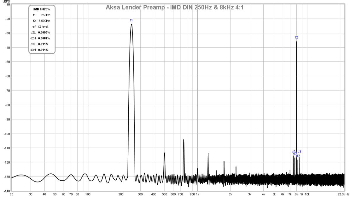

Here is IMD using DIN standard 250Hz and 8kHz at 4:1 ratio with 20vpp into 3.4kohms, IMD=0.02%:

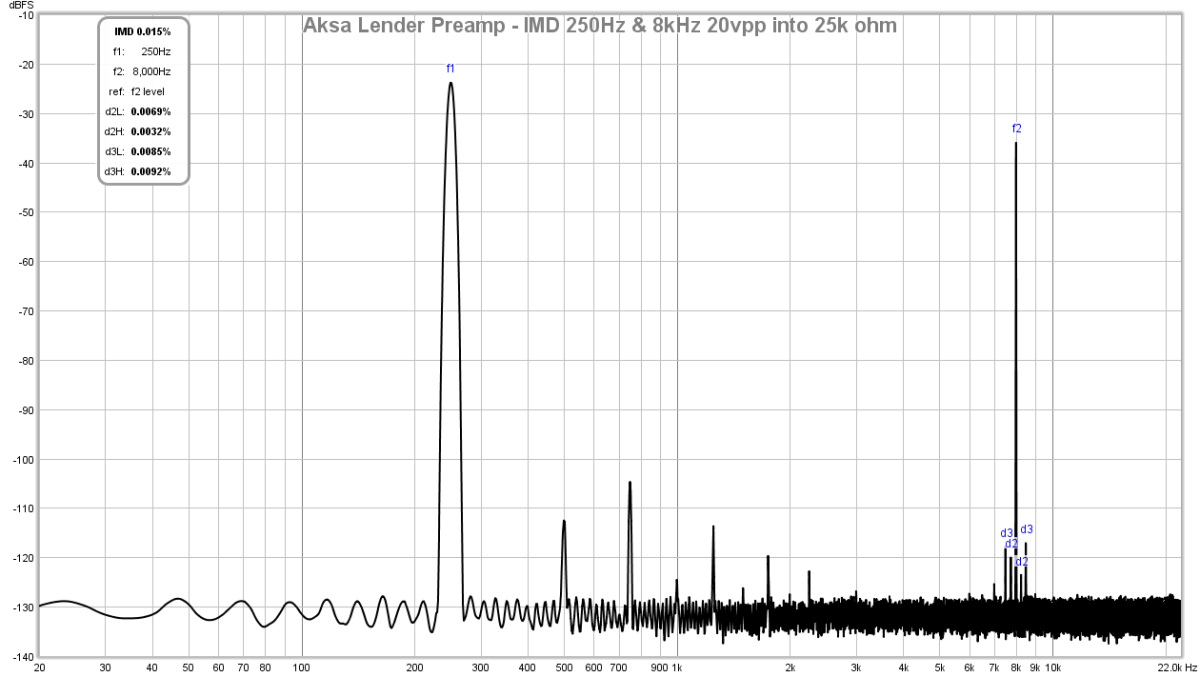

Here is IMD with same DIN standard but for 20vpp into 25kohm, IMD=0.01%:
So, I would say that 4.7k ohm load can work, just be careful of clipping at higher drive levels.

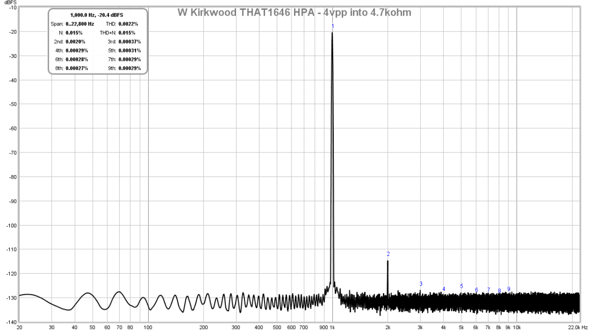

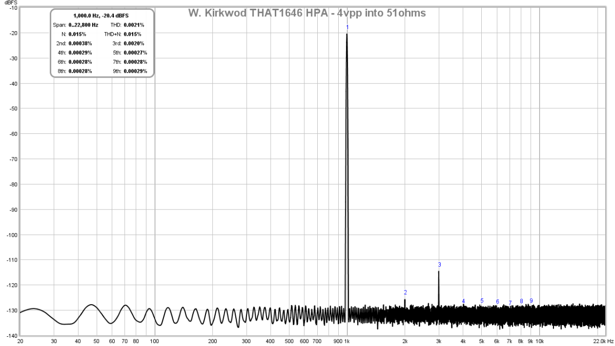

One more measurement, this is Wayne Kirkwood's THAT1646 HPA (0dB gain current buffer), which up to this point, was the lowest distortion amp I had measured. But subjecting it to the same 4.7kohm load and 4vpp, I get the following distortion with a THD of 0.0022%, a low number, but Hugh's Lender preamp actually beats a formidable low distortion opamp in this case! Here is the Kirkwood THAT1646 driving 4vpp into 4.7koms:
So the AKSA Lender Preamp, now has the new distinction of being the lowest distortion amp I have measured for a 4.7kohm impedance at 4vpp.
Using the Kirkwood THAT1646 as a headphone amp driving a 51ohm load, we see that the dominant distortion is now 3rd order:
It's not a bad headphone amp, but doesn't have the nice harmonic profile of a SE Class A amp.

Hi xrk,may i ask what is your measurement hardware and software?One more measurement, this is Wayne Kirkwood's THAT1646 HPA (0dB gain current buffer), which up to this point, was the lowest distortion amp I had measured. But subjecting it to the same 4.7kohm load and 4vpp, I get the following distortion:
With a THD of 0.0022%, a low number, but Hugh's Lender preamp actually beats a formidable low distortion opamp in this case! Here is the Kirkwood THAT1646 driving 4vpp into 4.7koms:

Right, I was only referring to my own measurement as I previously stated that the THAT1646 HPA that I built was the lowest distortion amp that I had measured, and now it turns out, Hugh's design is actually lower (as a preamp). I fully realize there are designs out there with qnty 248+ actives that achieve order of 1ppb (part per billion) THD 😀
Regards.
Hi Thimios,
I am using a Focusrite USB ADC/DAC (audio interface). I have 3 units, all using the same ADC/DAC internally, I think. These are the Solo 2nd gen, the 2i2 2nd gen, and the 2i4 2nd gen. The data for this preamp was taken with a 2i4 and the Solo. The software is REW, in RTA mode with the built in function generator feeding the DAC. I typically run in ASIO mode at 48kHz data rate. Sometimes I use Right Mark Audio Analyzer, but I find that too limiting as it requires one to set the amplitude exactly at a certain level before it agrees to acquire data. Whereas REW, takes data always, no matter what. For signals greater than 3 or 4v, I use a 10:1 voltage divider network. The one limitation that I have just run into is that the noise floor on the Focusrite is -130dB, and some amps actually have a lower distortion level than this, or of same order of magnitude. But generally, that won't matter anyway as it is much too low to really matter. Oh, it helps to have a lot of RCA to 3.5mm stereo cables, or RCA to alligator clip cables, and several 3.5mm and 1/4in stereo jacks fitted with dummy load resistors.
