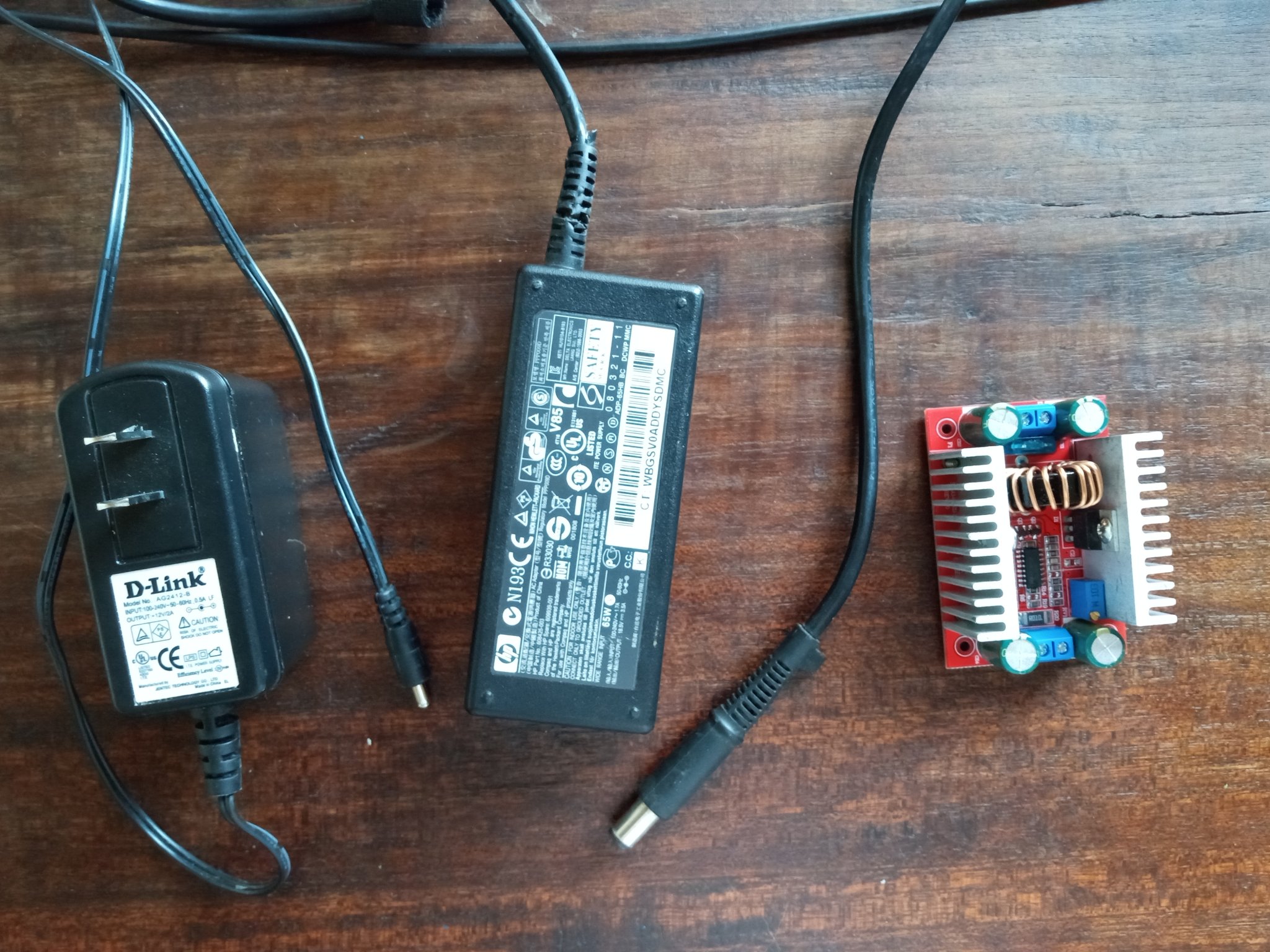

I am ready to start building the PS for the ALP. I have 2 possible supplies and a DC-DC boost converter in the pic attached. One is a D-Link router wall wart with 12V/2A output, and the other is an HP laptop brick with 18.5V/3.5 amp output. I am thinking that the HP brick is probably a better choice. Any comments on choice of PS are welcome.
I was looking at post#446 (some AL TLC), and I see that the boost converter shown uses a barrel connection on the input, I think. I don't have any of these laying around, and I am thinking of cutting the connector off the cable and using the supplied screw connectors on the boost, along with the fancy ferrule tips that X is fond of. Any problem with this reasoning, and how do I determine which wire is +/- in the cable ?
Would like to know how other folks managed this?

I like the the variable boost DCDC that lets you run at 48vdc at the preamp rail. So that’s about 53v at the supply. Feed this with a linear 12v or 24v wall wart for best results. You can try the laptop 19v bricks and name brand ones like HP or Dell will be quieter than no name ones.

It won’t need more than 200mA at 53v so 53/19x200mA=557mA. Double that to be sure you have margin so a 1A 19v supply should be good.
