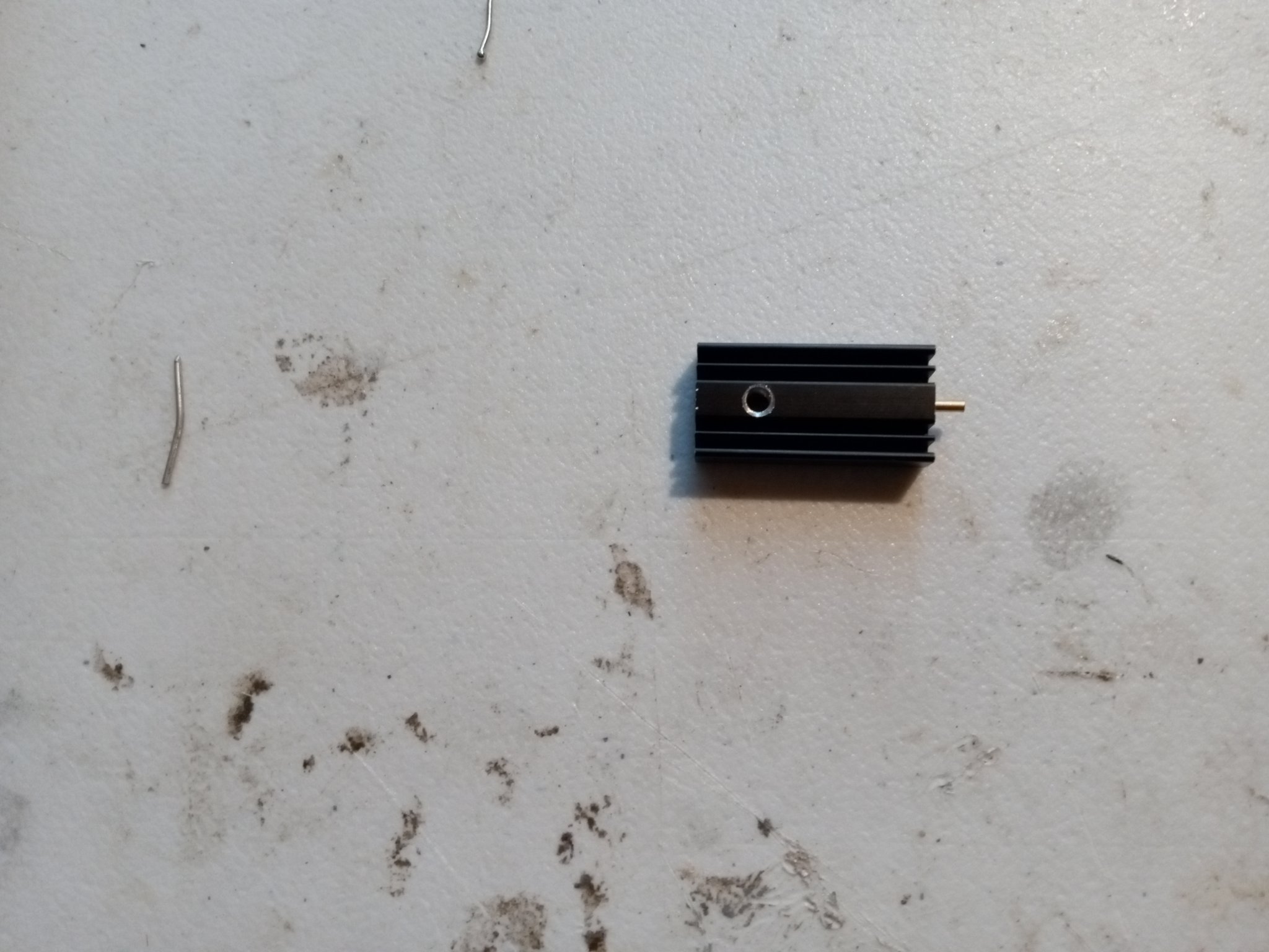

Hello AKSA Lender Pre builders,
I have some SK95 heatsinks that I would like to use for the transistors on the ALP. They are Fischer and the dimensions are 25mm L x 12mm W x 7mm T. They fit the transistors well as they are TO-220.
I am wondering if they are enough sink for the DN2540 transistor. I think OK for the SA1381 transistor. See attached pic.
Thanks for the help.
That should work - it will run pretty hot but as long as the heatsinks are below 55C you won't burn yourself, but they can run 85C fine as long as you don't touch them.
