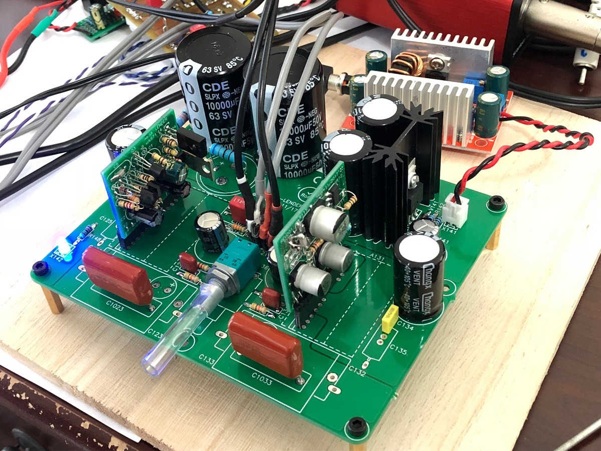

I'm just getting around to building this preamp. DN2540N5 is no longer available. I thought I'd adapt the BSP129 unless there's a better substitute. Any suggestions will be appreciated.
I believe you could use DN2535N5 as alternative. Looks that the voltage is slightly lower than the 2540, but that wouldn’t be an issue in the AKSA Lender pre.

The TO92 version can handle a watt - for a preamp at 45mA bias current and 24v drop it’s right at the limit. Drill a hole in a small block of aluminum and use thermal compound.
https://www.mouser.com/ProductDetail/Microchip-Technology/DN2540N3-G?qs=nVvxX1UUhUy3YEvMgWenjQ==
BSP129 will work fine of course as long as it’s mounted to a small heatsink.
Sounds like the BSP129 might be safer. I think I can easily attach to small heatsink. If I get industrious I'll make an adapter like you made for the LU1014.
I've just finished building this preamp using DN2535N5 instead of DN2540N5. I have a dumb question, sorry.
Using a 24V - 1.5A SMPS I can only get about 12Vp-p output before i get clipping. I tried a 36V - 4.4A SMPS and can get higher but not the 40Vp-p. Using my bench supply with the dual outputs in series (about 60VDC - but not sure of amps) I can get only about 20Vp-p. I've built using the standard BOM from this thread. Is this just a matter of finding the right PSU (possibly a linear one) or is something else amiss? Thanks.
This preamp was designed to work with 48v Vcc so about 52v upstream of the cap multiplier and CRC supply to account for drop out. What I use is a DCDC step up supply powered by a 12v 1A linear Class 2 wall wart. The 12v is boosted to 52v or so with the trim pot. Measure the voltage at the drain of the mosfet and adjust trimpot until it reads about 48v. The circuit DC setpoints was not optimized for 24v or 36v. It can work there but you won’t get anywhere close to 40Vpp output.
Here is the DCDC boost unit I used (silver heatsinks in background):
I have also used this style with good success.

Hi X, what is the model of the DC-DC boost module in the picture in above post. I am thinking it might be a good module to have in inventory. If I recall correctly, you have used this boost in a few other projects, correct?

I use this one for my Aksa Lender from a local supplier, but should be easily available from Digikey or Mouser:

Thanks for the great information. I'll change it as you recommend. Plan to use it with F4 and will need the 40Vp-p.
It’s similar to this:Hi X, what is the model of the DC-DC boost module in the picture in above post. I am thinking it might be a good module to have in inventory. If I recall correctly, you have used this boost in a few other projects, correct?

US $3.54 20% Off | DC 400W 15A Step-up Boost Converter Constant Current Power Supply LED Driver 8.5-50V to 10-60V Voltage Charger Step Up Module
